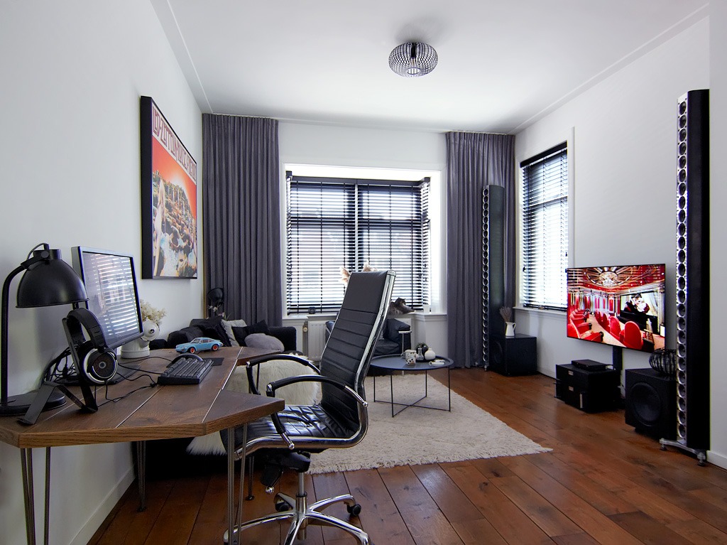

It depends on how one is able to do it I guess, maybe a bit of luck thrown in. I went for an excellent single seat and great couch result. Balancing everything is hard and it sure takes time. But time I was willing to invest. It isn't punishment to listen to songs. Lots of experiments can be done on the PC first, to get more time listening than measuring.
For starters, I do have all the sources at the same end of the room and at similar distances, so it's all directed at the listening position and fires (still in Stereo) at the couch. It (left right) really sums + 6 dB at the sweet spot. Whats needed for the subs is differing positions in relation to the room boundaries. Have you tried a single or double bass array? I would love to do that. It has about all the needed requirements.
The reason this works for me is because it's making use of my relatively small room. I have the arrays working along with the subs(*). The arrays are 2.25 m. tall and help produce bass to spread the bass sources (I know you don't believe in this method of using EQ down low, but it does work and stays well within limits). This helps to spread the positions in height. Each sub should be in a different location. One in a corner, one half way along the long wall etc. One or two at a different height etc. The arrays are dialed down compared to the subs. They don't work on the lowest octave either, the subs handle that part way better. They work where they still work best, where the room adds to their output and they are dialed back where the room counters their output. They are all this close to the front wall for a reason.The subs fill in the gaps, much like I was able to do between the left array and the right array in the not so distant past. This way, trough planning and using the room as an advantage, I get way more out of the complete package than many would consider possible. And well within the limits of each driver that is part of it. The arrays have less volume displacement capabilities than the subwoofers, so they carry a load that is in balance with that fact. Without room gain, it would fall apart.
Most people will probably find it hard to believe, but this system can do the 85-90 dB on average and still hold up well at the peaks too, that are present in our dynamic music. (you know, songs with a dynamic range of about 15 instead of 6) I aimed for the ability to do 105 dB at 1m over as large a frequency band as possible (for music use). Every song I play has been scanned in advance for dynamic range and plays at the same average level. I don't ever feel the need to be louder than that. I would get different speakers for a party outside.
I may at times listen at lower levels at times (but that doesn't even happen that often :D). Planning ahead what one wants to (or be able to) do helps to get the right mix of ingredients. All amps are way more capable than the speakers can handle. The worst signal firing at a speaker is a clipping amp.
I've worked on this (as a hobby) to improve the results continuously over time, learning from mistakes. But also learning to really make use of what one has and optimizing that over time. Staging and imaging varies with the song content and can easily be up to 180 degree, way past the speaker placement, having the center voice "hover" slightly in front of you. If it's in the song. Due to the room treatment, the song determines the imaging, not the room.
I've had many visitors, a few forum members have shared their impression, those stories are linked in the first post of my thread. Most have heard the version without subs though and still they were impressed what could be achieved (due to my relatively small room ;)). Without the room to help out, none of it would have been remotely possible. The room size matters in what it needs, but if I would have had a bigger room, I would have had more space to get bigger (sub)drivers. :D
I won't blow coke cans off of a table at 4 meters, but I have bass that I can feel and it certainly isn't sloppy. The transient we hear isn't the low notes. Those notes we mostly feel, the hear part that gives it "snap" is in the harmonics... No overhang or having fast and even decay, that should help. Sometimes you need a bit of luck with the room. I have firm brick walls all around, but it has an inner shell (with damping behind) behind the speakers and on side walls.
One exception on bass output: for Home Theatre I dial things down a bit and restrict the output of the lower octave to protect my subs. In music I haven't run into any trouble and can let it run lower. It starts to slowly back off at 30 Hz, but due to using an in-room measured curve the frequency curve at 20 Hz is louder than at say 3 KHz. The loudest song I have found over the years used to get me in trouble. These days I make sure it isn't a problem.

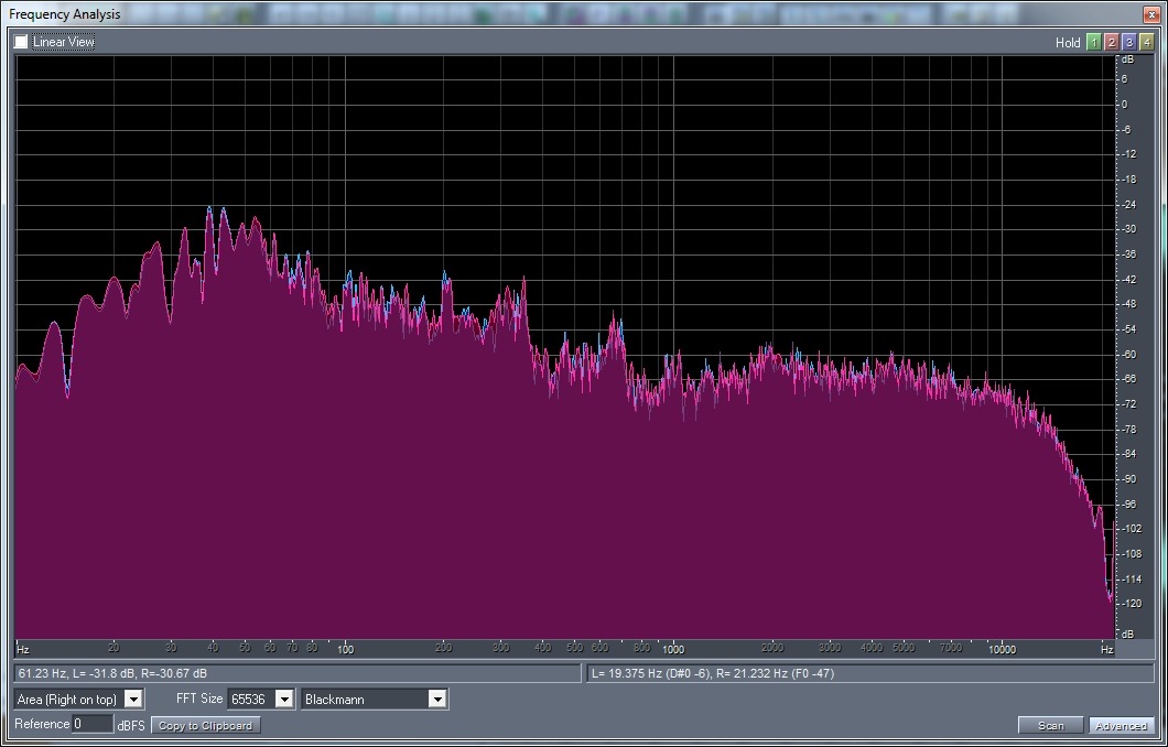

The song: A Perfect Circle - Lullaby
a_perfect_circle-jpg.1017899
Part of that particular song in a frequency analysis.
The bass part is a slow pumping atmosphere in this song. Not something that hits hard. The timing of 'feeling and hearing' makes for the most fun experience i.m.h.o.
That is the part that produces the smile on my face. Somehow people always flinch and look up when the bongo's hit on Hotel California, the live version from Hell Freezes Over. They don't expect it to sound that close and lively. But even simpler songs get new meaning with low bass. Feeling is very much part of listening.
We hear with our entire body.
(*) Without the arrays I wouldn't be able to get as clean results at lower frequencies. I had to choose between using them for these low notes or optimizing for midrange by not letting them play low. Listening extensively to each setup, I chose to have them lift the parts where they do so with the help of the room. It smooths out bass performance in-room while not taxing them too much. Straightening phase and using linear phase EQ plus room treatments could be considered the tools that allow me to do so. All done by measuring in-room at listening position. Many things can go wrong with that, so it took me an awful lot of time (learning) to get it right. It surely isn't as simple as drawing up your favorite room curve :).
Hope it's not too long winded, this is my take...

I'm well aware that my setup is strange and different from most, all DSP done with the PC. It is an ongoing playground for me to enjoy this hobby. I've only once build speakers, subs and ambient channels. Most in this hobby build new speakers every once in a while. I puzzled on a concept that could work and am dedicated to get the most out of it. Whatever I can come up with, I'll try.
Reactions: 1 user
Oh, you're the person with the line array! I've seen your room photos in a different thread. First of all - amazing room, very good looking, I love everything about it. Including the fact that it's not huge, i. e. like most rooms I have access to, not like the U. S. mansions :) And second, I have tried reading one of your threads, the one about phantom center image, if I'm not mistaken? I was amazed by how deep and technical the discussion was, I couldn't keep up. Respect for digging in and applying science.
Found your line array thread, very interested, but it's also way over my head :)
