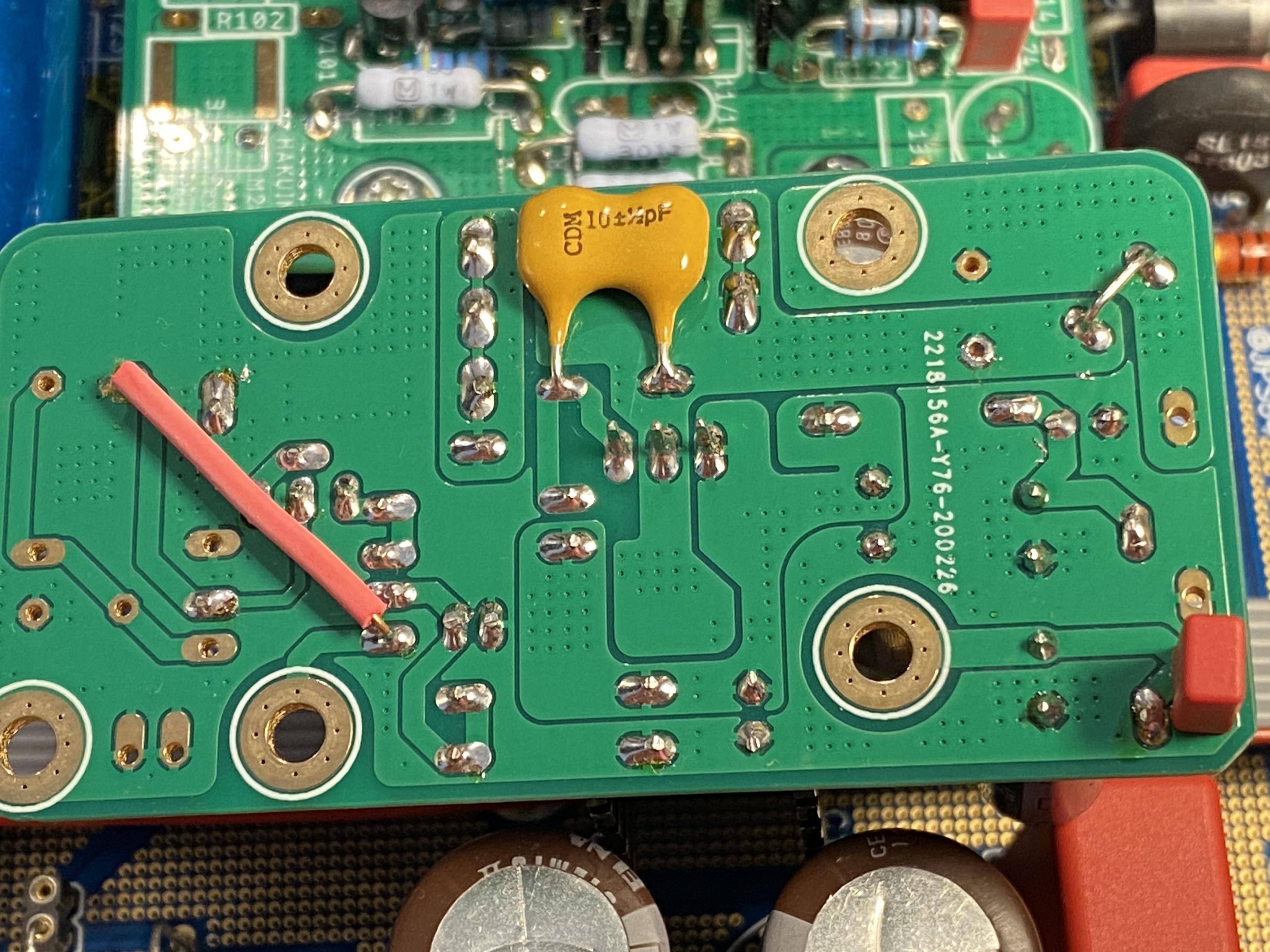

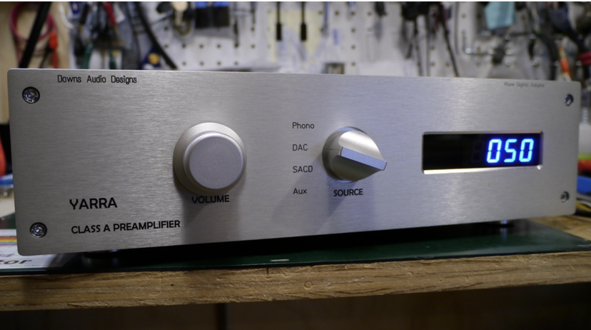

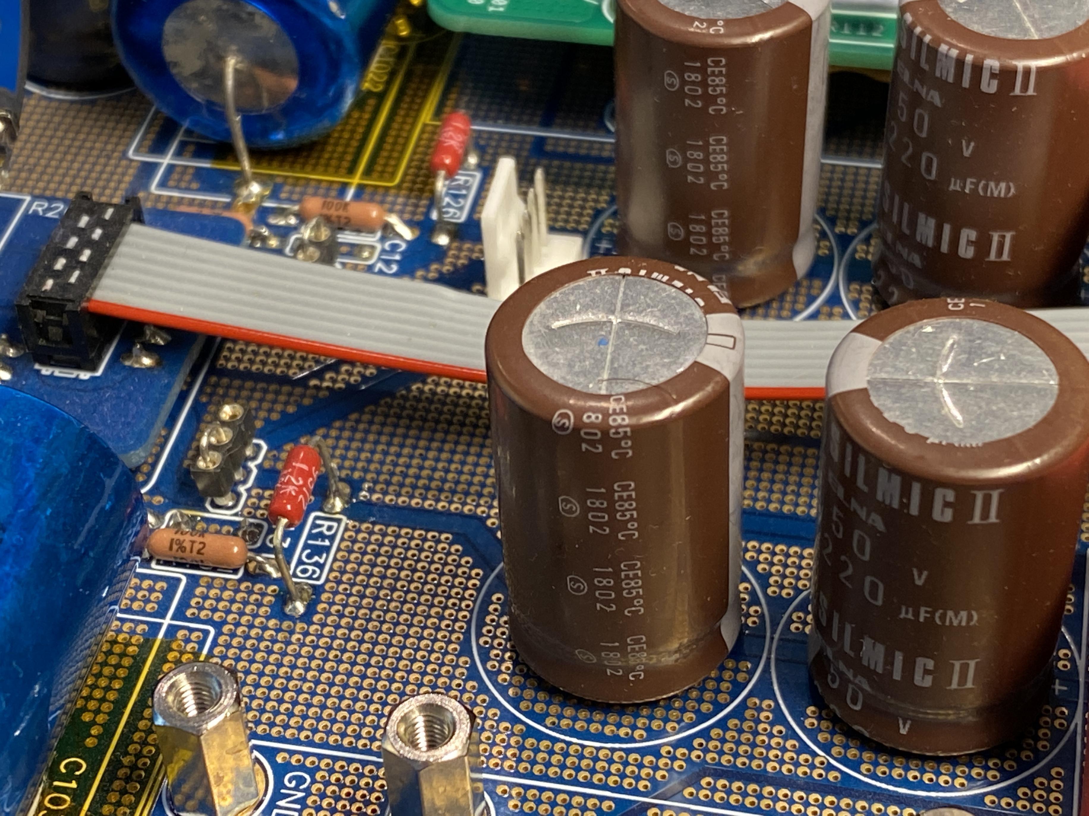

However, I missed having a remote volume control.
So, I decided to add a volume control module inside the existing case. The Muse control I used was a project by member meldano he created a couple years ago. Information on this project can be found here.
As most of you know, there is not much 'extra' space inside the Yarra. Getting everything to fit was a little challenging, but obviously doable. The module requires +-15V, and includes an onboard regulator supplying 5V for the micro-contoller and display. I decided to use a separate supply, with a small toroidal tranny under a DIY'ed faraday cage to help minimize noise.
The meldano project is available in SE output, or using 2 stereo boards - balanced as well. To attach the VC I used one of the small unused PCB included with Yarra kit. That was the simplest plug-n-play replacement and worked effectively.
The display is optional as well.
Below are some pictures of my install inside the Yarra, as well as the finished revised chassis. As you can see, a pretty tight fit of everything.
I polished off the mod with the front panel being 'redone' by FPE to support the display, and my input/ selection text.
With very limited testing in my system - using X's new class D amp, I've been impressed.
I can't hear any noise introduced by the controller, and the volume has 240 steps! One nice addition is, the project uses the ubiquitous Apple remote for volume up/down and mute. Very convenient.

“To attach the VC, I used one of the small unused PCBs included with the Yarra kit” - that was one of the daughterboards? I’d guess - the smallest one?
It’s available in “ available in SE output, or using 2 stereo boards - balanced as well” - for the Yarra, you bought the SE?
Your display looks * very professional
> is optional
A Diyaudio guy (Meldano) also supplied a display? (If not, do you recall where you got it?)
The custom hole in the thick front plate - hopefully/ presumably Modushop could do it? (for extra) so it’s all one purchase. I guess the display comes with mounts, so size the hole for the right match.
Much appreciated :up::up:

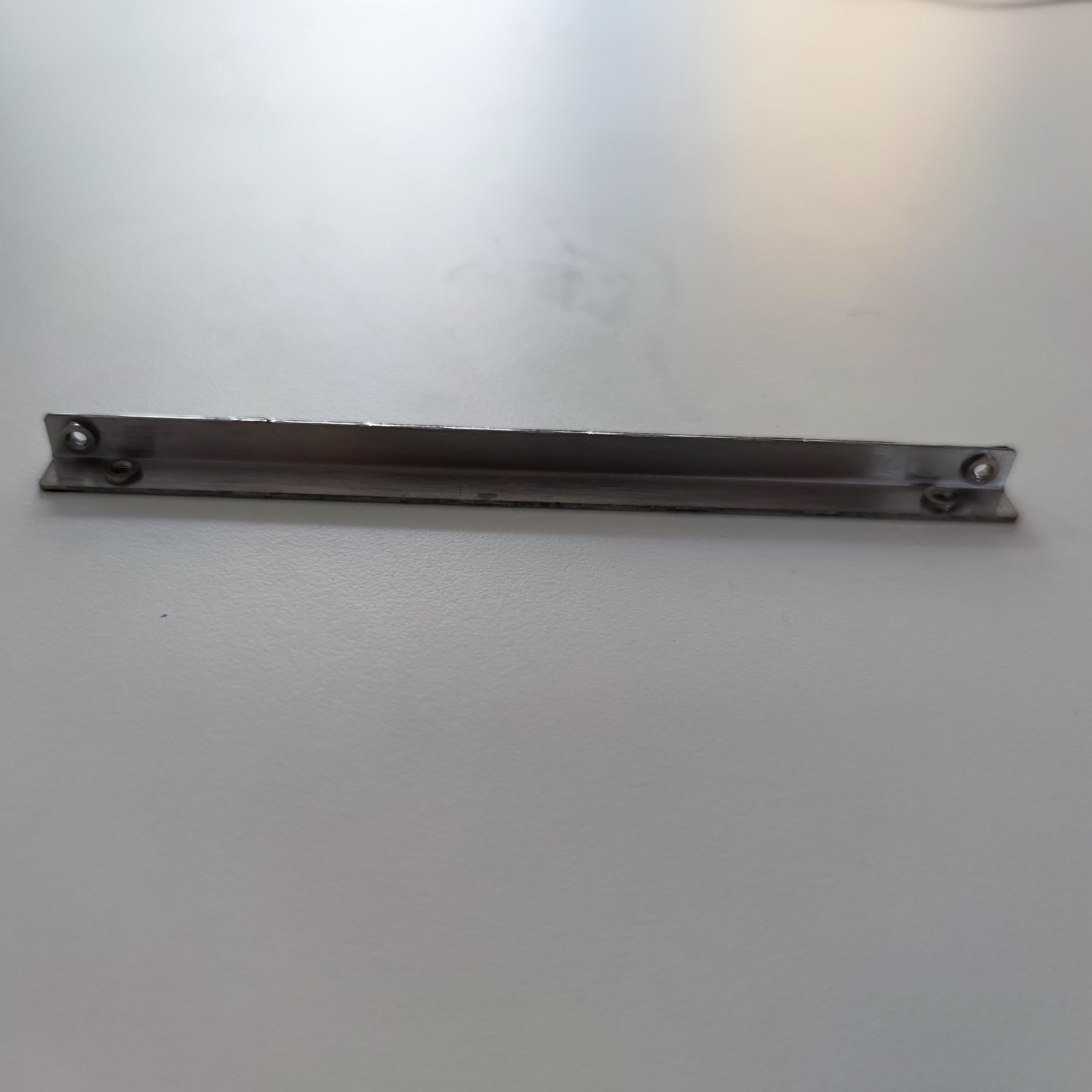

The back plate
- one said the rear I/O board “will also need some center support to avoid flexing”. … only one in 27, so not a * problem, but for such a first class amp - imo solid = good, especially if/ when swapping any * tight fitting leads -
what was the depth & material of the back cover?
- I saw that eg the MANLEY RCA phono jacks just fitted. My approach …
I recall when once looking at an amplifier case with Hugh Dean, seeing its very close sockets required extra care etc - while there was plenty of “spare real estate” he said something like “why don’t they simply space these a little more wide apart”. I agree
If the vertical gaps between the pairs of inputs and outputs, currently ? 5 ? mm were to be say 3 mm more; and the spaces between the four inputs were closer to the spaces between the outputs …
If that then encroached on the surrounding labels/ so the labels then would look not quite right, if it were a hassle to stretch the labels, I would fine with leaving those labels on the right hand size .. off.

The back plate
Yes, we are well aware of this problems as it is concerns other chassis as well. What we usually do is add a "L-shaped" bracket between the edge of the rear panel and of the bottom cover which makes the cover less likely to blend. You can find a picture attached. This would just add a couple of EUR to the final price.
That can be easily changed too :)

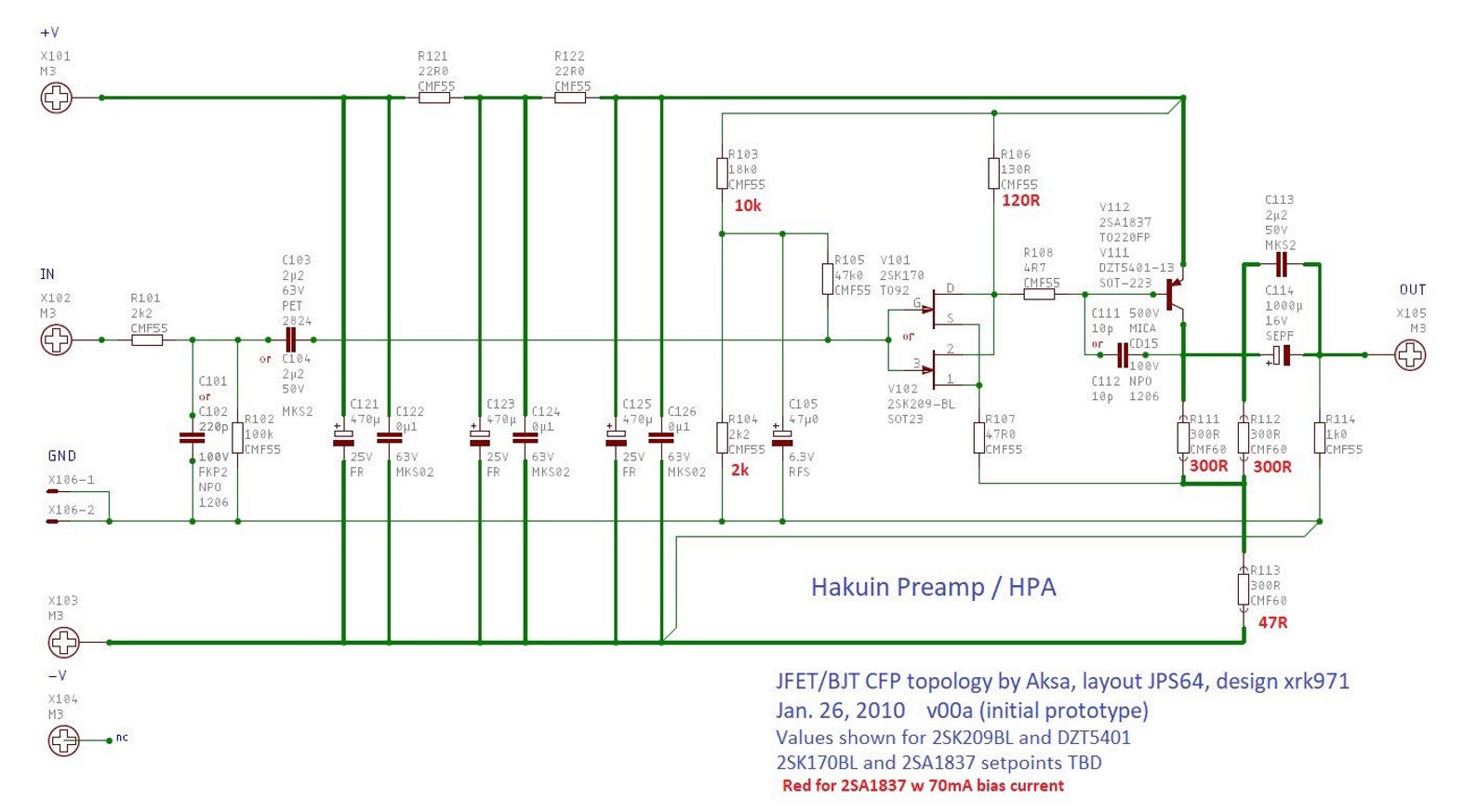

Hello,
Any advice on this?
I'm trying to figure out the correct capacitor values to slow down the DC component (Hakuin-Yarra) without sticking to smooth low frequencies and if I can eliminate any signal passing capacitor, the better.
(Sorry for my low level of the English language)
Greetings!
Founder of XSA-Labs
Joined 2012
Hi Karucho,
When posting specific questions about schematics please post the schematics as I don’t have these memorized in my head :)
738798d1551063707-yarra-preamplifier-hpa-melbourne-db-buy-melbourne-schematic-v1-image-png
So your question is if your selection of main on-board caps of 4x 22uF enough for proper bass extension? You will be installing all AC coupling caps on the main board, 2.2uF in input and two 22uF in series on the output?
The 2.2uF on input is fine. The two 22uF in series gives 11uF only. If you only plan to use Hakuin then back to back output cap is not needed to be bipolar. Just use one (+ve facing the Hakuin output) and put a jumper in the second.
A single 22uF will limit your bass extension for a headphone load of 250ohms to 30Hz, but probably ok for a preamp driving an amp. Let’s assume your load that you are driving is 10k ohm.
The -3dB cutoff frequency of a 1st order high pass RC filter is 1/(2pi R C). 1/(2pi x 10kohm x 22uF) = 0.3Hz. I usually will go two octaves up to see where it starts not being flat. So I get 1.38Hz for -3dB and this is good down to 5.5Hz. But, if your amp is input lower you may notice some loss of bass. If you used them back to back, then it would be 11Hz.
I would go with at least 47uF output cap, single not back to back.
Hope that helps.
Hi X, I am sorry I did not publish the scheme, you are absolutely right.
Thank you very much for the explanation and I don't know if my hard brain has understood it ...
In the yarra scheme that you have published and speaking only of one channel "in left":
C1022 / 122/123/1023 -------- 2.2uf Capacitor quality
C126 / 127/128 -------- 47uf Elna Silmic
In DB Hakuin's schematic:
C103 / 104 --------- 2,2uf Capacitor quality

Hi Karucho,
My Yarra preamp is strictly for line level use, no headphone usage at all. So all my daughter boards are built with this in mind.
I have my Hakuin boards currently installed. Since the Yarra motherboard already has all the input components and a large area for a nice PP capacitor (at least 4.7uF size), they need not to be duplicated on the Hakuin DB’s. Same for the output caps. Back to back 220uF Silmic II’s with a Wima PP are installed on the main board. Eliminate the 1000uF cap and replace with a jumper on the Hakuin. Keep an eye on your input psu voltage, use the Hakuin CRCRC R121 and R122 to fine tune your working voltage.
Change the bleed resistors R126/R136 to 1K2 or similar on main board.
The Toshiba loaded Hakuin’s sound very good!
:cheers:
