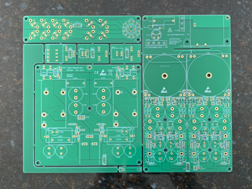

Hi folks,
The order for the Yarra board set just arrived and I can begin shipping the orders for all of you have placed orders on the past couple of weeks. This board has the issue of some orphaned ground pads on the input/output board fixed. Another beautiful masterpiece in layout by JPS64. Thank you, JP!

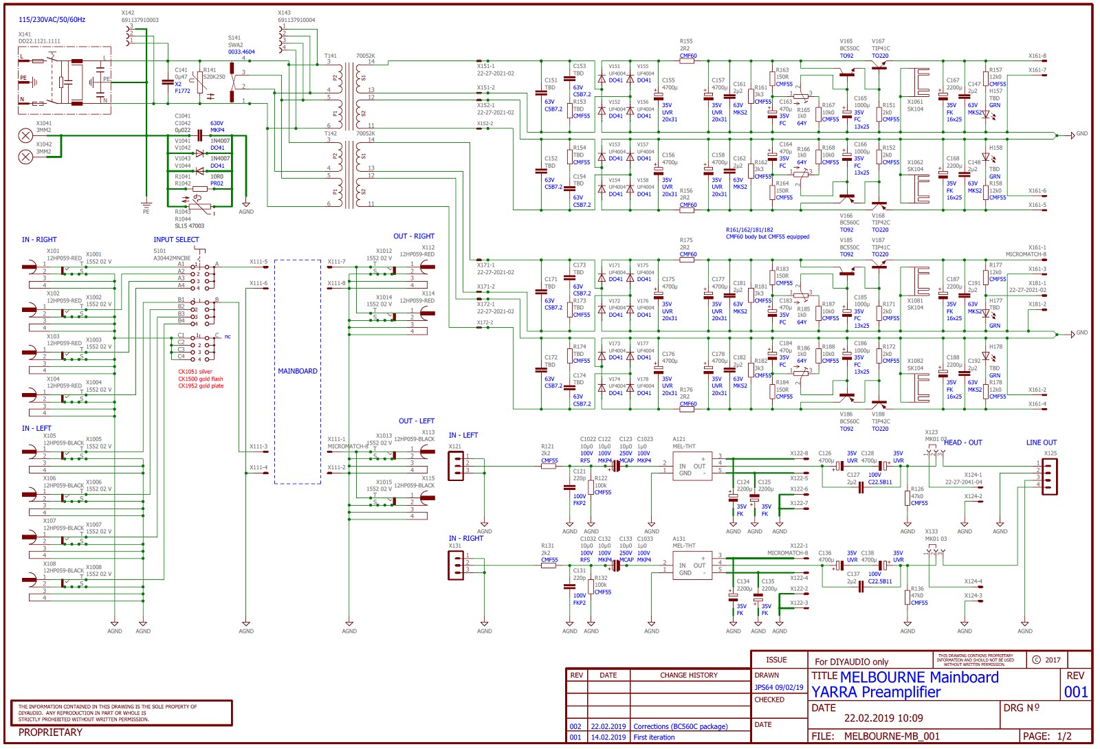

I am finishing my order for the Yarra / Hakuin components and I have a question on the Yarra board. These are capacitors C151 / 152/153/154 (150nf chosen value and 63v) ... But what type? I can't quite understand the reference "C5B7.2".

Excuse my ignorance ... I have the Talema 700K52 12v + 12v transformers and I don't think I get beyond 18v at the output of the Yarra power supply (I don't have a pcb yet). The Hakuin plate whose voltage recommendation is 24v will be fed ...
Will 18v (Talema 12 + 12v) be enough? Should I connect a jumper across the transformer output (serial output) to get 24v?

I was thinking of putting the amp modules in the amp prior to the amp board. Looks like that may not be as easy as I first thought. I have the WBA18 and the melbourne boards so far to try this once I build them out. I have a few questions. Most of the amps will have +/- 24V rails.
Which boards require coupling caps?
What are the voltage ranges required or acceptable for each board?
How much gain?
Is the gain adjustable?
I would like to try them all, but it appears that some will require a voltage adjustment or or coupling caps.
The will all work on +/-24v or +24v. The single ended ones can be discerned by single rail supply (PCA, Hakuin, Korg 6P1, H2) and these need coupling caps. The ones that are dual rail (Melbourne, WBA18, ACP+) don’t need coupling caps on the output. I highly recommend caps in the input in all cases. The Melbourne and ACP+ can run up to +/-30v. The WBA18 might be able to also, although you might want to decrease the bias current on the outputs. Same with the ACP+.
Gain on Melbourne by default is 22dB I think. The PCA and Hakuin are around 12dB to 15dB. They can all be adjusted of course but some will take some theory or use the LTSpice simulator.
