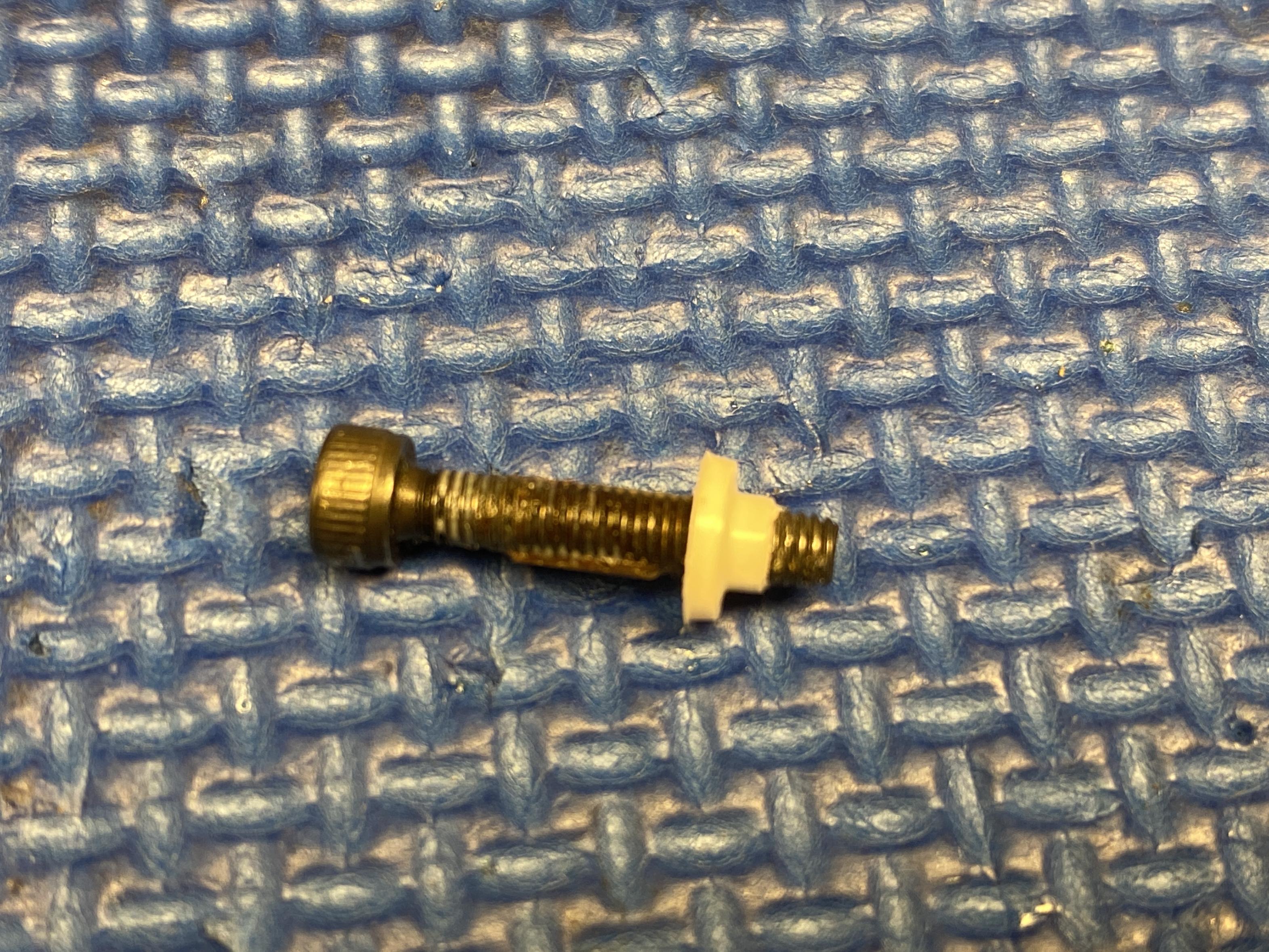

Thanks for confirming this. I have now managed to get the parts off. Will add nylon washers and non conductive thermal pads as per your advice.
I think I’m going to reorder some new transistors as I feel I’ve subjected them to too much heat as getting them off was a real challenge. This time round I will forego using Loctite and will nut and bolt them instead so removal will be easier should I screw up again. I was concerned that I’d end up lifting a PCB trace but is seems those boards are very well made and very rugged, kudos on a quality product.

Please make sure to use a nylon/plastic shoulder washer to attach the transistors to the heatsink, not a flat washer. There could still be a chance the threads on the fasteners can touch the metal tab and short.
Your BJTs are probably fine because the short went from collector to ground and not through the junction. But they are inexpensive and may be wise to replace. A good practice is to always use a conductivity meter (beep mode) to check the tab of a transistor or mosfet to make sure it’s not conducting to the heatsink. Rarely is this ever done on purpose. Sometime a small metal burr in the threaded hole can poke through the silicone sheet and short out a transistor. This happened to me once and blew the BJT and the driver transistor. It was a mess to replace.

I've just ordered some nylon shoulder washers from eBay as well as some hardware to fix them in place.
Re checking conductivity I will certainly do this in the future, today was a good lesson. I've spent the best part of 8 hrs checking the board looking for the fault, learning about NPN vs PNP and re reading this thread looking for clues. As a complete amateur when it comes to board stuffing and building something like this it all seemed to be going too well...

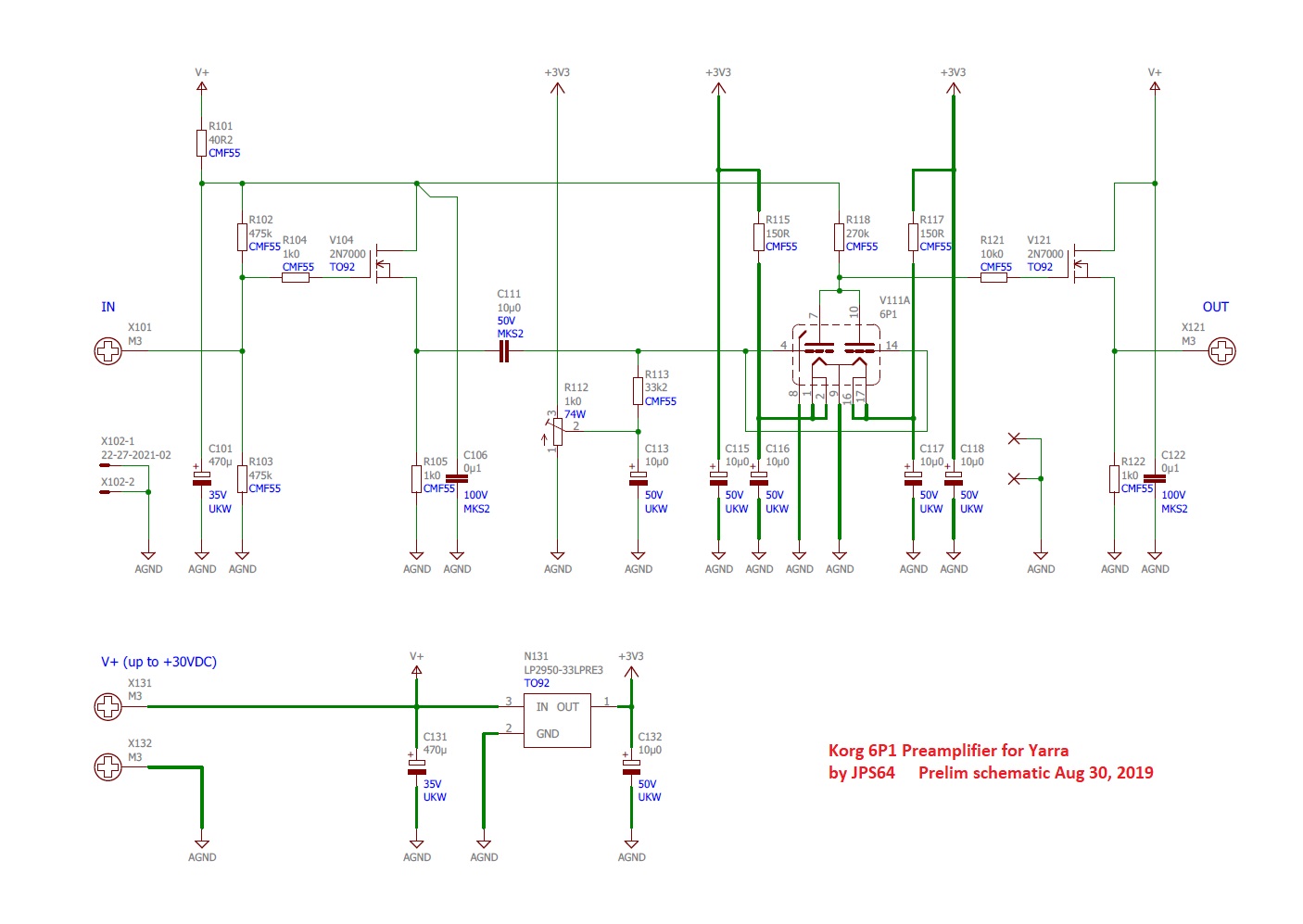

It’s based on the design described here:
Nutube 6P1 Buffer PCB
Gain is 6x (15.6dB) and supply is 12v, so I would imagine max output is probably maybe 10vpp or 3.5vrms? But I would keep it well below that to keep distortion down. Maybe 2vrms?

It might work but probably not optimal as designed. If someone could redo the spice simulation and redo the output MOSFETs it could work. It just takes some design time and verification with a test build. That’s where your DIY abilities come in. 🙂
If we make the V+ input say 24v, the voltage regulator can still reduce that to the amount needed to power the Nutube 3.3v, the pot would have to be adjusted differently for a grid voltage of 12v but the drain on the output MOSFET could be higher. This might allow more swing. It just needs to be tested. It might be as simple as that. If anyone has ability to measure what the maximum output swing is that would be great. I don’t have it setup currently to try out.
You could probably get 18vpp with 24v input. That’s about 5w rms into 8ohms.

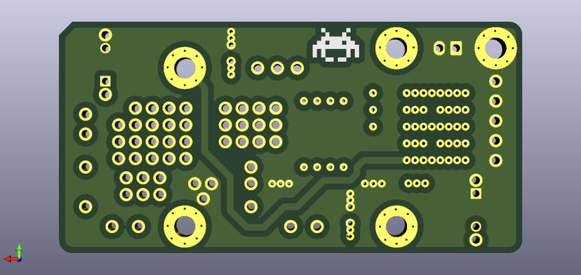

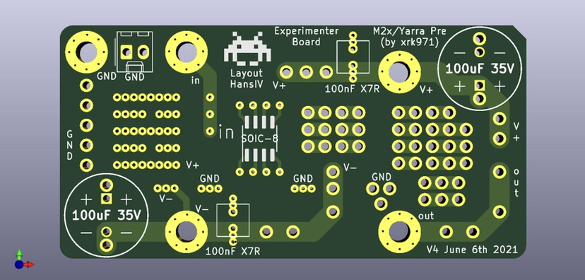

Member Puijkh made a slick little Yarra/M2X format Experimenter’s breadboard:

This could be really handy.

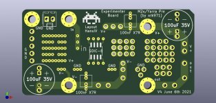

I have an M2X/Yarra format breakout board that is ideal for experimenting or making a compact preamp if you want to use your own PSU.
M2X/Yarra Format Breakout Board
Example of it being used to make a standalone ACP+ preamp:
Your choice of screw terminal blocks or Molex KK/JST connectors - you can go wild!

I like your breakout board. Since I am doing monoblocks, I would probably end up making a board for each channel. I was thinking it would be handy to use before an F4 or a MoFo which don’t have connections for the Yarra boards. I am trying to avoid a separate preamp. Just run directly from my DAC which has volume control and basic preamp capability.
