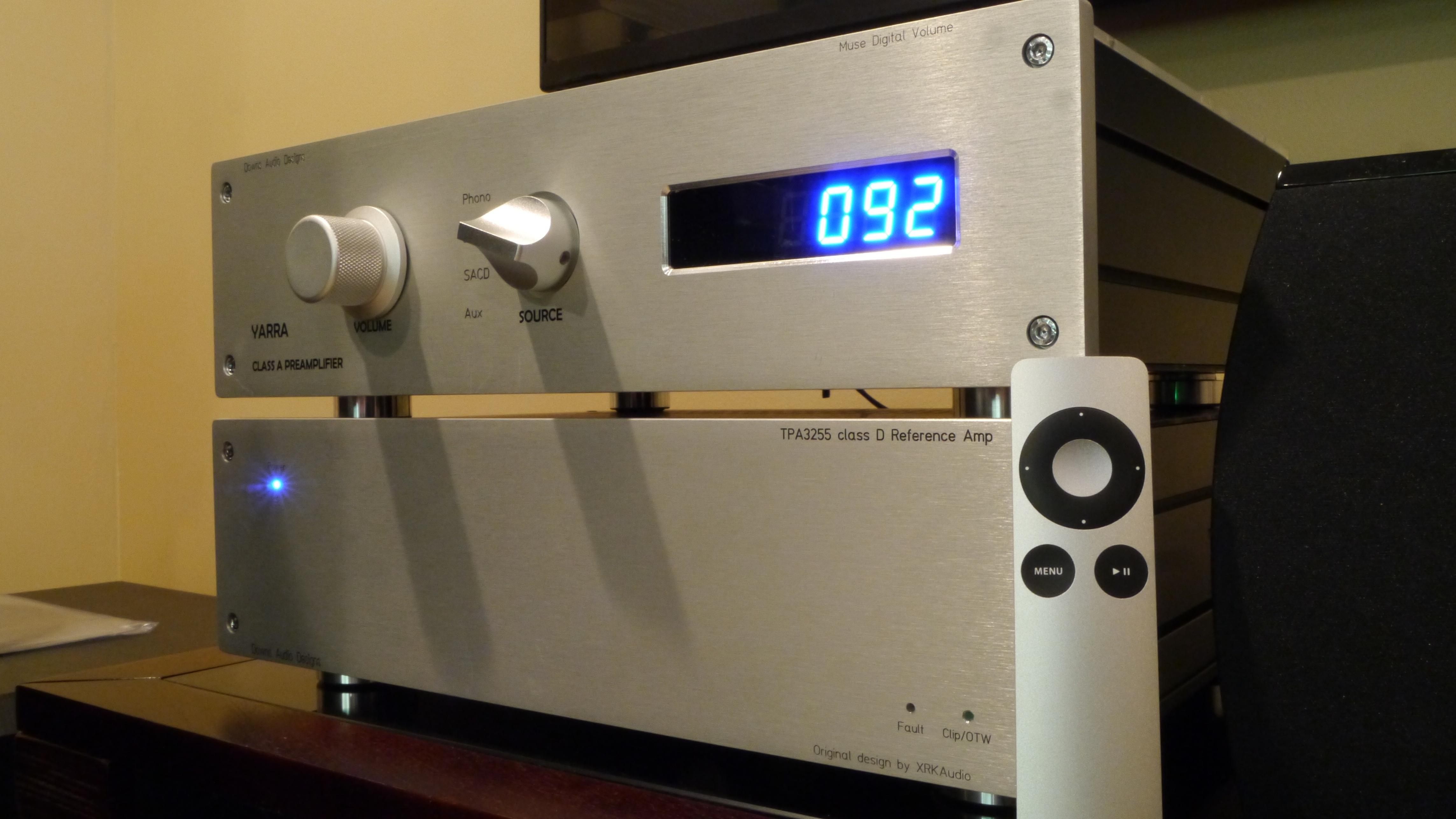

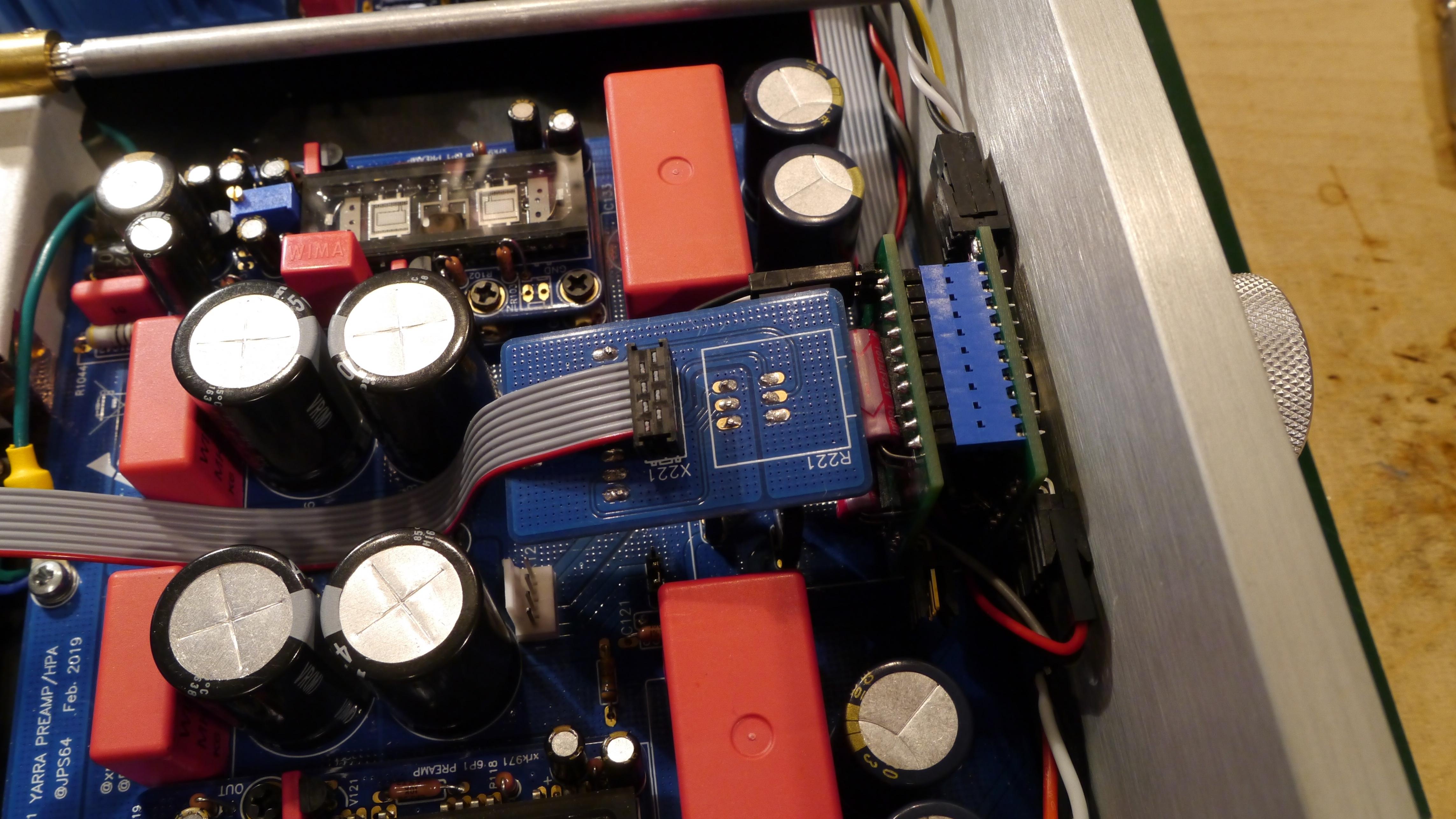

Yarra Muserized

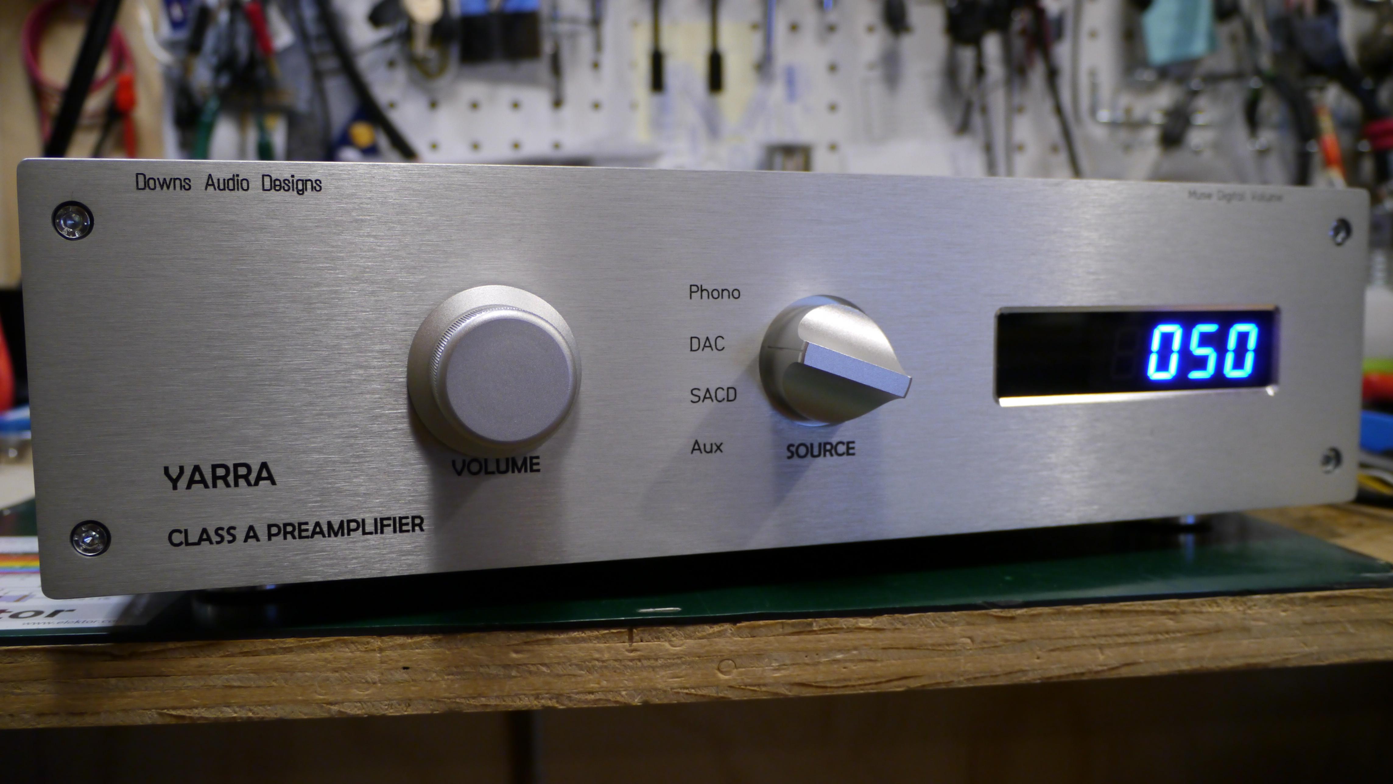

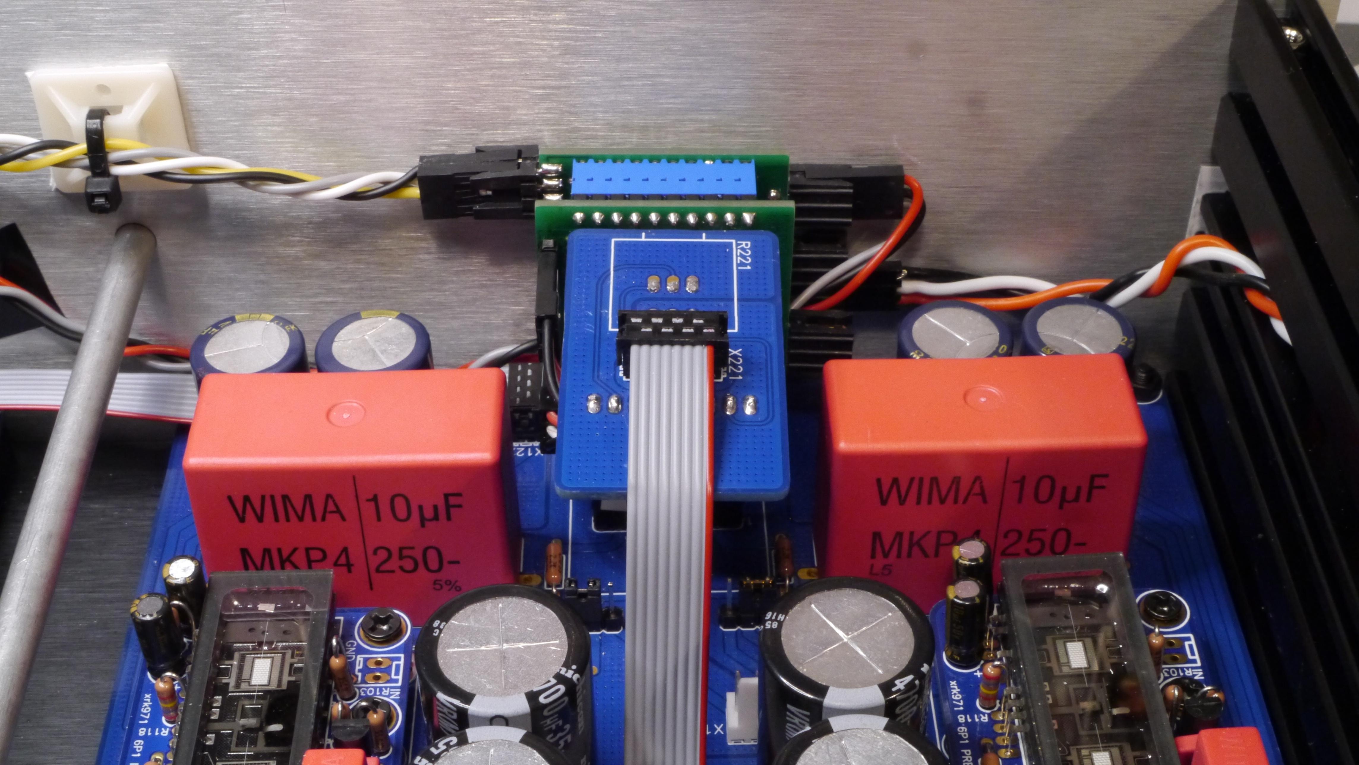

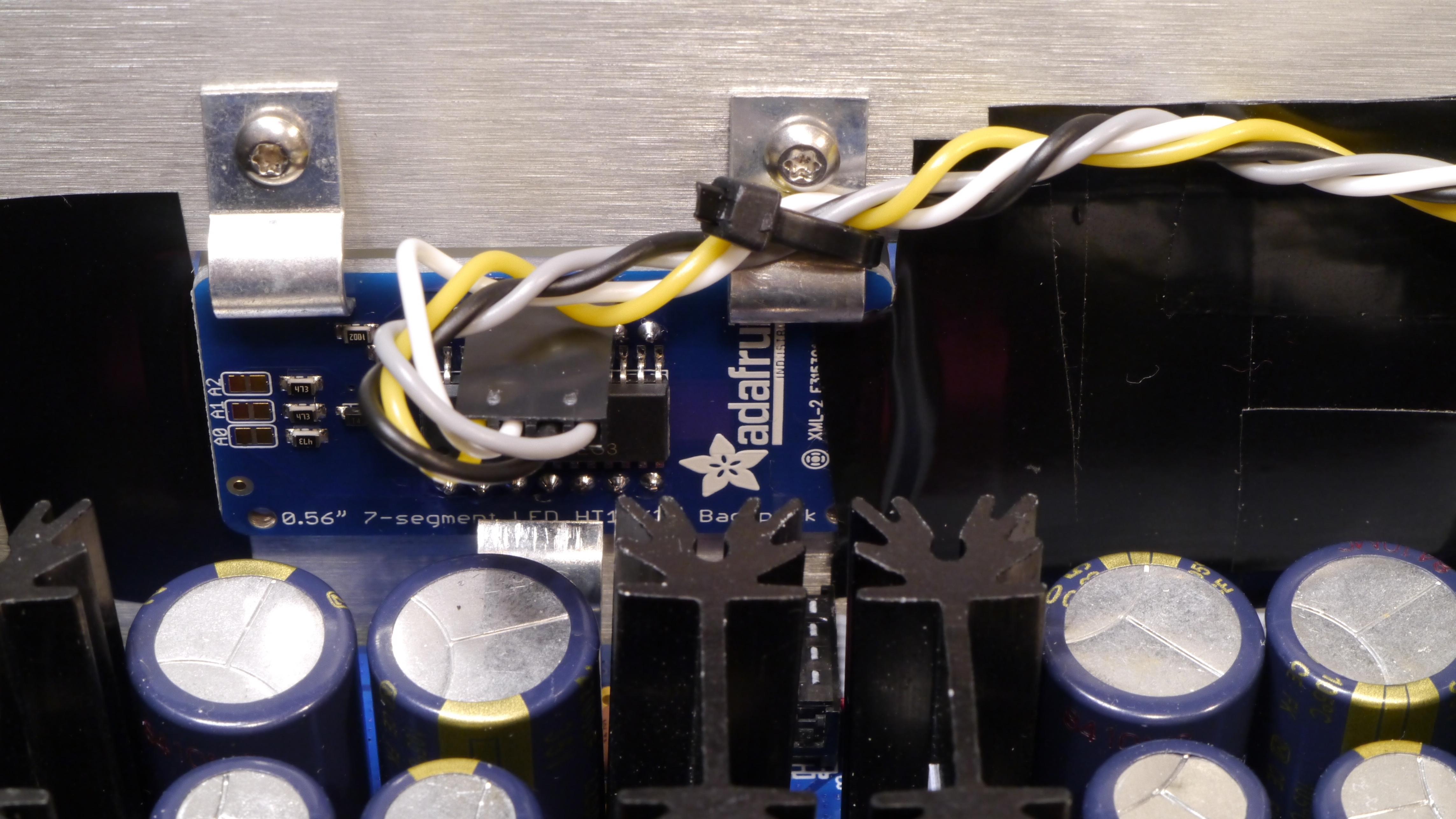

I built the Yarra pre about a year ago. It is a beautiful sounding pre with customizable modules. However, I missed having a remote volume control. So, I decided to add a Muse volume control module inside the existing case. The Muse control I used was a project by member meldano he created a couple years ago. Information on this project can be found here.
As most of you know, there is not much 'extra' space inside the Yarra. Getting everything to fit was a little challenging, but obviously doable. The module requires +-15V, and includes an onboard regulator supplying 5V for the micro-contoller and display. I decided to use a separate supply, with a small toroidal tranny under a DIY'ed faraday cage to help minimize noise. The meldano project is available in SE output, or using 2 stereo boards - balanced as well. The display is optional as well. To attach the VC I used one of the small unused PCB included with Yarra kit. That was the simplest plug-n-play replacement and worked effectively.

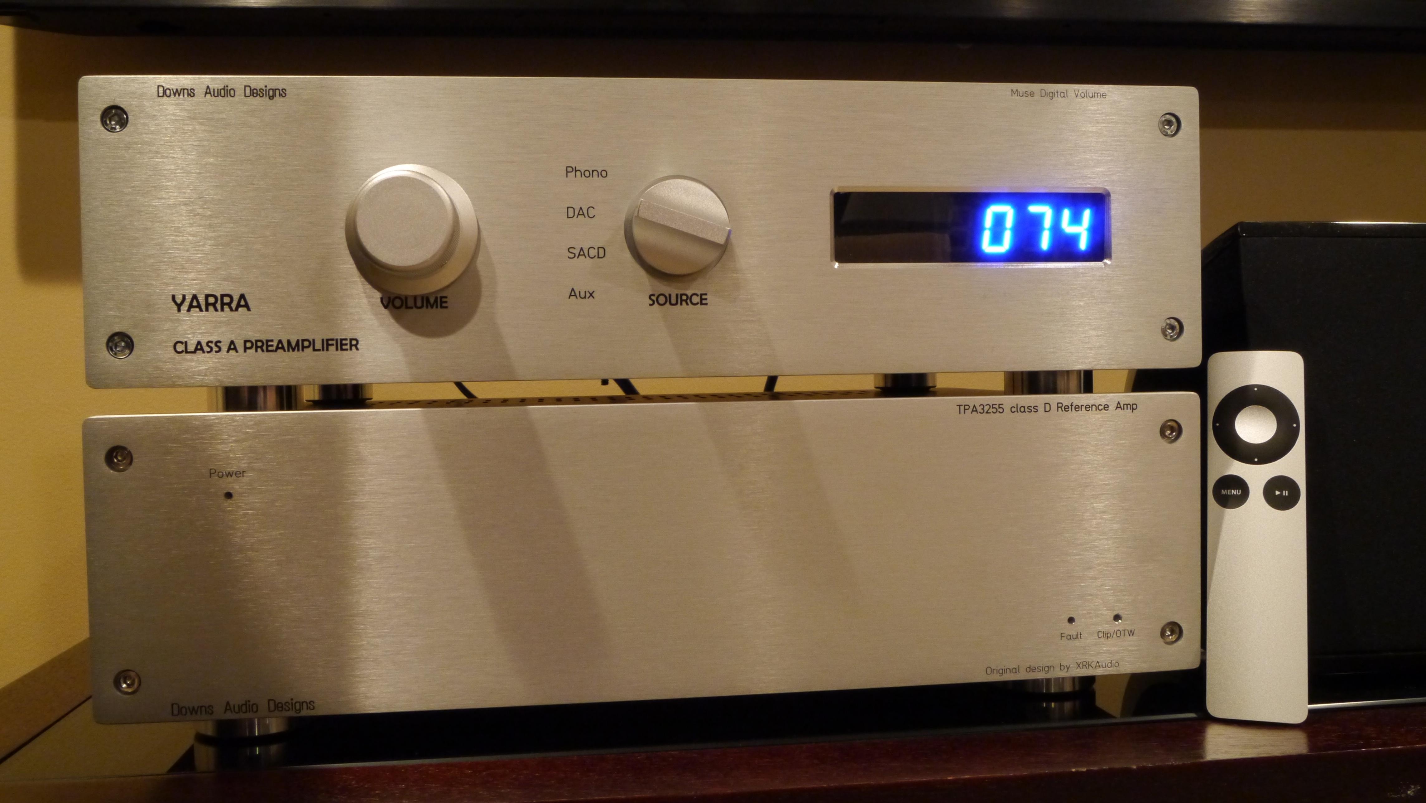

Below are some pictures of my install inside the Yarra, as well as the finished revised chassis. As you can see, it was a pretty tight fit of everything. I polished off the mod with the front panel being 'redone' by FPE to support the display, and my input/selection text.
With very limited testing in my system using X's new class D amp, I've been impressed. I can't hear any noise introduced by the controller, and the volume has 240 steps! One nice addition is, the project uses the ubiquitous Apple remote for volume up/down and mute. Very convenient.

Fantastic work Redjr!
It is a tight fit, but you squeezed it in just fine.
I’ve been interested in the same volume control, very good to know the Yarra stays quiet with the additional circuitry.
Thanks for the kind words. It was a fun project, and turned out the way I had intended. I hope there's not too much noise banging around in there, that may be affecting the pure audio signal. Now I can adjust the VC from my easy chair! 🙂 The nice feature of the Muse is that you simply wire it in-place of any normal analog volume control. That makes it easily adaptable to just about any pre, or amp. As I mentioned, the little VC PCB's that came with the Yarra made it super simple to adopt.

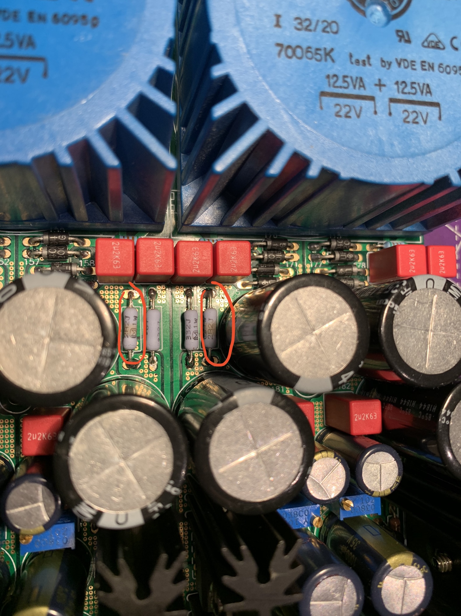

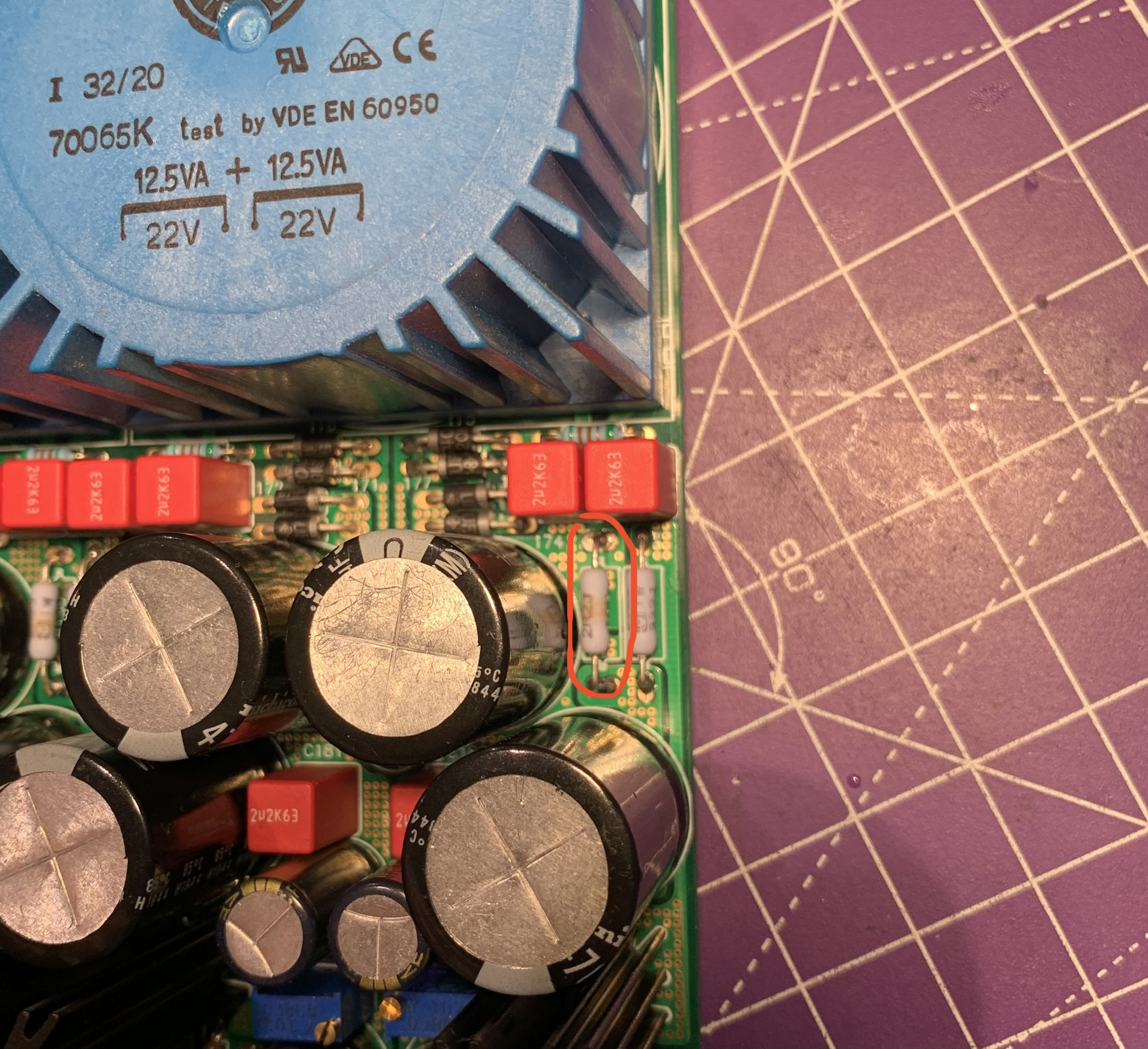

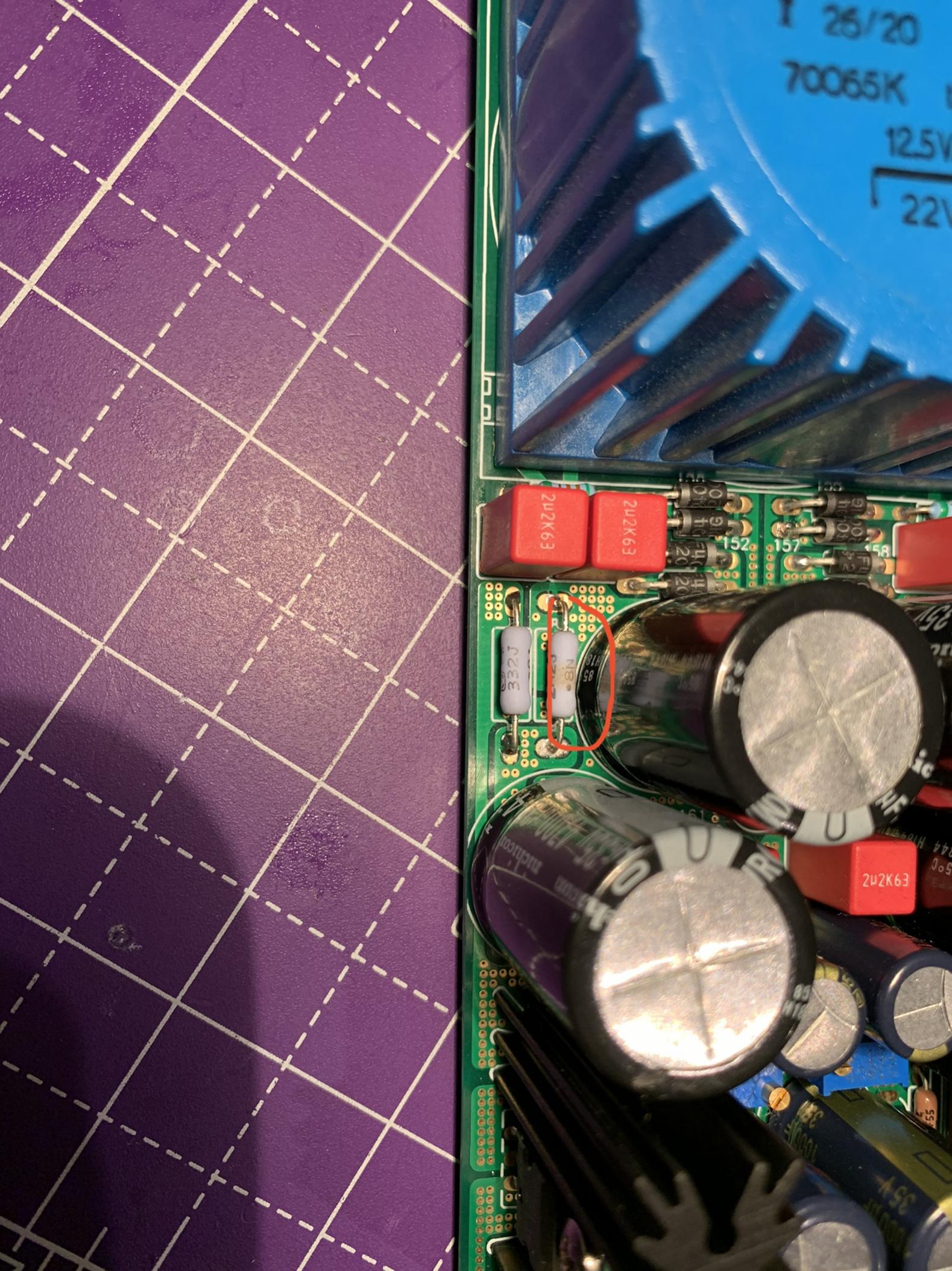

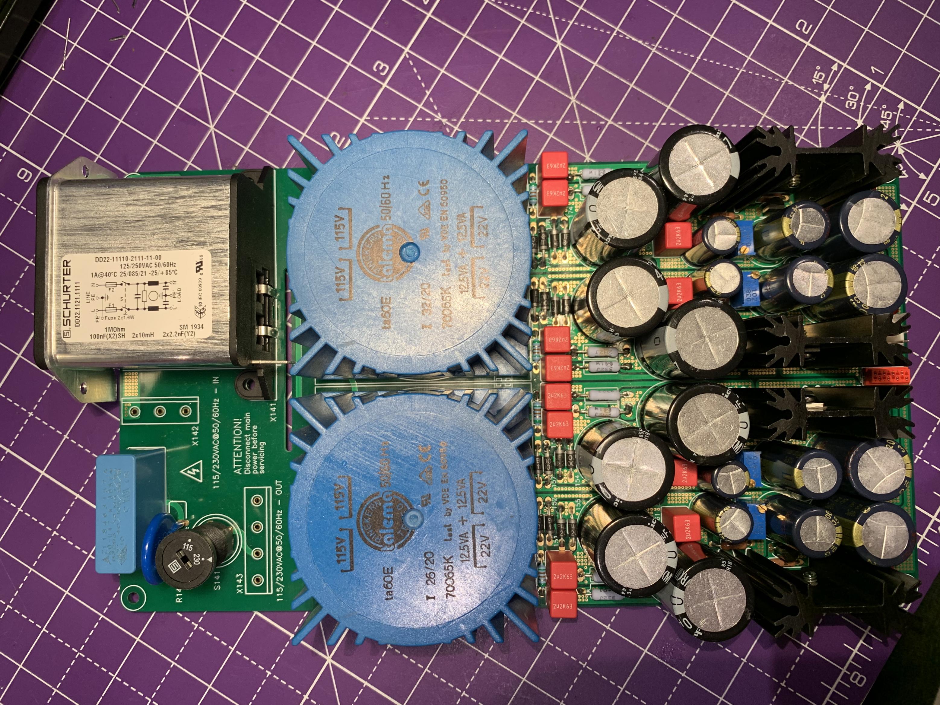

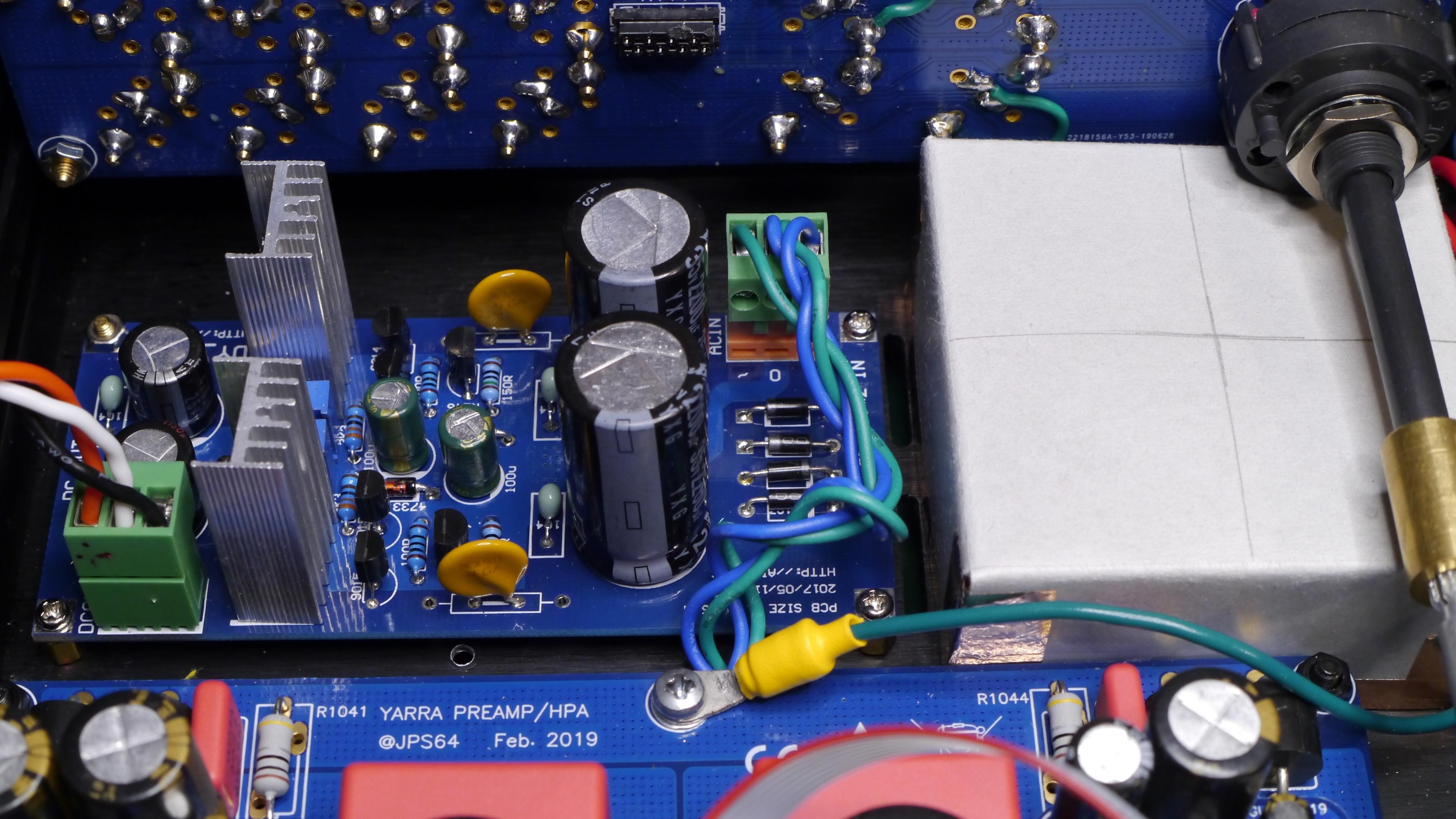

I’ve just finished the power supply for the Yarra but when I powered it on its smoked a little from the resistors R155, R156, R175 and R176, I used 2.2 ohm 1w Panasonic resistors.
I switched it off immediately so hopefully I haven’t damaged anything else. The unit was built using the BOM created by Vunce and I triple checked the component values against the schematic but the WIMA caps were TBD but I thought I’d picked the correct ones for the 22v Talema, I’ve used 2.2uF 63v WIMA film caps. Have I made a mistake with the cap selection for C151 - C154 / C171 - C174?
Hi Stuntfingers,
Sorry you are having trouble. When a series resistor of a CRC smokes, something downstream is shorted. What is the resistance of the downstream lead with respect to ground? It should not be in single digit ohms.
Couple of things to look for:
1. Solder bridges between the traces with exposed vias.
2. Incorrect BJTs installed (NPN vs PNP) in the cap Mx.
3. Reverse polarity on the electrolytic caps.
If you can remove the connections leading to the large TO-220 BJT's, then you can debug safely. The DC voltage at that resistor should be as expected 1.41x 22v = 31vdc under no load.

Thanks for the reply. Having gone over the board I have found the following:
1. No solder bridges
2. Correct BJTs installed
3. Caps have correct polarity.
I have checked the downstream leg of the resistor (R155 for example) and get zero resistance to GND when using the heatsink as GND reference, same happens when checking the LED.
I see most of the builds show the transistors thermally coupled but electrically de-coupled from the heatsink. I used thermal paste and have electrically coupled the transistor tab to the heatsink, is this my problem?

That’s your problem: the collector is the tab so you have your wires from the CRC connected straight to ground. Always use insulator silicone spacer sheets and nylon shoulder washers with metal tab transistor packages.
If you have a hot air pencil/gun try pre-heating it from the bottom with the hot air and then using a thick chisel tip iron with a lot of solder. Alternatively, leave the heatsinks and heat only the pins of the BJTs and pull them out.
