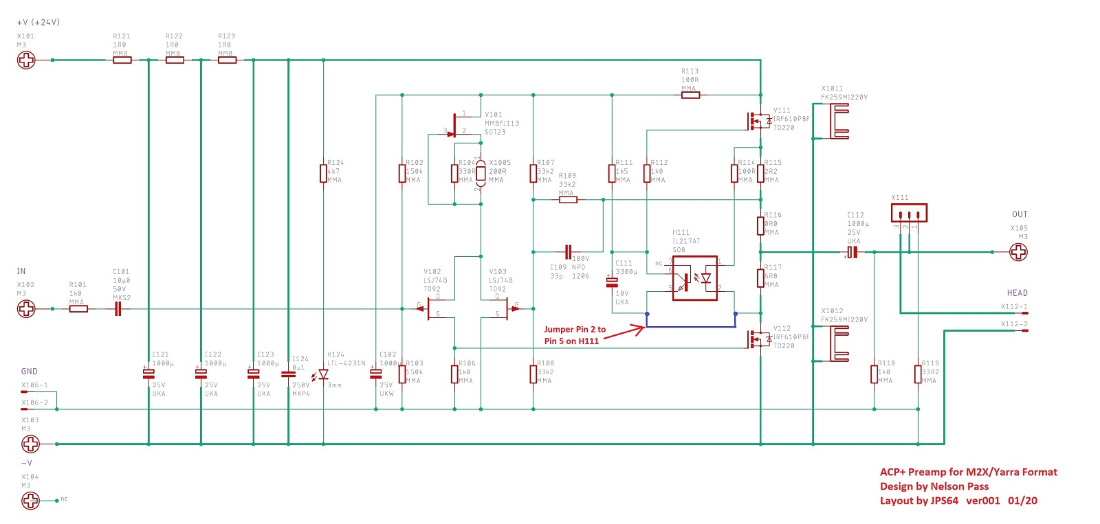

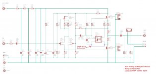

Here is the BOM, as built for the ACP+ board.

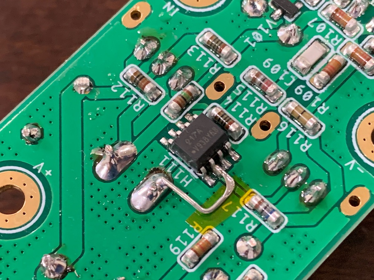

This prototype board has a trace error - you need a jumper at location shown on schematic:
attachment.php
Here is how I did the jumper:
attachment.php
