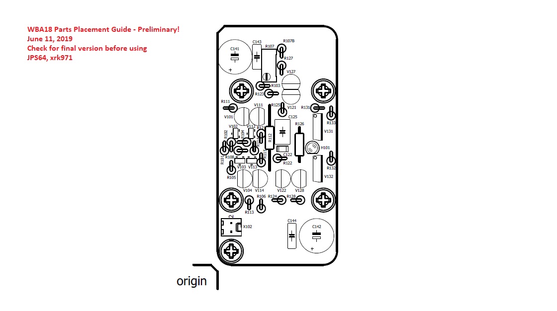

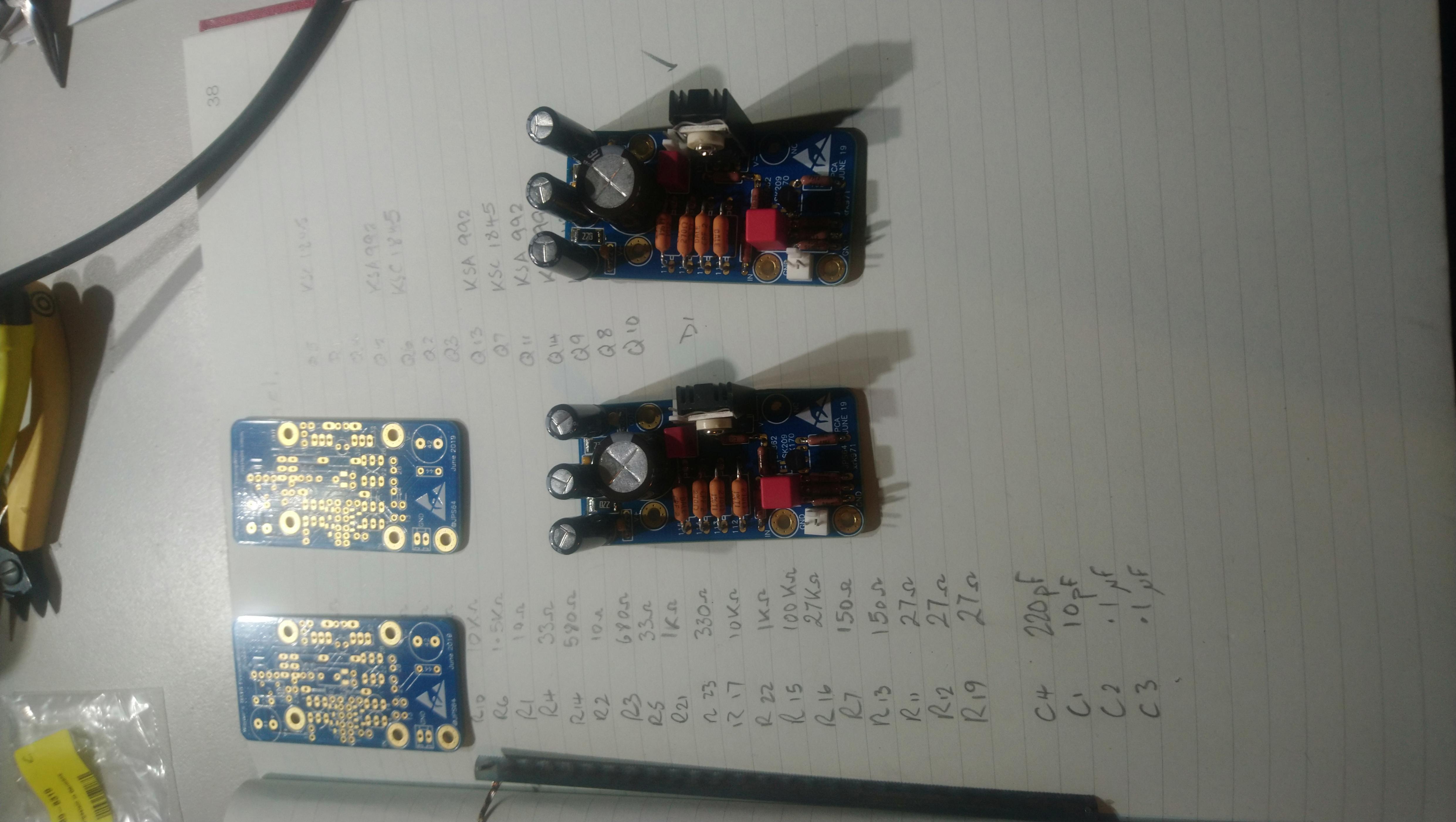

PCBs arrived for the WBA18 and PCA daughterboards, just need to sort a BOM for them.
I have some matched pairs of 2SK170s so will use them.
Awesome PCBs, I must admit looking at them I have no idea how to go about finding parts and where they go, I was expect idents such as R1, C3 etc, but there are just numbers.
Is there a parts list and a diagram of what goes where?
please.
please.
Batty, the boards are so small that JP left the C or R off to save space. It’s pretty obvious what part is an R or C or V. But you should use the stuffing guide that is provided as it show orientation of the standing resistors. WBA18 one is here:
The YARRA Preamplifier/HPA for Melbourne DB Group Buy
There is one for the PCA somewhere in this thread too. Just need to look. I never got a chance to put a link in the first post yet.
BOM for PCA is here but the large source resistors need to be changed:
https://www.diyaudio.com/forums/gro...fier-hpa-melbourne-db-buy-64.html#post5827525
The test build was here:
Change to use either two 2w x 270ohm resistors or some other combo that is about 135ohms and can dissipate 1W. You have lots of choices. Four 0.5W 560ohms also work.

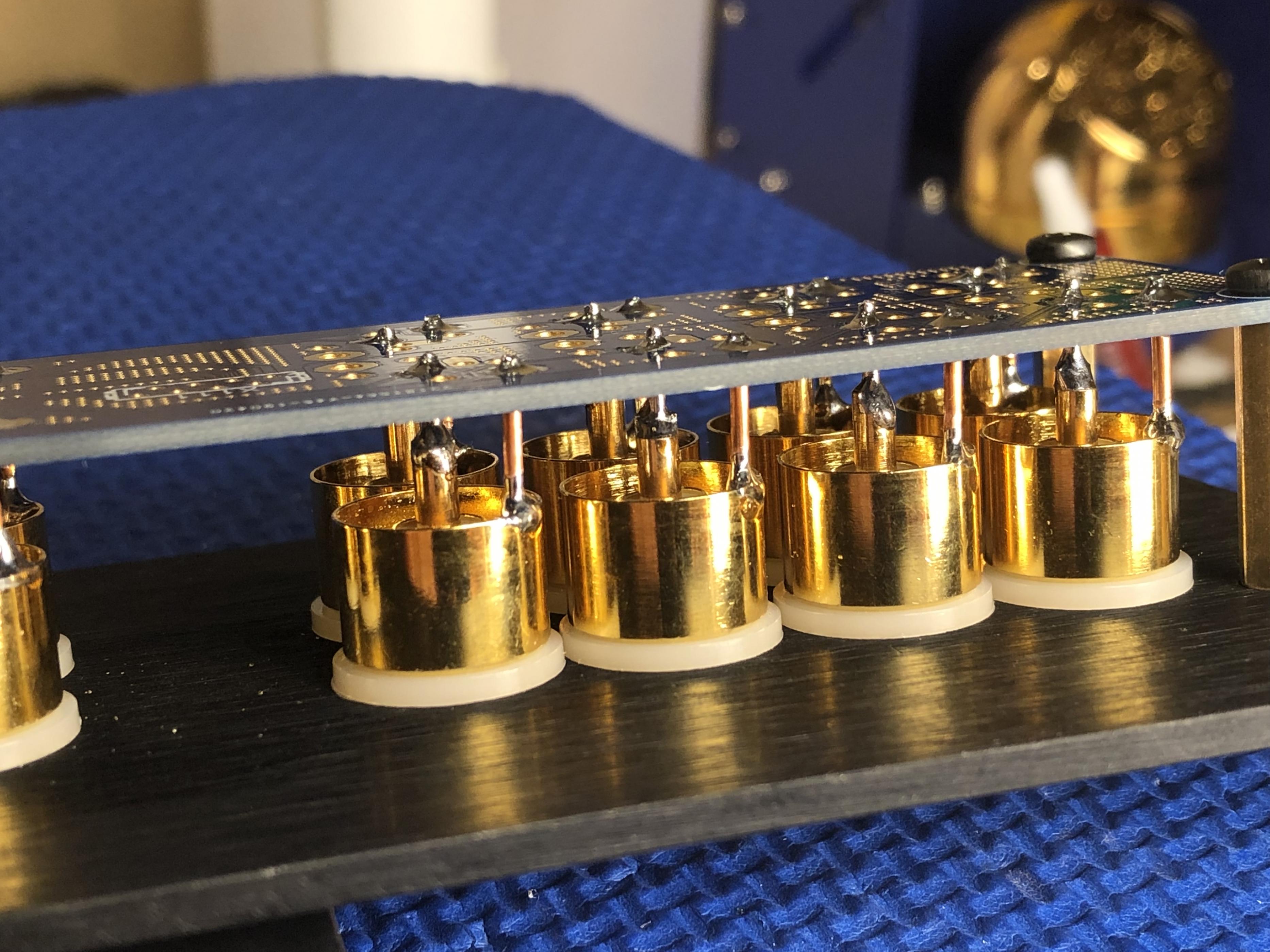

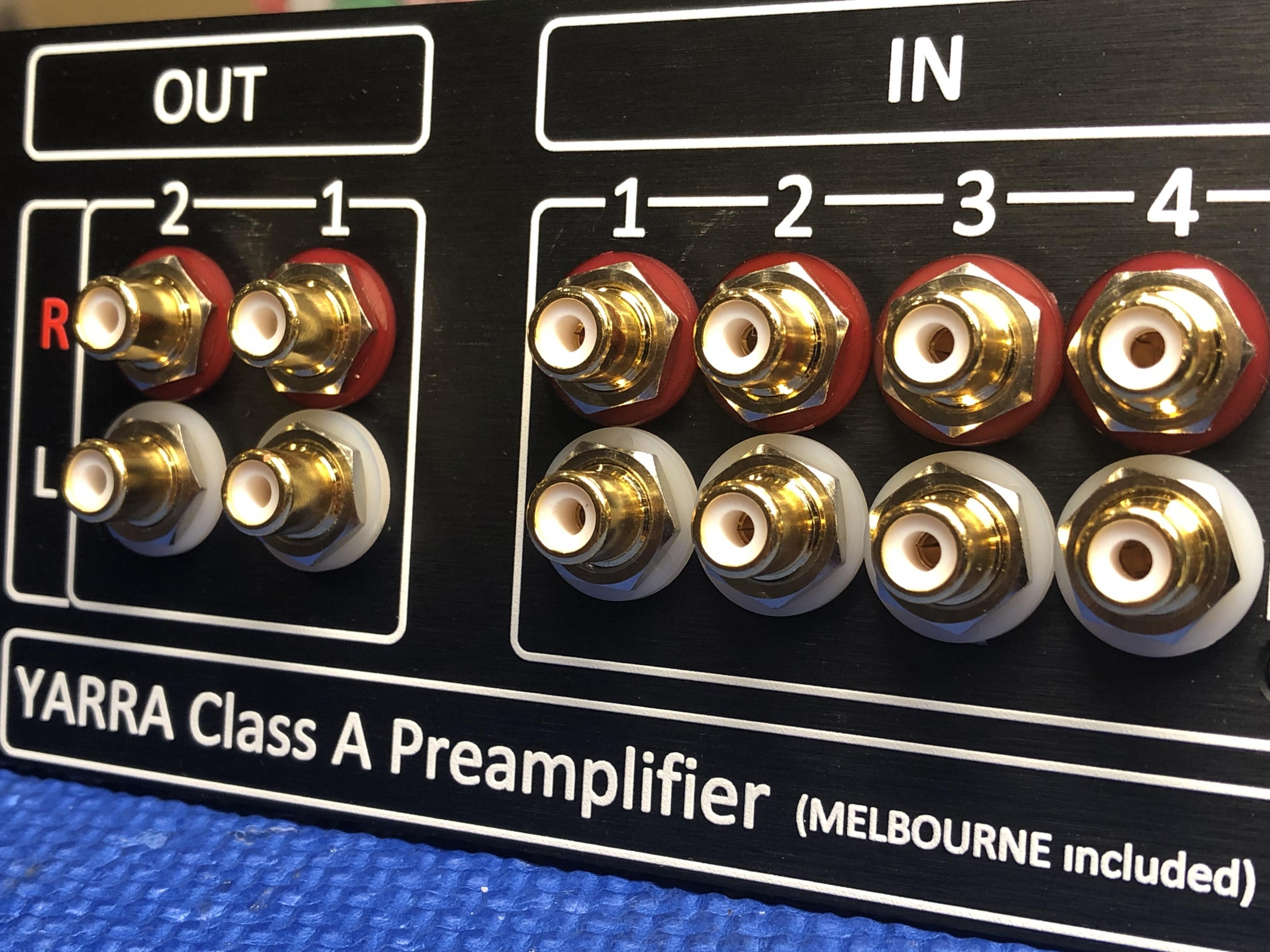

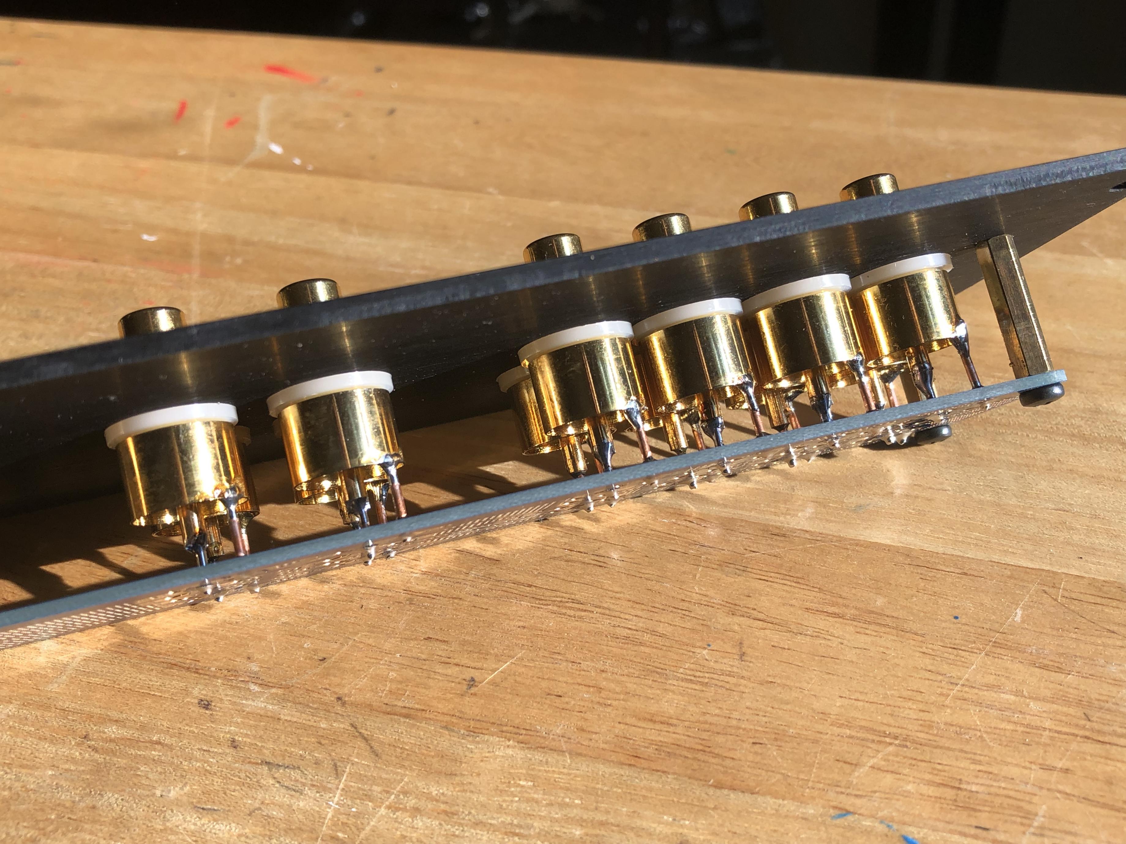

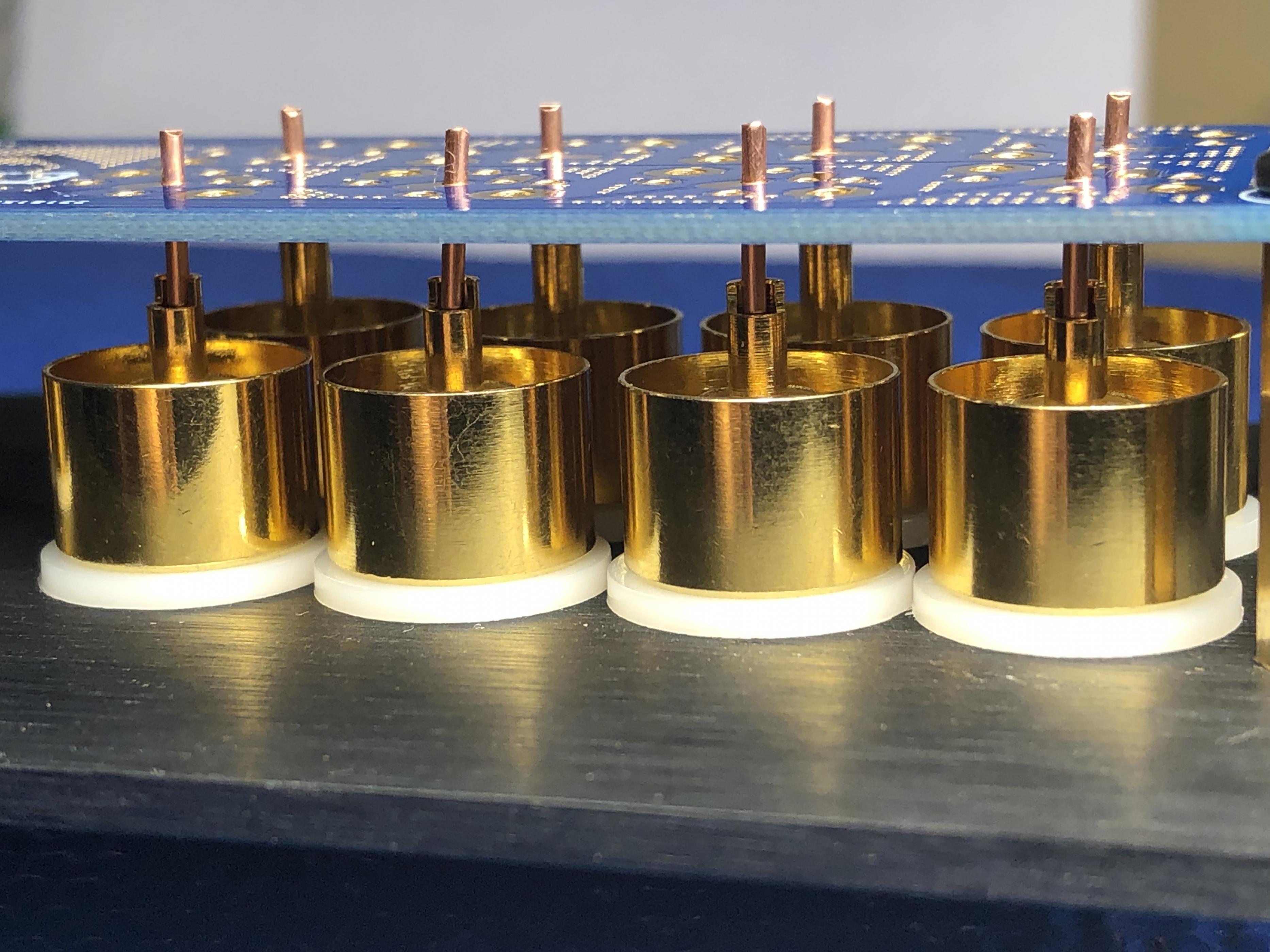

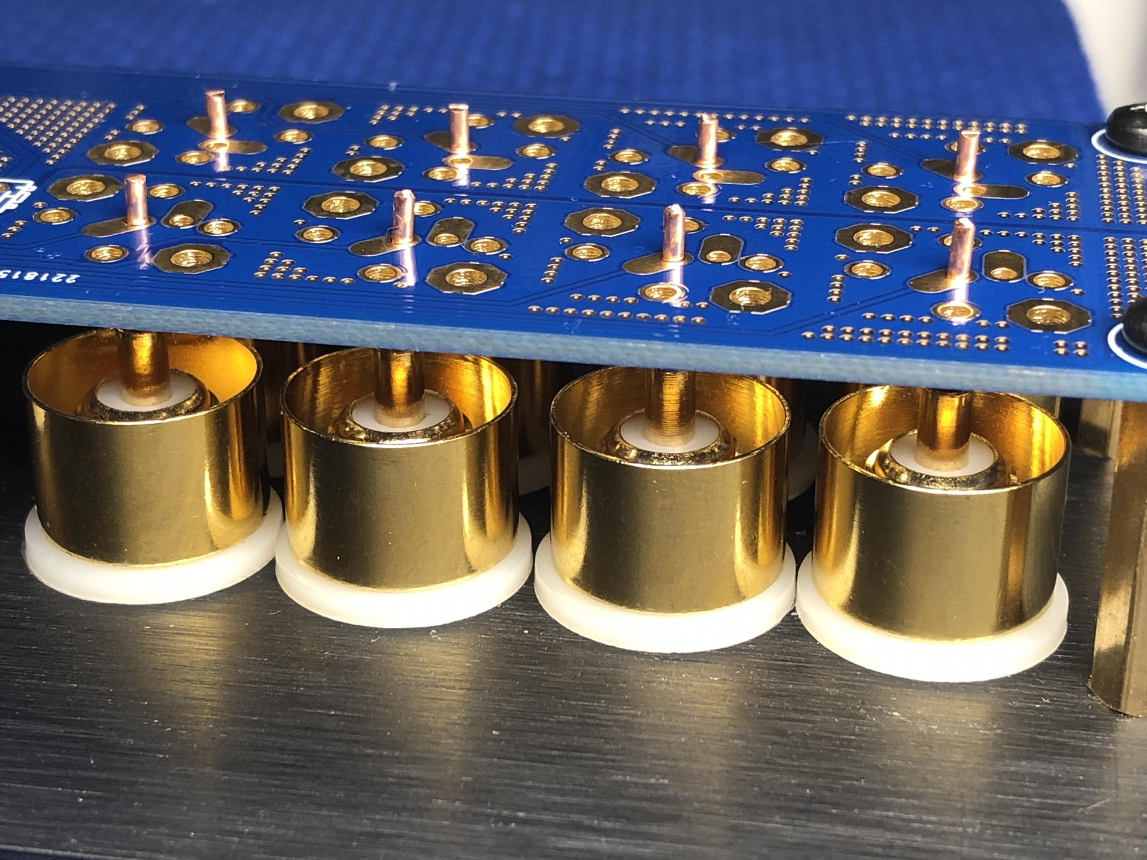

I had some time last night to work on my Yarra ‘s rear panel.

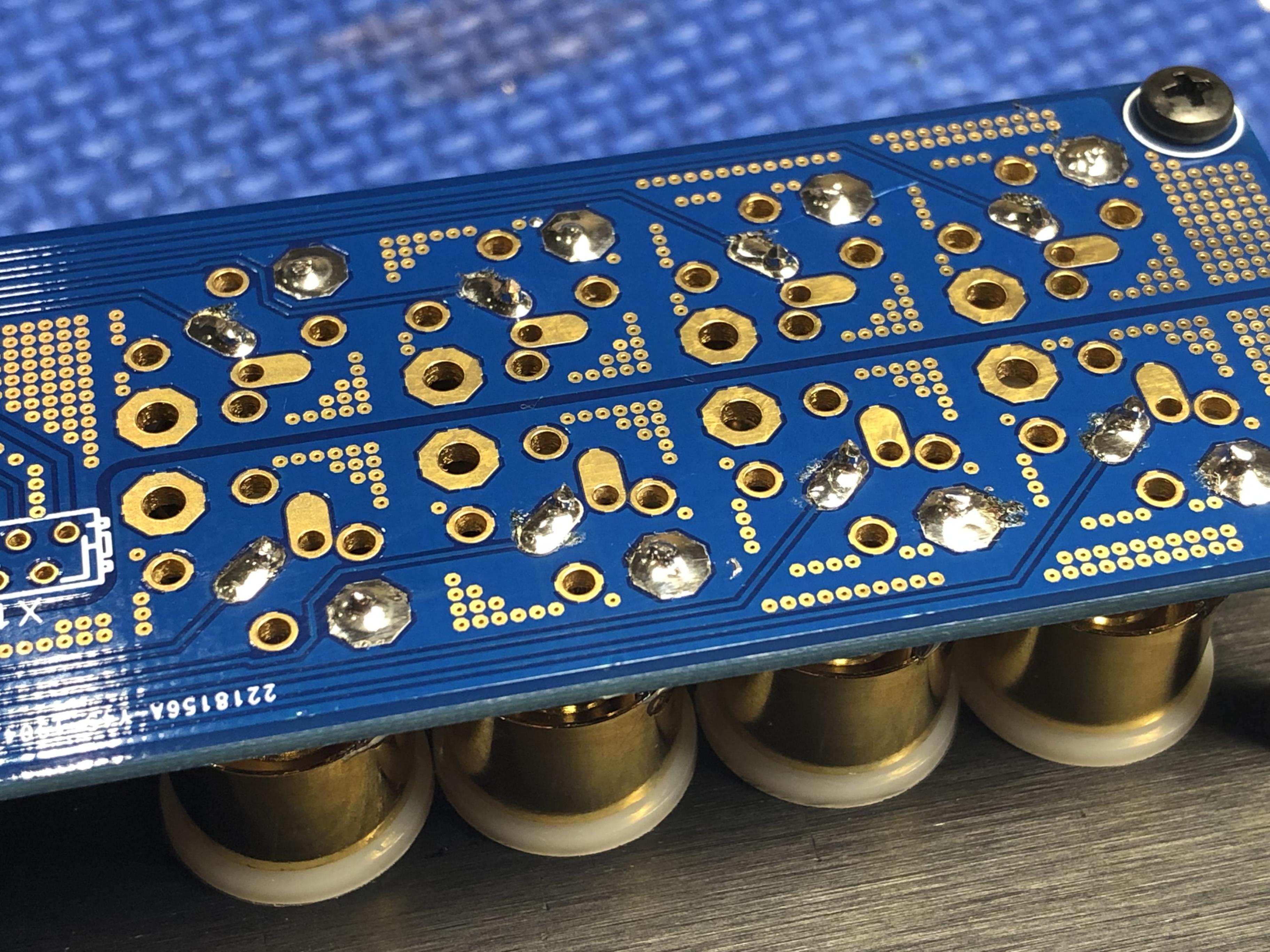

The pcb is spaced on M3 x 20mm brass standoffs to give room for the Manley Labs RCA’s. I used solid core copper ground wire from household 14/2 Romex cable for the short connection to pcb.
Position all the jacks on the rear panel and attach PCB to the standoffs. Then insert the copper wire through the pcb to land in the RCA center pin solder cup, cut the wire just above the board. Repeat for all and solder. Then do the same for the ground wire, landing it inside the RCA ground outer ring.
(Note: make sure you attach the rotary switch and ribbon cable header first)
Manley RCA link:
MANLEY RCA Gold-plated & Teflon phono jack Brand NEW! | eBay
Manley RCA link:

That's a beautiful fit and finish, Vunce! And those Manley jacks, are well, very manly-man looking and well built with lots of metal and gold and teflon. Nice. The exterior nuts also fit perfectly! Very nice job.

Hi Gary,
The WBA18 is still the verification build PCB - I haven't released the BOM or placement guide yet because I want to make sure they are good.
I guess there is probably no harm in releasing the BOM early if you want to do some shopping for parts first...
So these are still preliminary, please use the latest version once I verify the board works and order the final production boards.
Below are the BOM (in zipped CSV format), the stuffing guide and the schematic.
Is this the current placement guide and BOM for the WBA18, or have there been updates based on the verification build, etc.? Can current versions and schematics be put at post #1?
