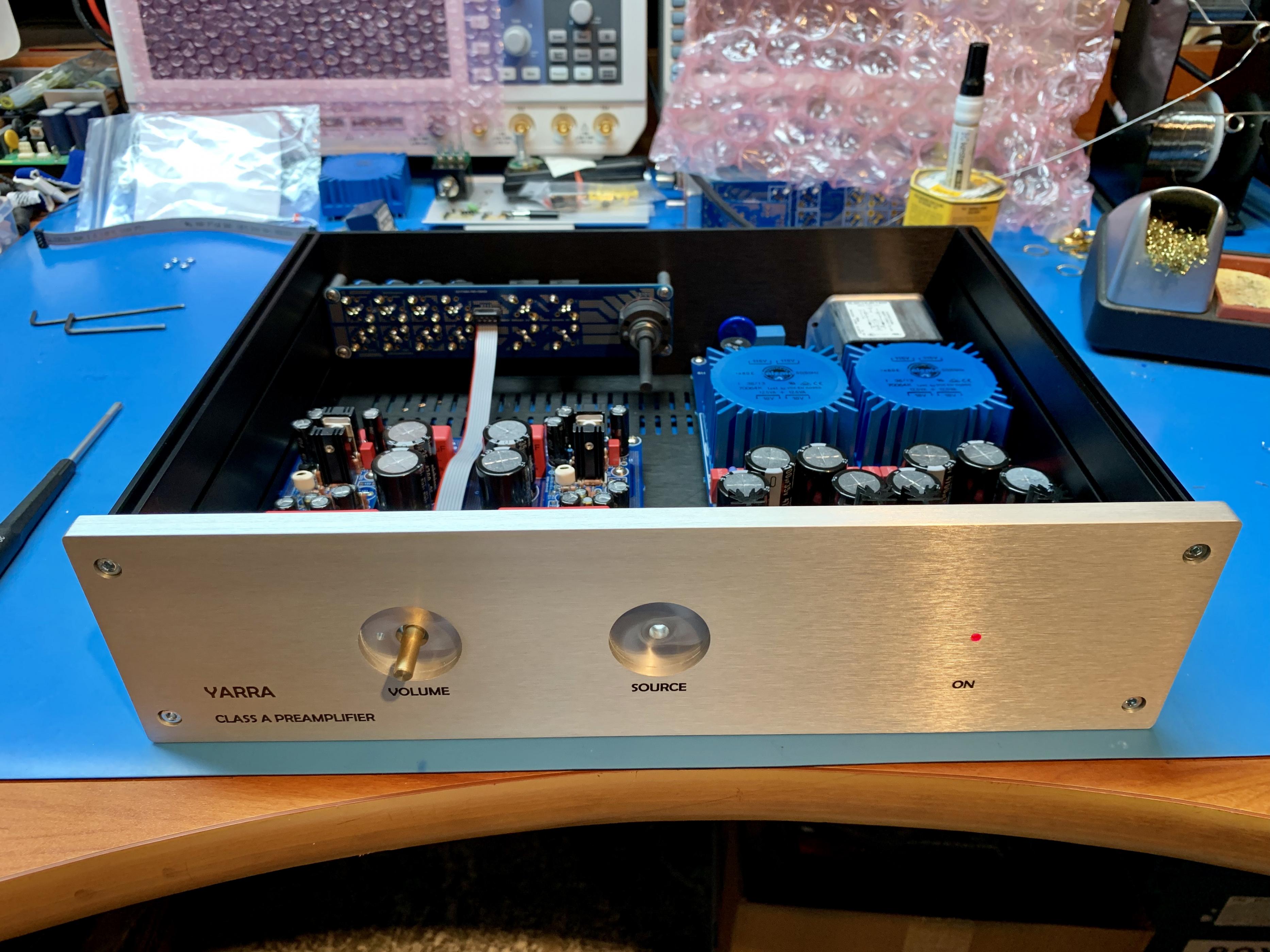

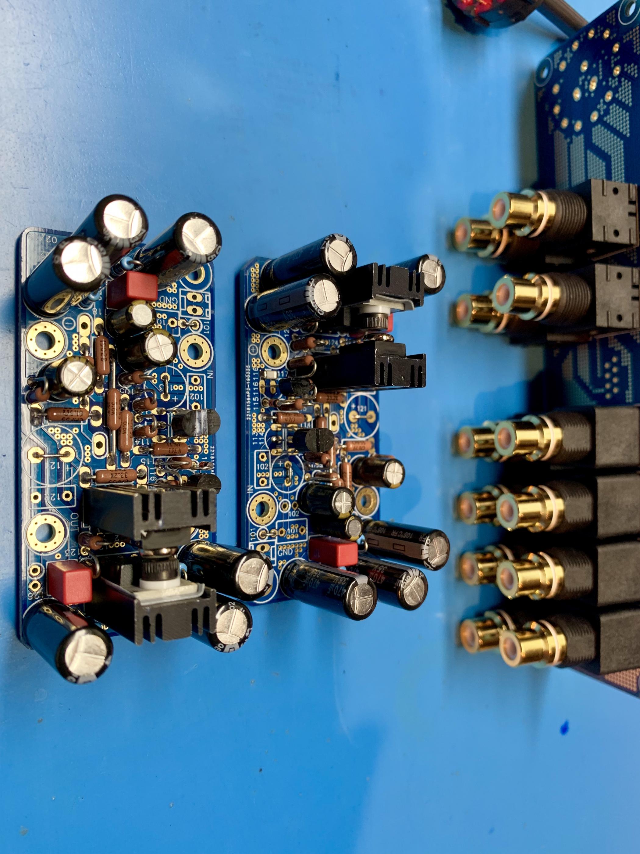

Final Melb cleaning. These actually took a while to build. Even though I used the stuffing guide, I still managed to swap two tombstoned resistors and hand to fix that. If anyone spots an error let me know! Clearance around the specified heatsinks is marginal and best to raise them ~1mm off the board.

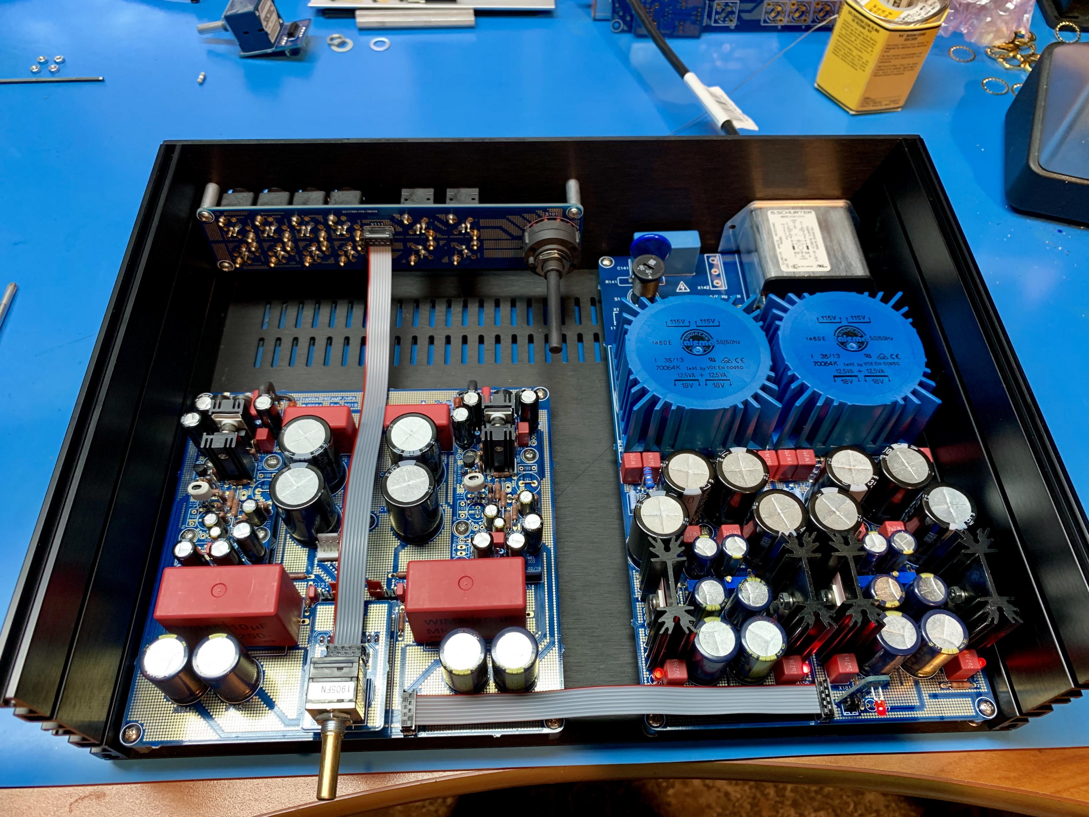

Dang, I was at the finish line just now and got smoke from the PS.

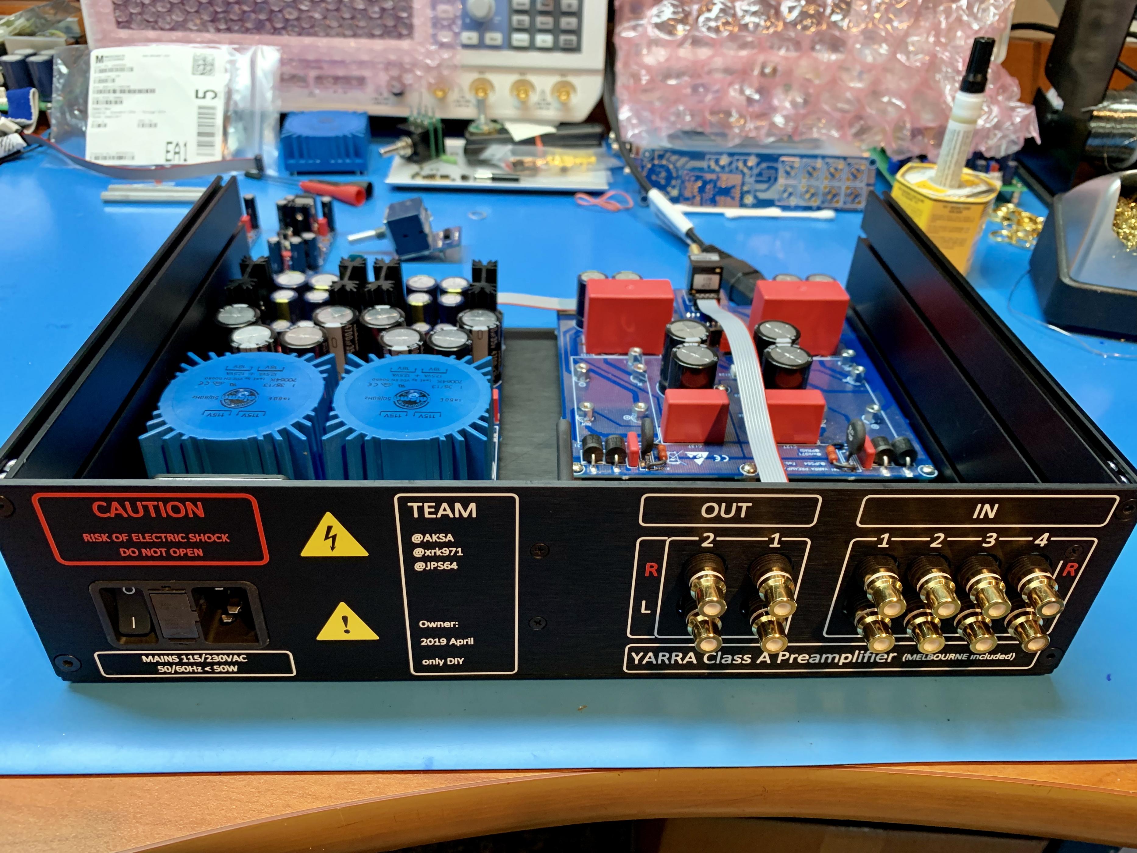

Connected up as shown below (no Melb boards). I had previously tested the PS with Yarra connected by the ribbon cable and all was good, but that was outside case. Since last power-up, I added two LEDs (X181 and H158), PCB mounting screws at X141 for IEC, centered all trimmers.

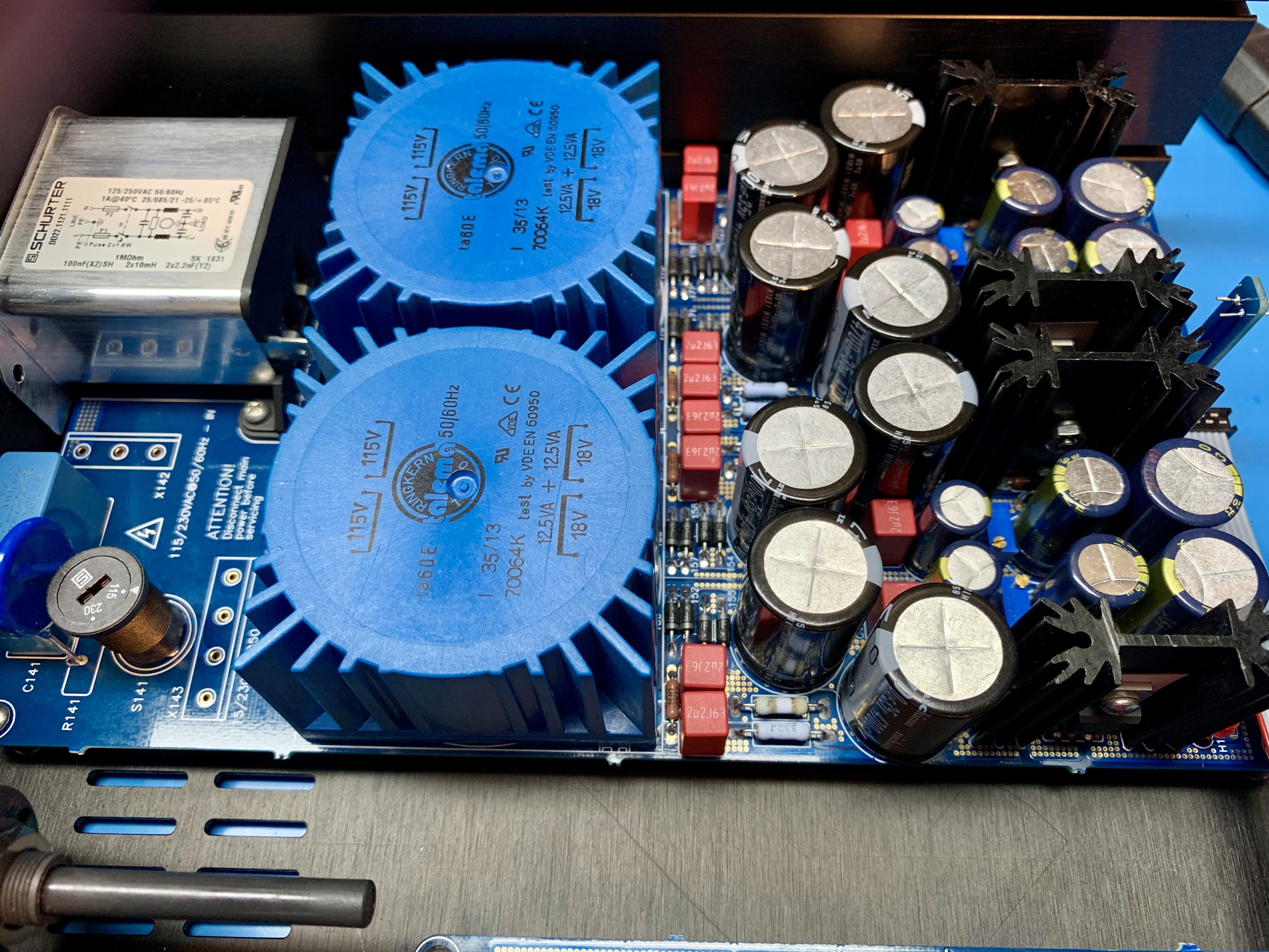

Burnt the 2.2R at R151 right away. LEDs lit only one side. Fuses didn't blow, but one looks suspect like it was about to go.
I've looked over everything with magnification and don't see any problems or shorts.
Need some direction!

I think I found the root cause of the smoked R151!
I lied before - I also newly installed standoffs on the Yarra for the Melbourne cards. Everything was within the silkscreen pattern, but the + standoff was somehow shorted to ground. Rearranged the washers and now all seems well. I made a mental note to check all that before powerup and totally forgot. Summit fever I suppose, and a good lesson slow down and take sanity breaks.

with all due respect, are you referring to the 2R2 resistor R155? It's more logical that would fail with a positive rail short to ground. A metal oxide resistor would be ok in that location.

I replaced R155 with a 2.2R MO power resistor from my inventory and continued on. Sorry for the confusion, typo on my part, the charred light blue panasonic resistor was R155 as shown in my previous pics.
In retrospect, it's advisable to use M3 standoffs. They are slightly smaller diameter than 4-40. I looked VERY carefully and didn't see a problem, but the DMM doesn't lie. Or use Vunce's suggestion of some Kapton tape.
All is now good! Looks really great!! Super precision everywhere.
