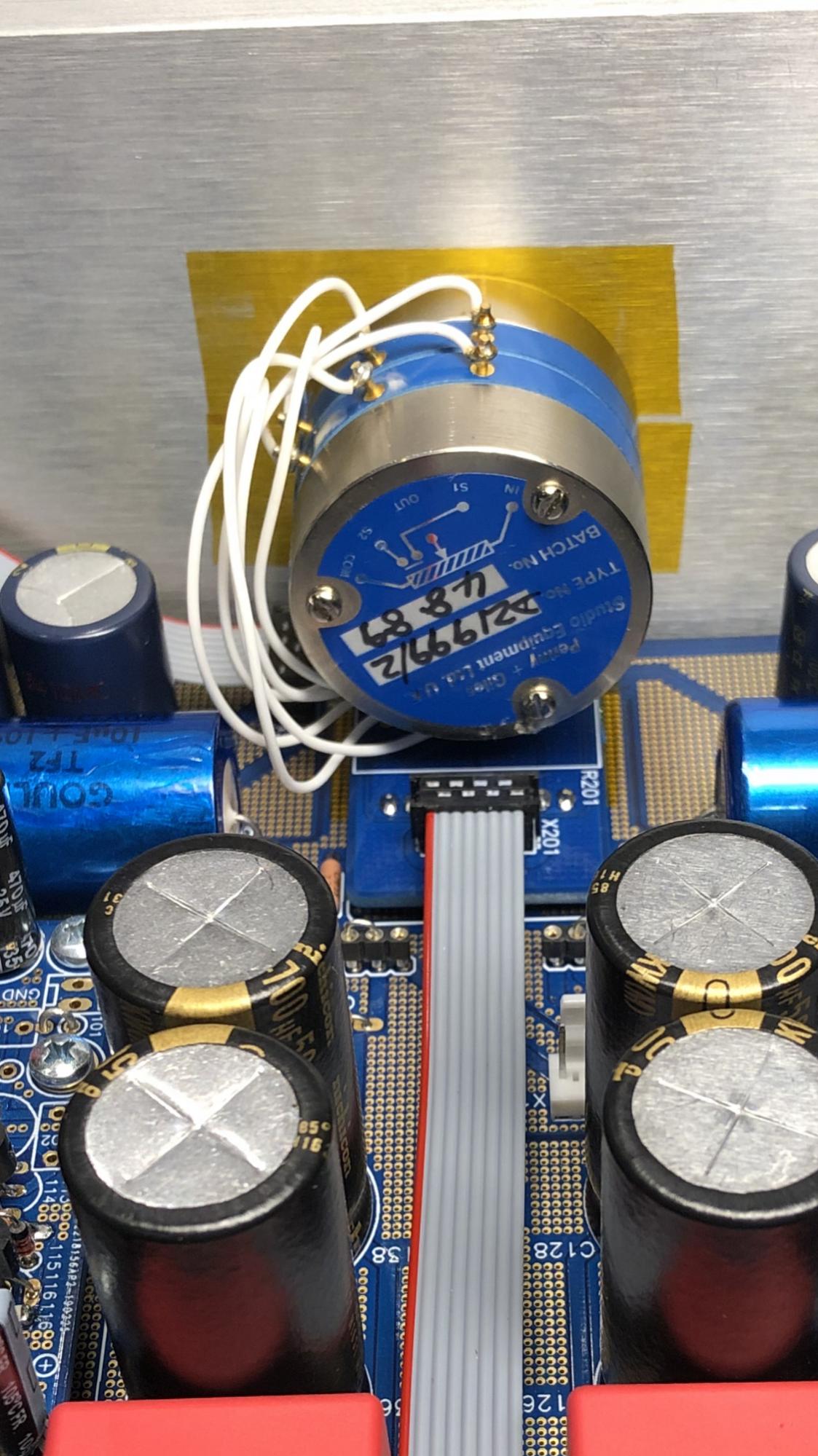

Can someone, who has finished building the Yarra Preamp post a pic or two, on how to physically mount the vol pot onto the chassis.
Mine vol pot was aligned properly behind the faceplate, but there is no way I can tighten it to the faceplate. So it's kind of dangling behind but still sings perfectly.
Hi meanie,
I didn’t feel comfortable leaving the volume pot board un-soldered. I soldered pins to the bottom side of the volume pot board and then soldered that directly to the motherboard to keep close as possible to the MB without touching. Then I soldered jumper wires from the volume pot to the volume pot board and mounted the volume pot to the face plate.

No prob meanie
It’s a Penny & Giles 10k pot.
Unfortunately, I don’t think they are made anymore.
I have mostly used 10k pots on my preamps and headphones amps. Sometimes a 50k pot. I think most sources can drive a 10k pot with no issues. Maybe some tube output stages like to drive 1M? Higher input impedance pots pick up RFI noise easier. I think 10k pots tend to be very quiet from EMi/RFI standpoint.
I still haven’t gotten into boutique pots yet so can’t really say - but a decent quality $3 Alps RK09 series has served me well on countless projects.
