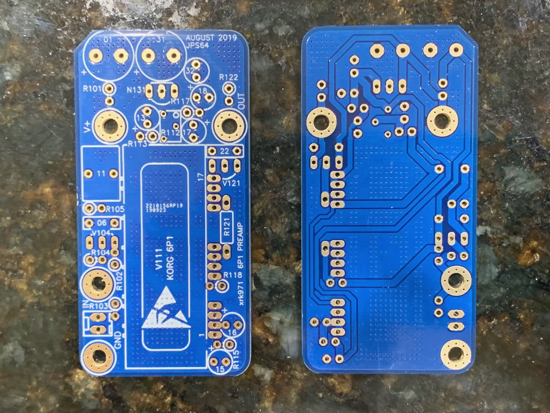

Hi X,
Am I missing something here as all of the other Yarra pre amp daughter boards (BA18, Melbourne and PCA) have 5 mounting holes to line up with the 5 screws on the Yarra mother card - but the Korg 6P1 DB has only 4 mounting holes as pictured. So how does it attach to the Yarra mother board?

That’s the negative supply voltage hole that’s not needed. JPS64 needed more board real estate, so the hole was omitted. It will still be sturdy enough for mounting. That particular standoff needs to be a female screw thread - or removed all together.
Thanks X, now I just need to make sure the Yarra mother card is fitted with female threaded standoffs for the mounting of any of the daughter boards.
