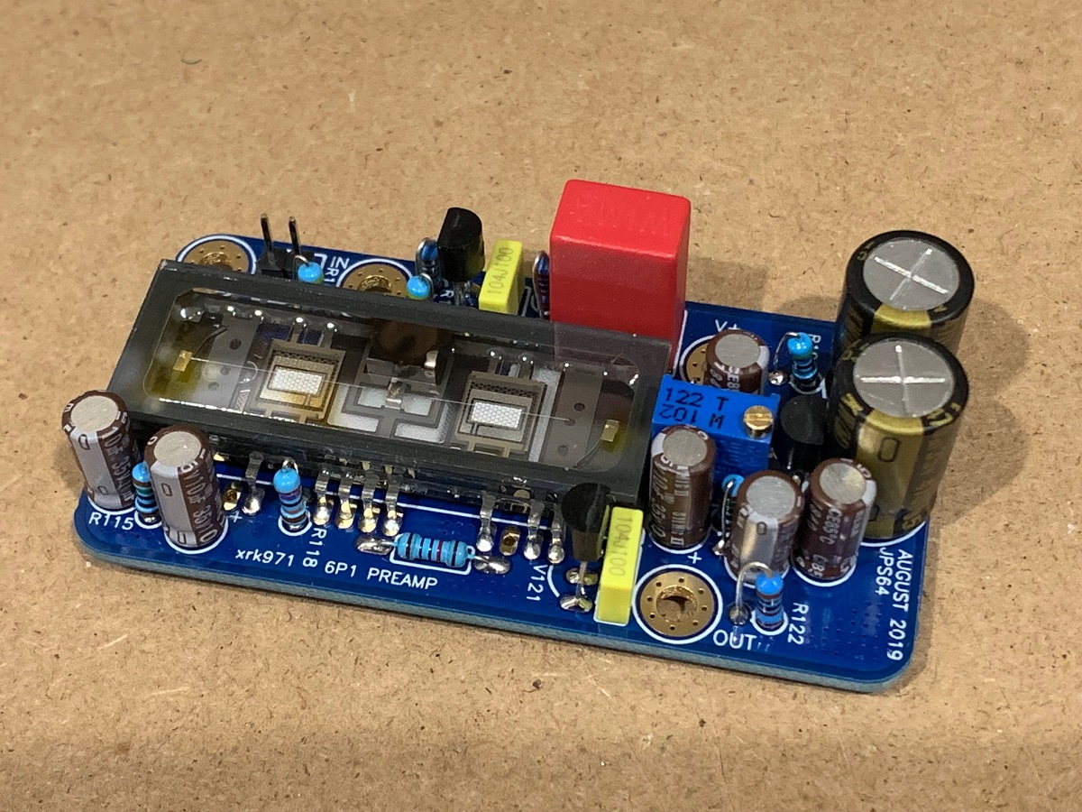

Korg 6P1 Preamp for Yarra Verification Build

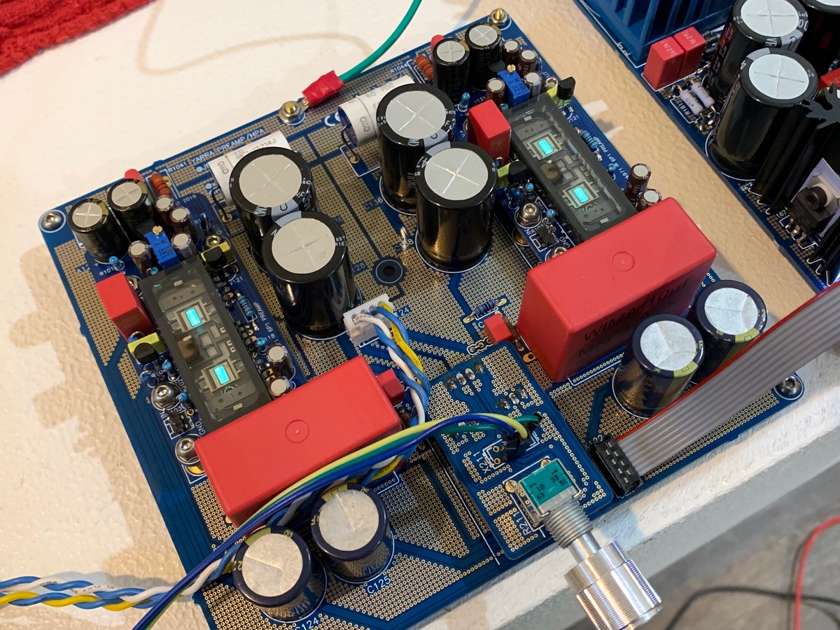

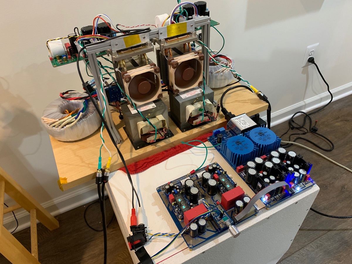

I finally had some time today to sling some solder and decided to build the Korg 6P1 preamp for the Yarra. It went together easily - only 11 resistors and 11 caps per module - easy to do in a few hours. What took longer was the fact that my Yarra motherboard was only set up for DC-coupled input and output, so I had to install all the coupling caps on input and output. I am using some rare 5uF metalized polycarbonate bypass caps on the output along with the dual back to back 4700uF Nichicons. On the input, I am using the BOM spec'd huge red 10uF Wima MKP's. Also had to add the input RFI filter consisting of 2k2 and 220pF and 100k to ground.
I also adjusted my rails to +29.9v (negative rail not used) as the max allowable voltage on the 3.3v regulators is 30v. I then installed the boards and fired it up. The aqua colored neon glow came on right away to show that it was working. I adjusted the pot to set the bias voltage for the grid (as measured at the top of R113) to be 2.5v (I saw this somewhere in Pete Millet's website). It can work at other voltages and easily set anywhere between 0 and 3.3v. Pot middle position was about 1.65v and that made music too. There is probably an effect on the harmonic distortion profile that could be explored.
I am using it drive my 50w SE Class Glass Harmony amp (an Aspen commercial design under development still). It actually has quite a bit of gain which is good because the amp is a 0dB gain power stage. Listening to it now and sounds very very good. Will continue to listen and give impressions later.
Main thing is that the preamp works without a hitch - first time. Nice work there by JPS64. I was a bit worried that there woiuld be debugging to do, but works great.
Easy peasy soldering:
The fluorescent glow lit right up!
Making fine music with Aspen Glass Harmony:

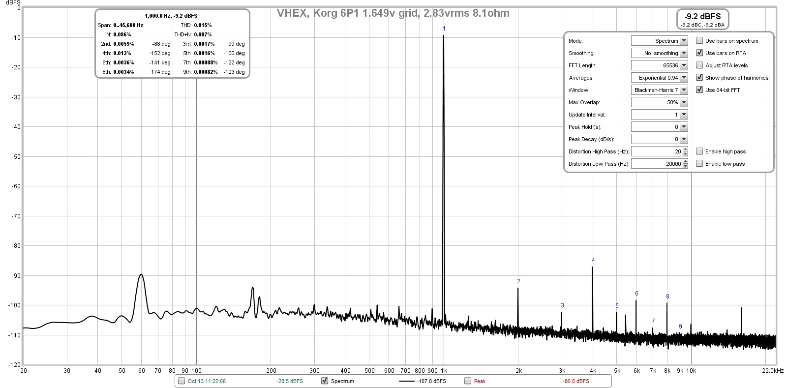

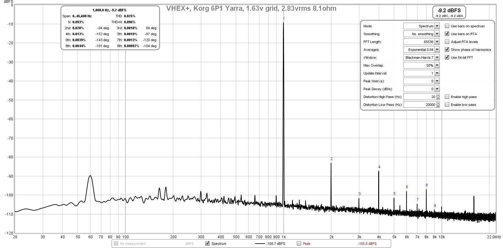

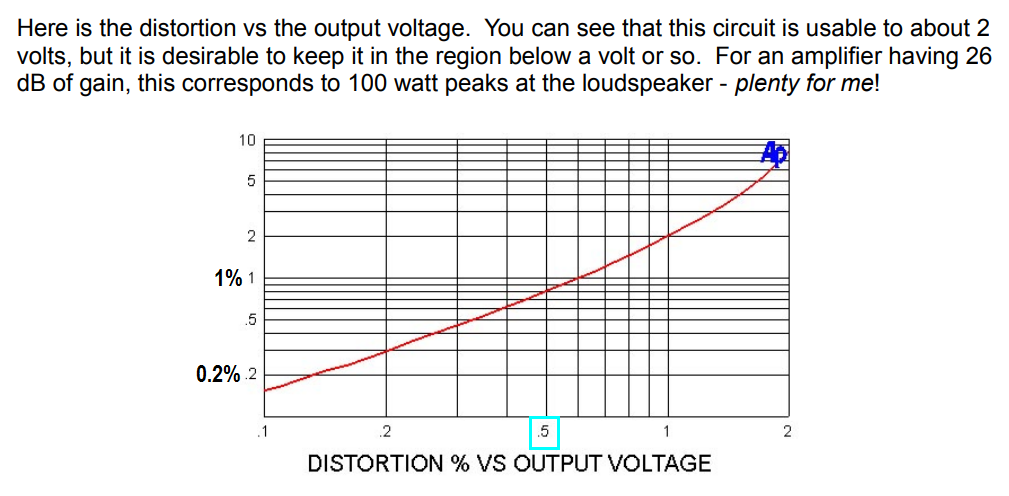

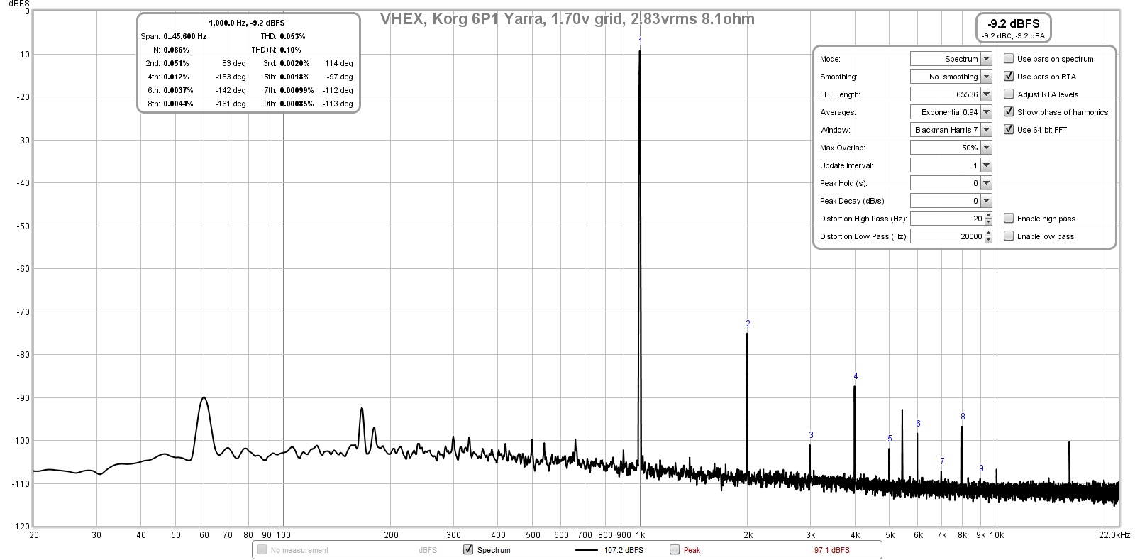

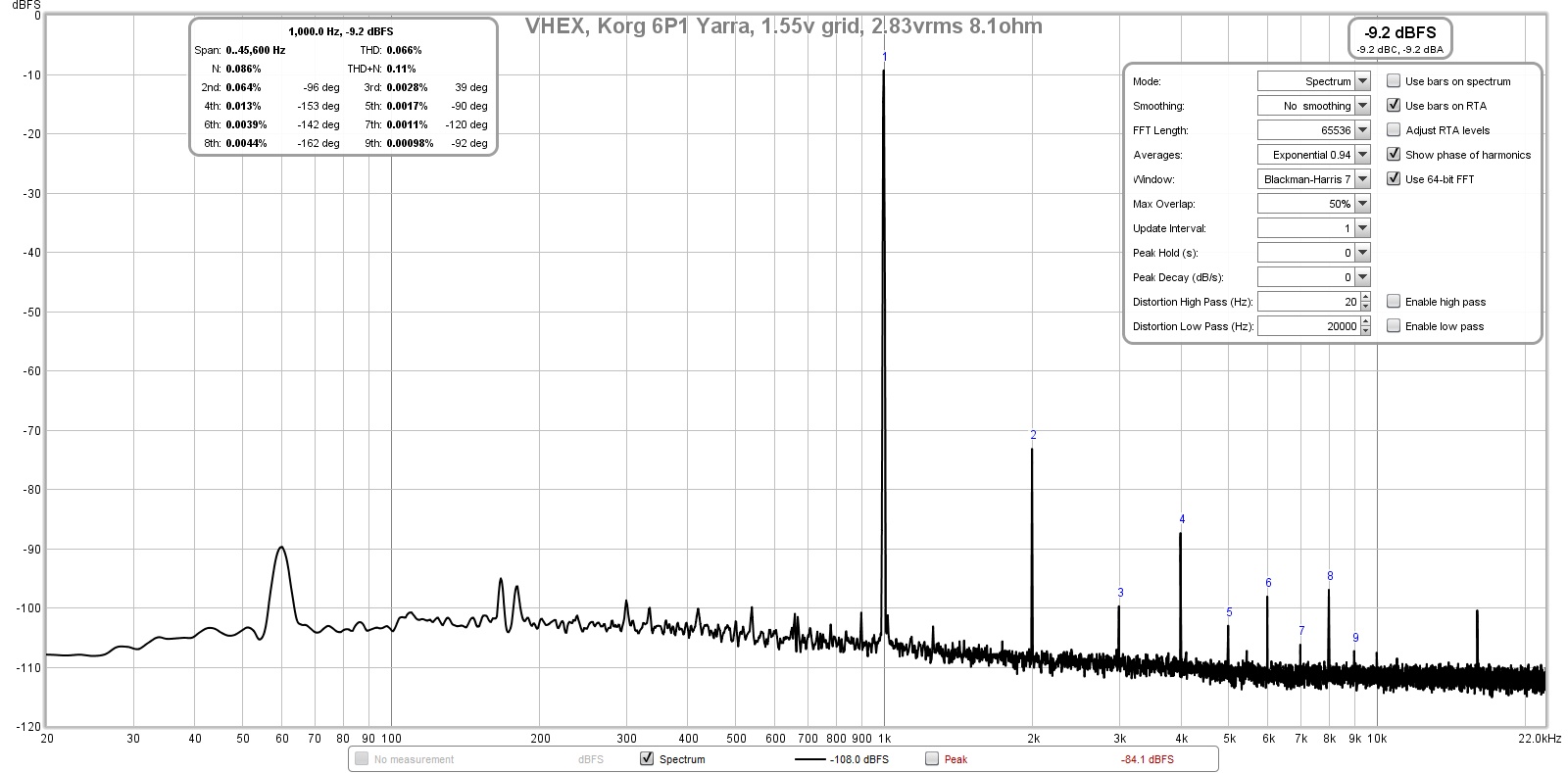

Folks, the grid voltage should be set close to 1.63v to 1.70v - real time FFT's show that it is critical to the nature of the distortion and the level. 2.5v is a terribly high 0.2% THD level. At 1.63 it is about 0.06% and a good balance of 2nd and 3rd and 4th harmonic.
Various grid voltages for 2.83vrms into 8ohms from VHEX+ amp being driven by Korg 6P1.

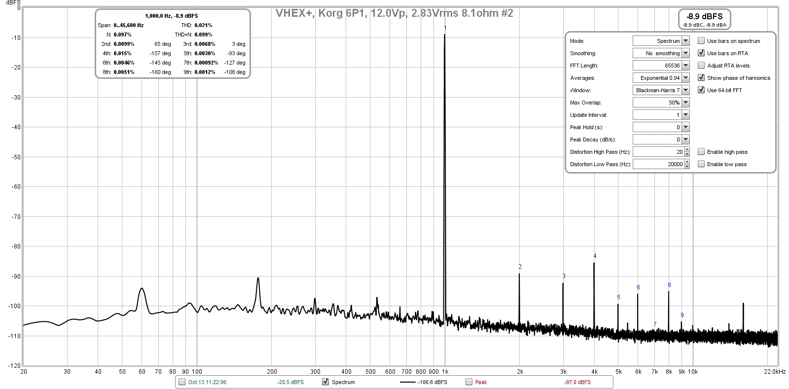

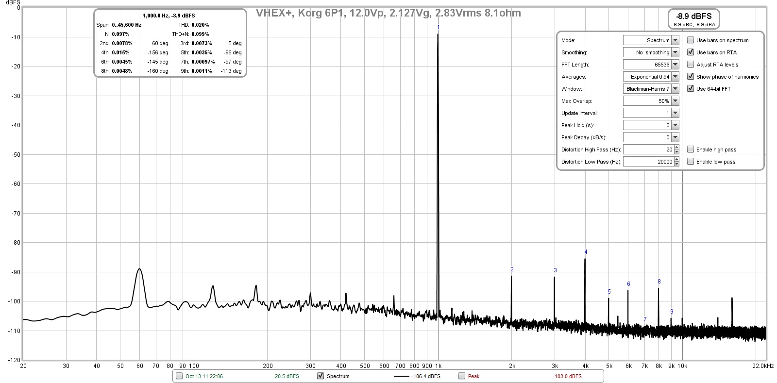

So I tried setting the Korg 6P1 operating setpoints according to the recommended settings shown here, mainly setting the plate voltage to 12.0v (versus setting the grid voltage). Vp can be measured on the left exposed leg of R121, filament voltage (Vf) can be measured at pins 1 or 17 (far left or right) of the 6P1.
So my settings are:
Vp = 12.00v (28.61v upstream of R118 at exposed top leg) and 270kohm plate resistor gives 61.5uA or 31uA each - right within the recommeded plate current.
Vf=0.651v (3.3v uspstream from regulator) and 150R gives 17.7mA, just a tad over the recommended 17mA filament current.
Vg ended up at 2.127v

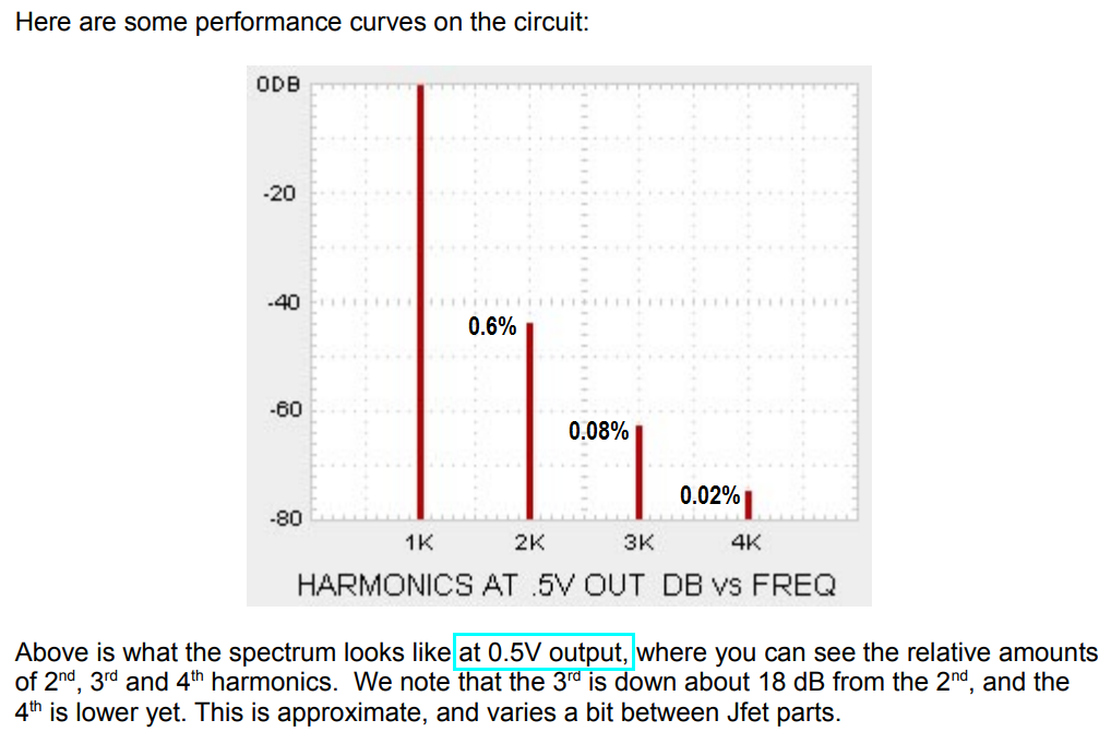

The resulting harmonic profile has about even amount of H2 and H3 and H4 higher than both. I am not sure what to do to get the 4th order distortion to be lower because the profile needs to be monotonically descending, High 4th order seems to be prevalent.

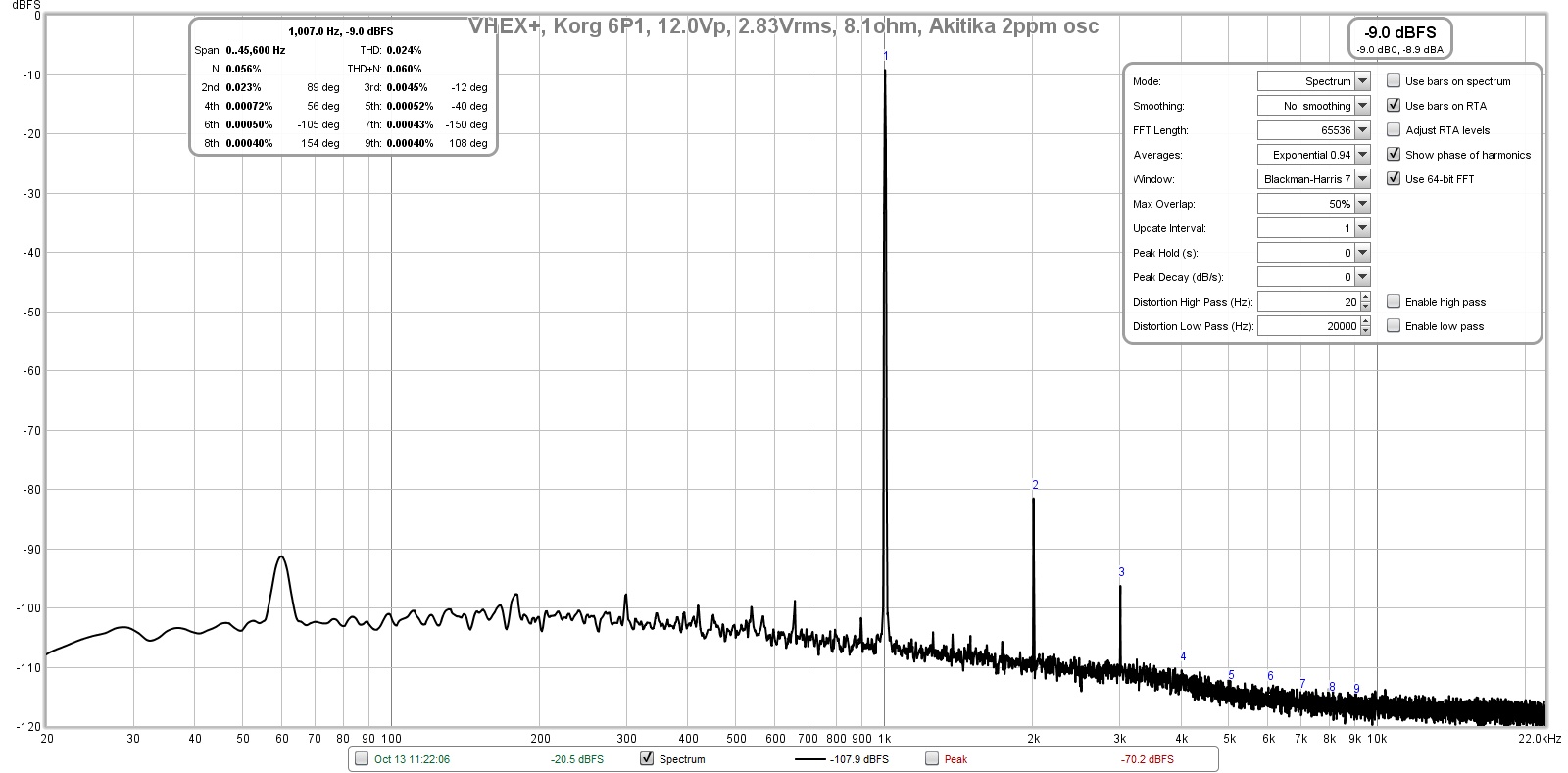

FFT R122 set at 600ohm:
With R122 set at recommended 1kohm:
Edit - I kept thinking something is strange with the H4 being high and how there is so much higher order stuff - this should be much cleaner since SE Class A. I removed to the on-board oscillator using the headphone output of the Focusrite and replaced with the Akitika 2ppm 1kHz sine wave oscilator. Finally, things now make sense. We get a dominant 2nd order harmonic distortion and lower 3rd order and nothing else. I will need to look at what is going on with that internal oscillator on the Focusrite. It has not been that far off before.
So it looks like the design is good as is, with the requirement that the plate voltage be set at 12.0v per the recommended facotory setting.
