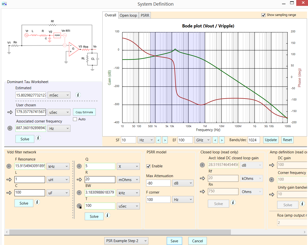

PI networks in VDD path need predictable dampening
Summary, for now: I view the VDD network to also be a design issue.
Here are two VDD networks with PI networks: 1milliFarad at the VDD supply, 1uH of wiring (~1 meter), and 100uF located by the OpAmp.
In both cases, the 1mF has 3milliOhm ESR and 100uF has 1milliOhm ESR.
The ringing frequency is set by the smaller of the caps, and the total loop inductance, producing approx 16KHz Fring.
In the 2nd case, an additional cap with high losses is placed in parallel, at the OpAmp, with the 100UF. This new cap has 1nH ESL and 1nH PCB trace inductance. Note the 16KHz ringing is not affected.
What is going on? These lovely low-ESR high-value capacitors will produce audible ringing, if not dampened.
Use the formula R_zeta1 = 2*sqrt(L/C) to compute the critical-dampen R value.

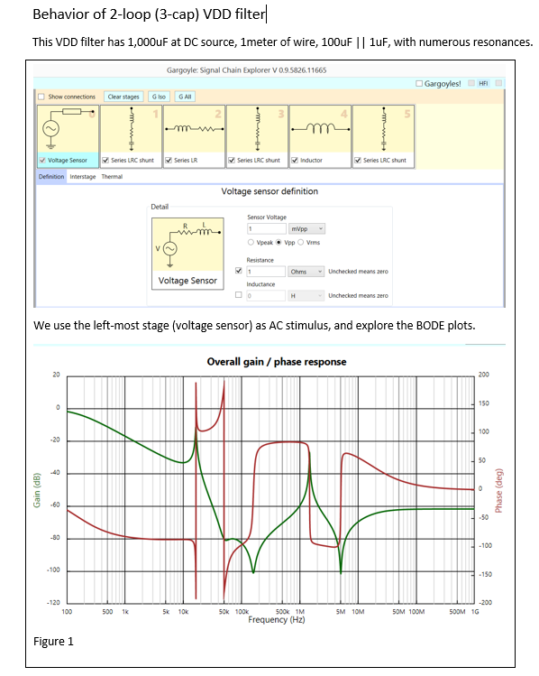

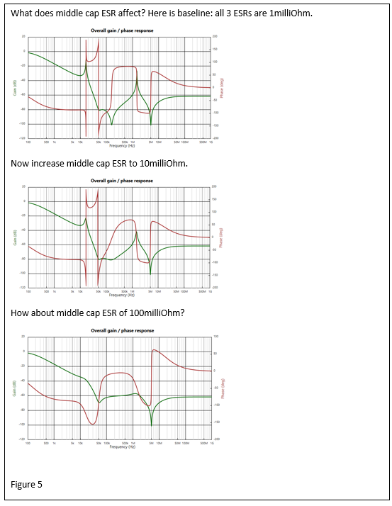

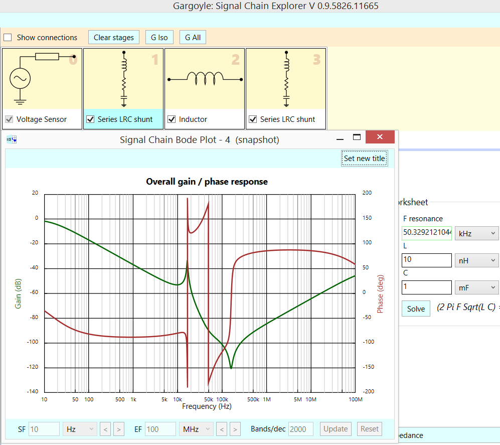

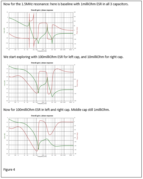

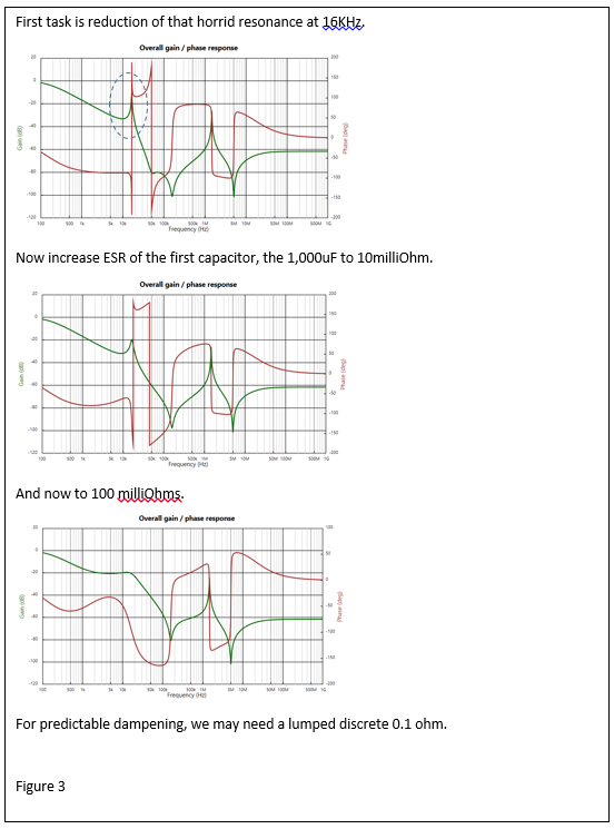

3 examples of how Capacitor ESR controls VDD peaking

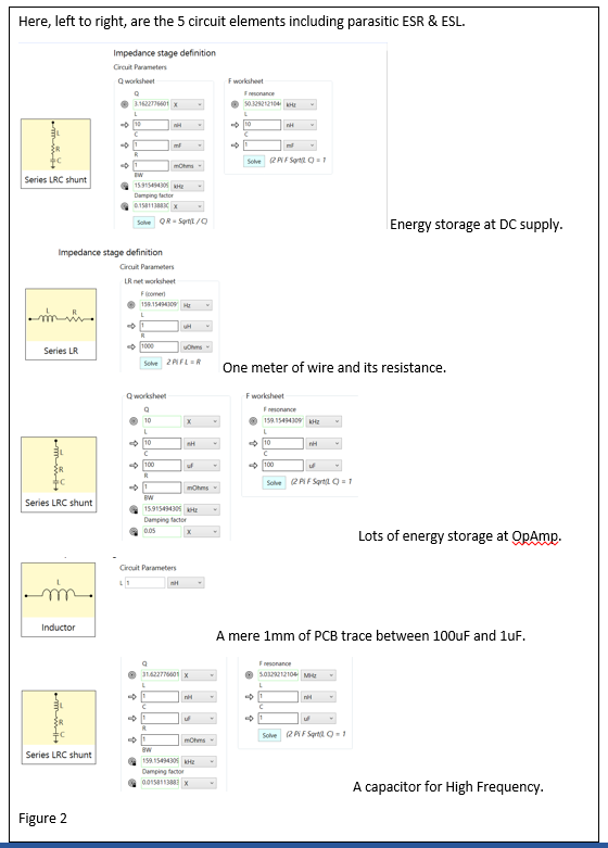

Here are more details on VDD as design issue.
The circuit has 2 adjacent and interacting PI CLC filters, with 1mF, 100UF, 1UF. Baseline ESR is 1milliOhm in all 3 capacitors. I've set the ESLs to values I consider likely for small and large capacitors.
You'll notice how increasing the ESR has excellent reduction/dampening effect on peaks.
Figure A provides the schematic and baseline frequency/phase response.
Figure B provides details of all the caps and non-parasitic inductors.
Figure C has 3 freq curves, for 1milliOhm, 10milliOhm, 100milliOhm ESR in the 1mF cap.
Figure D has freq curves for 1uF cap.
Figure E has freq curves for 100uF cap.

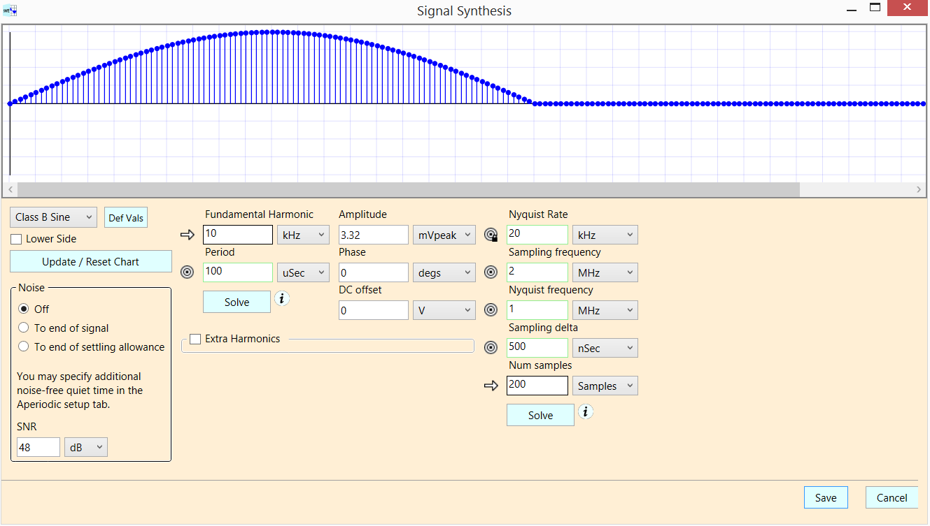

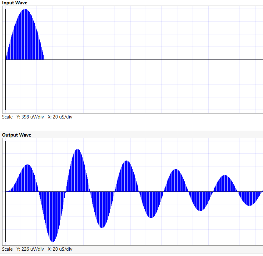

Predicting 66dB Signal/Coloration Ratio from VDDringing (PSRR on)
tankcircuitnoise: Summary, for now: I view the VDD network to also be a design issue. Here is: 1uH, 100uF, 20milliOhm R_dampen
Here is Part2 of a simulation (Part1 simply computes Load Current flowing through ESR of VDD filter, as a ClassB pullup current from OpAmp)
predicting 66dB ratio between desired Signal into headphone at 10Khz, and the undesired 16KHz ringing/coloration.
First figure shows two waveforms: (1) the distorted ClassB OpAmp pullup current, from 200 milliWatt headphone signal (5.3 volts PP) at current of 166mA; we use 3 pulses of ClassB to show how LC stored energy may fight the incoming energy; (2) the buildup of LC energy over 3 ClassB pulses, followed by the Q=5 (20milliOhm ESR) dampened response.
We use a utility to compute the #bits and multiply that by 6dB/bit.
With 5.3 volts PP at 10Khz, and a mere 2.34milliVolts at 16Khz, we see 11 bits or 66dB signal/coloration.
Second figure shows the macromodel producing the 16KHz ringing.
Upper left corner is the schematic; VDD components are in red.
Third figure shows the ClassB stimulus: frequency, voltage (computed as 0.166 amps * 0.020 Ohms), and #timesamples for the signal.

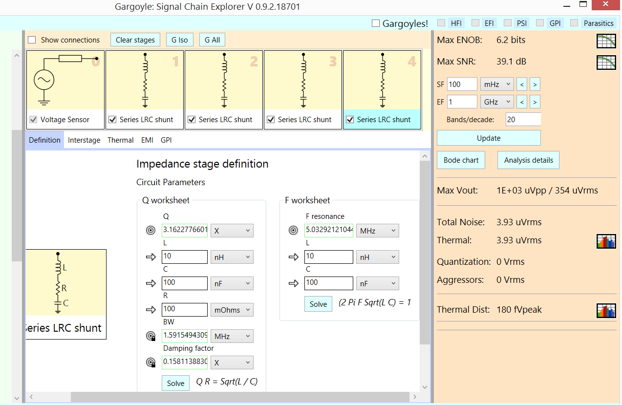

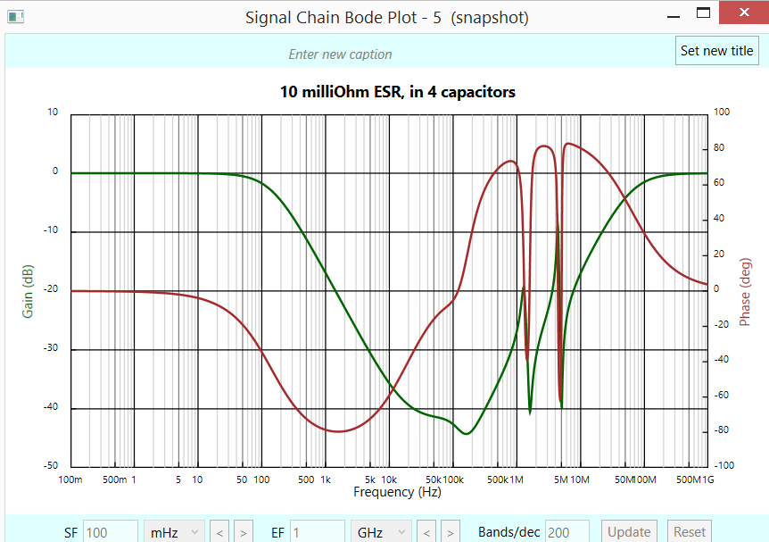

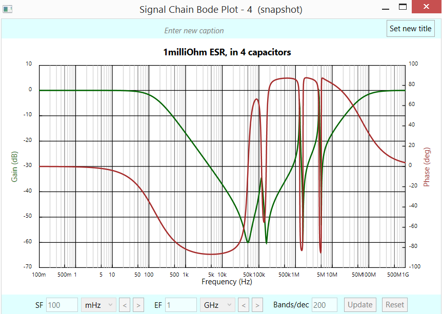

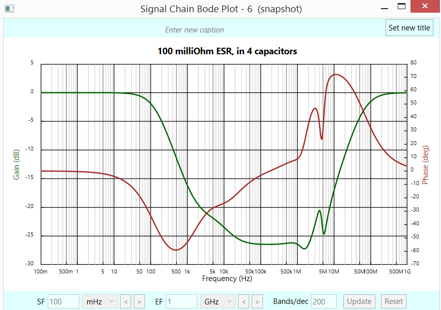

Dampening of 1,10,100milliOhm ESR with 1000,100,1,0.1uF caps
<So, just putting a resistor (of about .2 or .3 ohms) at the output of the PSU would be sufficient? >
Here are 4 capacitors in parallel: 1000, 100, 1, 0.1uF with 10nH ESL for each; I show the schematic, and then sims of BODE with ESR of 1,10,100 milliohm. The VDD source resistance (on far left) is 1 ohm.
Note the smaller capacitors need higher R_dampen.
This is consistent with
R_dampen_Zetaof1 = 2 * sqrt(L/C)
