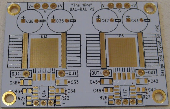

OPC, the BAL-BAL boards arrived. Thanks. Can I check the wiring? "Out" seems straightforward but there are no polarity markings on the supply input. I'd rather ask than make a mistake. If the board is oriented with the OPAs at the front and the silk text is 'right way up', which hole is V+ and which is V-? Pics of builds here suggest V- is on the left and V+ on the right but then those boards have markings on the silk to that effect as well whereas mine don't. On the signal input, what's the middle hole for?
EDIT: post 2257 has a pic of what appears to be Pin 1 being connected to signal ground if that's what the middle of the three holes at the input to the amp module is. That would be a huge mistake, no? XLR pin 1 should only be connected to the chassis. Pin 1 is for shielding, it is not for signal.

SGK,
you are right.
We have been told for over 20years how to wire Pin1 and yet we still find folk wiring it wrongly.
Pin1 goes to chassis.
you are right.
Hi SGK,
I just had a close look at the boards and realized the PCB fab house made a total mess of the silkscreen on the power inputs. They are on the board, but in the wrong spot, making them impossible to read.
I have attached a picture of the board with the correct silkscreen which should help you identify the power inputs. I will also add this to the Wiki for clarity.
The signal inputs are as marked, and the middle pin connects to audio ground.
This was done for flexibility, so please feel free to hook these up in whatever way you see fit. You don't need to terminate a GND here, but please be mindful of the common mode DC limitations if you do long runs without any GND reference.
Owen
Thanks Owen. I just looked at the spare board I purchased and indeed I can see the markings buried in the silk for the caps - I had already soldered the caps (and everything else) and so they were covered up. Is the Wiki working now? I haven't been able to get it to work for some time now.
I don't follow this. Can you explain? We have a differential signal input and differential output. + is referenced to - and not to any "GND".
Internally, the op-amp is referenced to GND, and the common mode DC offset at the input is limited to roughly the supply voltage. If the voltage at either input pin exceeds the supply voltage relative to GND, then the op-amp can be damaged.
Imagine you run only the two differential wires from your preamp to the input of the headphone amp which sits all the way across the room on another outlet/circuit, thereby omitting any GND reference between the two units. If the GND reference for the amplifier ever differs from the GND reference of the source, then this will appear on the input of the headphone amp as a common mode offset. If this is only a few volts (eg, both chassis are earthed and connected to the same power bar) then this won't be a problem. If both units are not earthed, or far away from one another, then getting more than 15V differential between the two GND references could easily happen due to line transients, ESD, or inrush current. Under these circumstances, the op-amp is at risk. Always make sure there is some solid common GND reference between the source and the amp. Generally, this is done with pin 1 which would link both chassis together at the output and input.

These are indeed a pain... the best way is to use paste and bake the whole thing, but I just used an 80W iron with a 3mm flat tip and it went pretty well. Once one side is tacked down I was able to solder the other fully without the heatsink moving around.
Owen

SGK,
there are three alternatives that I can see.
a.) Install the interconnect with screen/shield connected to Pin1 at both ends and Pin1 connected to Chassis at both ends.
b.) design the circuit inputs to tolerate excessive common mode voltage on the signal lines. This is usually discussed in the datasheet. Many inputs have protection built into the IC chip and the datasheet gives guidance on what impedance/resistance to put into the signal lines to prevent the internal protection from becoming damaged.
c.) do neither of the above and hope the circuit survives.

Yes (a) is the right solution. I just don't think of this as a "GND reference". It merely ensures that both chassis are at more or less the same potential. The only signal reference is the other half of the +/- transported via pins 2 and 3. Better XLR connectors ensure the cable shield and the whole connector shell meet with the chassis. Under no circumstances would I see a need to connect an input or output to the 'GND' plane of the board (which is polluted by the electrolytic and bypass caps). After all, this is why the design is differential in the first place - to avoid a GND reference. As is often the case, Bruno puts it rather succinctly in his note on the subject: http://www.hypex.nl/docs/papers/The G Word.pdf
Correct... A) is indeed the right solution, and the way equipment and the connectors themselves are designed to be used. They key is not to omit the common reference between different pieces of equipment unless you're using transformers or some other form of isolation that can tolerate high voltage differentials.
