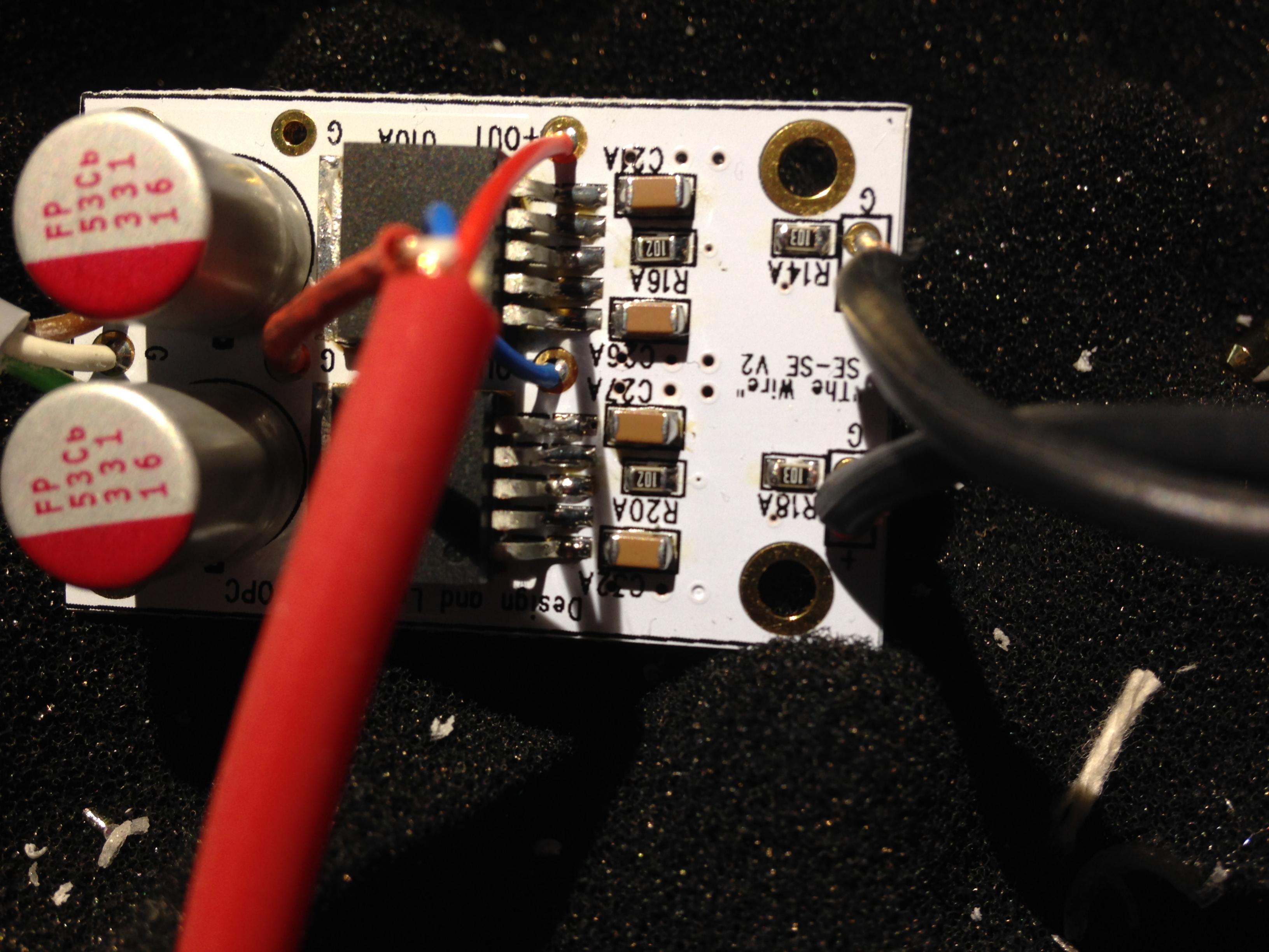

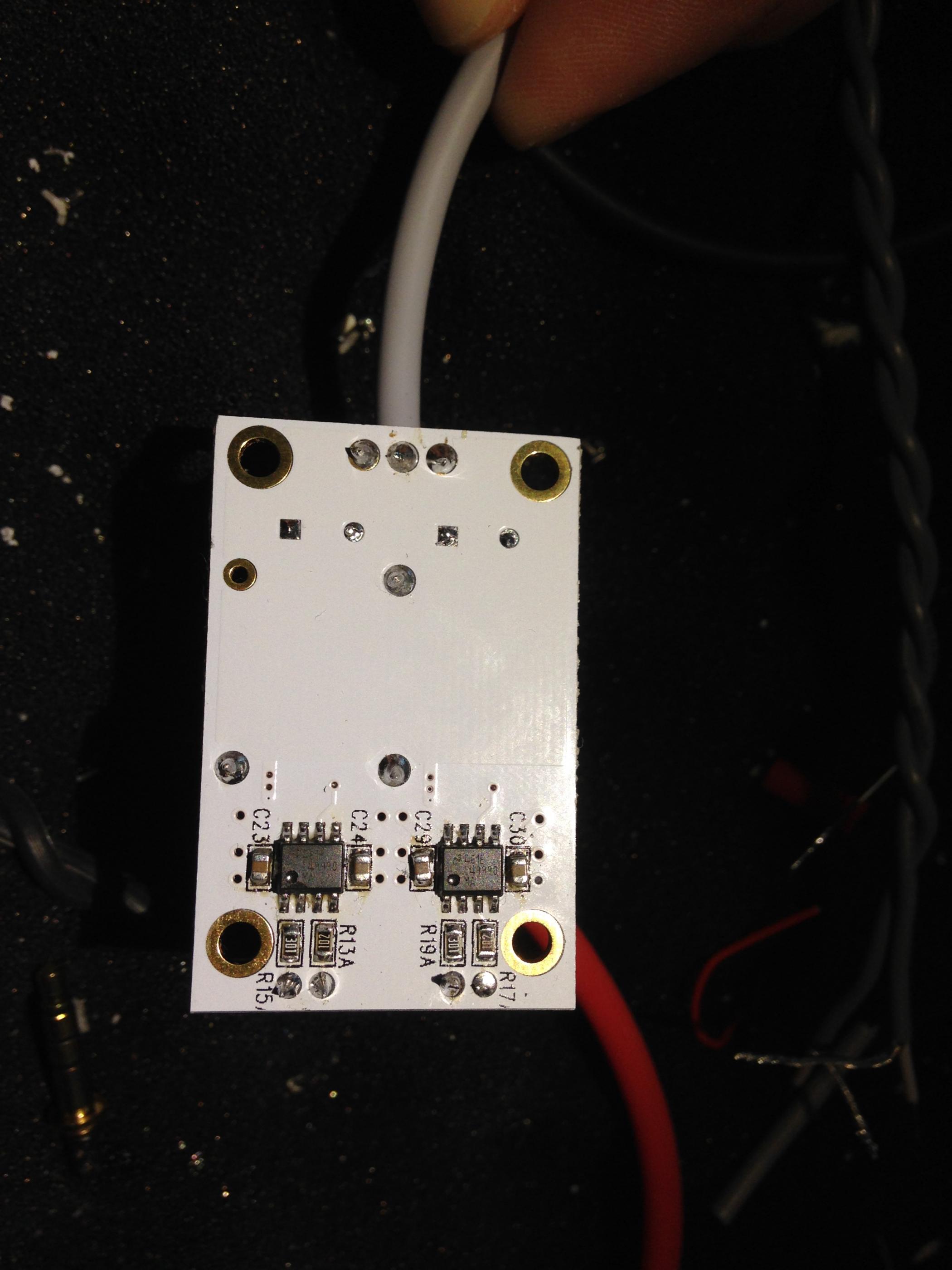

working temperature of SE-SE
hello fellow wires,
i just finished soldering the psu v2 and the SE-SE version.
i checked everything, all the pads, all the bypass caps and finally plugged in my orthodynamic frankenphones (32ohm).
sound is coming out and probably not bad, but the SE-SE gets super hot (can hold less than 5s with the finger), especially the buffers, but everything, the opamps, and even the poly caps.
i am afraid to let it run longer.
what are typical working temperatures? the psu is barely warm, and delivers the right voltage.

better post some images since something obviously is wrong.
Your wiring cannot have an effect on the temperatures, and I doubt it is oscillation. My SE-SE gets barely warm to the touch even after being on for long time. Looks like current draw is too high for some reason...
I'd agree with stixx here... we need some high resolution pictures to really help you out.
What rail voltage are you running? Is it +/-18V? This might cause things to run warm, but probably not as hot as you're implying.
At +/-12V or +/-15V it should be only slightly above ambient.
I would hazard a guess one or more of the ICs was damaged either by heat during soldering, or if you ever accidentally reversed the supply polarities. Sometimes the output buffer or input op-amps remain functional but draw a lot of current, and usually suffer a significant performance hit. If you're using the standard LME49610 or 49600 and an LME49990 then it's very unlikely you have any oscillation.

hi multi, stixx and opc,
thanks for the suggestions, i will be able to upload pictures later on (im not at my workshop atm).
however i think this problem is not going to plage me anymore for now... i kind of destroyed one PSU by using a center tapped trafo and im not sure what i did to the second PSU, but i have a suspicion that the place where the heatsink is soldered to the pcb caused a really bad short and blew up the regulator.
i powered the SE-SE with another PSU and it was singing merrily, then i used the PSU of the wire phono preamp and it was also merrily singing and not getting hot at all.
my theory is that the SE-SE was getting too hot because it was running with a shorted rail.
so at the moment i dont have a dedicated PSU but will work on that, maybe i can make a prototype based on the o2.

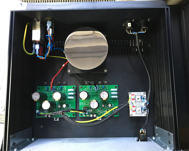

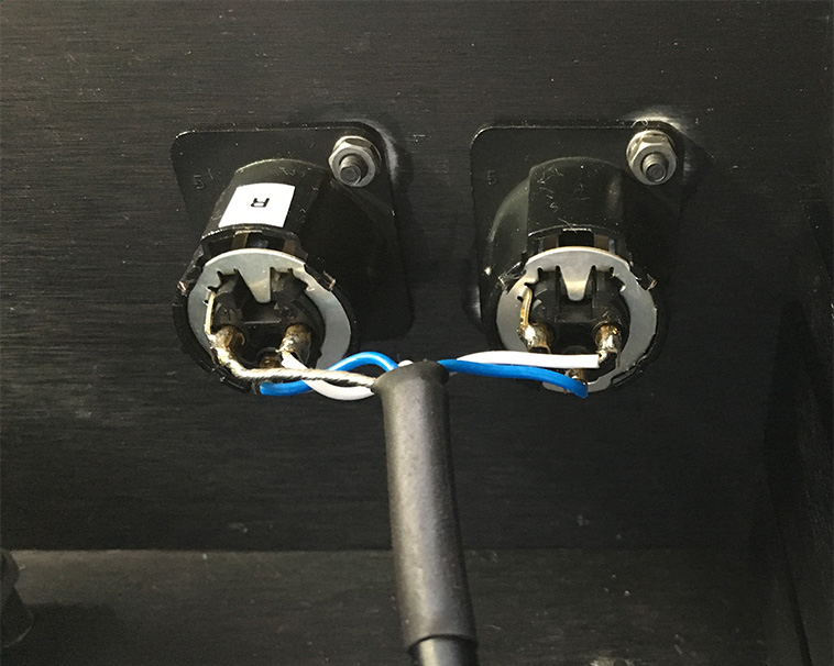

Ok all seems good. After a few hours yesterday cursing the lack of connectors on the board I got it all assembled and today I powered it up first with some cheap headphones and then with the LCD-X. Seems to be working fine so far.
I will try to take some pics at some point.
BTW I must say I am a bit underwhelmed by the LCD-X versus my speaker setup. I can't wait to run them through a Dirac Live calibration to get a better sense of their frequency response profile. People praise the bass on the LCD-X. I would say it is very 'flat' versus a very good set of speakers and subwoofers calibrated by Dirac Live. Oh well,at least I now have a means of listening when the wife would otherwise complain. I'll run them in for awhile before coming to a final judgement.

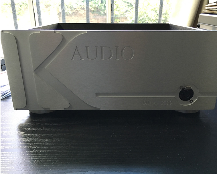

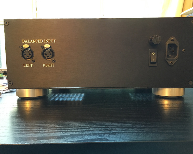

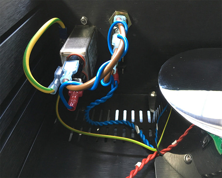

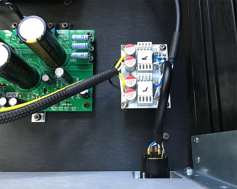

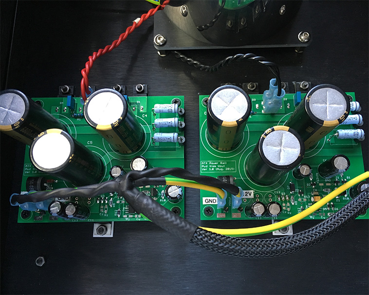

Some iPhone pics.
Enclosure is by Modu. I'm not sure why I went with the 3u enclosure. I think I just started with the height of my previous project and never went back to examine dimensions again. 🙁 2u would have been fine/better. I could have gone for a cabinet 5cm less deep as well. The circa €15 difference in base enclosure price would have been, however, rounding error to the cost of the enclosure post milling, engraving and drilling.
The power supply is from my previous project - 5A capable regulated PSU with superb line rejection. (I used 3 of these to build a linear ATX supply.) I just used a couple of the spare boards I had and downsized the filter caps a bit from 10,000uF to 6,800uF 🙂.
