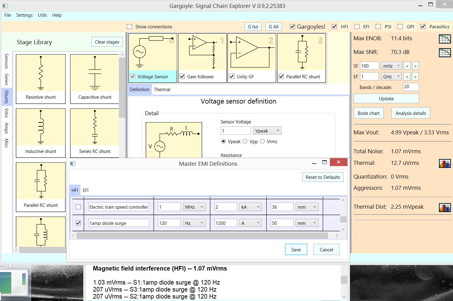

So I'm planning to build a SE-SE into a desktop headphone amp unit. The plan is ODAC (rev B) -> SE-SE -> headphones.
2) How much distance should we put between a toroidal transformer and anything in the signal path?
Let's consider just a long straight wire, carrying the current surges occurring at peak of the incoming 60Hz (120Hz full wave) energy. Those surges, occurring as rectifier diodes turn on, are 1 Million amp/second transients. Let's model that --- 1 Million amp/second risetime --- as coupling between a long straight wire radiating 2 inches to a similar length signal path between DAC and some OpAmp, the signal path placed 1/16" (or 1.5milliMeter) above the GND plane [loop area 2" by 1/16"].
How big a problem? Its a 1milliVolt rms 120Hz, against 5vPeak music output, problem. SNR is 70db. Its an evil buzz (I recall from teenage amplifiers).

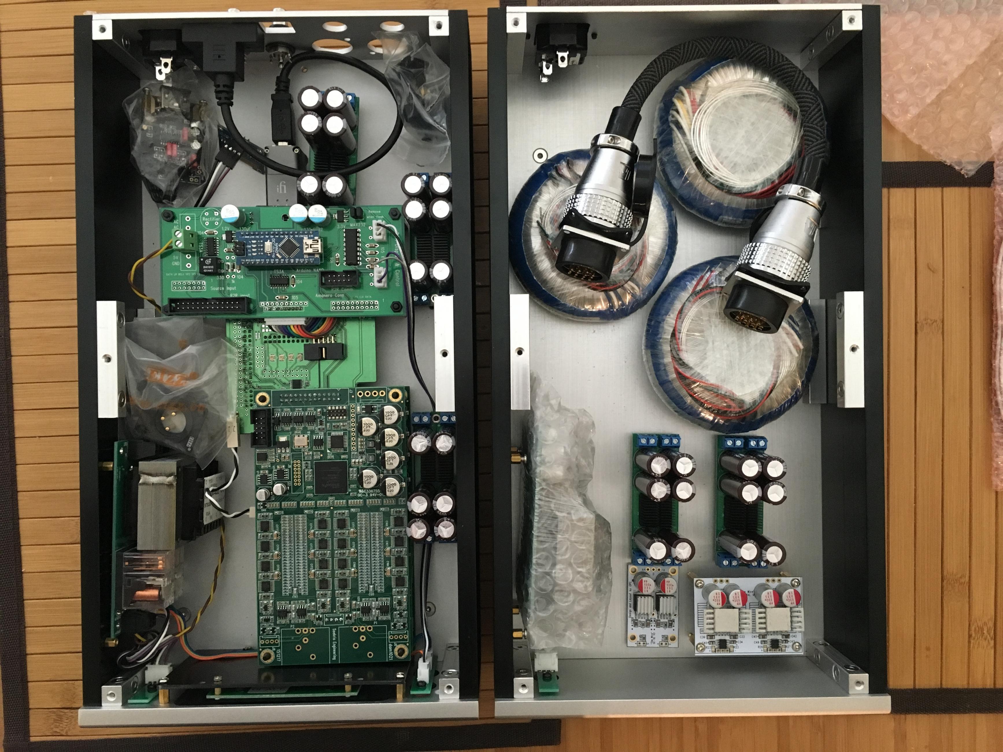

Completed my wire se se build at long last - making for a very happy father's day indeed! Thanks so much for this wonderful little amp OPC!
After a lot of reading up on wiring/grounding options, I opted to go with a true star ground and am pleased to report she runs dead silent, without the need for a ground breaker circuit between safety earth and star. Sound quality is fabulous, as expected, particularly when hooked up to my Yggy as a source. Will need more listening time, but I think I may prefer the wire to my mainline with th-x00's! Looking forward to trying it with my hd800's when I get around to making a xlr4 to trs adapter.
Here's a shot of the internals. Trafo is the ever popular amveco, and the build is stock but for the resistor changes (shorting r13 and 17 and 1m for r14 and 18) to allow for a 100k pot. If anyone uses this photo as a reference, please note the pot is inadvertently wired in backwards, which I promptly corrected after a very loud initial listening test. Note to self to meter this on the next build.

Nice build! Where did you get the case from?
Thanks Lucien! This is the ebay chassis I used. It is spacious relative to the boards and makes for an easy build, but I have still got to figure out some way to remove the "breeze audio" branding from the front panel. Maybe start with acetone? Also, the description references a power switch "with lamp," but FYI, the switch that the seller shipped with mine does not light up.
Thanks. I've been looking at something similar on eBay too. Size is a bit different, but it's similar enough that I guess it all comes from the same factory.
I was worried I wouldn't have enough space between the toroid and everything else which would cause interference, but your build gives me confidence. 🙂
Not sure if it helps you but I managed to remove Breeze Audio screen-printed ink from a brushed-aluminium front panel by using car brake fluid (DOT 4) and a piece of course wire scourer rubbed very lightly over the ink.

@Lucien I was a little worried about noise as well after some earlier reports in the thread, but I think with braided or shielded inputs, star grounding and reasonable spacing between the signal/amp side and psu side, you will be all good. You'll have to share a pic of your build once up and running. Did you go with this enclosure?
@howarthcd Thanks so much for the comments and suggestions on removing the breeze branding! Good to know it is doable, provided the black faceplate can handle the same treatment as the clearcoat. I wonder why the overseas factory spent the money to mark up a diy enclosure in the first place. It is nice that they offer the precut enclosures, including iec inlets and power switches, but I can't imagine anyone actually wants the branding on their project. Seems like there would be a nice business opportunity for FPE, hammond, par metal etc to start offering a small line of precut boxes akin to the ebay stuff but made local and without any silly labeling in ugly fonts. Based on many threads here and elsewhere, it seems that there is a large number of diyaudio enthusiasts who enjoy sourcing, soldering, hookup etc. but lack access to the tools required for real chassis work. I don't know about you, but the thought of using a nibbler and file to try to cut an iec inlet, for example, sounds like less fun than a trip to have my teeth drilled.
