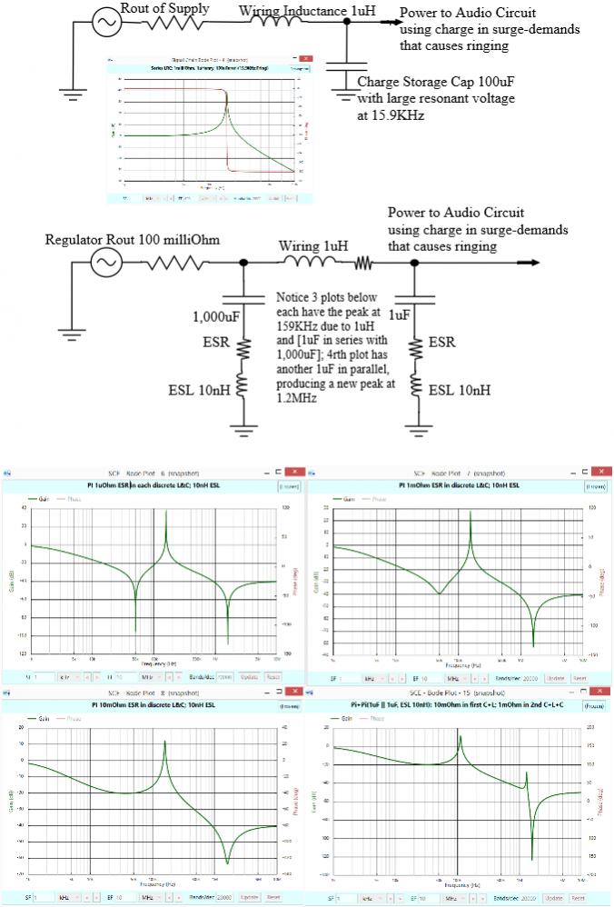

Comparing simple resonance, with parallel-cap PI behavior
tankcircuitnoise: I view the VDD network to also be a design issue.
This PNG has two circuits.
Top is series RLC, L being the wiring from Supply to circuit, C being the local charge storage; note there is ONLY ONE interesting point in the frequency response: the peaking of the resonance.
Bottom is 2 caps in parallel, one 1,000uF and other 1uF, with 1meter wire (1uH) between. The first 3 plots show peak at 15.9KHz (1uF & 1uH, ignoring the 1,000uF); varying the ESRs does not move the peak, tho the height does drop.
In the 4rth plot, I add a second 1uF in parallel with first, and we get a new peak. We need a lot more damping Resistor than 10milliOhms.
Use the formula R_zeta1 = 2*sqrt(L/C) to compute the critical-dampen R value.[/QUOTE]
