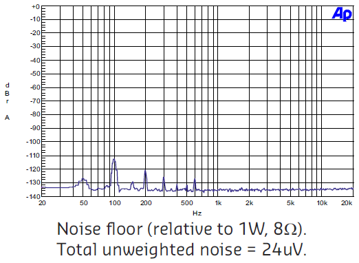

The noise floor sits at an amazing -130dBV above 500Hz, and creeps up to a little over -120dBV down at 20Hz. This is one reason why good class AB will always be better than class D. You won't find a class D that can touch this level of quietness.
Well, except for NCore ;-)

The measurements are from the NC1200 product bulletin, posted here. This is the high power OEM module.
NC400 is the DIY module (lower power but better input stage etc.).

There's a fundamental issue in that the N-core measurement is scaled relative to 1W at 8 ohm (2.83V) and mine are all done at 1dBV. That means the N-core measurements will be 9dB worse than they appear on that graph if you scale them relative to 1dBV as I have. This applies to all their measurements, including the distortion measurements.
The peak at 100 Hz is also significantly worse in that it's about -102dBV where the class AB is 20dB better. Keep in mind that peaks above the noise floor are significantly more audible than a generally higher noise floor is.
Don't get me wrong, the N-core amplifier has absolutely phenomenal performance for a class-D amp, but as I've said before, it's still not quite as good as the best class A and AB designs. It is a reminder though that hard work in that area is allowing them to close the gap!
Be very careful how you read graphs. There's nothing tricky or wrong about the way they did the measurements, but if you're going to compare graphs, make sure you have the same X and Y axis!

a noise floor @ -101dBW unweighted and genuine for a completed amplifier is indeed difficult to hear.
Even 100dB/W @ 1m speakers will give a noise volume @ 1m that is lower than the threshold of hearing.
