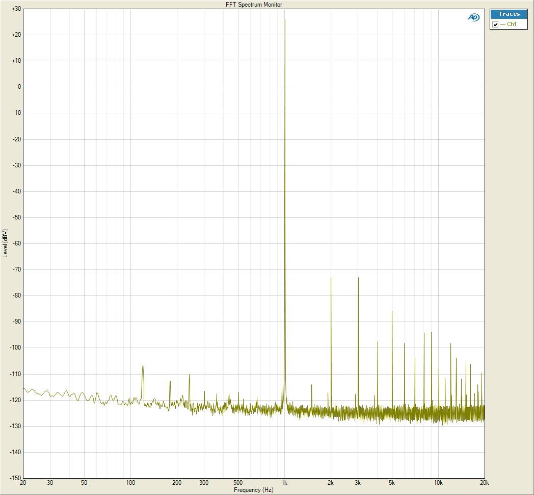

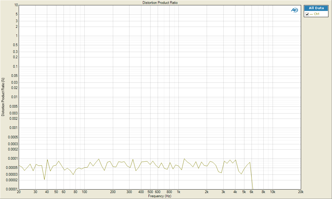

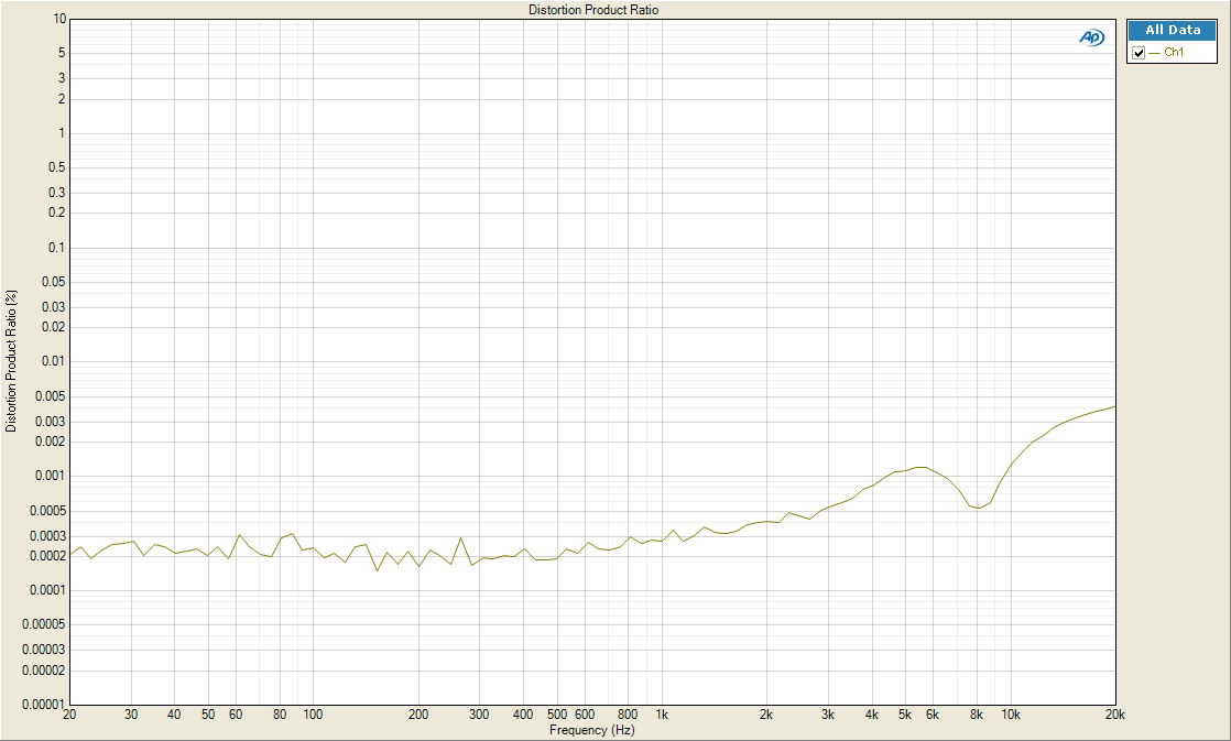

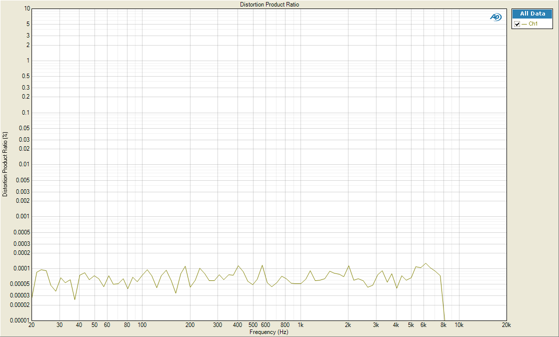

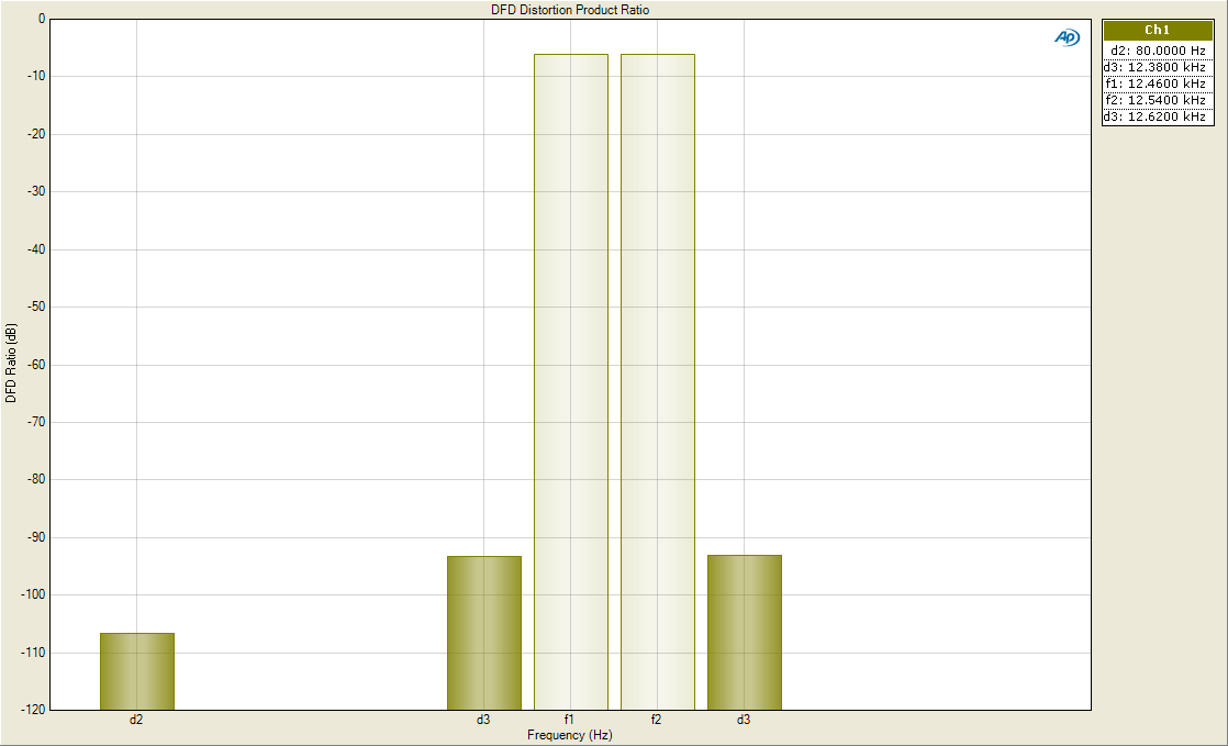

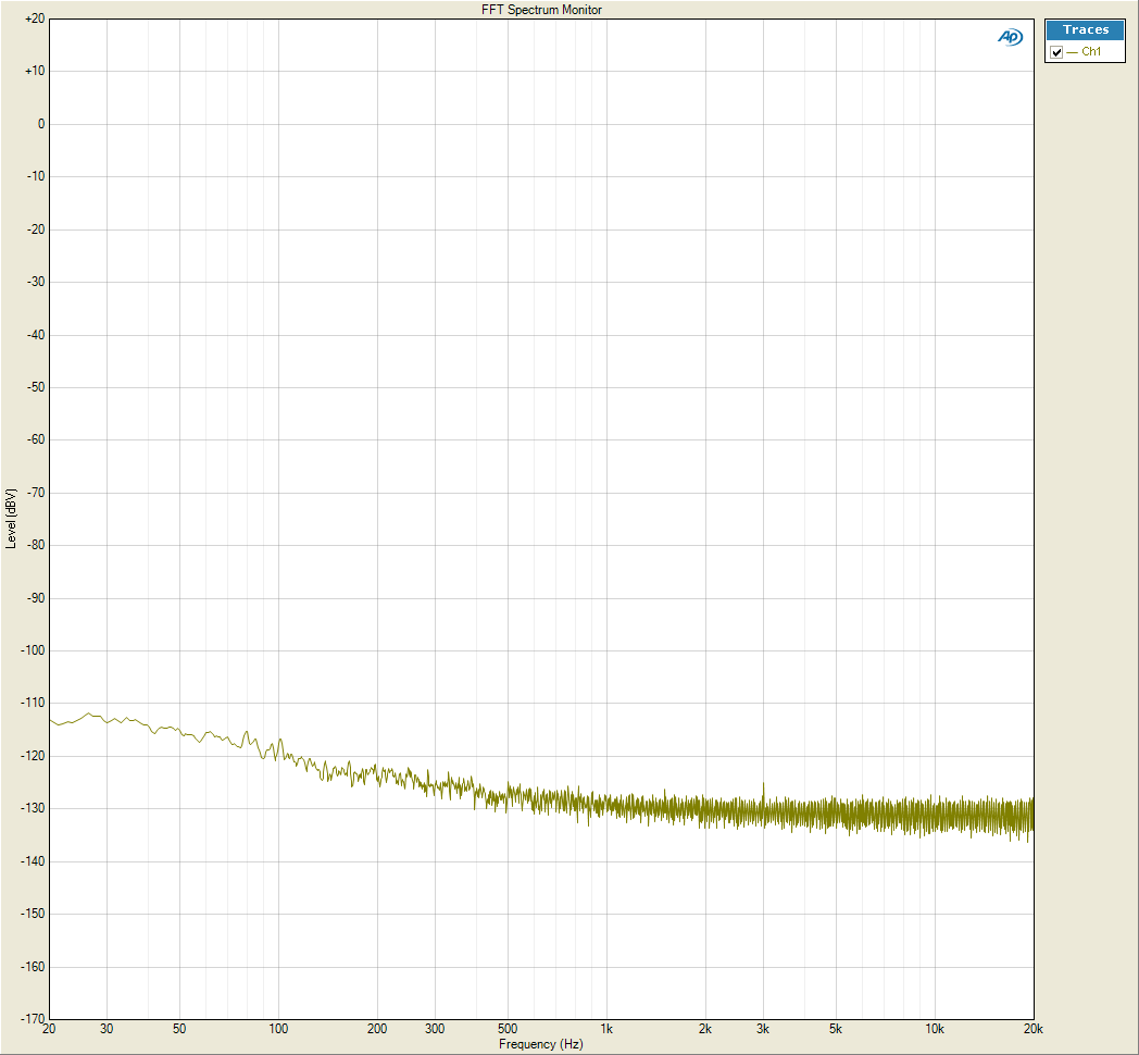

Hi Guys,

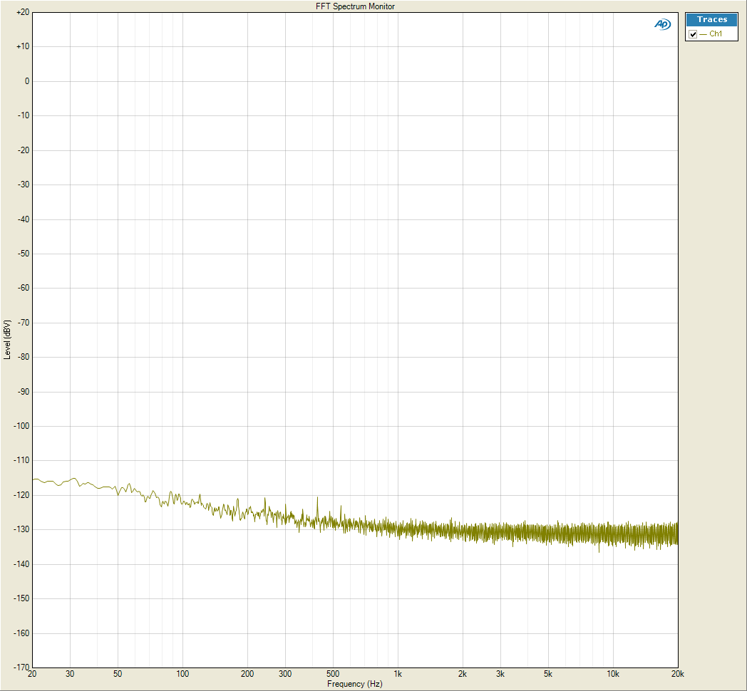

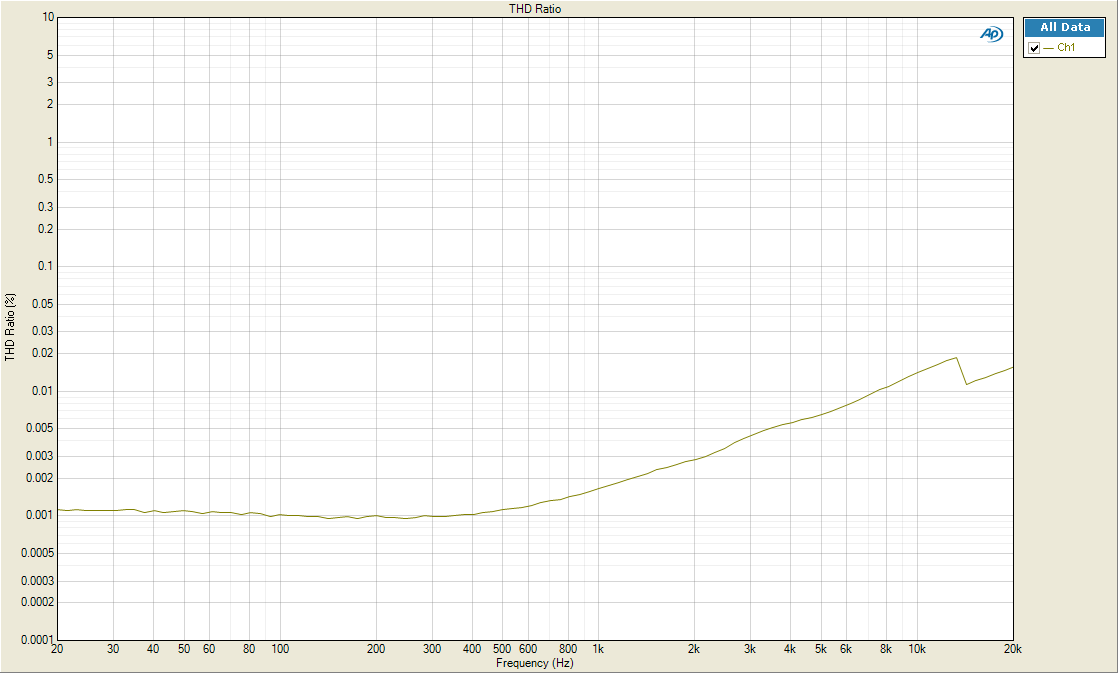

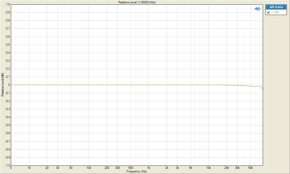

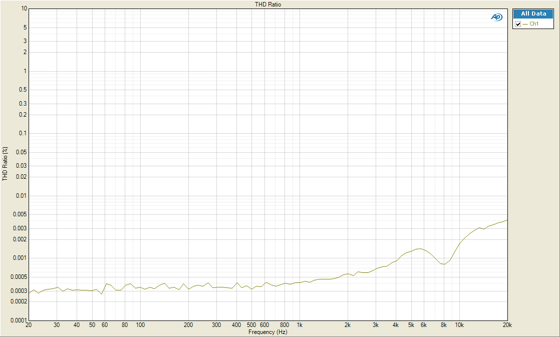

I've been working away on the power amp trying to get the circuit dialed in, and I think I've got the SE input setup for power outputs up to 150W pretty much dialed in.
I'm still tweaking a few things on the BAL input setup, and I still need to adjust the CCOMP filter for higher output power levels (between 150W and 300W)
I do have some measurements to post though for the SE input version under the following conditions:
- +/-42VDC on output stage - linear supply - 600VA toroid with 40,000uF
- +/-50VDC on input stage - regulated using PSU PCB.
- All 8 ohm load
- Gain = 29dB
- Input = SE
- Bias = 400mA
Here they are:

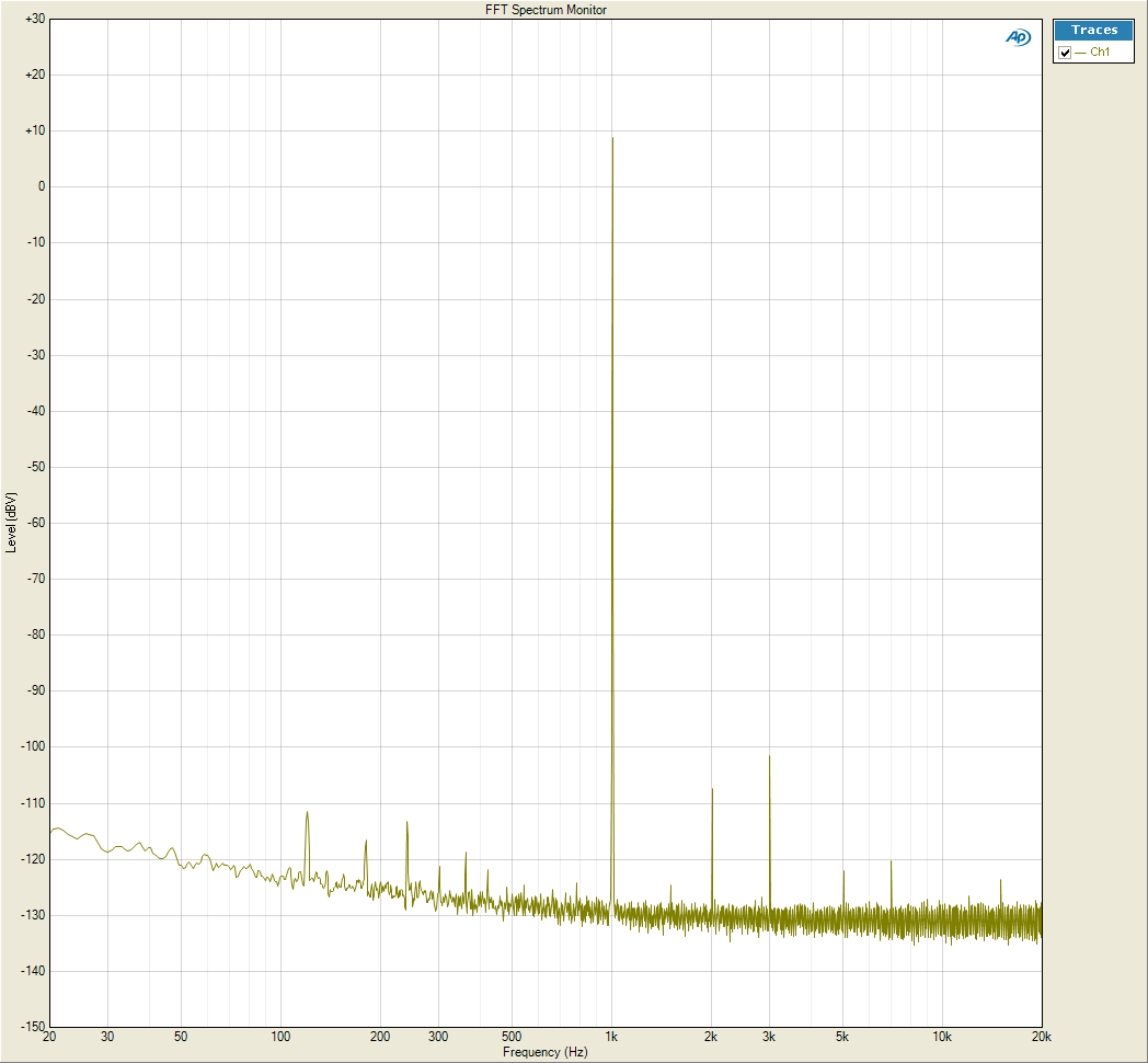

1. FFT with input grounded, measured across 8 ohm load
2. FFT with input connected to AP, measured across 8 ohm load
3. FFT @ 1W, measured across 8 ohm load
4. FFT @ 50W, measured across 8 ohm load

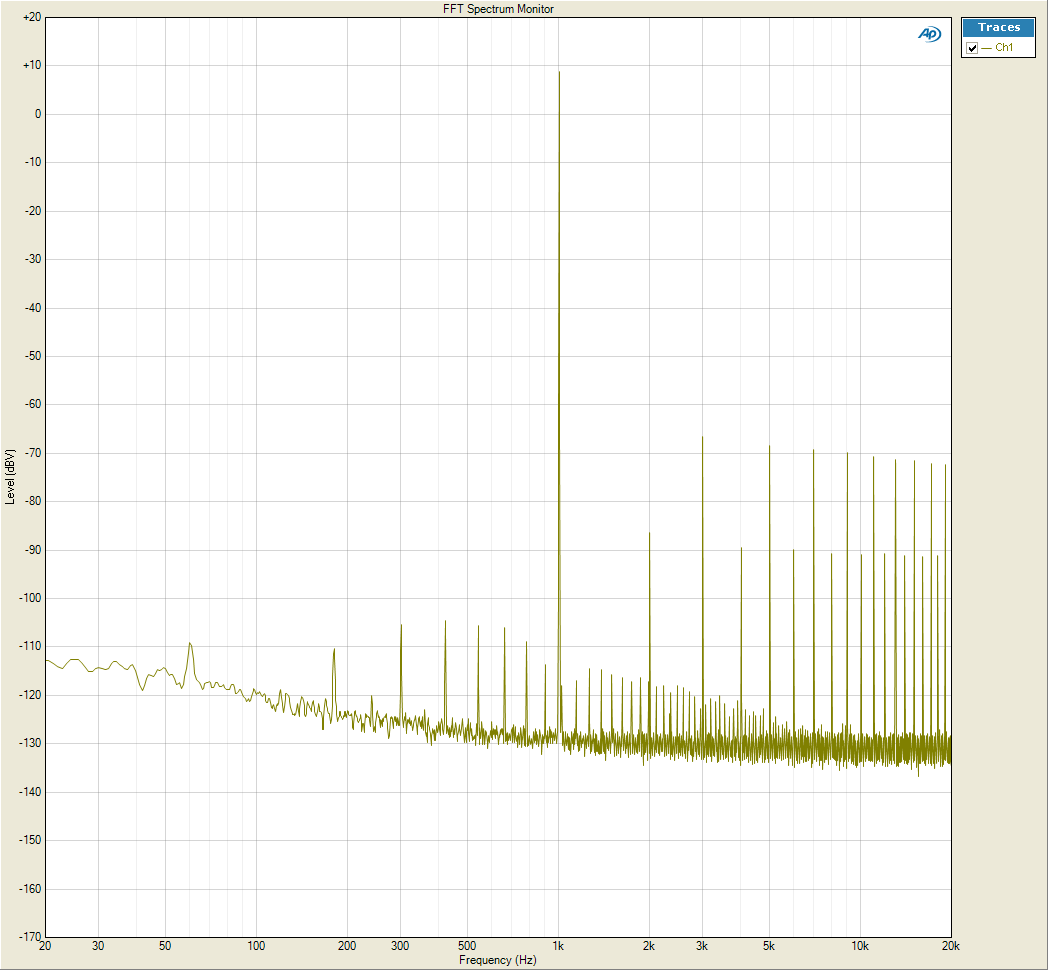

5. FFT @ 1W, Class B (not quite true class B about 5mA bias)
The FFT plots show that the amplifier has an amazingly low noise floor, and the regulated front end essentially eliminates all line noise from the system. The noise floor sits at an amazing -130dBV above 500Hz, and creeps up to a little over -120dBV down at 20Hz. This is one reason why good class AB will always be better than class D. You won't find a class D that can touch this level of quietness. The FFT for the 1W output shows the 2nd harmonic about 116dB down, and the 3rd harmonic about 110dB down. All other harmonics are more than 130dB down.

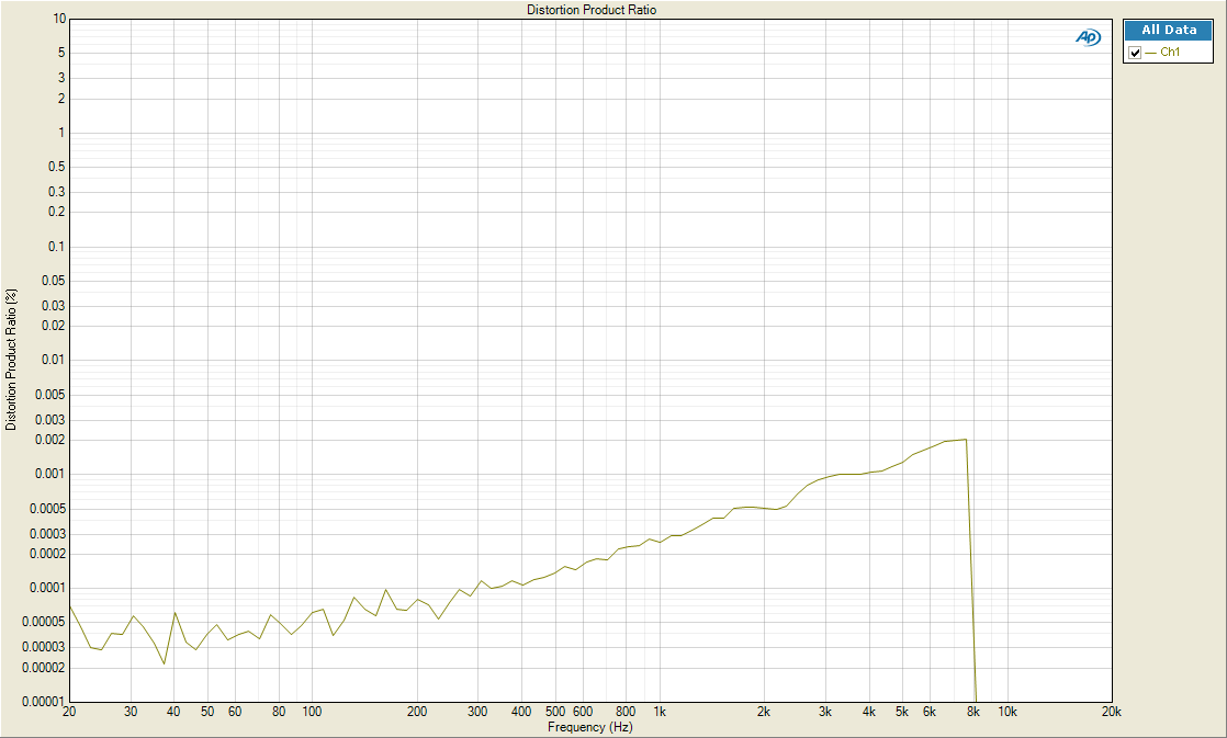

The FFT with the amplifier biased in class B is kind of a neat one. The odd order harmonics don't really get any lower and there are only a few dB between the 3rd and 19th harmonic! This is why you shouldn't use class B amplifiers for audio! To put this into perspective though, the horrible distortion show here is still lower than the noise floor on many class D amplifiers.
6. Frequency Response

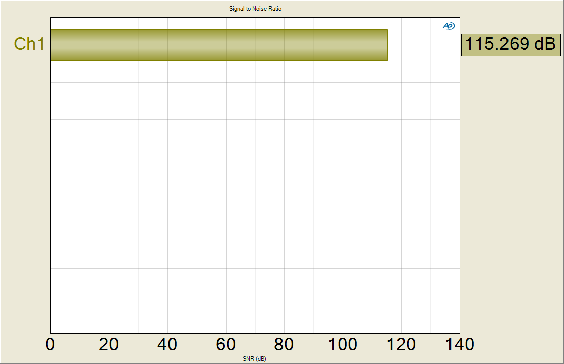

7. SNR at 50W

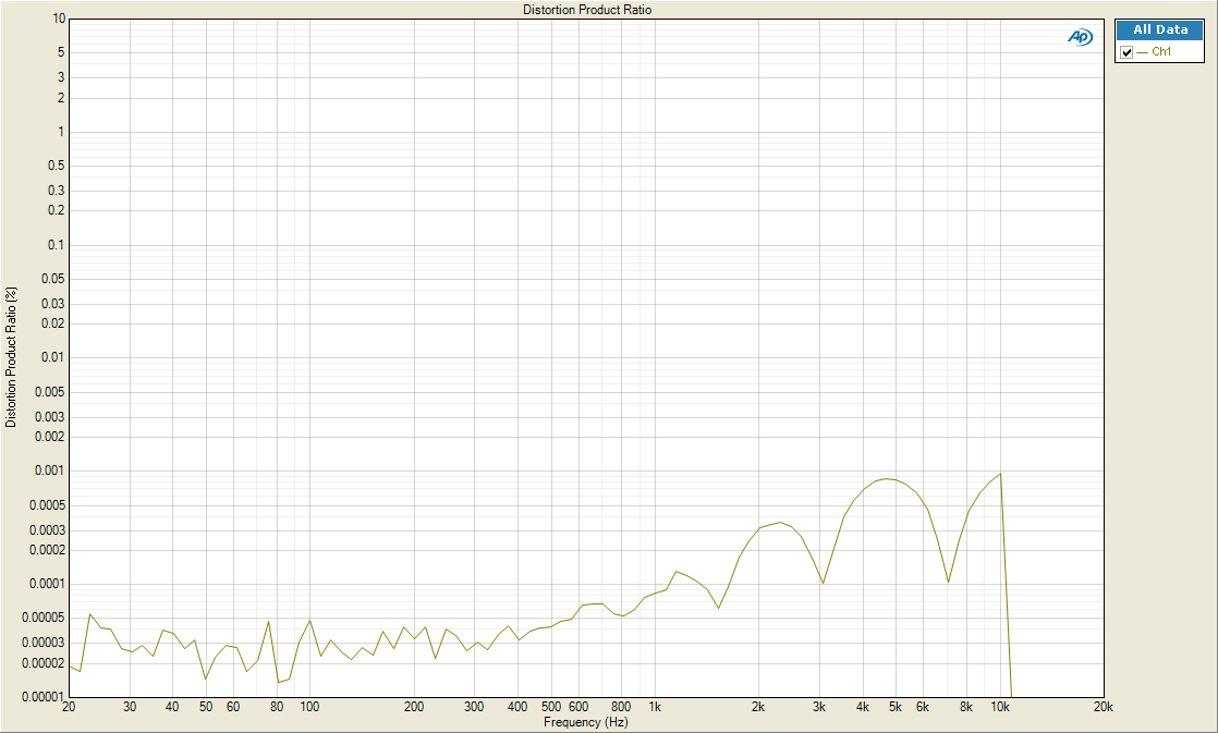

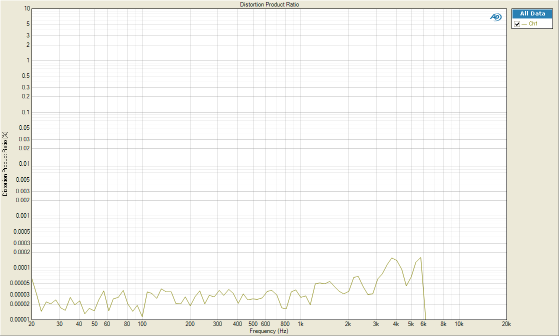

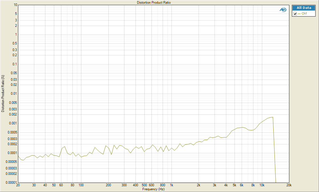

8. THD Ratio at 1W 8R

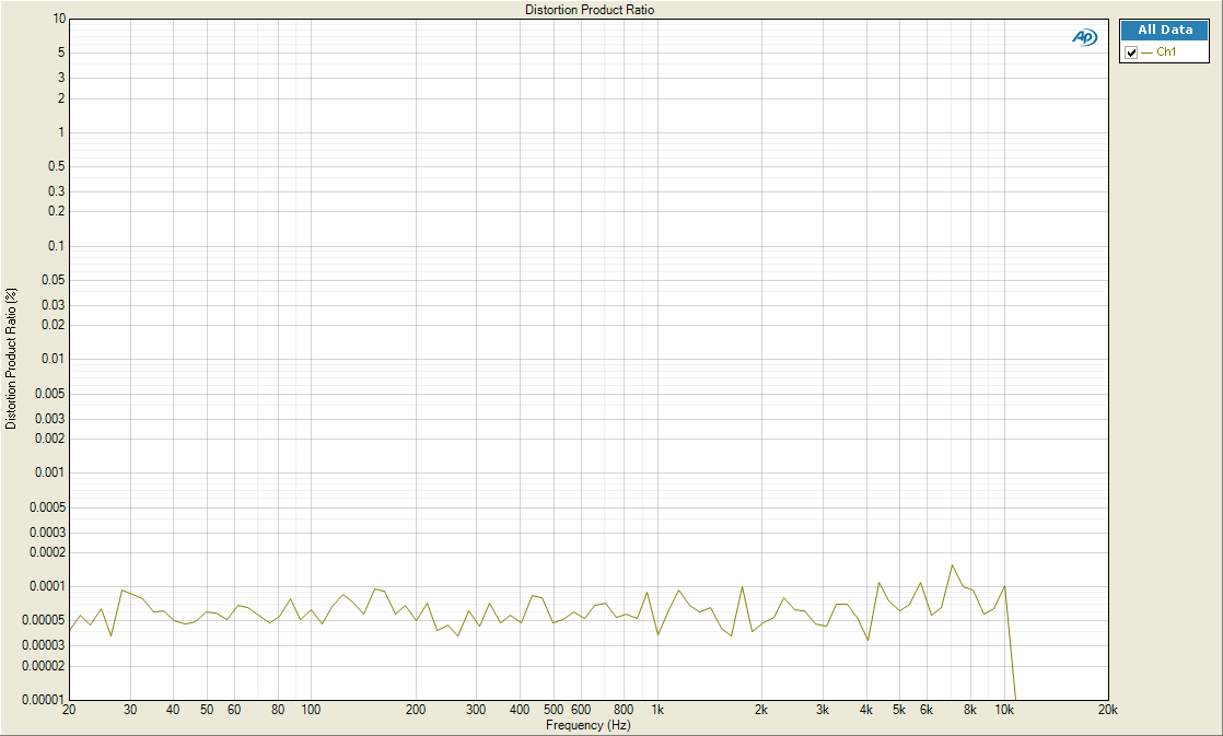

9. THD Ratio at 50W 8R

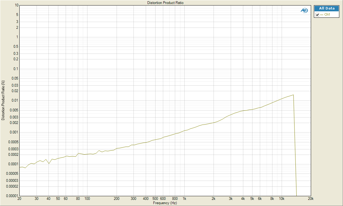

10. Distortion Product Ratio - 1W 8R
The above graphs are pretty self explanatory. More to follow!
- All 8 ohm load
- Gain = 29dB
- Input = SE
- Bias = 400mA
Here they are:
7. SNR at 50W

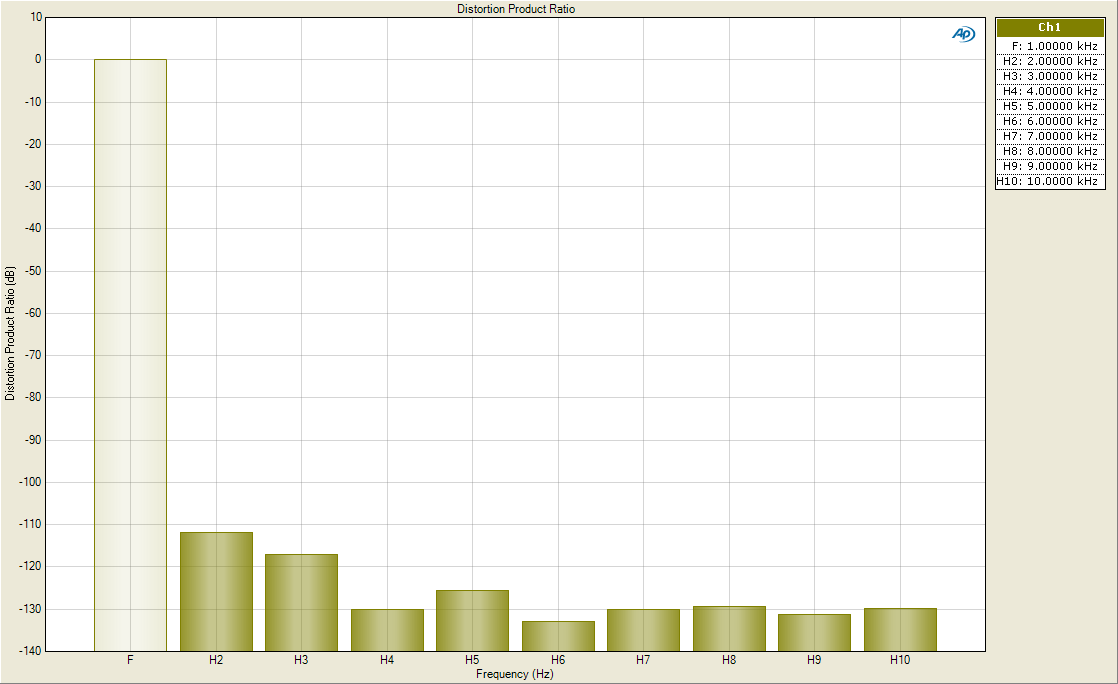

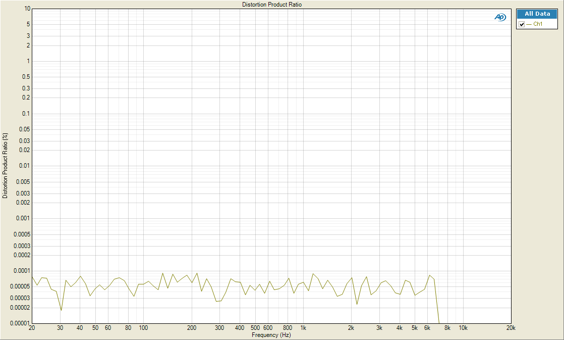

Next up we have all the distortion product ratios at 1W
And at 50W

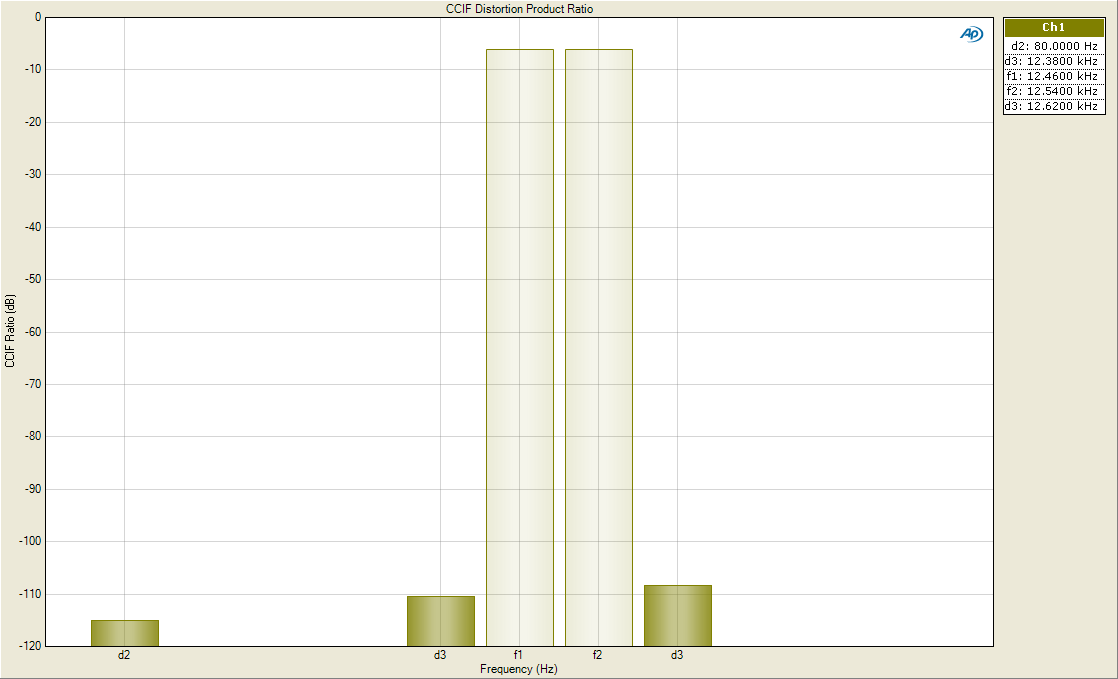

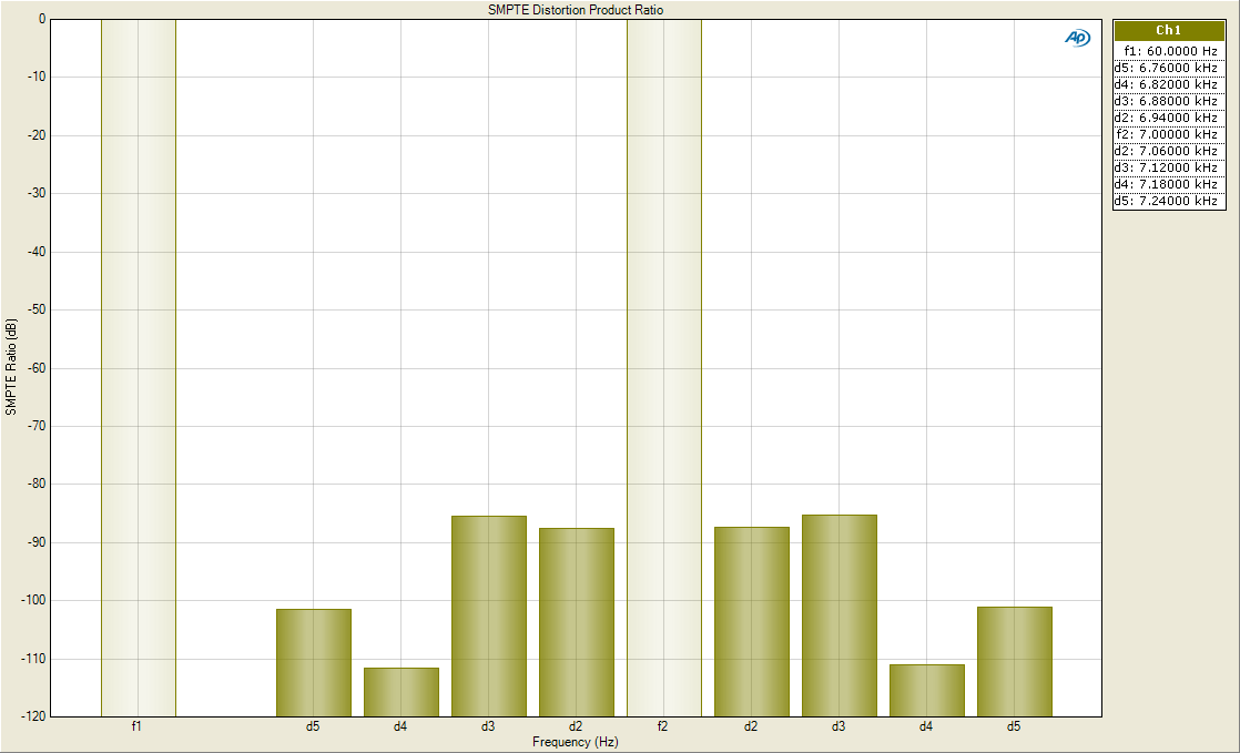

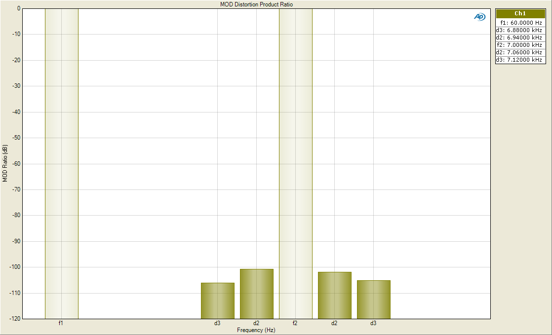

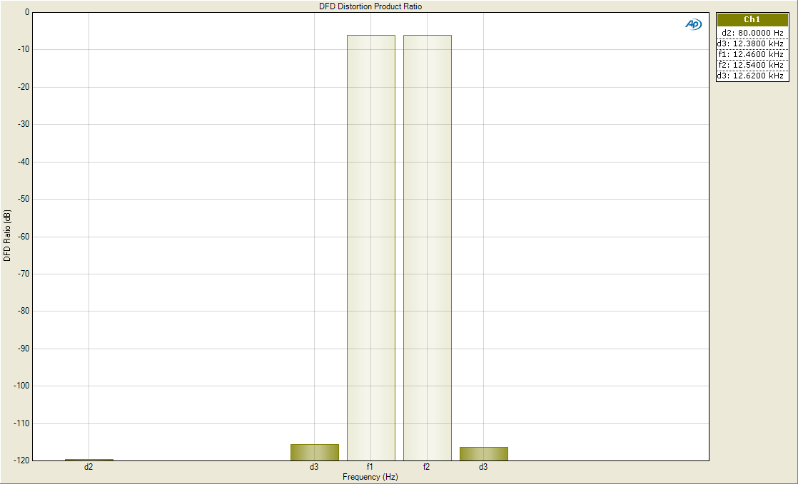

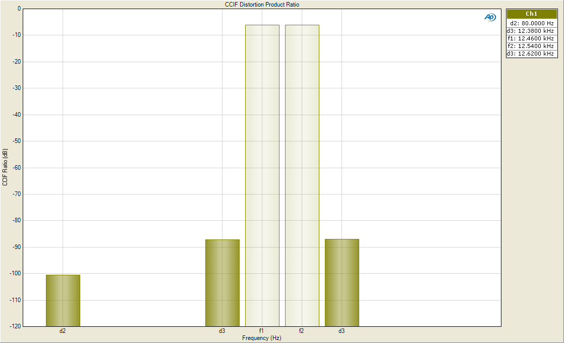

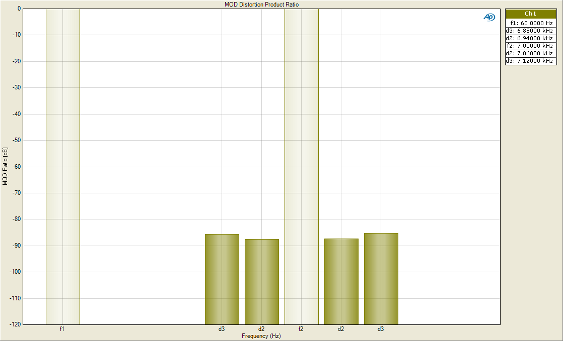

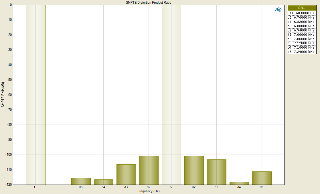

Lastly we have all the intermod goodies for those still interested:
