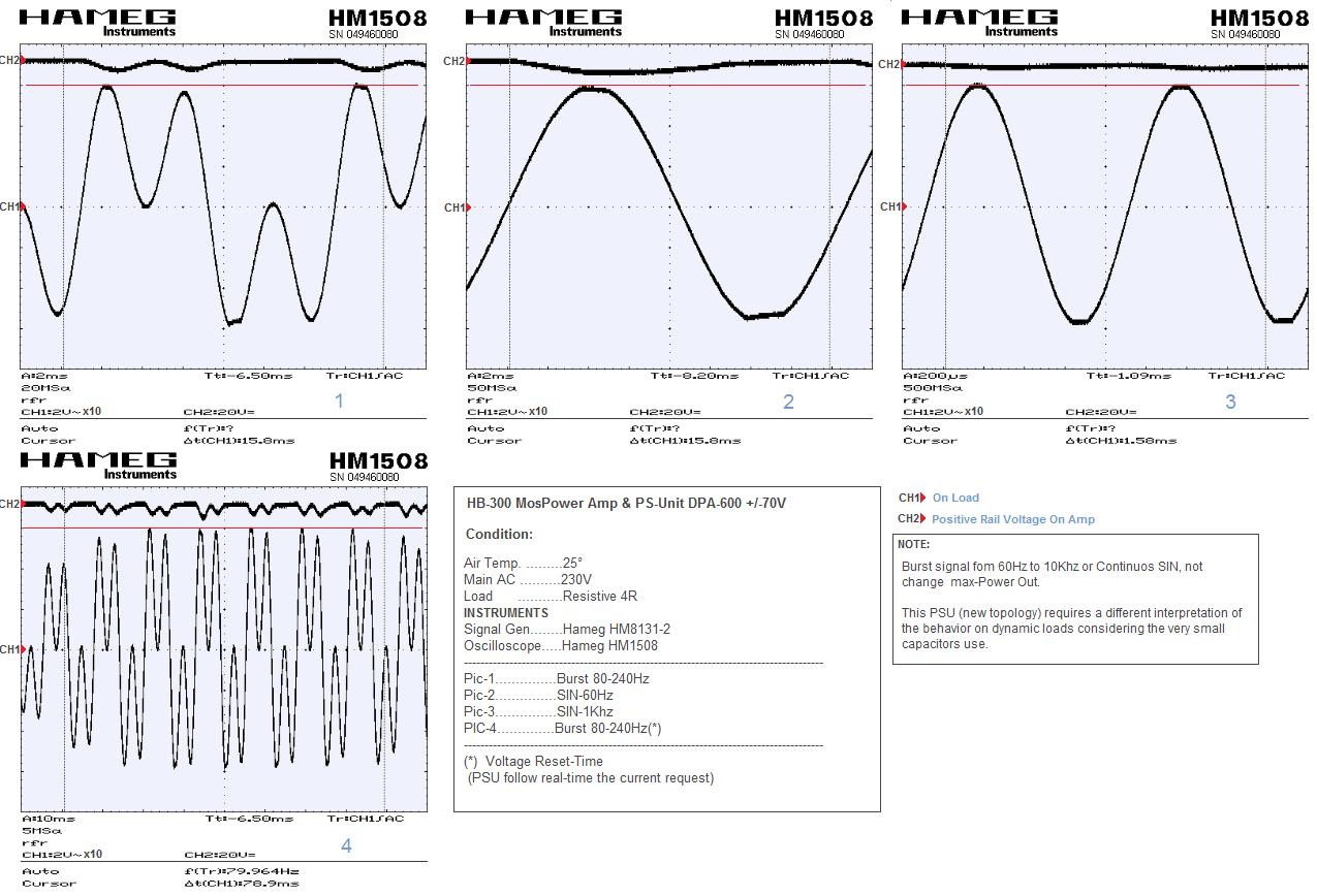

Excuse me if I intrude. Since the DPS-600 does not use large capacitors to store energy. (seen on pcb small capacity, just as a filter).
perhaps it can be helpful to show the behavior of the voltage rails with different types of signals, a MOSFET amplifier 450W rms AB. (see burst and continuous)

I would be happy if someone repeats these steps with any type of psu, and obtained the same results (independent of the size of the psu and capacitors).. 🙂

Thanks for the measurements! It's rare that anyone steps up with empirical evidence to prove performance.

The reason linear supplies like to have piles of capacitance on the output is because it's a brute-force way to compensate for the fact that there's no feedback, and hence no active regulation of the rails. A good SMPS, like the one shown in the measurements here, can have extremely good load regulation by virtue of the feedback used in the control system. If you performed the above tests on standard unregulated linear supply, the rail fluctuation would be immense, even with 60,000uF of capacitance.
You seem to be stuck on this notion that a whole bunch of capacitance can somehow make for better bass output, but that's just not the case. There is a lot more to the equation that just the amount of capacitance, and this is doubly true when you start looking at regulated supplies where the amount of capacitance means absolutely nothing compared to the regulation capabilities of the supply itself.
To put this into perspective, I've worked on an 800 watt SMPS designed specifically for a subwoofer that had a grand total of 4.4uF of capacitance in the form of two 2.2uF polypropylene caps on the output. It worked just fine, and performed significantly better than most large unregulated linear supplies. It's all about the design of the switcher itself, and the control loop. It has nothing to do with the amount of capacitance.
I'll do a head to head comparison between the linear and the SMPS, both measured and listening, and we'll see what happens.

Sorry, but I can not put the name of companies who are using this psu.
diy bought some and said they are happy, but I do not know how they put the forum post. one has in this forum. (quad404-AudioPower SMPS) (I know others, that will soon)
This SMPS has a very high cost of production, the components used and the manufactory (active power-unit and a special ultra-fast hybrid regulator).
The research on this new SMPS, is justified by the ratio size / performance obtained. This allows the creation of amplifiers with incredible realism of sound, stylish and ultra compact new design of case.
This SMPS has been designed for use in mono-block (one amp), then philosophy is that stereo is "dual mono". right way for a true audiophile.
I am happy that OPC head and publishing the results. AudioPower although, to date this has not pushed for DIY SMPS.
OPC .. I hope you have some very strong speakers. Perhaps no image, it produces a drop of just 400mV 600Hz to 20K form in terms of dynamics and timbre... 🙂
although I'm sure, that the first difference you will feel the right to 30-40w.
Yes, agree on feedback but i can not obtain this performances (response time and clean output) with traditional chip for smps pwm etc. then develop new,trafo is custom,etc..
