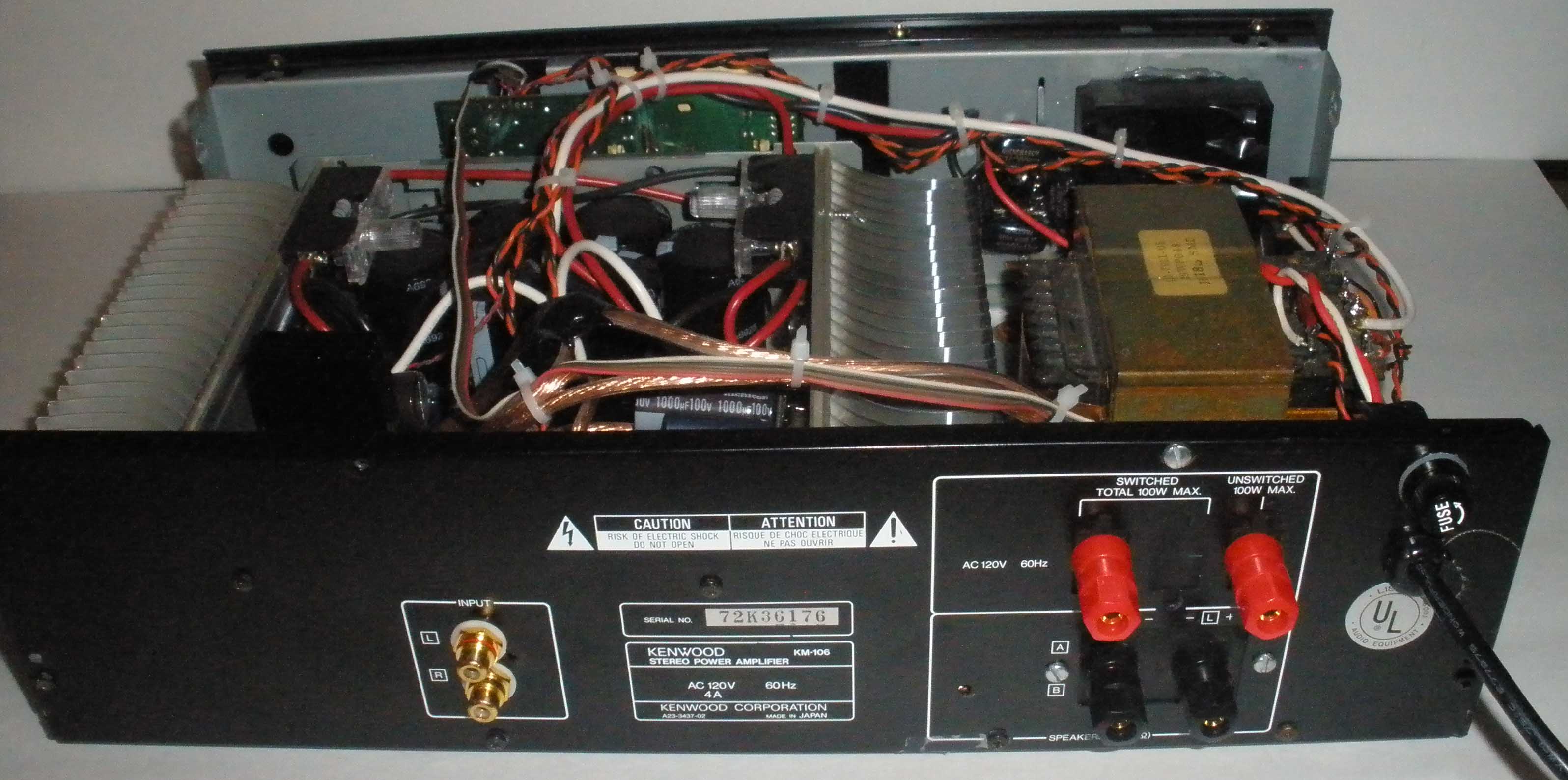

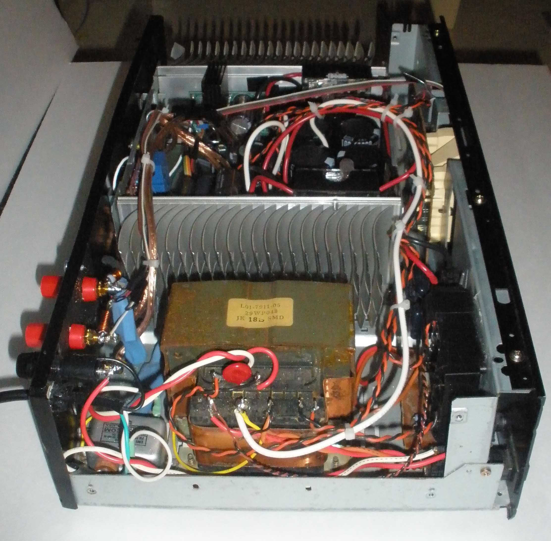

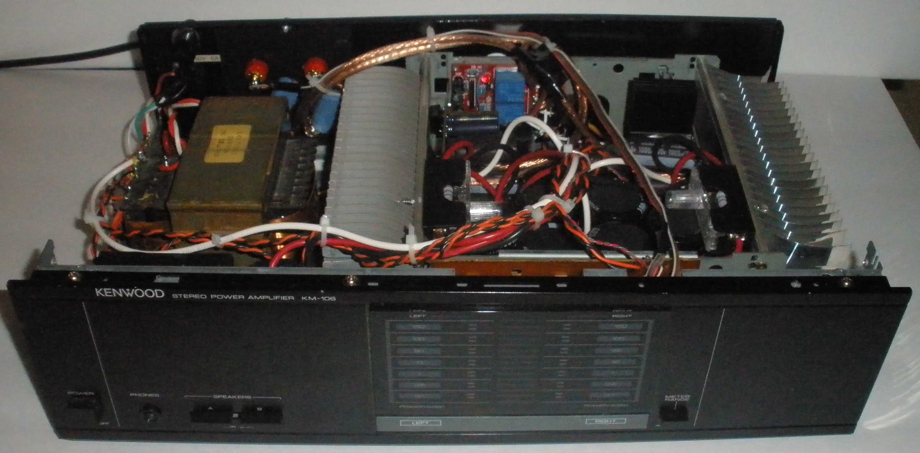

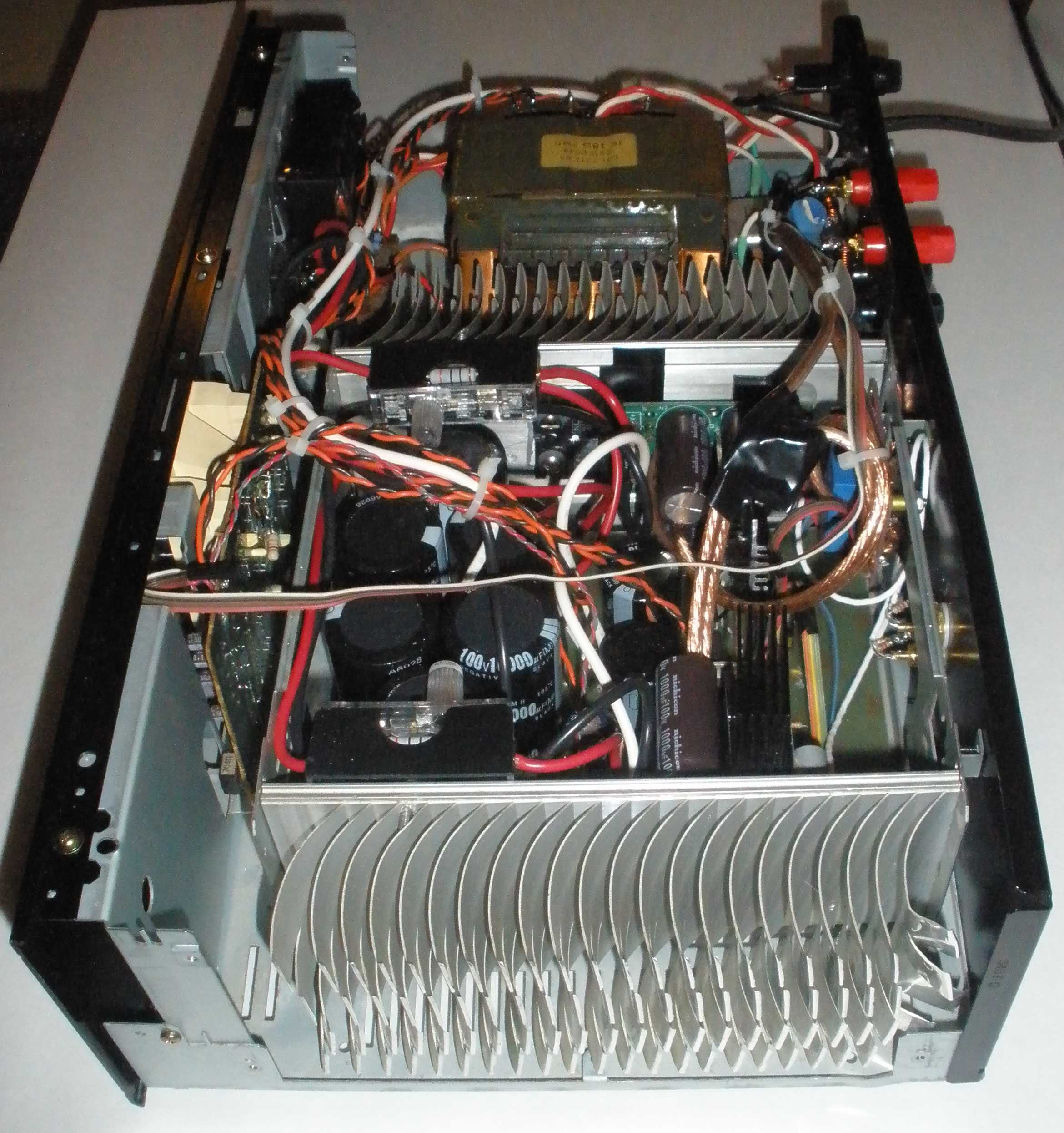

here are some pics. This is a 2 channel version, single ended input, one pair of output fets per channel. When I first saw the bare amp boards I thought it would be a piece of cake to put them into an old kenwood chasis. Boy was I wrong. I kept adding stuff and I had less and less room. To change a part on the amp boards now takes 1-2 hours of dissassembly and then reassembly. I was going to use one power supply for the front end and the outputs with 6 x 10,000uf caps. I was looking around ebay one day and came across some epoxy cast transformers 0-15, 0-15, 200ma output. I thought the transformer would fit perfect. It did. I had a bit of trouble adding another bridge rectifier and 2 more caps. There was a bit of space on the powersupply board to add a +24v supply for the front panel VU led display. It didn't take too much effort to add a couple more +/- 75v regulators for the LME front end. I moved the DC protect/speaker relay board to the rear heatsink bracket. I found a couple of socket fuse holders that had room inside for 10ohm resistors so I could check the bias whenever I needed to. I tried to keep the leads as short as possible, but I had to make some of them a bit longer to make service easier. I had too much trouble to twist the 14 guage power wires so I left them straight. Why did I use 14guage, because I had some. I added some output zobels and a coil near the speaker binding posts. You can see the epoxy transformer just below the transformer in the first photo and the socket fuse holders with the resistors just above the filter caps.
The build was not without grief, what looked like 120khz osscilation was an old CFL lamp on the work bench. Little 68khz pulses was the battery charger for my hand drill. A 10.6 mhz osscilation was the heatsinks not grounded. A 1.25 mhz oscilation was the output caps I forgot to put on the lm3xx regulators. I put 10uf close to the regulators and oscilation gone. I had a ground loop buzz when hooking up a cd player to play some music. I removed the 0 ohm jumpers on the boards to solve that one. I don't know what it sounds like as it is playing through some junk speakers.
With +/- 65 volts on the fets and +/-75 volts on the front end, power is a hair over 150 watts @7.5 ohms per channel just before clipping. My load resistors are 2.5 ohms. If you remember a few posts back I changed the feedback and input resistors to 30k ohm. I kept the original caps 330uf and the bandwidth at 10 watts is flat from 1hz to forever. I say forever as my generator only goes to 110khz. Before I put on the output coils and zobel, full power bandwidth was past 60khz with some obvious slewing above 100khz
The powersupply board is a single sided circuit board that I removed copper with a dremmel tool as needed. You can see where the dremmel tool slipped on the rear of the amplifier as I was trying to enlarge a hole for the fuse holder.
The amplifier has been playing on the workbench for a couple of days now and I will hook it up to the livingroom speakes when the wife is not home. She retired over the holidays and for some reason I don't have much free time lately.
