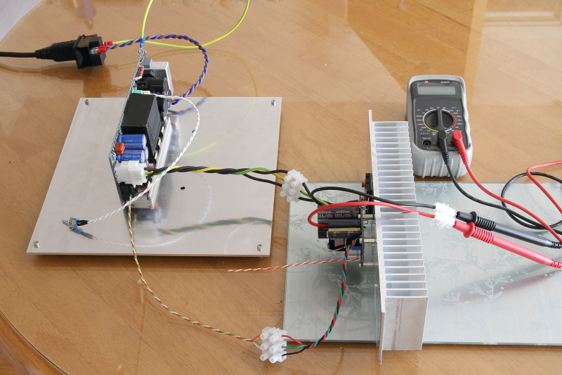

Fault finding...
Wow, this thread was way back down the list. Took ages to find...
For starters, not a huge up-date from me just more fault finding. Both dps-600's have been up & running after hurting them and one of the amps.
One amp appears to be running fine, however, it's reading 70 to 80 mV on the output with the dps-600. Need to check this with a lower V supply.
The broken & fixed [supposedly] amp was showing some high readings at the output and this [hopefully] has been traced to the P-channel FET. Please, is THIS the correct part?
The DPS-600's now won't start-up with a load =>50mA... Grounding issue perhaps???

Hi Paul,
Send me a PM with your address and I can see if I can mail you a replacement fet. I have a few extras and it will save you buying it.
You problem does indeed sound like grounding issue, as that's the only thing I can think of that would cause a DC offset that high. The only other thing might be grossly mismatched rails on the LME, but even that shouldn't be an issue.
What version are you building? Did you follow the guide closely?
A few pictures might help as well.
Owen

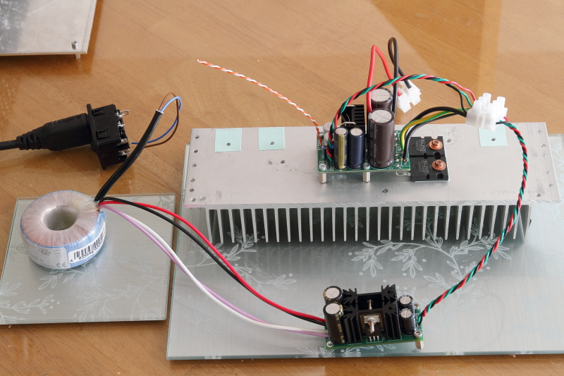

Thanks Owen, PM sent...
Amp setup, SE AC coupled build spec as per build guide.
Amp A - Setup A: Bias; minimum, single The Wire psu +/- 23 VDC rails. Measured 1.4mV offset at speaker output. Measured 2.5 to 3 Vdc spike on powering off at speaker output.
Amp A - Setup B: Bias; minimum & 360 mA, dps-600 +/- 55/45 VDC rails. Measured -0.8mV offset at speaker output. Measured 2.5 to 3 Vdc spike on powering off at speaker output.
Amp B - Faulty / blown P-channel fet. Replaced LME, mute components and a few smd caps.
DPS-600 - Initial power up using soft start switch, OK at 360 mA bias.
DPS-600 powering down to power up behaviour [on off on]: bias => 50mA
< 5 sec gap, power up failure.
=> 5 sec gap, power up successful.
Grounding - Uncased, both the remote soft-start switch [dps-600] and small wire on the signal input, cause slight variations on the measured offset as they are moved / touched.

This sounds like DPS600 protection taking time to reset ...
