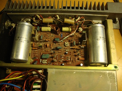

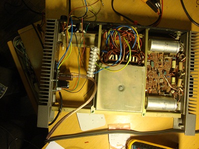

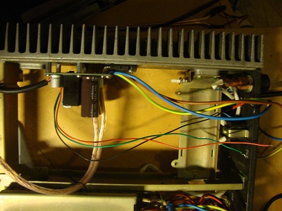

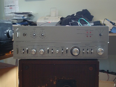

Well, at last found out how to add pictures to message😱
Both amps are running and behaving well, DC offset on both outputs is about 1mV.
Did some mistakes while assembling, luckily didn't blow up anything. One mistake to mention, i used screws with too large head for mounting, screwhead touched ac coupling cap. That made DC offset on one amp to rise to 70mV, second amp started to oscillate.
At the moment lme's and fets are running on +-32V unregulated, will try to fit into frame separate regulated +-40V psu for lme's.
Maybe a dumb question, would it be a good idea to add some additional capacity to fet rails? Now there are only 1000microF caps on pcb.
