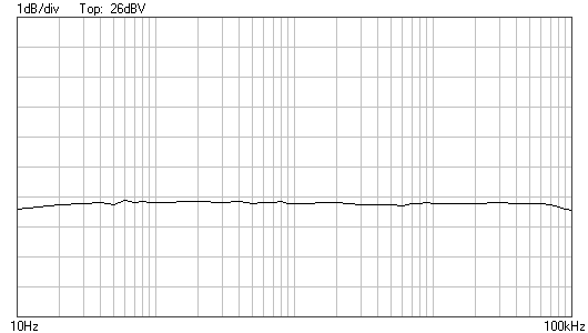

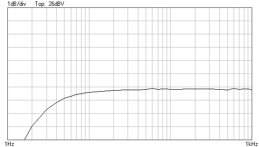

Well, at last got wrapped my first amplifier. Built by manual, SE AC coupled inputs, +-32V unregulated on fets, -40V regulated on LME-s. Added are 9,9mF caps per fet rail for each amp.
Did some measurements using Velleman PCSGU250 PCscope. Output loaded with 11ohm resistor. Looks pretty much linear from 10Hz to around 80KHz. Scope is an entry level measuring device, reading differences between 20Hz and 60KHz are smaller than scope accuracy error.
Attached are graphs and measure tables for 1Hz-1KHz and 10Hz-100KHz

looks like you need to add some RF attenuation to the input.
F-3dB @ around 160kHz to 320kHz may sound like you still hear everything available in the treble.
That would convert to about F-1dB @ 70kHz to 140kHz.
More roll-off than your plot shows.

Yes........ you mean it would be good to use a low pass filter on input? ..........
You may already have a passive RF filter on the input.
I cannot tell from the plot what RC you have fitted.
