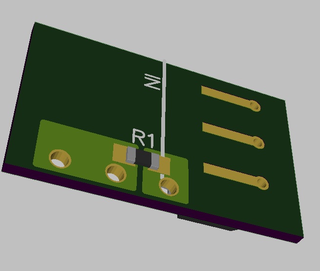

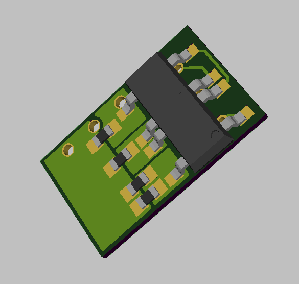

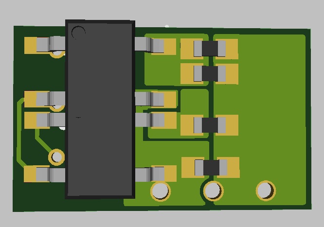

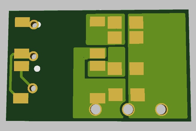

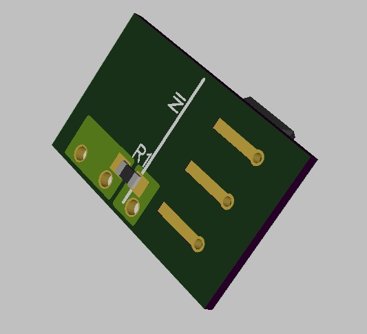

OK parallel it is. heres the 2 layouts. option 1 was the version that places the relay in series with the first relay (in order to put the resistances in parallel 😉 ) looks neater/cleaner, but looks can be deceiving. the 'IN' point is just showing the direction to solder the control voltage connection, not indicating the CCS input
its 14mm x 8.75mm
its 14mm x 8.75mm

the settings will be completely up to you, people can set it how they like. yes the idea is to start up into ~110ma (below 100-110ma the ALFETs are not neutral tempco, so I would not recommend 90ma) then select one of 2 other settings depending on temperature or your heatsinking, or just preference for higher class A bias. actually they are speaking of the ALF08N20V rather than ALF16N20V in that app note, but it probably holds true to some degree.
the highest bias setting is just a single resistor, with no relay, right next to the pins directly across them. Actually I have put 2 parallel resistors for the high bias position to allow more accurate tweaking and 2 parallel for the lowest, to again make it easier to achieve a low bias. the middle bias setting (one relay open) only has one position, as I feel this is probably less critical. we may end up going with a thin film resistor network instead of discrete resistors, if that can be made to work.
so R1A, R1B (front and back directly accross the pins) is high bias, R2 with the relay open places that in parallel to create the mid setting, then the second relay opens to place R3 in parallel and create the low/start up bias.
