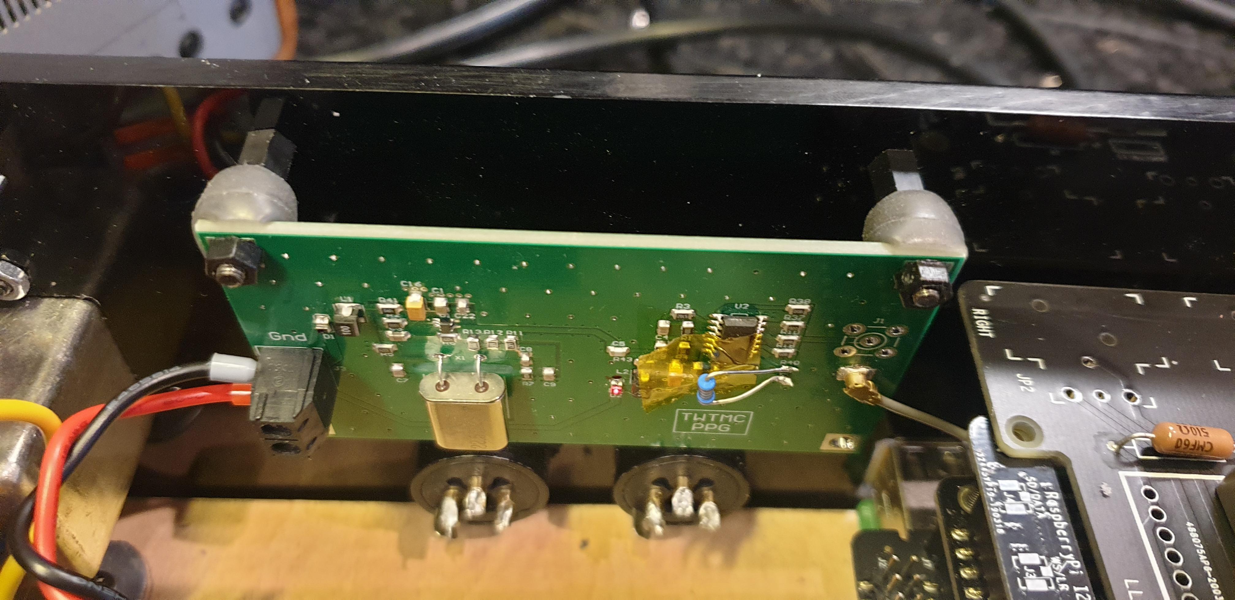

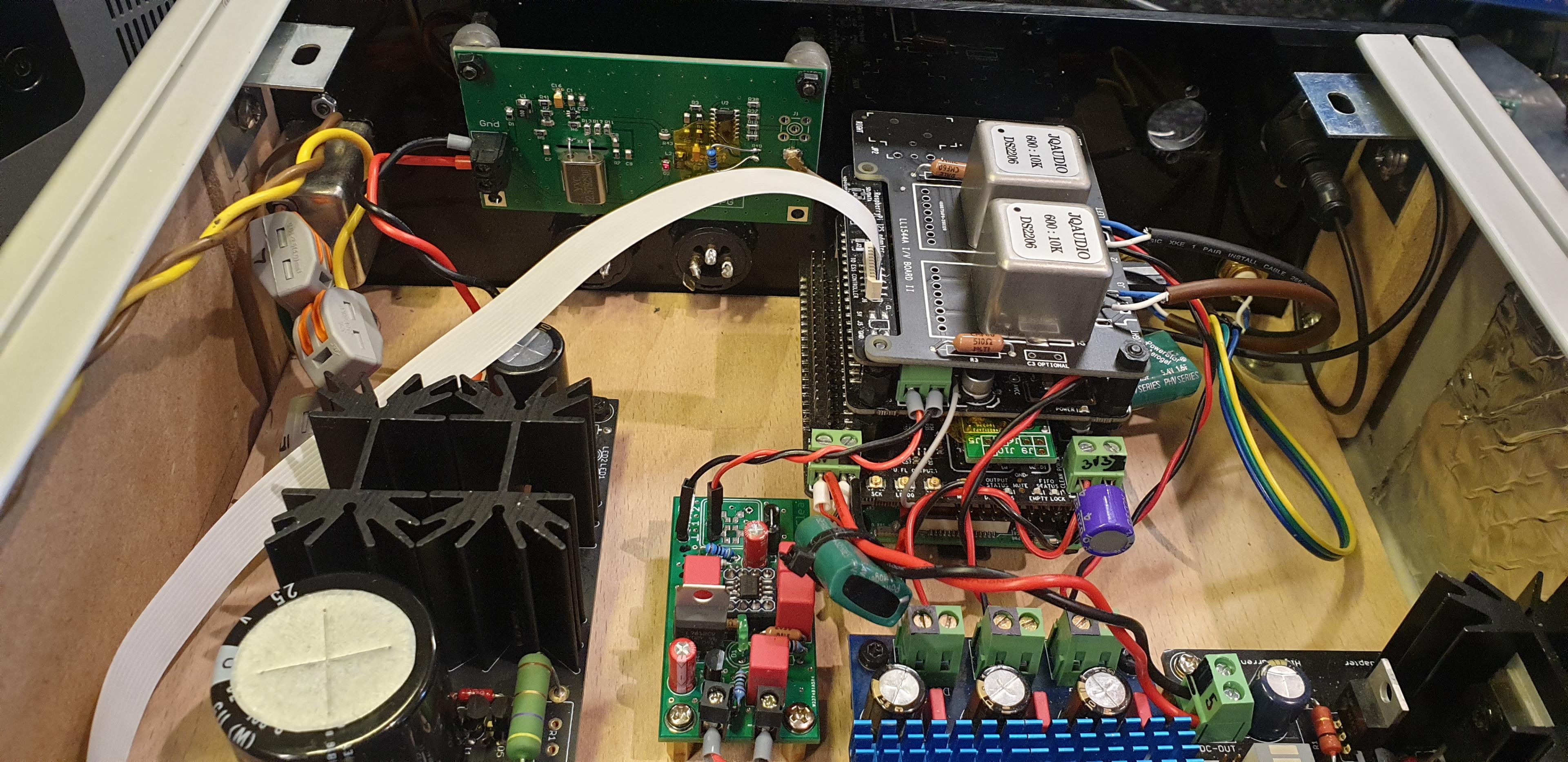

I thought I'd add a couple pictures. So I'm not really 'up there' with you guys and the SoTa drixos and exos but this is still a nice upgrade over my previous Crystek and NDK SDA. Hopefully this helps a few members just onto the ladder of adding better clocks.
Powered by a Salas Ref D...maybe ill change to a Ubib or even might try a much smaller psu such as a PFM Flea.
Feeds Ians Fifo via Ufl and Andreas DIP 8 adaptor board.
It is mounted with earbud silicone covers. Just hangs off the top 2. Far from ideal and is close to the AC inlet but it is working nicely until I can implement a separate chassis for it.

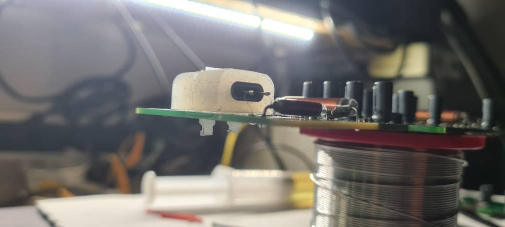

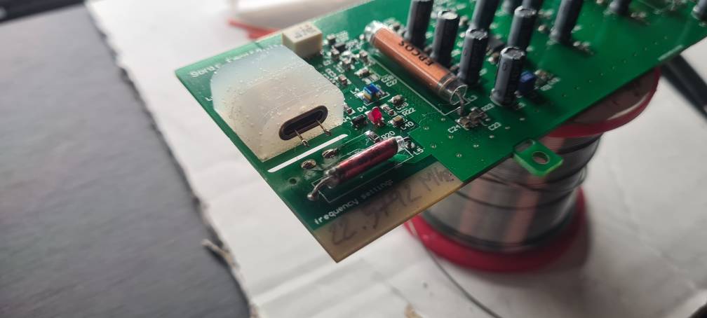

If someone is interested, that's how I isolated the quartz from the pcb.
From my tests this resulted in the lowest transmitted vibration ratio.
The silicone cast was subpar for my standards... But i want the job done relatively quickly and after the second attempt i call it good enough for me [emoji4]
Surely not the "ultimate" way (whatever that means)... But surely it was the best among the options i have on the table at the moment.
The second "barrier" will be an elastic external case suspension dampened with some proper mass to de-tune the system for the low freq vibration response.

... the mold was done with a 3dPrinter (ABS filament).
Done in two pieces in order to get released the two pegs that went trough the board in order to mechanically fix the silicon cover.
The pcb was drilled in two specific points and then the pegs was dragged trought them.
silicone used is "prolastix" from "prochima" (an italian company), shore 30 (tested 10-20-30-40, 30 was the one that attenuated the broadest vibration freq. spectrum).
If someone is interested i can share the STL files (keeping in mind that is good for f's > 5-6Mhz due to the phisical dimension and board constraints)

Which shore scale? Which frequencies did you test? What was the vibration test setup?

Shore "A"
sampled at 500 / 1000 / 2000 / 4000 / 8000 / 10000 / 20000 Hz.
the eccentric mass was selected each time to be in a manageble range.
The comparison was done for each "solution" vs each frequency.
Used a purposely built test bench that i was using at work during some similar tests for a product i was developing the past year.
Vibration generator was made with an eccentric tunable mass with a servo controlled motor.
The sensor is a flex pcb with accelerometer attached at the end. the weight of the quartz case was very similar to the one of the accelerometer/pcb assembly, so in this case i was not adding any additional mass to the sensor probe.

I'm jealous. Would be interesting to try some silicone gels.
Also, how did you mount the board for the test?

the board was put inside the hammond box with polyester "wool" wrapping around the board (as suggested by Andrea). Then the hammond box is fixed to the "vibration" table.
