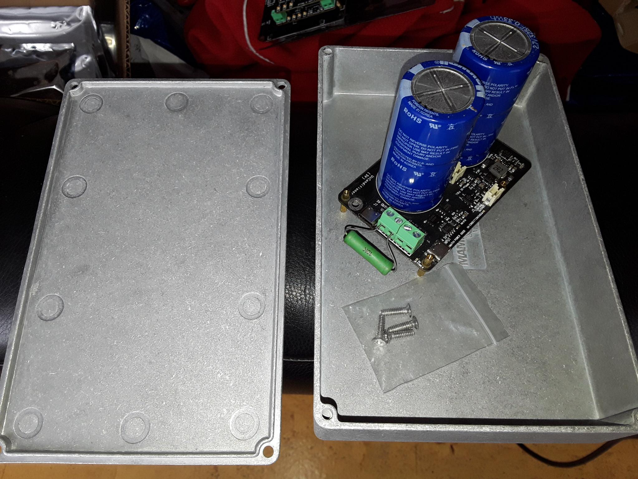

Hello,
I just ordered 6 of these in Germany.
Enclosure DC-DD :: Diecast Aluminum :: Enclosures Boxes :: Electronic Parts :: Banzai Music GmbH
They look very similar to the Hammond ones. The Hammond however use 6 screws to close the box. They are deep enough for the Drixo and more than deep enough for the DBM circuits.. . But i think 6 identical boxes next to each other will look nicer.
There is no coating or paint so no need to scratch things to achieve good screening. One review ( elsewhere) mentions a good enough screening to make a mobile stop working. He had a Samsung and an Apple, one stopped the other didnt. Of course can increase thickness of the box by attaching a sheet or a U shaped panel in the clock area. Probably the complete board will try to communicate with neigbours.
If it surely wont make things worse it will be cheap to just add aluminium. It will at least make things more soundproof.

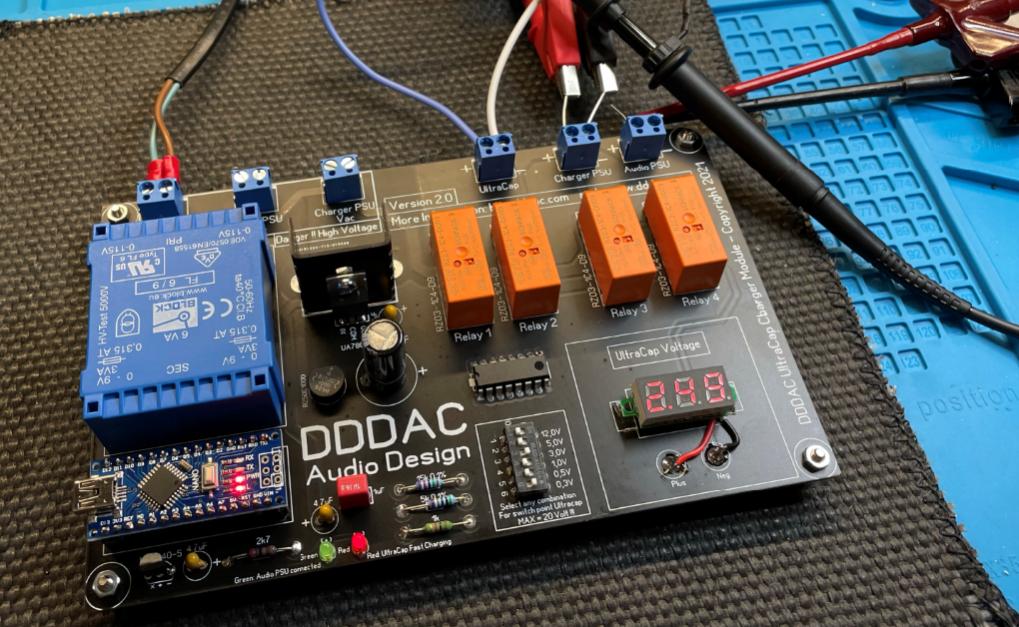

Hi Eduard,
There is no terminal for Power. It is supplied through the power and ground pins that would power any standard 8 or 14 pin time base. If you are going to power the STS directly be sure not to connect the power pin to the fifopi but do connect the ground pin. Otherwise the normal clock power from the FIFOPI will power the STS.
I am unclear what the purpose of the 10K resister is in your picture unless it is just there for testing. It will not drain ian's ultra cap as the output is disconnected when the input power stops. As recharging can take several minutes from a totally discharged state, why would you want to fully discharge the ultra cap? Also you will need to disconnect the STS and anything else powered by the ultra cap if you do fully discharge it, as the current will go up as the voltage drops and the circuitry will not be happy under these conditions.
