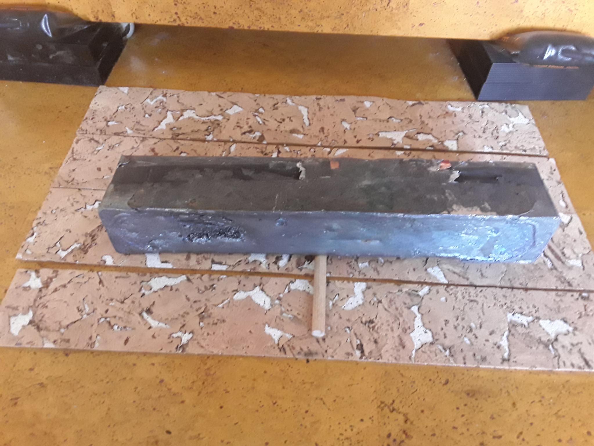

Maybe you could add weight to the clock. You could cast a lead housing . With a cavity inside that will allow you to fix the clock with something that will prevent the lead acting as a heat sink. Then mount this housing onto the board with a single vibration damping element that is optimized for this load.
A Japanese company called Taica makes them . NOT sure if they also make them for very tiny loads. Available at Mouser.
ALMOST sure that if you execute this well it will be worthwhile .
Greetings, Eduard
P.S As you can see in the attachment i have worked with lead before
Greetings, Eduard

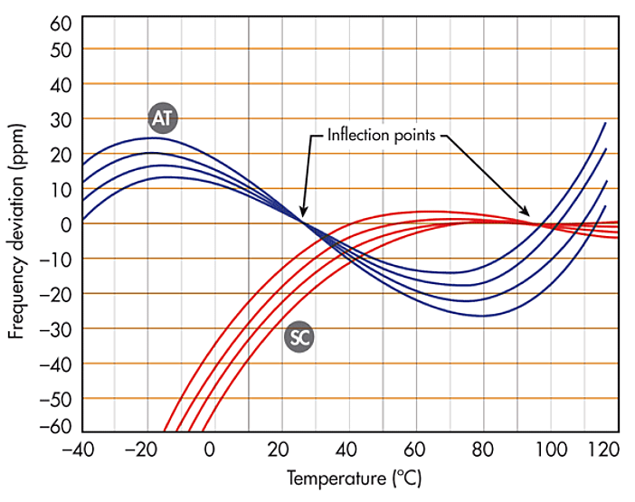

I think there are some misconceptions about temperature. Laptech publishes a temperature at which each oscillator produces optimum phase noise. In the case of the last GB, my 45/48MHz crystals came with specific temperature spec around 85C that corresponds to their published Q. I believe that Andrea found that temperature was less important for the performance of the 5/6MHz family and implemented without the oven making our lives much simpler. If you were looking for the ultimate performance I guess that temperature stability and a specific temperature would be the answer.
can you link me to the document you are referring to ?
As I explained several time in digital audio we look for short term stability.
Long term stability does not matter unless you have to synchronize other devices.
If you need long term stability you can add a oven by yourself.
We have tested the oscillators with and without the oven and since there was no phase noise difference we decided to avoid the complexity and the cost of the oven.
So there are no plans to implement the oven.

i suspect, and is just a suspect, that the thermal data is referring as measure of how much/what is ideal when laptech's are used for OCXO's.
not every quartz can handle the temps usually needed for an ocxo with ease, and who has the technology that keeps optimal phase noise at ocxo's temps then surely is good marketing material.
The phase noise measurements are related to the oscillator and not to the crystal.
The crystal itself does not oscillate so there is no way to measure its phase noise until it's operating in an oscillator circuit.
The temperature specified by the crystal manufacturer for a SC-Cut crystal is the ideal temperature at which you get the exact oscillating frequency and the best long term stability.
SC-Cut crystals have a specific inflection curve related to the temperature and usually the inflection point is placed in the range 80-100°C, so they need an oven to operate at this temp point.
The operating temperature does not affect the short term stability, there are no phase noise difference at 25°C and 90°C.
As I already said we have measured the phase noise with and without the oven and there was no difference.
AT the time of the last GB when ovens and temperature were a consideration, we received the test data from Laptech with our crystals.i am sure of that !
