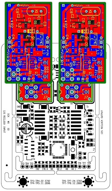

Here attached an image showing a way to connect TWTMC boards to Ian's boards (the first otion is showed).
Where I wrote "Xo adapter ???" means that we need Ian's support to understand what his adapter can accommodate. U.fl. connector if possible or direct soldering on XO adapter pads.
The document "Ian_Form_Example.pdf" is an example that show how to fill the document "TWTMC Parts Options & Assembly Service" provided from Phil.
Thank for the layout Andrea,
2 adapter types provided by the G.B of Ian
1 partagé sur ZimageZ
2 partagé sur ZimageZ

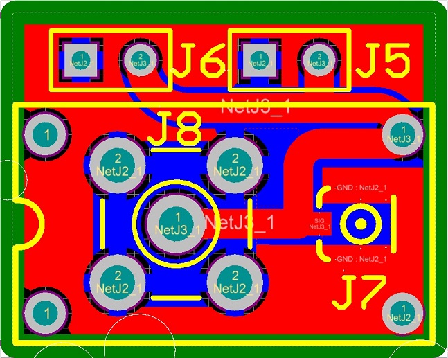

Im thinking about doing something like this for Ian's dual XO board:
Also Andrea will there be any performance degradation if I use /2 divider to get 22.xxM from 45.xxM XO.
This is not optimal to connect a good XO in this way?,the ground is not active?
The best would be to make a PCB with connection SMA.
"Also Andrea will there be any performance degradation if I use /2 divider to get 22.xxM from 45.xxM XO."
How would you respond to that Andrea.🙂
Good question. Difficult to say.
Usually the lower the frequency, the lower the phase noise.
In this case we have 22/24 MHz fundamental and 45/49 MHz 3rd overtone.
3rd overtone crystal, typically, has higher Q, that theoretically means lower phase noise. Also, dividing by 2, phase noise decreases, but the active device used to divide, introduces itself some jitter.
I believe we are in the mid-stream.
If I could use both indifferently, and I had a gun pointed at my head, probably I would choose 22/24 Mhz. But I have no specific reasons to support the choice.
Would be curious testing both frequencies with Ian's FIFO, and listen to the result.

The ground is connected.
The top pin is connected to output and the lower one is to ground.
