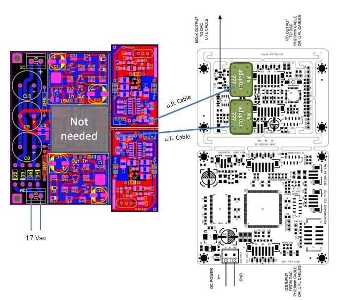

BTW, I think you have to use one of the following:
Dual XO, FIFO buffer
1st option: the two TWTMC-C (J1/J2) have to be connected to Ian's Dual XO clock board via u.fl. cables, using Ian's XO adapters. Output will be taken from Ian's Dual XO clock board. TWTMC-D&D has to be used for power supply only.
2nd option: using Ian's Dual XO clock board for automatic fs detector only (one of the two OE pin of the XO sockets of Ian's Dual XO clock). Two TWTMC-C have to be soldered with TWTMC-D&D; master clock via u.fl. cable from TWTMC-D&D (J13/J14) to Ian's FIFO board J6. Output taken from Ian's FIFO board, without any reclocking. TWTMC-D&D will be used both for power supply and switching logic (RF relay)
3rd option: no Ian's Dual XO clock board. The same as above, manually switching between the two XO (unless the source provides automatic fs detector).
Using the first option, you need both Ian's Fifo and Ian's Dual XO clock.
You need two TWTMC-C XO (eg. 22.5792 MHz and 24.5760 MHz) and one TWTMC-D&D daughter board, that will be used to supply the two XO boards.
So, you have to select "Rectification and filtering" + "Regulators on board" only.
You cannot use Ian's Dual XO clock board to supply the two XO, since they need two rails, +15V and +3V3, while Ian's board provides 3V3 rail only.
The two XO will be soldered to the daughter board using the pin strips for the power supply only (XO-1 Vo and Vs pins, XO-2 Vo and Vs pins of the daughter board).
Seems Ian's XO adapter does not provide footprint for u.fl. connector, so you have to adapt it on the board, using clock and ground pads.
Then, you can use two u.fl. short cable to connect J1 or J2 from the two XO, to Ian's XO adapters.
As an alternative, you can use two u.fl. cables with single connector termination: u.fl. connectors will be plugged into the receptable of the XO boards, while the other terminations, connector less, have to be soldered to Ian's XO adapters (clock and ground).
Finally, I2S output will be taken from Ian's Dual XO clock board, that implements I2S reclocking.
Ian's Dual XO clock board performs the swithing between the two clocks.
Using the second option, you need again both Ian's Fifo and Ian's Dual XO clock, two TWTMC-C XO (eg. 22.5792 MHz and 24.5760 MHz) and one TWTMC-D&D daughter board.
With this option, you have also to select "Dual XO option" (K1 relay + logic), as the daughter board customization.
Again, you cannot use Ian's Dual XO clock board to supply the two XO.
The two XO will be soldered to the daughter board using all the pin strips: power supply (XO-1 Vo and Vs pins, XO-2 Vo and Vs pins of the daughter board) and clock output (Out pin of the daughter board).
Then you can use a single u.fl. cable, to connect the master clock from the daughter board (J13 or J14) to Ian's Fifo board (J6).
One of the two OE pins and ground pin of Ian's Dual XO clock board, using an XO adapter, have to be connected to the clock selection pins of the daughter board (L/H).
I2S output will be taken directly from Ian's FIfo board, without any reclocking.
TWTMC-D&D daughter board performs the swithing between the two clocks, via RF realy.
The third option could be used if you are planning to use Ian's Fifo board without Ian's Dual Xo clock board.
This implementation is the same as above, but no automatic fs detector is available.
So you can switch manually between the two XO, unless your source provides this feature. If yes, you have to connect your source to the input selection pins of the daughter board.
I hope this helps, but I also hope Ian let us know what is the better way.

.... Using the first option, you need both Ian's Fifo and Ian's Dual XO clock.
So, you have to select "Rectification and filtering" + "Regulators on board" only. ...
I suppose you don't have to select the "rect and filtering" but could feed the D&D the needed DC instead?
