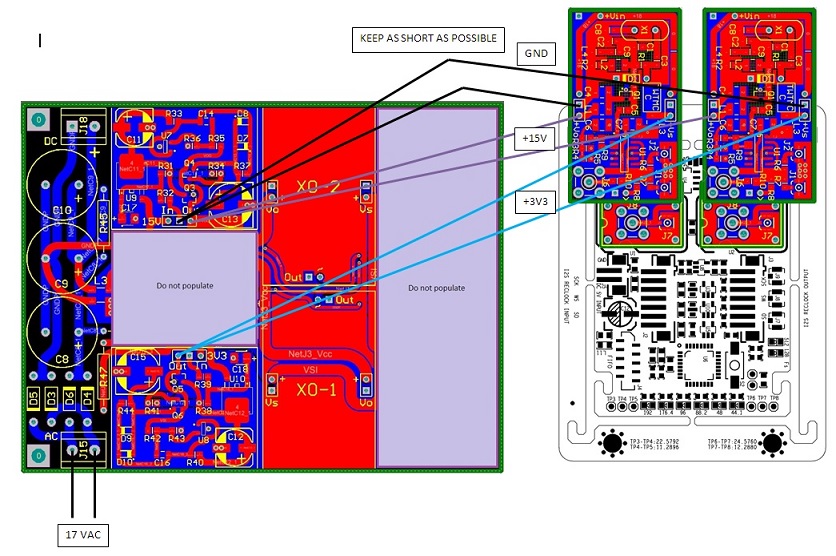

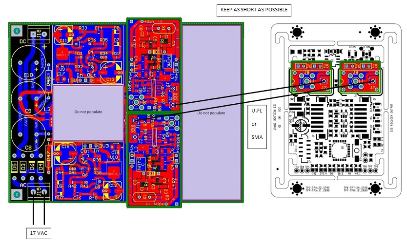

Ian's Dual clock board users
For those who want use TWTMC boards with Ian's dual XO clock board, I attach two images that describe two possible options:
- Option 1: TWTMC-C (XOs) soldered to TWTMC-D&D (daughter board) using pin strips; Master clock from TWTMC-C (XOs) to TWTMC-DIL (adapter boards) using u.fl or SMA cables as short as possible
- Option 2: TWTMC-C (XOs) soldered to TWTMC-DIL (adapter boards) using pin strips; power supply (+15V, +3V3, Gnd) from TWTMC-D&D (daughter board) to TWTMC-C (XIs) using wires as short as possible
Can you foresee any performance difference? O2 seems less complicated and I would prefer this if it would fit physically. O2 could be better whit shorter clock-lines but power feeding is further away and could pick up noise etc...
