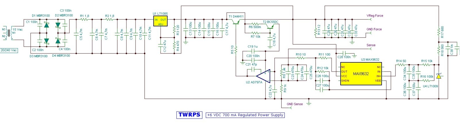

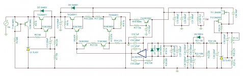

Gootee,
I think there is a little confusion in this thread.
I start the thread in parallel to Ian's thread, but as I said in first post I'm trying to build a regulated power supply either suitable for digital than analog audio circuits, not specifically for Ian's FIFO buffer.
My primary goal is to use it to supply analog stage of PCM63 DAC.
I try to design a regulated power supply, both positive and negative rail, from 4.5V to 28V output voltage: good regulation, low drift, low noise, low output impedance.
So I can't see it as a system. In the case of Ian's project, he has to solve local supply problems, with adeguate decoupling at the load.
I could only try to build a good PSU.
Then it could be used as a distributed regulator. I'm planning to use several for my DAC conversion: 1 for Ian's FIFO buffer (separate supply for clock), 1 for digital filter (SM5842) and digital section of PCM63, 2 for analog section of PCM63 (positive and negative) , 2 for output buffer (unless I'll use a tubes stage).
I could provide a Kelvin connection, but not certainly with a delay circuit. Your idea is right about delay, but it's not really implementable.
As I said in a previous post, simply adding 2 capacitors closely to the drain of the output devices of a power amp the result changed drastically. So, I think starting from a good enough supply regulator, sometimes it will be sufficient decoupling the load with film capacitor as closest as possible to the load itself.
Simulations, for me, are the starting point to design, then prototyping and real measures.
But maybe I'm wrong.
Andrea

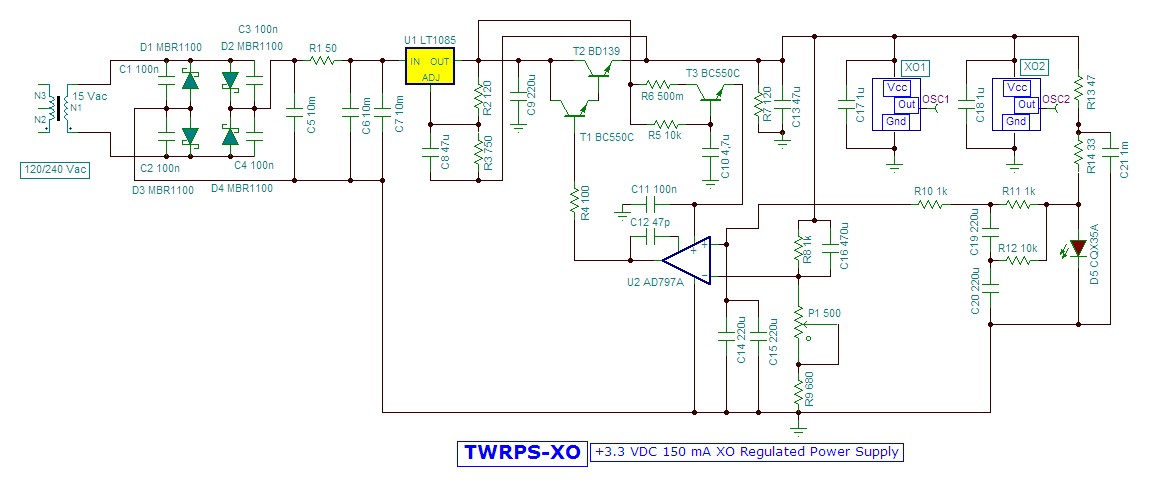

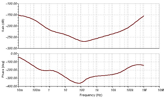

Obviously I start from a basic idea, as I said in my first post: CRC passive filtering, opamp based regulation, hi-grade components.
Also many other starting points was clear in my head before circuit simulation, for example:
- use a feedback control circuit opamp based rather than a simply 3 terminals IC monolithic regulator
- use a transistor (not a mosfet) as the pass device, or better use D44H11/D45H11 for its linearity
- use an ultra low noise opamp as feedback control device
- use a ballast resistor to load regulator as about client load
- use film capacitors where possible, bypass electrolityc capacitors with film capacitors in some points of the circuit
- paralleling electrolityc capacitors rather than use a single capacitor
- use metal foil resistors, or at leat wirewound resistors
- use a low noise, low drift bandgap as reference for the feedback circuit
- supply active device from regulated output where it's possible
This is the basic idea in my mind, then I use simulation to analyze and tuning.
Final tuning at prototype level.
So, I meant simulation is a good starting point, but obviously following a solid basic idea.

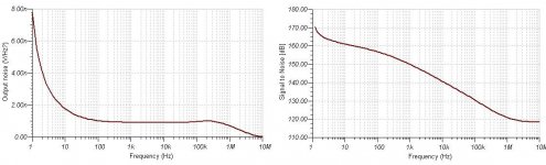

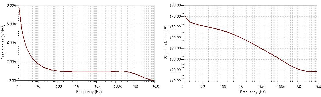

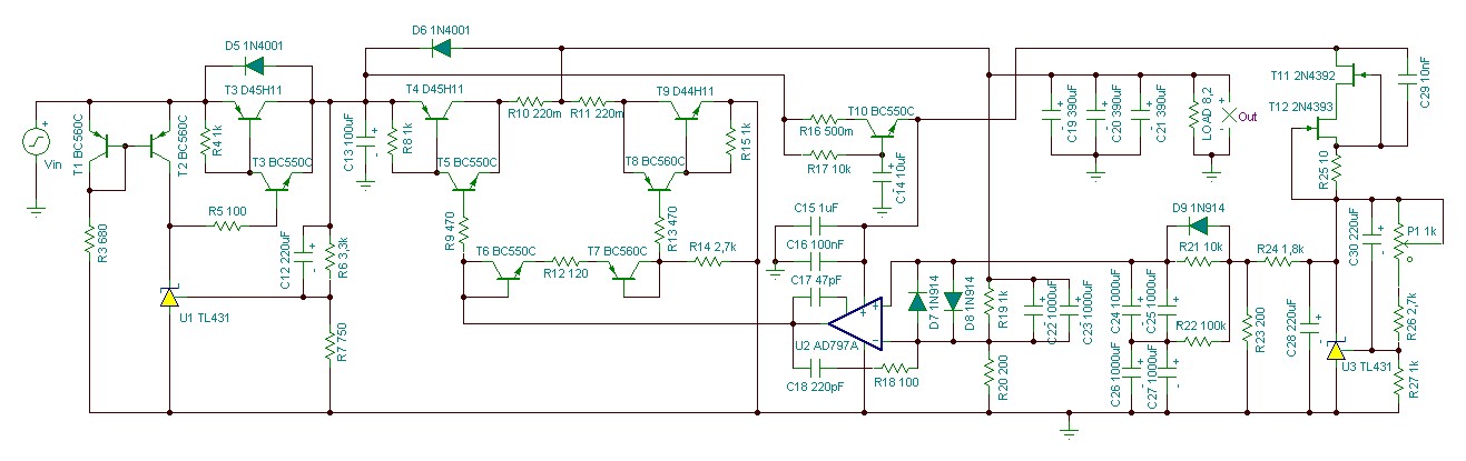

Revision
Some changes:
- filtering section now is a CRCRC, also resistors value increased from 1 to 1.8 ohm
- now use a low noise voltage reference composed of LT1009 filtered and buffered by MAX9632 opamp. Its teorically output noise is less than 2 nV/sqrt(Hz).
- shunt section removed
- paralleled some critical capacitors
Andrea

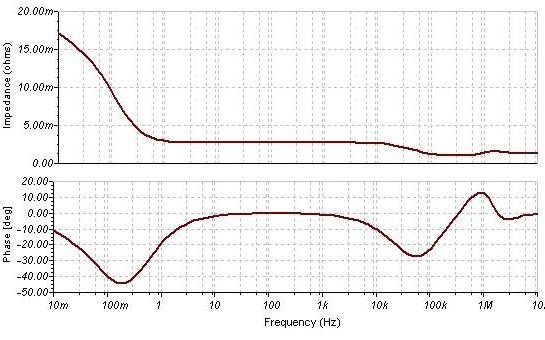

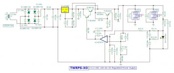

Some changes:
Andrea
http://www.ti.com/lit/an/slva255/slva255.pdf - hopefully will open some eyes around here.
interesting.. but I don't understand the connection...
the article is about switching converter, while I'm designing a linear regulator.
Obviously I could have issue about parasitic inductance and capacitance at pcb layout level, but now I'm still far from pcb designing.
Andrea

After several changes this is the final schematic I'm going to prototype:
- 3 terminal pre-regulator was replaced by a discrete pre-regulation, because IC regulator has serious problem of output impedance at low frequencies. Now a TL431 act as feedback control amplifier and drives a Sziklai pair pass transistor. T1 and T2 act as a CCS to flow the right current through the TL431
- another TL431 works as voltage reference feeded by another CCS (T11 and T12). Reference voltage is set around 10V then is divided by 10 and filtered by a first order low pass filter, so the noise is drastically reduced
- the AD797 operates as the feedback loop control of the series regulator. Its gain bandwidth was reduced to avoid oscillation
- T10 act as a gyrator to provide a more clean supply to AD797 and voltage reference stage
- the pass device of the series regulator use a push-pull Sziklai pair to get a very low output impedance. A quiescent current flow through the push-pull even without any load.
- all capacitors now have its real ESL, ESR and leakage current
Now I'm going to order parts to try and test the regulator with a breadboard.
Andrea
Andrea
Wow. That's a really-good output impedance plot.
Please let us know some results from your breadboard version.
