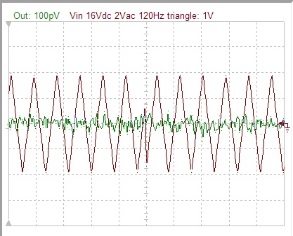

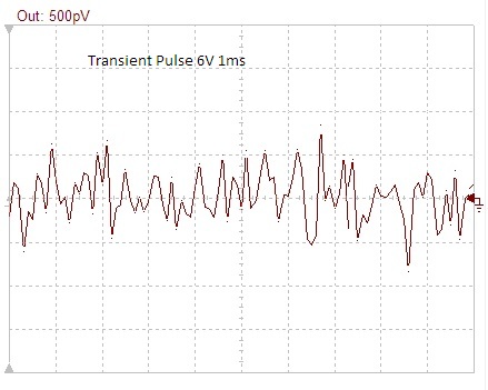

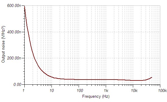

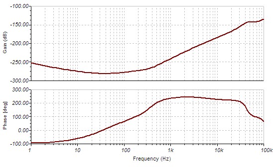

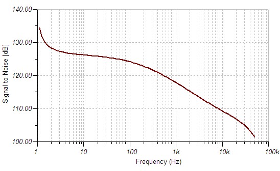

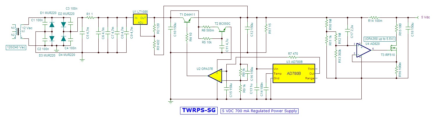

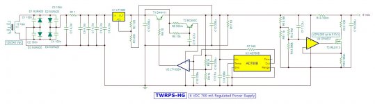

Follows the final schematics of two versions of regulator: HG version is a 6Vdc 700mA with hi-grade components, SG is a 5Vdc 700 mA with standard components.

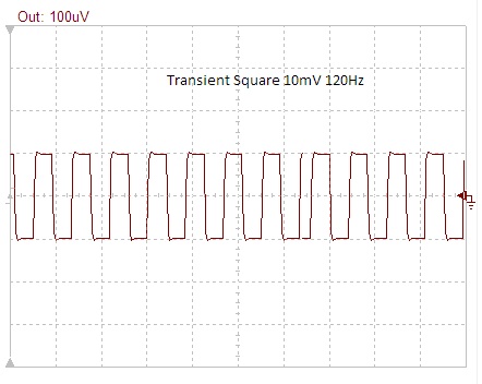

I attach some analisys of HG simulated circuit.
I'm going to order components to build two prototypes.
Andrea
Andrea
I think that cannot work because I need a voltage on the base of D44H11 greater than emitter voltage, so if I supply LT1028 from the final regulated voltage I cannot reach a positive vbe. At least I should replace NPN transistor with a PNP type.
Jung super regulator operate in a different mode, pass transistor is biased from a constat current source and the op amp modulate this current with error signal.
Andrea
You are right, I missed that. It only works when you use a PNP pass.

In your simulations, you should probably also try including estimates of the parasitics, of both the components and of the conductors. It will give a much-more-realistic simulation (although slower-running), and could also help you to find out which, if any, conductors' lengths might be critical to keep short.
For a first approximation, you can usually use .001 Ohm of series resistance per inch of PCB trace and 30 nH of series self-inductance per inch. (Obviously you might have to guess at, or estimate, the PCB trace lengths, for now.)
If you don't know the parasitic series inductance of a capacitor, then at least include 30 nH per inch of lead spacing. And many resistors have roughly 0.2 pF or so of parallel parasitic capacitance.
The parasitic series resistance (ESR, or Equivalent Series Resistance) of electrolytic capacitors changes quite-significantly, with frequency. If ESR is not given at the frequency you need for simulation, you can usually convert it, using the assumption that the dissipation factor (tan(delta)) varies by much less, versus frequency, usually less than 100% overall. They are related by
tan(δ) = 2 ∙ π ∙ f ∙ C ∙ ESR
which can be used to get tan(δ) if you know only the ESR at a particular frequency.
Then you can solve for ESR and re-calculate the ESR for different frequencies, assuming that tan(δ) doesn't change by much:
ESR = tan(δ) / (2 ∙ π ∙ f ∙ C)
There is usually also a leakage current spec, such as "I = .01 C V or 3 uA, whichever is greater", which should be used to calculate the parasitic parallel resistance, i.e. V/I = R = 1 / (.01 C) .

Based on a Maxim application note, it can cancel noise up to 1.3 mV. Best choise for op amp should be OPA350, but I'm note sure it can tolerate 6V power supply; data sheet indicates 7V as absolute maximum supply voltage and 5.5V max operating voltage.

Original application note use a MAX4475 opamp, that has two problems: first it work only up to 6V, but I need an opamp tha work up to at least 30V; second it's an SMD components, and as you see about any other components in the schematics I avoid to use SMD components for this project.
I cannot use LM833 because it has a relatively high input bias current characteristic. As you can see in the application note: "... use an op amp with low input bias current..".
In my simulation that means to use an op amp with ultra low bias current, max 1-2 pA, to work properly, but LM833 has a typical 500 nA ib current.
The OPA637 in the HG schematic is not the cheapest op amp but surely an high performance op amp suitable for this implementation:
input bias current: 1 pA
input voltage noise: 4.5 nV/sqrt(Hz)
slew rate: 135 V/us
gain bandwidth: 80 MHz
AD820 used in the SG version, IMHO is the right price/performance compromise
Up to 5.5V OPA350, in my simulation, it's the best choise for its transconductance, perfect for this feedforward shunt regulator:

As i said in the previous post, not all opamp are suitable for this application.
OPA353 is a low voltage opamp and for voltage up to 5.5V the best choise is OPA350, ideal for its transconductance.
LME49710 is a good opamp, but it has an high input bias current (70 nA), too high for this application.
AD825 is a good opamp, but is an SMD device.
BTW OPA637 is an high speed opamp (135V/us), very low noise and ultra low input bias current (1pA), so I thing ideal for this application, and my simulation confirm that. The only problem is the price, so I'll test AD820 in the SG version as a compromise.

you're right, an unity gain stable opamp in not the ideal opamp, unfortunately OPA350 is a low voltage opamp and I cannot find any valid alternative. I have investigated several opamps in my simulations, but seems all I found suitable for this feedforward shunt regulator are low voltage type. Also AD825 (and I would like to avoid SMD device) does not work properly in this circuit, cause of its relatively high input bias current. Remember that the resistors network divider at the non-inverting input of the op amp must set 1-1.5 mV, so high values resistors are needed, then an input bias current greater than a few pA cause a voltage drop on the resistors.
So I decided to try OPA637 in the first prototype to see if it really has problems like oscillations or so.

you could try opa827, its happy at unity gain and equal to 637 in every measure..ah SMD mate that requirement in particular is pretty limiting today. why? dont tell me you are SMD phobic or some other such 'audiophile' nonsense? or you wish to sell it to those who are?
I have nothing against SMD devices, but my eyesight has declined in recent years and so I have a little difficult soldering them.
BTW OPA827 does not work properly in simulation, no problem about input bias current, but I think there are problems about its transconductance.
I'll investigate again among SMD devices.

It seems only OPA140 works properly in shunt circuit, not a bad opamp and 4.5 to 36V supply voltage.
I'll test both OPA140 and OPA637
