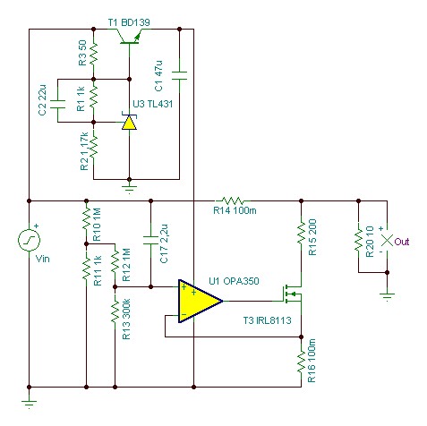

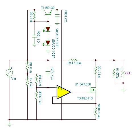

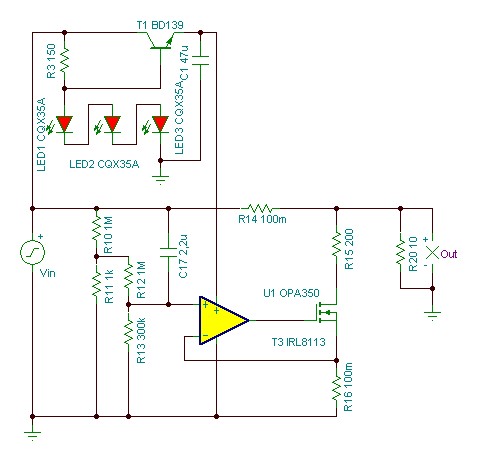

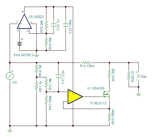

Question
In order to use OPA350 also in regulator that output a voltage greater than 5.5V we have to reduce its power supply voltage to 4/5V.
After some simulations I found two way as in the attacched schematics: first simply with 3 red LEDs, the second more complex with TL431.
I would like to know which one you favor, or if you have any other suggestion.
Thanks all
Andrea

TL431 for the thermal stability of its bandgap reference.
Tony

I would not use such a simple emitter follower. I would use a 3-pin 5V regulator for the opamp supply: more accurate, lower impedance, better rejection. With an electrolytic on its output.
jan didden

So I have to ask... You are already using a part that has 90dB CMRR, how much quieter do you need to be?
This isn't a slam, I'm just curious.
Tony

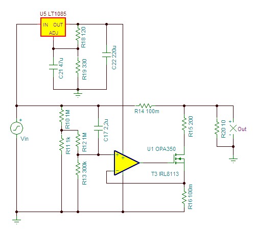

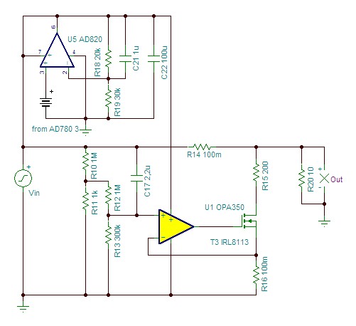

Two more options
There are two more options to set operating voltage of the OPA350 around
5V.
The first option uses an AD820 opamp as series regulator to supply directly OPA350 taking voltage reference from AD780.
The second option, the simplest, use one more LT1085 regulator.
In any case for 5V output regulator this section should be omitted, and the OPA350 should be supplied directly form series regulator output.
5V.

Ooops.. there is an error in the AD820 schematic in the previous post: AD820 output connected to positive rail.
The following is the right schematic.

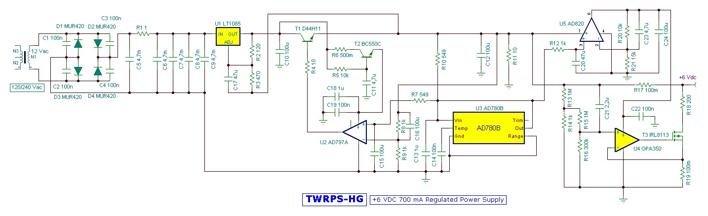

Ready to prototyping
Follows the revised schematic ready to build a prototype.
Some changes:
- AD797 op amp in series regulation stage
- AD780 now works in shunt mode
- AD820 supplies fixed 5V for OPA350, so it could be used at any regulator output voltage
Comments are wellcome
Andrea

Although it's true that high frequencies should be handled by (local) by-pass capacitors, I would rather avoid high feedback designs (thus Op-Amps) and would use simpler, faster (wide-bandwidth), all-discrete designs instead.
A simple integrated pre-regulator shall be more than enough to kill ripple and keep the voltage stable at the source. I don't quite see the need for a second cascaded one. To get better filtering, instead of a second series regulator I would rather use a CCS between the series (pre-)regulator and the output shunt reg (in parallel with plenty of by-pass capacitance).
The CCS very high series impedance followed by the very low shunt impedance of the shunt reg & by-pass caps forms a voltage divider (RC-like filter) which is extremely effective in cutting away any kind of noise coming from the previous stages (as well as blocking any noise from the load trying to travel in the opposite direction). Add RF-chokes and/or ferrite beads in series with the CCS to stop any HF/RF noise too.
N.B.: also for the CCSs you must use simple, wide-bandwidth, all-discrete designs. Do not use op-amp based CCSs such as a CCS-connected integrated regulator!
P.S.: use only Schottky barrier diodes for the rectifier! That's the only kind of diodes (besides vacuum tubes...) which do not suffer from reverse-recovery and associated noise (having only one type of carriers, there's nothing to recombine).
Another often neglected problem is the rectification noise due to the current peaks in the PT/rectifier/filter capacitors circuit. That's a huge source of wide-bandwidth noise which is radiated just about everywhere (and possibly conducted, too).
The solution is to slow down and drastically limit the amplitude of those current peaks. To do so, again I'd use a simple CCS (such as a depletion-mode FET or a couple of BJTs "back-to-back") in series between the diodes and the first cap. That will work sort of like an inductive-input (LC) filter, but without the many problems associated with the "swinging choke" (of course, as for the LC type filters, you'll need a higher voltage on the PT secondary).
It is even possible to use a modified (voltage-controlled) CCS circuit designed so that the "set current" will be reduced as the voltage on the filter caps approaches the desired one. Basically, that's sort of a current-limited, high-impedance series regulator working directly on the unfiltered (pulsing) voltage from the rectifier into the filter caps (but voltage pre-regulation and ripple reduction are just welcome side-effects: the actual goal is to reduce as much as possible the power and bandwidth of the rectification noise!).
Last but not least, you're better off distributing constant currents rather than constant voltages!
Yes, have the PSU output constant current(s). Have these DC currents routed through the circuit. Convert back to constant voltage only where required, that is right at the load(s) that needs it. Use fast, simple and small shunt regulators. One for each "atomic" load!
(use shunt regulators possibly as simple and small as just a Zener diode mounted right across the load pins, right next or even on top of the local by-pass capacitor!).
That way you can avoid interactions between different loads and minimize the area interested by the the load current loops.
That's particularly useful when you have to deal with loads that may produce fast (wide bandwidth) current pulses, such as any digital circuitry.
My 2¢.

Hi UnixMan,
thanks for comments and suggestions.
BTW I have a different point of view about most topics you treated.

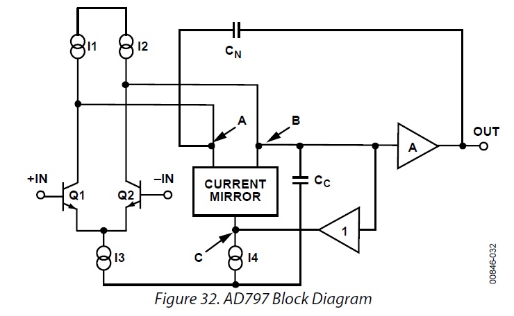

I don't think op amps are so diabolic as you said: I like vacuum tubes, now I'm building a modified Atma Sphere OTL , but I don't disregard what technology today offers. Op amps are very useful in many applications and one of these is just regulated power supply. I'm not the one, not the first and surely not the last who use op amps in this kind of applications, Walt Jung "docet". All his regulator are op amp based, and certainly he's not the last coming in this applications.
Also if you take a look at AD797 datasheet you see that it shows impressive electrical characteristics: GBP 110 MhZ, SR 20 V/us, CMRR 130 dB, PSRR 130 dB, Input Voltage Noise 0.9 nV/sqrt(Hz), THD -120 dB. If you see block diagram of AD797, attached at this post, you can deduce it works just as you ask, so I think it will work as just as well as discrete replication.

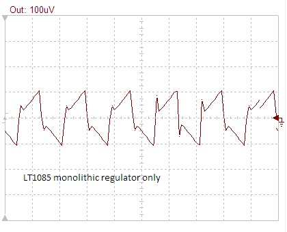

I'm not sure that a simple monolithic IC regulator do the same work of a pre-regulation followed by a series voltage regulator rejecting ripple and noise.
I attach two simple simulations of both configurations: as you can see there are at least 120 dB of difference between the two options. Just why I chose to adopt this configuration, followed by a feed forward shunt regulation that improve noise rejection and transient response.
In a future post I'd like to discuss about how fast should be the circuit response to the transient pulse. For now I can say that I prefer series regulation rather than shunt regulation, just because tipically it's slower than shunt. That's why I chose a feed forward shunt at the end of the regulator, only to act a limited noise cancellation, a little more than 1 mV. Most of the work is done by the series regulator.
Andrea

Do you think you get better performance using a couple of 2SK170 plus a couple of BC550, a mosfet and a zener or an LED as voltage reference?
Don't forget, for example, AD780 works as a zener, as a super zener, with lower drift and lower noise than the zener.
Andrea

I would take a look at the layout which Jan did for Jung's regulator and go from there.
