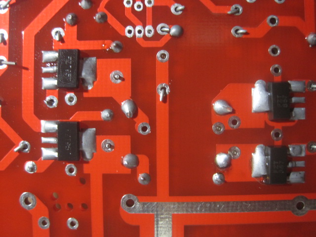

A42-92 was tested, no matter what happens when using a long time.
please see the FZT857, 957 under My PCB
Used long time not damage,have not mean it is good.A42-92 was tested, no matter what happens when using a long time.
If signal is full,NPN in bottom saturated(Vce #0v) is it will damage.

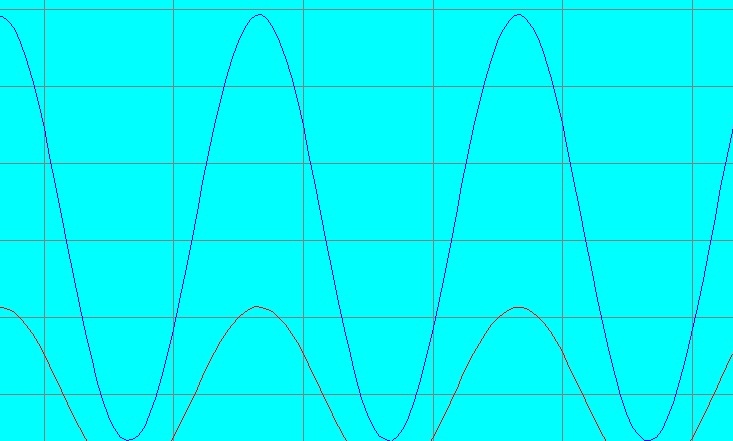

You use low frequency (1-10Hz) of sine wave in put,out put conector load true(4 or 8 ohm)And more!
thanks

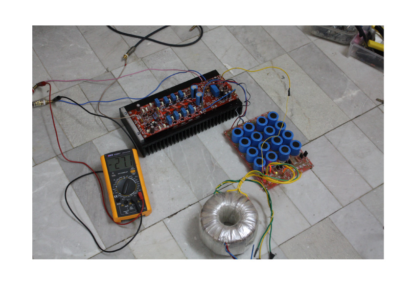

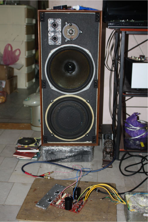

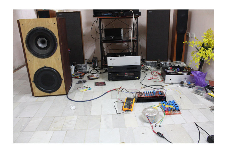

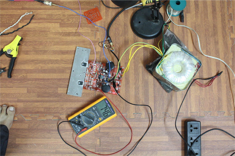

Used Oscilloscope to see signal in C-NPN,the peak of this signal # (V-) => damage now.🙄
I test in this case!
I=I1+I2 => I2=I-I1; I2max => I1min; I1min~0mA
I2max => Vce2min => Vce1max
I1min.Vce1max = I1min.150 < 4,66.150
Have you got some pictures your test?
can you show here?
can you show here?
ok!
I do not know your picture.
1. Where is sine wave machine?
2. How much frequency?
3. Where is osc machine?
4. Where is measurement (in circuit)?
5. Where is the line DC (V-) on Osc? not see in display?
6. Where is load true?

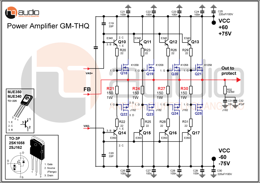

Hi All!
This is part of the power amplifier, a positive connection between the K1058 and J162 G, you can refer to this connection.
I wish you good advice on electronic Watches on how this connection, to the reasonable value!
Currently I am using the values as circuit diagrams, please visit
