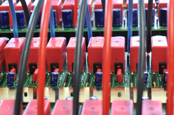

A stereo amplifier with dual polarity supply rails could have 4 sets of smoothing capacitors, if each amplifier has a separate PSU.
6 paralleled 8m2F would give +-49m2F per channel, resulting in 196m8F. Or as the brochure says approaching 0.2F
Exactly it is 72x100uF = 7.200uF( one mosfet one capacitor) + 4x1.000uF = 11.200uF for output stage(all)
Not included capacitor for Vas,pre,...
If they combined all the capacitors in a machine, I have no idea

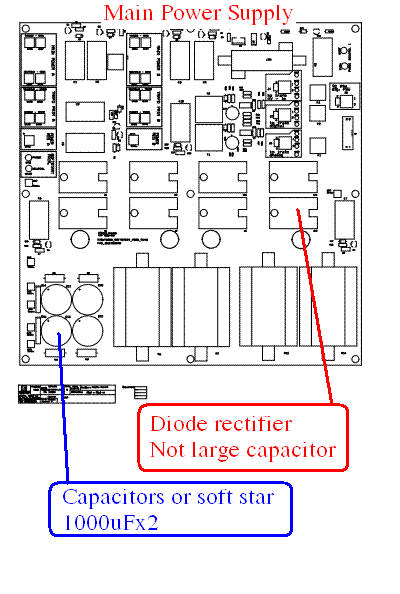

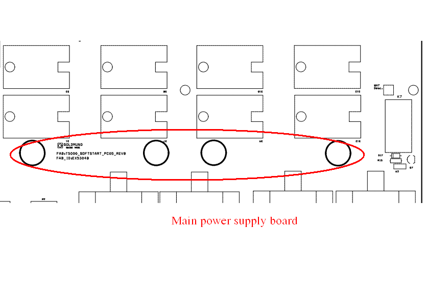

No,in main power supply have not caps,only diode rectifier.Hien,
The 24 caps are in the power supply.
The 4 capacitor of soft star

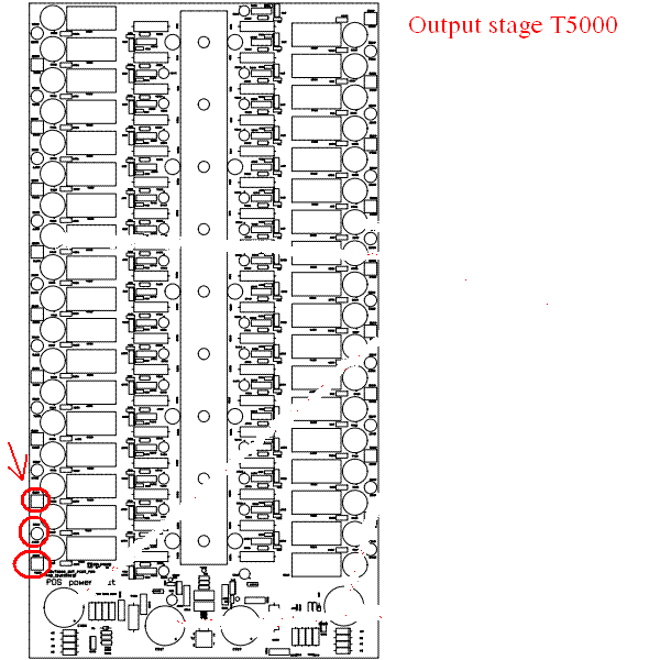

72x100uF = 7.200uF( one mosfet one capacitor) + 4x1.000uF = 11.200uFWhat is post1835 pointing to?
Place me bold on the top
it is in the blue box here pictures

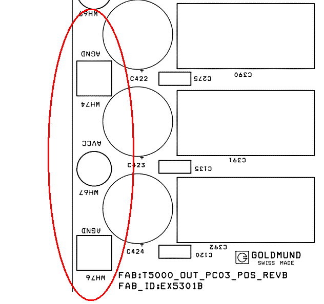

Yes,it is connections to power supplyWhat is this part/function of the PCB? Seems to be many of them. Connections to power supply?
Are they connected directly to the rectifliers?
Yes,is it.
On board main power supply has large pads, wires will be soldered to it and bundled to the output board.
What is the function of the other PCB that sits above the power supply board? Can you show me?

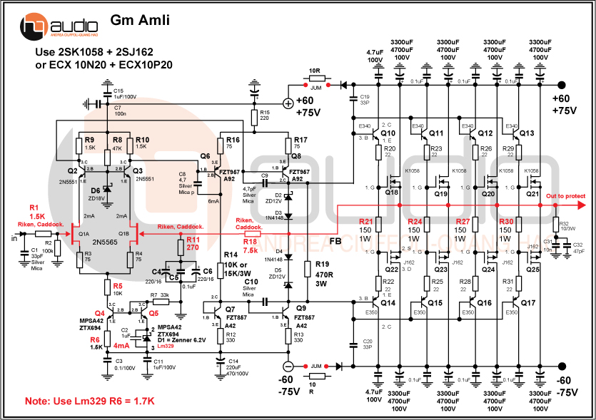

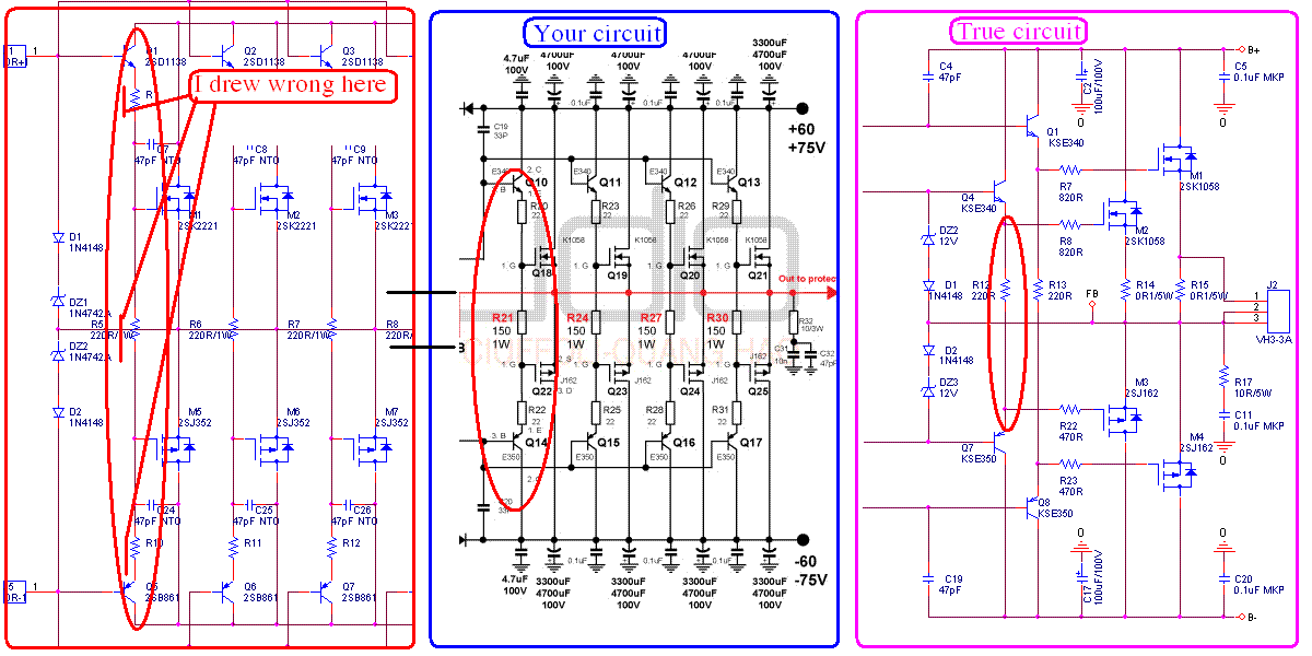

This my Clone Amli!
And!
I use this circuit!
thanks
Have a few problem in circuit.
1. I drew the wrong and that you was copy the wrong to your circuit (see picture)
2. MPSA42/92 not be used with +/-75V in the Vas .
3. Current of Vas the same as your circuit is (2.4/257.5)/2 = 4.66mA not 6mA you wrote in circuit.
No wrong, and no copy of you!
I practiced many times, to have the same value!
Schematic you gave false and not true reality!
The values given are based on my practice many times, finishing last, but maybe it is just the beginning of the capacity.
I said I drew the wrong, if you draw like me, you also wrong!
Right the same as normal, but wrong the same as is sure to copy.
In here,many people have good knowledge,they will see now.
quanghao said:No wrong, and no copy of you!
You have no knowledge of electronics so your practice does not mean.
If you have knowledge of electronics,you did not draw like that(you say your circuit is right).😉

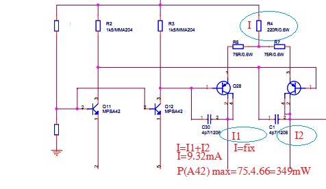

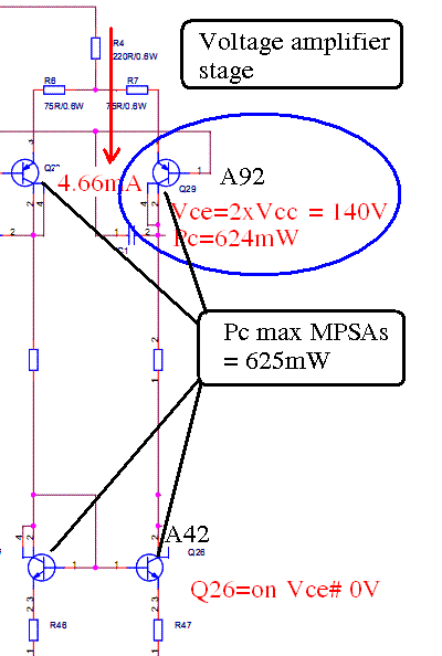

Please see the image, line I is fixed. I = I1 + I2, I1 I2 increases, the reduction should decrease the VCE.
VCE Q29 is inversely proportional to I2 so P = I2.75 = 4.66x75 = 349mW <625mW.
What do you think it??
