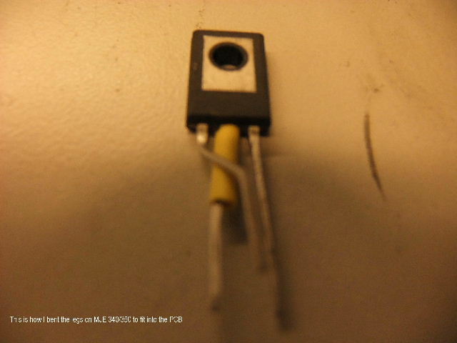

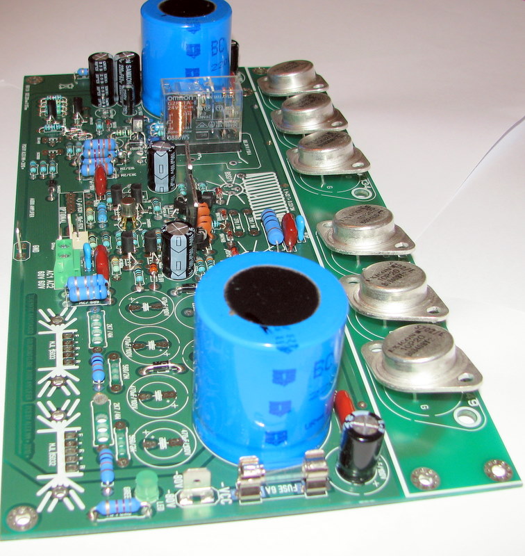

This is how I mounted T7-T10 on a common heatsink and how I had to bent their legs.
I use MJE340/50 instead of MPSA42/92. Arguments for this have been discussed in a earlier post on this thread.
If you go for MJE 340/50 instead of BSS71/74 I think it could be possible to also incorpulate drivers on the same heatsink, but do we really wish that(ref. ThorstenL)??

See post #1751
I think in another post someone strongly recomends to put drivers and predrivers on the same heatsink, but I can´t find it now.
I am not sure if it is a good idea to put them on the same heatsink as the MOSFets as they change to negative tempco at some point. If it was BJT output, then it would be adviseable.

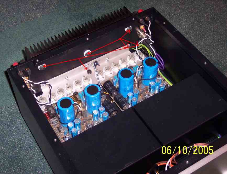

I wonder if anyone can explain practically what makes up the characteristic Mechanical Grounding?
Alex has done a great job as usual.
Nagys verified for all those who had supported.
It is a way of attenuate vibrations according to Goldmunds white paper.
See attachment. It also seems to be patented?
And is there any proof it helps ( real experimental data, or some numbers) or just a bunch of marketing babble? That white paper is about as useful as the white paper in my bathroom.
😀 I tend to agree. But (I'm not kidding here): There is a little region in the brain called 'nucleus accumbens'. It's very susceptible for e.g. marketing babble and especially for high price tags. It might even let you think you're listening to "The Very Best Amplifier I Have Ever Heard!!!!" (sic). 😉
You guys really need to build amps!
For some people like me, we like lateral mosfets, not because it is expensive 😀 Then not many good lateral mosfet amps you can find commercially or even DIY. So to get the best out of your amp, you have to pay attention to the details. And grounding is very important. It's not marketing hype. You just need to build the best amp you can.
