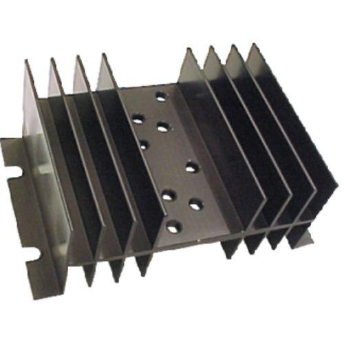

Please explain further how to do it, co'z L-bar is my only option to mount the PCB in the heatsink.....

You may need something like this to do that...
Max.

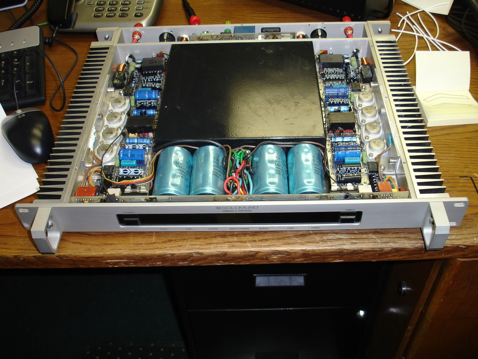

Great. If Nagys didn't change the design in the last second before release to use the outdated, bulky and difficult to mount TO-3 case you wouldn't have this problem now. The added thermal resistance of every bar construction, be it an extra L-shaped or one-piece, requires a much bigger heatsink to use. Next time better use the superior TO-247 case which saves you all the difficult mounting and requires a heatsink of less than half the size plus you have the option to mount the pcb parallel to the heatsink saving a lot of space inside the amp. 😉 And no: The TO-3 doesn't sound any better than the same transistor inside a TO-247 package. There are very good reasons why the TO-3 package isn't used anymore. 😉

It's true the TO-3 package has better thermal resistance to the heatsink but the L-shaped bar totally spoils that advantage. A TO-247 package mounted directly to the heat sink without any bar in between will have lower thermal resistance. You can do this with TO-3 as well but need a special heat sink for this (shown above).

Not if the L-bracket is large enough.
(Hitachi MOSFETs are TO-3P package, not TO-247, btw)
How large is large enough? There's a limit on thickness because the leads have finite length. The L-bracket not only needs to be thick enough it also must be absolutely flat, even and smooth where it contacts the heat sink.
I once planed a design with such a L-bracket and gave up because the results from calculations were so bad, a real high quality L-bracket not readily available and a custom precision machined one made of copper extremely expensive.
Those L-brackets are made by extrusion and this is not a very high precision manufacturing method. It doesn't matter for the space a TO-3 or TO-3P or TO-247 device occupies but it seriously matters for the area where a L-bracket is mounted to a heatsink. A thin bracket may flex and have enough contact but a thick one that is not exactly even might not flex so well and fit to the stiff but also not exactly even heat sink. A promising cure would be the heat sink that has the L-part built in. There's still some increased thermal resistance from the L-extention to the fins, but definitely much less than with the L-bracket.
IMO the TO-3 is a pain to mount and the thermal benefits lost so quickly.
But it even has some advantages mounting wise, namely the two screws that evenly apply pressure but this can be cured for the plastic packages easily.
It also has some other advantages and disadvantages that may or may not matter for DIY audio.
Every package has it's own set of problems. Pick your poison.
With a heatsink that is big enough the TO-3 with L-bracket will do fine. (The heatsinks Liliya uses are definitely more than adequate for this amp.)

On Friday was the job of Goldmund distracted by other tasks. Therefore, I did not reach my goals for that day. Now, in the weekend, it is my little daughter Kristine who gets my time and attention. Goldmund has to "rest".
I should like to make a digest of experience, any changes that I've done in relation to the original.
The changes are not many, and I have so far described some of them in # 1274.
When it comes to faults, I have not yet found other than what Alex points out in #1252.
But if the serious testing I will do together with Roar(with his measuring equipment, bought from Tandberg when they went down) reveals other errors, I will of course report on that.
Can any of you comments on this: Over the source resistors 0,22 ohm I have measured a 1,5mV drop. Roar says he wold like this measurement a lot higher.
In this case R23 is 1360 ohm.
More to come next week, also listening experience I hope.
