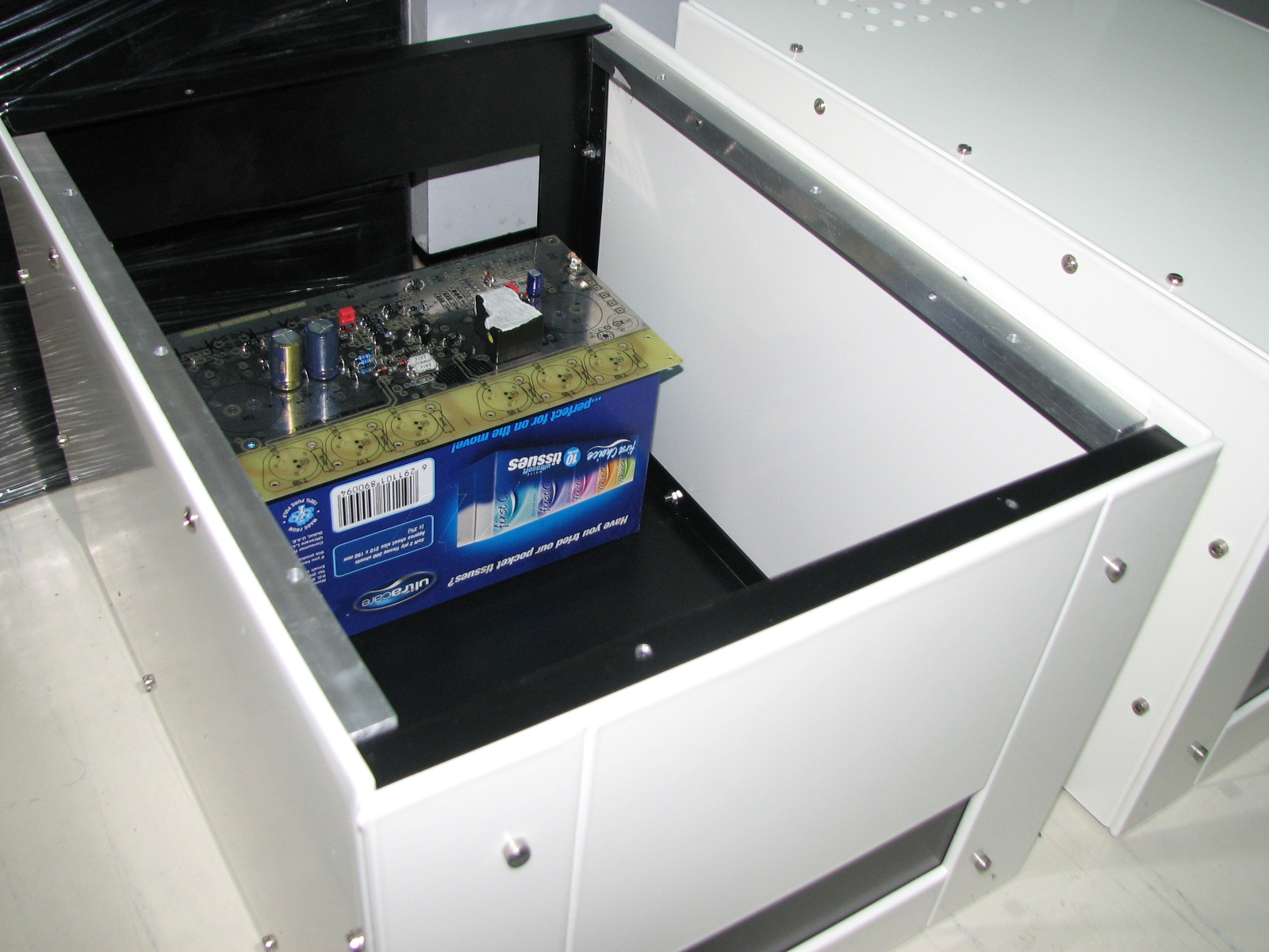

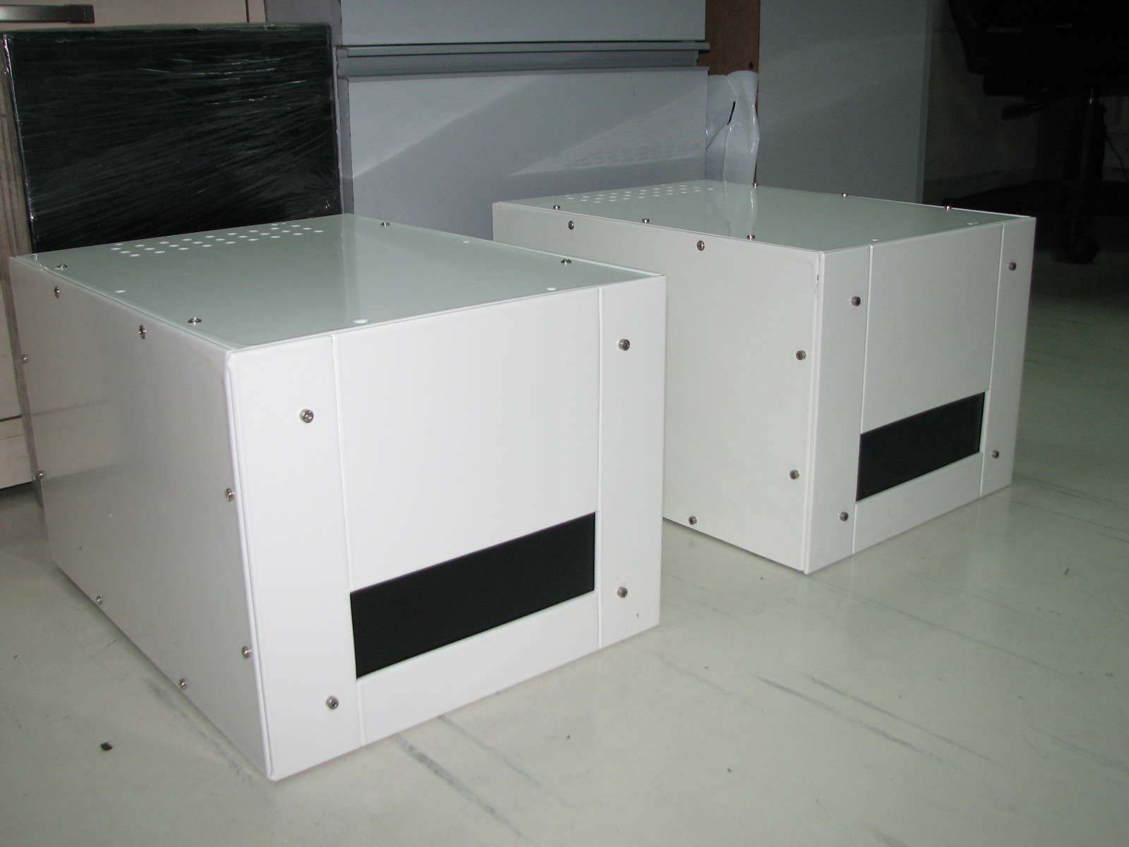

Casing was finished.....waiting for the parts to arrive...
Really "bigmund"! Dubai-size...
Congrats!
Wow, they look huge. How many channels will be put into each of them?
The relais looks weird. What's wrong with it?

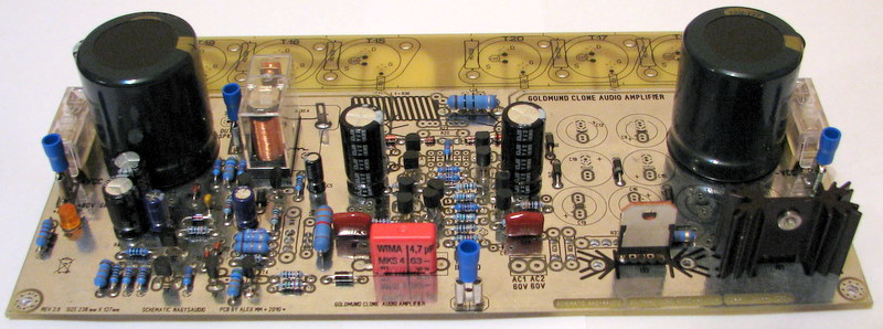

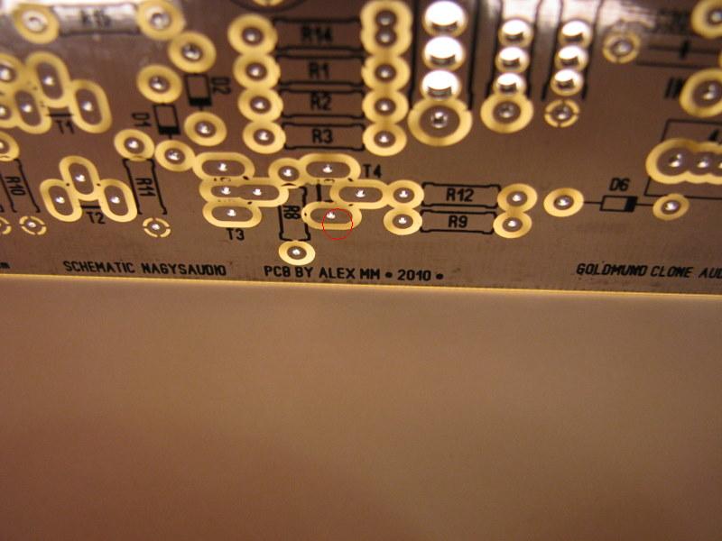

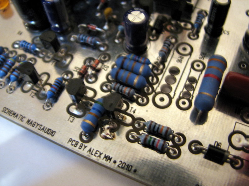

I have ,two new boards ,sent by Bigpanda they arrived four days ago . Some progress .....🙂 BTW Find one error (emitor )T4 must be ,soldered on top side ,to the ground plain, like in attached picture. Thanks ,once again ,for PCB's .
Alex.

wrong direction for T4?
Hi Alex,
Yes, you got me, but I was wondering if you had the transistor in opposite direction. It is a BC556 and you should have it in the reverse direction (only if you are using an alternative for it which has EC reversed as the original, but I seriously doubt that you are not using the original). Pls check.
BTW how are you going to test the protection circuit? Should you test it before you do (I mean soldering) the main amp. ? I found this quite difficult if you had the main amp. in position and simulate any fault. And can you post your procedure of doing that?
BP
Hi Alex,

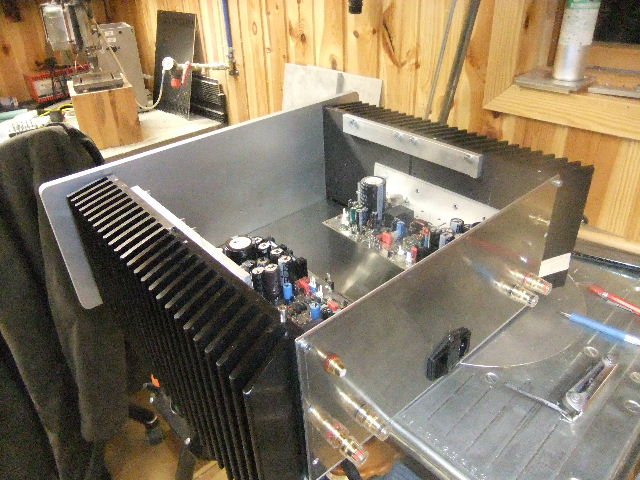

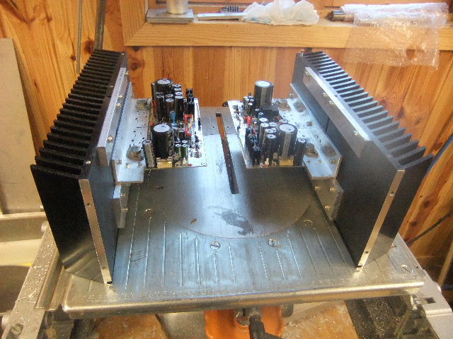

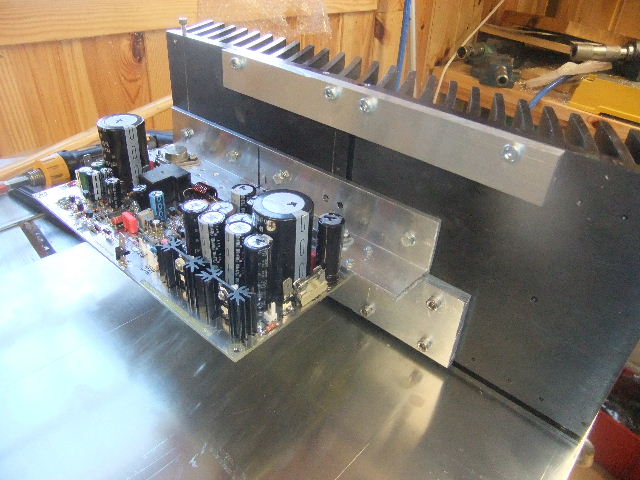

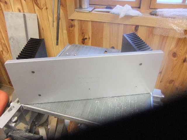

I took some pictures from the collection process with Goldmund Clone. Roar has been helpful and put his small workshop at his disposal. With the right tools results can bei pretty good. I am very happy so far.
1.Chassiet built around the front plate of the MI 7 from Musical Innovation (Roar Malmin)
