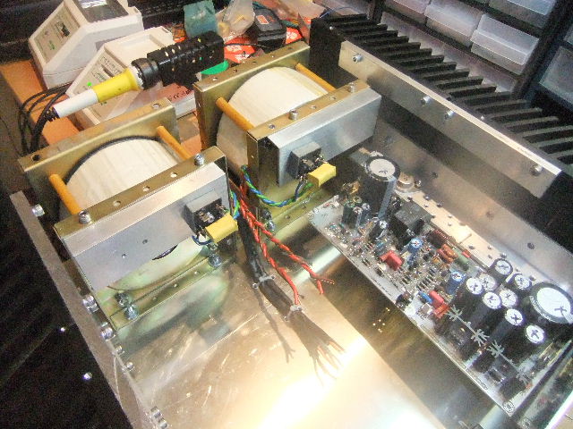

Front off again and both transformer mounted. 2x55V AC/ 700VA.

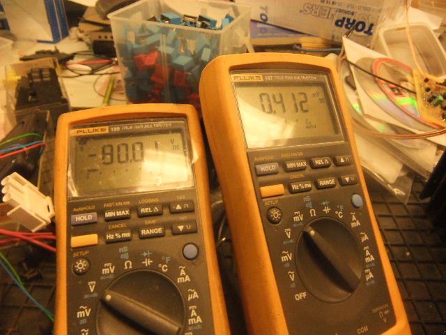

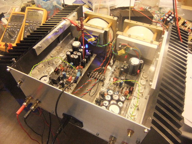

Almost the same results on both channels. DC "jumps" up and down. I think this will stabilize after I have choosed "earthing metode". First I will try "star-earthing" with connection to chassis at the input socket.
Problems so far: T7/8 very hot.
80 V DC = power front end. 0.4 mV = DC output.
To morrow: Listening test and may be some measurements.

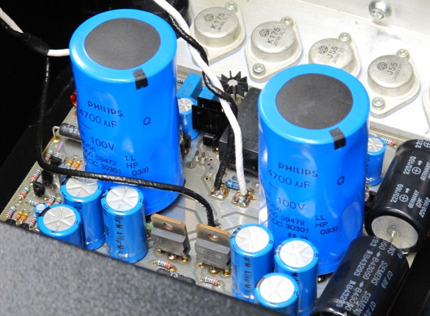

I remember a picture posted before where there is a heatsink mounted on T7/T8 position on the mimesis 9 board. See attachement.
Nikosokey wrote:
T7,T8 hot?
you used MPSA93-MPSA43 or other?
I used MPSA 92. I will look at R16 (150 ohm)
T3,T4,T5 and T6 also MPSA 42. R11 changed to 10 k. To morrow I will try to find the right value for R23. 330 ohm is a bit to low for the source restistors (0,22 ohm).
Bigpanda wrote:
Are you going to put some mechanical support on the other edge (opposite the bracket) of the pcb ? Whole setup weighs over 30kg, I guess?
Yes, it is a heavy "box". I do not find mechanical support on PCB to be necesarry.

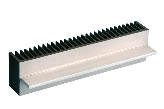

Telstar wrote:
Lilia, very nice... but why didnt you mount the pcb onto the heatsinks directly?
You loose gain much thermal resistance using the L pieces.
I can not see how that is possible using To-3. Explain.
I did the first listening test to day, not a serious one, but to check that is was a "hole trough" the Clone. Very often I listen to how equipment
cope with applause to jugde Hi-Fi quality. Clone was very good. No tendesy to "shattered glass ". More detailed listening tests to come later on bigger and better loadspeakers and better input signal.
Cooperation with the Roar continued Friday morning.
why to-3 would make any difference? It's the L bar that adds thermal resistance.
If i'm wrong please somebody correct me.
If you mean how possible would the mounting be, it is possible using some little cables then soldered to the pcb 🙂
See also the picture of the original Mimesis.
Component Mounting Flange
The flanged mounting feature, as seen on type MF30-1F-75 for example, is designed to improve thermal conductivity, provide greater ease of assembly and savings in cost compared to a fabricated heatsink and right angle bracket arrangement. By eliminating the thermal junction between heatsink base and bracket with a single piece heatsink, component temperatures are significantly reduced. (See diagrams below)
For example, the thermal resistance of the interface between a right angle bracket with cross-section 40x40x6mm bolted at 50mm. intervals to a flat backed heatsink (including thermal grease), has been measured at 3.5 C/W/cm2. The corresponding figure for Conrad flanged heatsink is virtually zero.
The Conrad flanged single piece heatsink (left) has more effective heat flow
than a conventional fabricated heatsink.(right)
