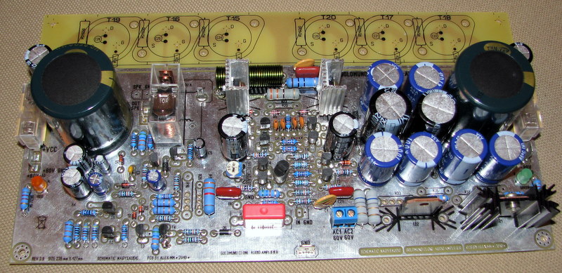

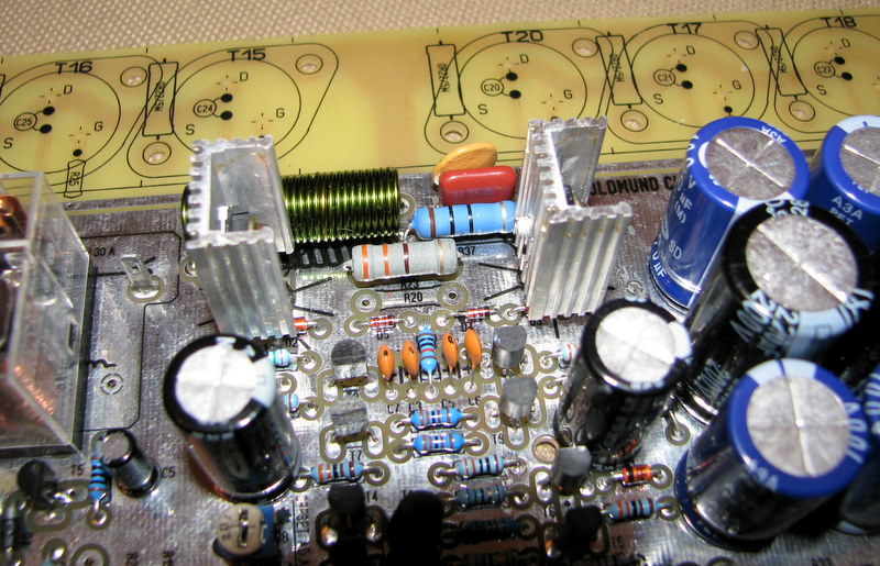

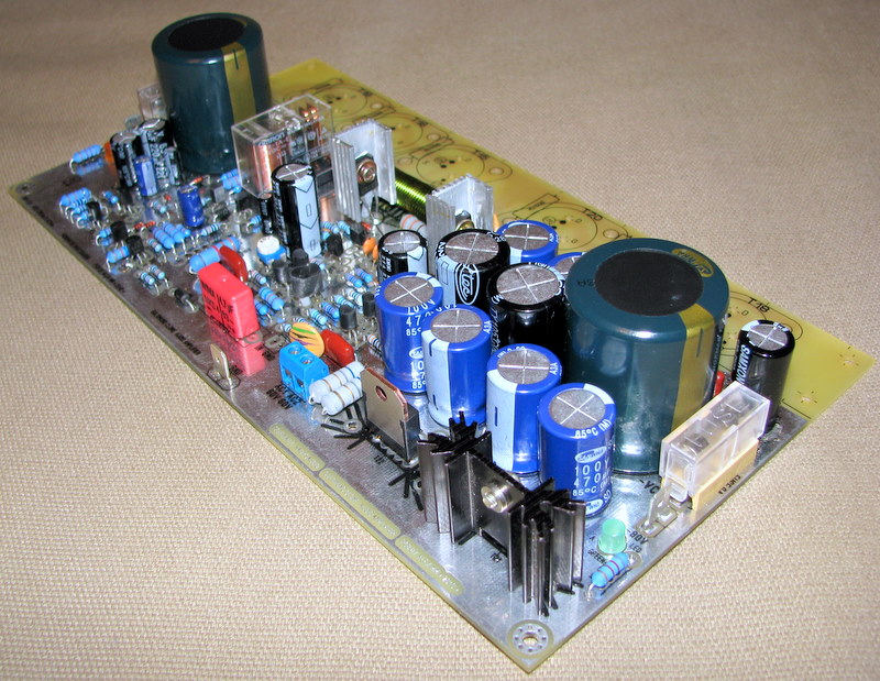

Liliya,
You have a rail to rail voltage of more than 180V so a transistor should be able to withstand at least this voltage.
The ones you chose now will do the job much better but don't have a safety margin voltage wise. They have a lot of power but a bit high Cob. Do you have a small heatsink for them? Do they run hot without?
Btw: My recommendation would be the SA1381/SC3503. They seem to be quite popular here at the moment. I used them in my amp that is very similar to the Goldmund.
Btw: Do you still have DC offset at the output jumping around? This concerned me a bit.
Good luck

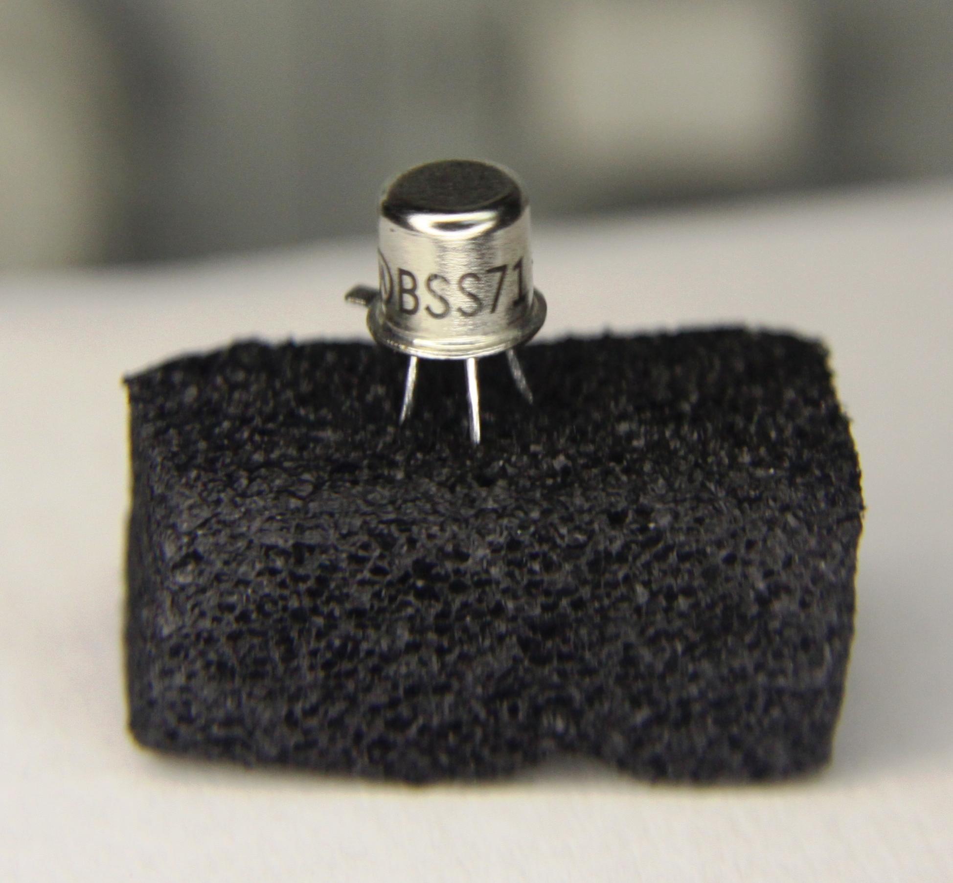

parts....
Maybe this will help for some members who is looking for parts...
I ordered from UTSOURCE.NET
2n5565 $15 each.
Bss71,74 $5 each.
shipping was $10.
2n5565 $15 each.
Bss71,74 $5 each.
shipping was $10.
2n5565 $15 each.
Bss71,74 $5 each.
shipping was $10.
I have seen this source before. My opinion is that they are Chinese counterfeit. They may or may not work properly.
>I have seen this source before. My opinion is that they are Chinese counterfeit. They may or may not work properly. <
Thanks for your advice

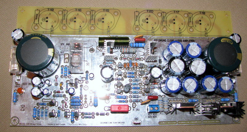

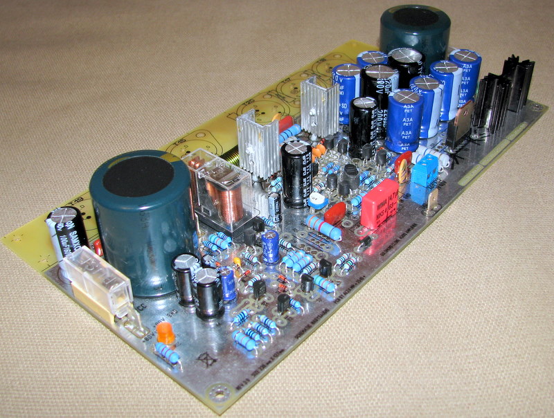

......some parts have not arrived yet....🙁

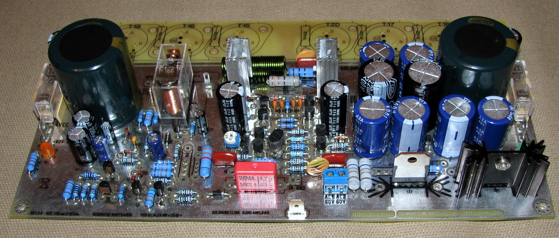

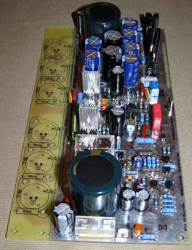

So nice so far! Congratulations!😎

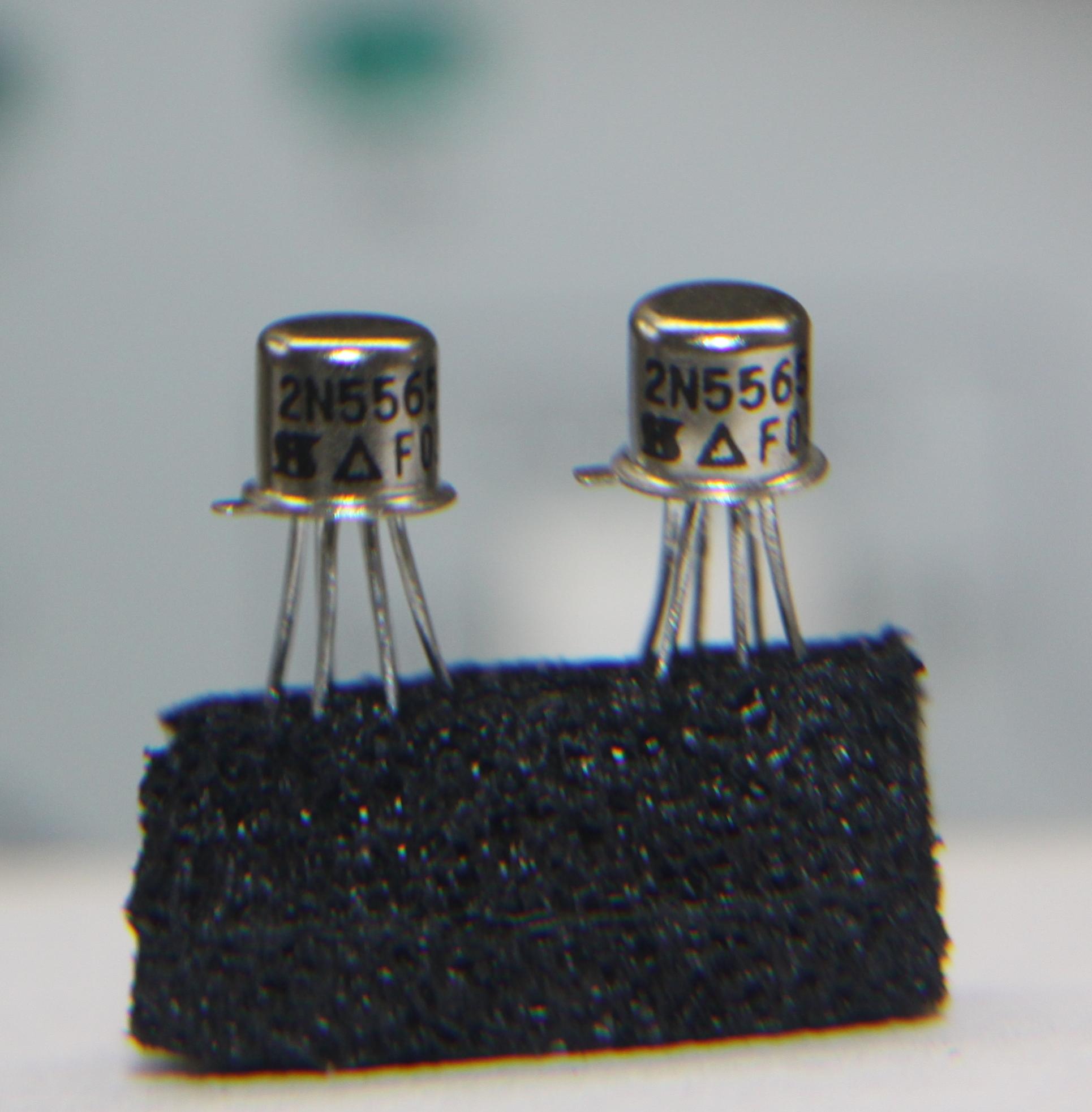

Alex, it seems like you didn't use 2n5565. What FET did you use on your input stage?
Hi Alex,
Looks like you are binding 2 pcs of Jfets with a shrinking tube. Nice try. Can you tell us what are they? Anxious to see how you can come up with it.
.... so I replaced it with 2SK170 mached , I will see how it's working , but it's an long way until I will start this channel .🙂

I am just waiting for the oppertunety for Roar and me to do serious tests the coming week.
Lee Knatta: The drivers you suggested (2SA1381/2SC3503) was not available at my supplier. Instead, I went for MJE 340/350. This is 300 V types.
Yes, offset setting also worries me a bit in that it is so unstable: Variation on both channels from 0 to 60 mV. Results like 0 - 5mV has been very common on amps I've previously built. But I see that the diversity I experience, is big, even if 60 mV does not represent any "danger ". Anybody have any suggestions for a "cure"?

No idea why you guys are so hung up on the Siliconix 2N part, but here's one for the adventurous buyer: Salvats
Roughly $1 each.
(PS : hope you realise that the Idss range of the 2N556* goes all the way from 5mA up to 30)

Good choice! Alex has some small heatsinks there. Prepare you might need some, too.
Ok, offset is a bit strange but 60mV is not a too big problem imo. I thought it was up to 0.6V? Maybe measurements with Roar will shed some light on this. 😕

Check R8, T3, T4 and T1 or replace them.
Tommy
What do you mean by "check" R8, T3, T4 and T1.
R8 is a trimpot(check what?)
T3 and T4 are MPSA 42 not BC 546 B. Would BC 546B bee a better choice??
Bouth channels behave the same.
Eivind Stillingen.
Eivind Stillingen.
Tommy
Eivind Stillingen.
From experience sometimes the trimpots do not work properly even if they are new. By check I mean does the components work correctly, correct type/model, does the PCB layoute match the schematic in his area, in order to find the problem. My opinion is that BC546B should be used. Hope this helps.
