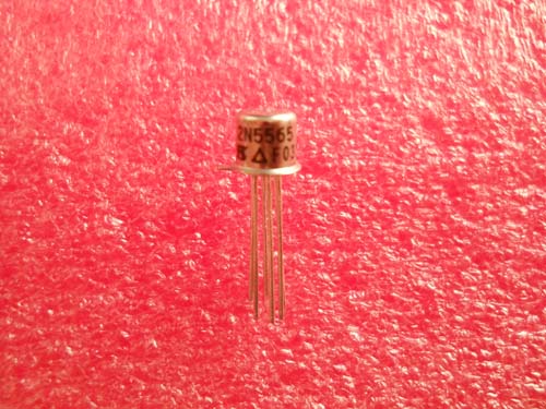

Maybe this will help for some members who is looking for parts...
I ordered from UTSOURCE.NET
2n5565 $15 each.
Bss71,74 $5 each.
shipping was $10.
I email that company and this is what they answer to me.
They give me NOT the confirmation if they are original, what do all you think?
My question:
Hallo,
Please note that they are NOT Chinese counterfeit.
This one is very important that they are not fake I need the original: 2N5565 JFETS Vishay/Siliconix
When you confirm they are NOT Chinese counterfeit I place the order and I tell the audio forum you have the original components.
Thank you very much for response,
Rudy
This is the answer that I get.
Dear Rudy, pls check the picture and datasheet in attachment ! thanks!
davis
This is “my order”:
Part Number Package/Case Brand Date Code Quantity Unit Price(USD) Picture
MPSA43 TO-92 MOTOROLA N/A 4pcs $1.0
MPSA93 TO-92 FAI/ON N/A 4pcs $1.0 PIC
BC182B TO-92 FAI/ON N/A 4pcs $1.0 PIC
BC546B TO-92 PHI/KEC N/A 4pcs $1.0
BSS74 CAN-3 PHILIPS N/A 2pcs $10.0 PIC
BSS71 CAN-3 PHILIPS N/A 2pcs $10.0 PIC
2N5565 CAN-6 MOT/VISHAY N/A 2pcs $15.0 PIC
