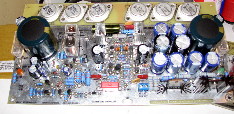

I am building a Mimesis 3. And if I understood Zen Mod correctly I can build it with one pair of fets because I do not need 200W
yes - but you still need transconductance in output stage , so - use those mosfets from Zhoufang
catch22 isn't in overall power of mosfets , but xconductance
You will have to also lower the rail voltages somewhat as not to exceed the power dissipation ratings of the 1 pair of output devices.
I thought the most important thing is XConduntance/Ciss
Ok Zen Mod I took your advice and go for 2SK1530 and 2SJ201. What do I need pot? to set the quiescent current? What value pot and to what value should I put it on min or max resistance
R22 in that schmtc must be made of resistor and pot in series
Ju wrote to me that in earlier post,I do not understand know if I put it in series with fixed it can not be splited 50/50 percent (just parallel)
instead of R22 of 330R , use fixed resistor of 180R and trimpot of 200R , both connected in series
