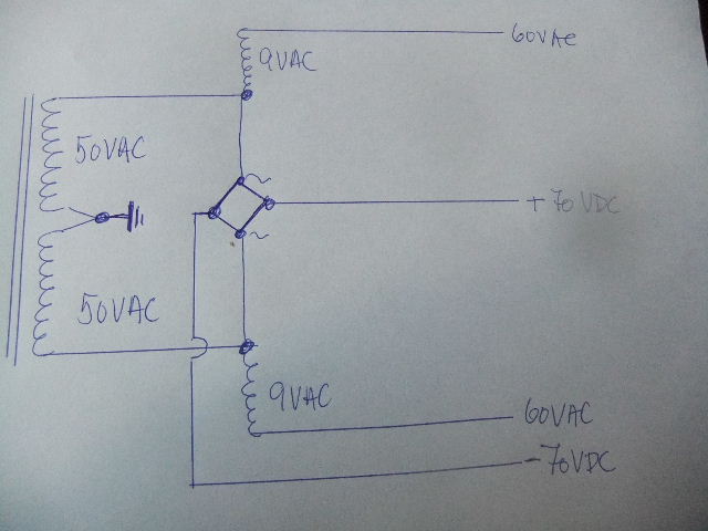

Transformer question
Thank you Nagys for your answer regarding the transformer I want to use. Your adwise is to unwind down to 2x40 VAC and run Goldmund as a 2x100 W amplifier.
Being a happy owner of a pair of Magnepan 1.6 loadspeakers, I want to “take” every watt that is possible from the Goldmund. I will “loose” a lot of watts "taking away" 2x10VAC from my transformer. Using 2x50VAC for the output stage will give an output some place between 2x100W (with 2x40VAC) and 2x250W (with 2x60VAC) I assume.
Before I listen to your adwise, bite into the sour apple and unwind down, I will ask you and other members about this solution taken from my LFA 50 from the nineties (photo)
I have a second reason to seek for other solution than to unwind my 2x50vAC transformer and go for my "own"(photo)
Nagys said:
“The input stage will be fed by taking the 40VAC before the bridge and the +/- rails will be fed with the voltage taken after the bridge, 40 X 1.414 = +/- 57VDC. Close enough to +/- 60VDC”.
This I do not understand because:
According to 9.2 Schematic the input stage should be fed with 60VAC not +/- 60VDC. What have I misunderstood (if I have)?

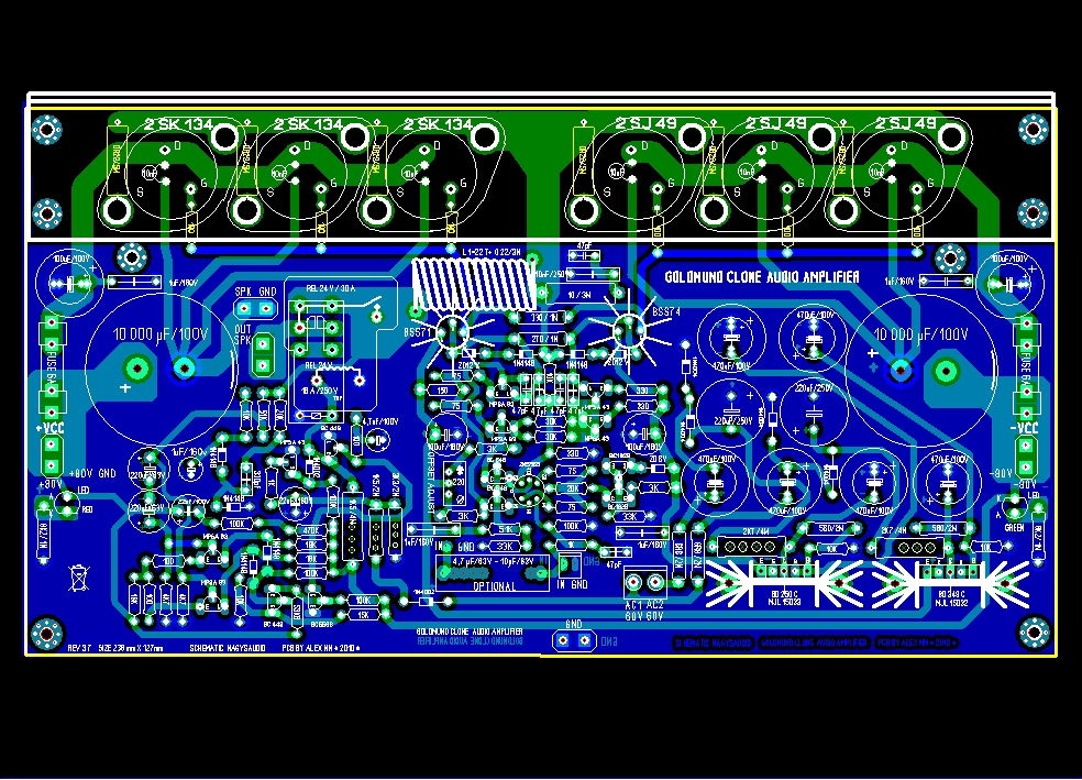

PCB ....rev ,rev,rev,rev many times
.......for those ,who wish to be added resistors on bottom for sources will do like in picture so screws and insulators are differences in how they will be installed , I think .🙂 Liliya , an simple schematic how must be connected ..
Alex.

Hi Liliya,
As I already say If lowering the DC supply at output stage will not lower the power of the amplifier. If you have 2x50VAC transformer don't worry the solution is very simple: change the drop resistors R32 and R33 with value between 1.9k-2.0k (3W is fine) and input tage will go to around 80VDC. I am not recommend to remove a pair of MOSFET's. By the way the current through T21 and T22 is around 26mA and there are not needed any heatsink.
Best regards
Transformer and source resistors.
Ivodonchev, thank you.
Dropping 32/33 down to a lower value: A straightforward solution for me (and others).
But we are still talking of 50VAC to this point and not DC?
Alex, thanks to you too for listening about the source resistor. Your proposal to this on the underside of PCB will be easy to adapt for those who want/need it.
Eivind Stillingen

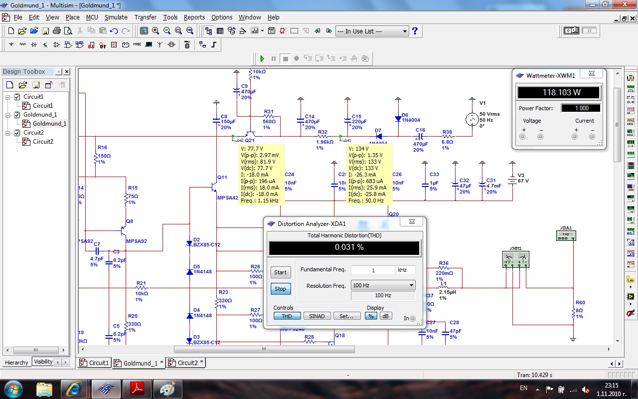

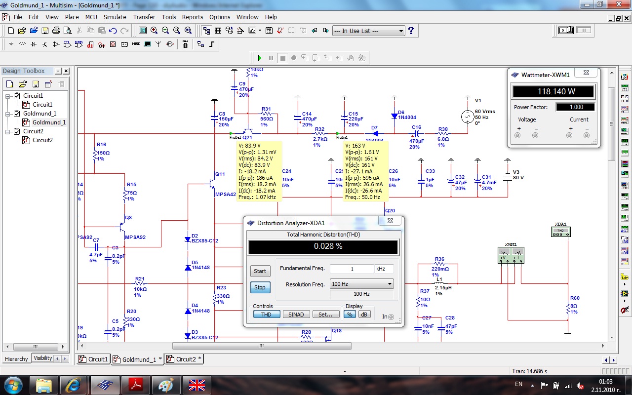

Here is simulation with 60VAC transformer, as you can see there are not difference in the power between two simulations. I think that the reason why Goldmund push mosfet's to the limit are primary sonic performance.
Best regards
