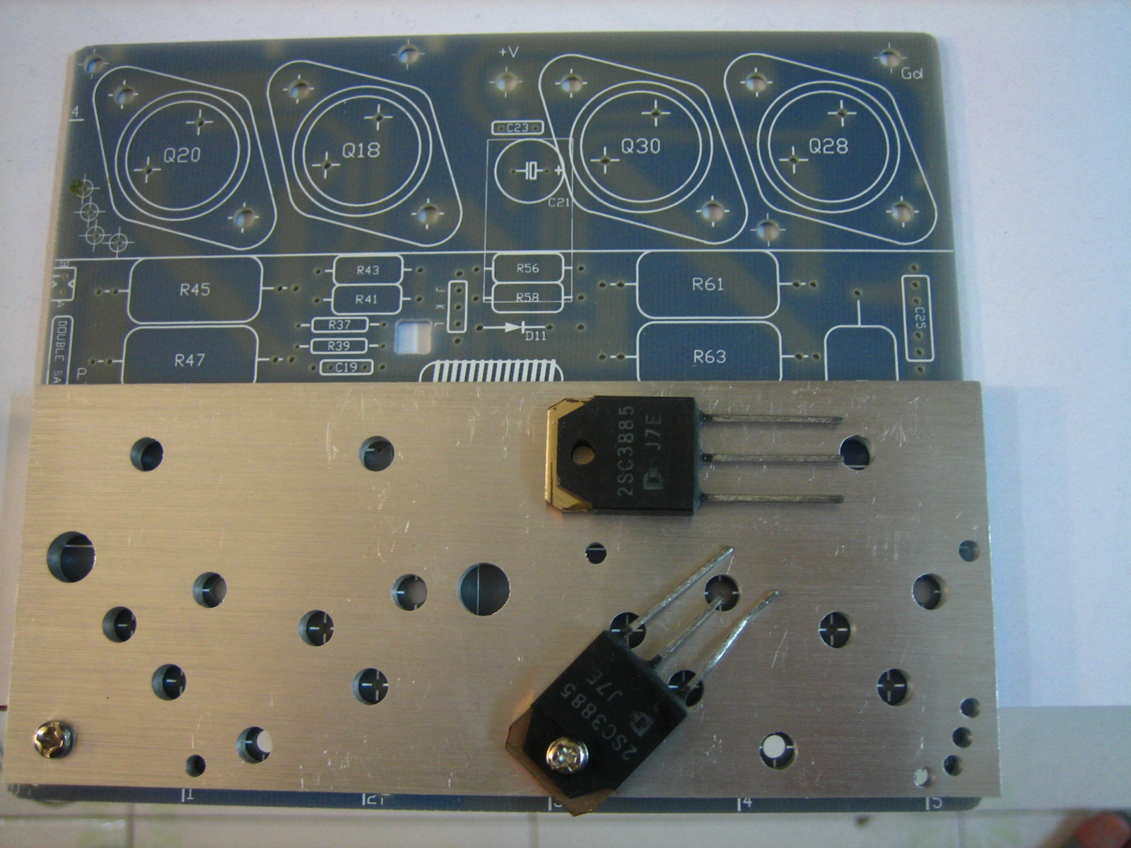

I don't think the TO-3P can be used on the TO-3 version board unless the board had to make modification again. I have include 2 photos so you can take a look. The screw thru the mounting hole for the TO-3P are not in contact to the flange (ie, the Source). So can't see how the Source of the Ps can be connected to the Source on the TO-3 on pcb.
If we mounted the TO-3P as shown in the photo (so as to fit the G & D and I think that is the only way to do so) the Source leg of the TO-3P will be too short to have anything to do on the soldering side. I am using a 4mm thick bracket.
Does anyone has any better idea?
Encouraging :
If we can insulate the 2 mounting screws on the TO-3 from the copper trace on both sides of the pcb, we may just use a solder lug to connect the upper hole to the output trace if we don't want the 0.22ohm. If do want the 0.22, we can solder one end of the resistor to the lower screw with a solder lug and the other end to trace near the other hole. That way we can still include the Source resistor. Hope I am describing it clearly.

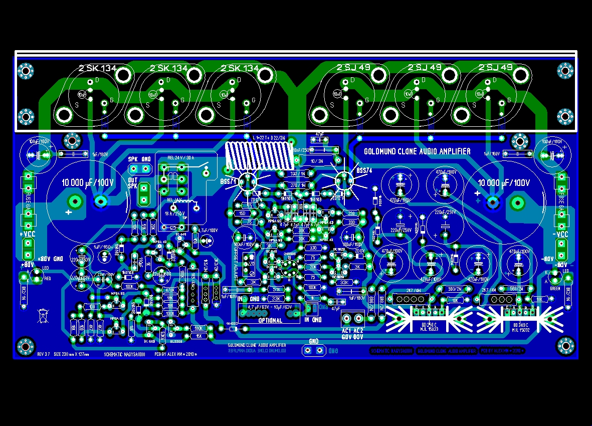

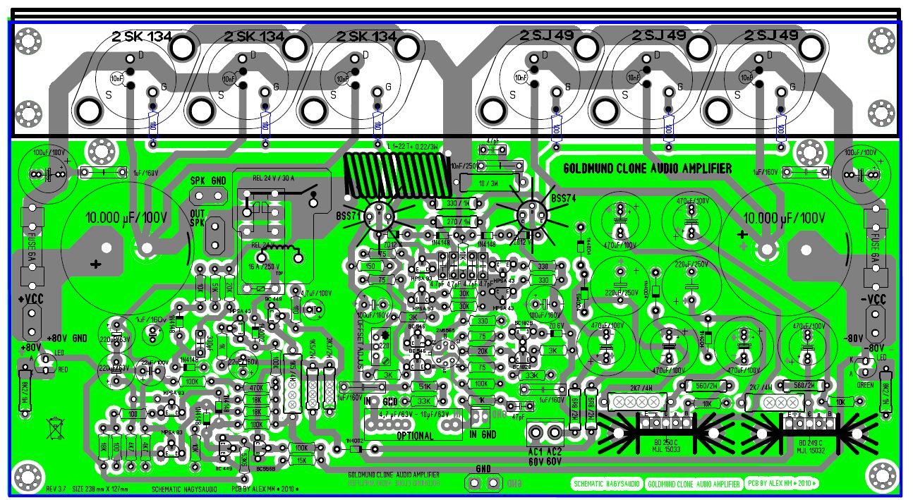

PCB REV 3.7 revised again and again ....
... it's not so hard to change the capacitors holes but had to make a greater thermal pad that I had not in library .😉
Alex .

....circuit is double sided with metallicized holes, such as electrolytic capacitors how will soldered on top ground plain 😕?
When drilling the holes for the board in the NORMAL places(holes) right next to the necessary ones needed for parts like the Electrolytic, drill a small hole in the pad and solder a short jumper in it or two if the pad is big enough and needs it. Think and innovate.
