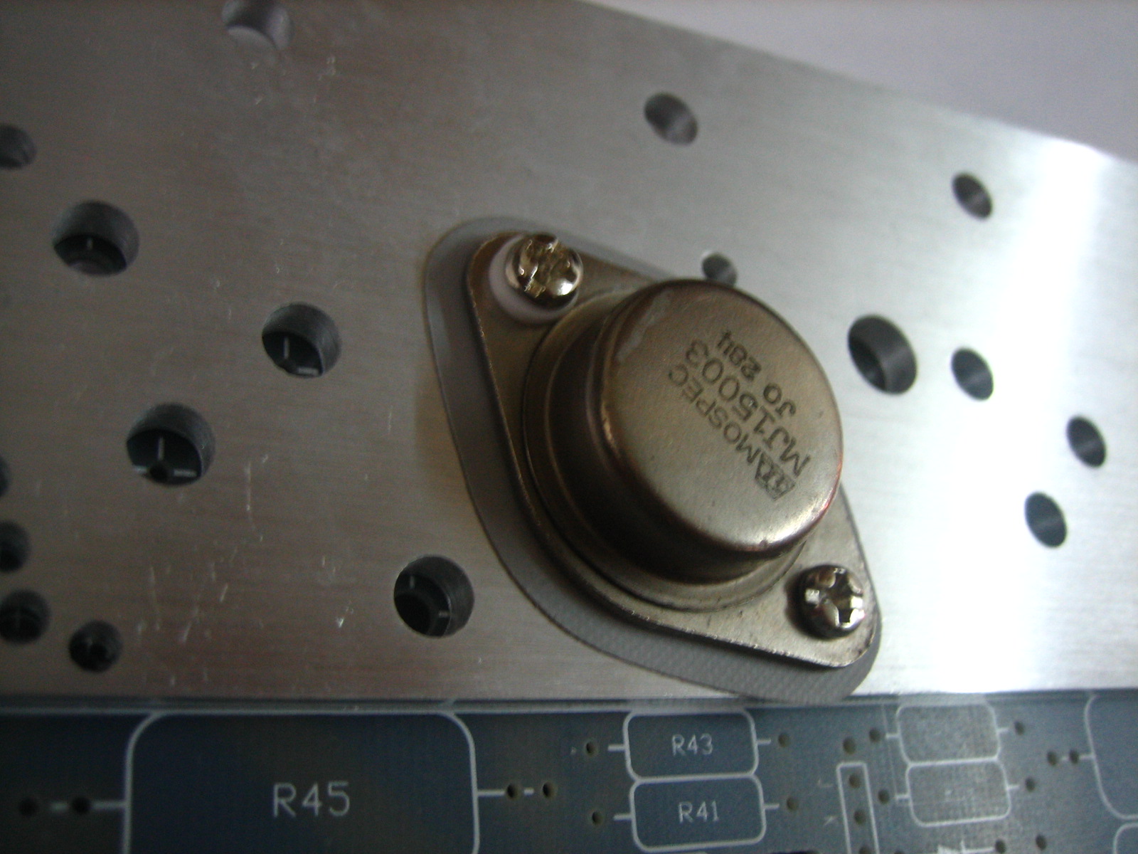

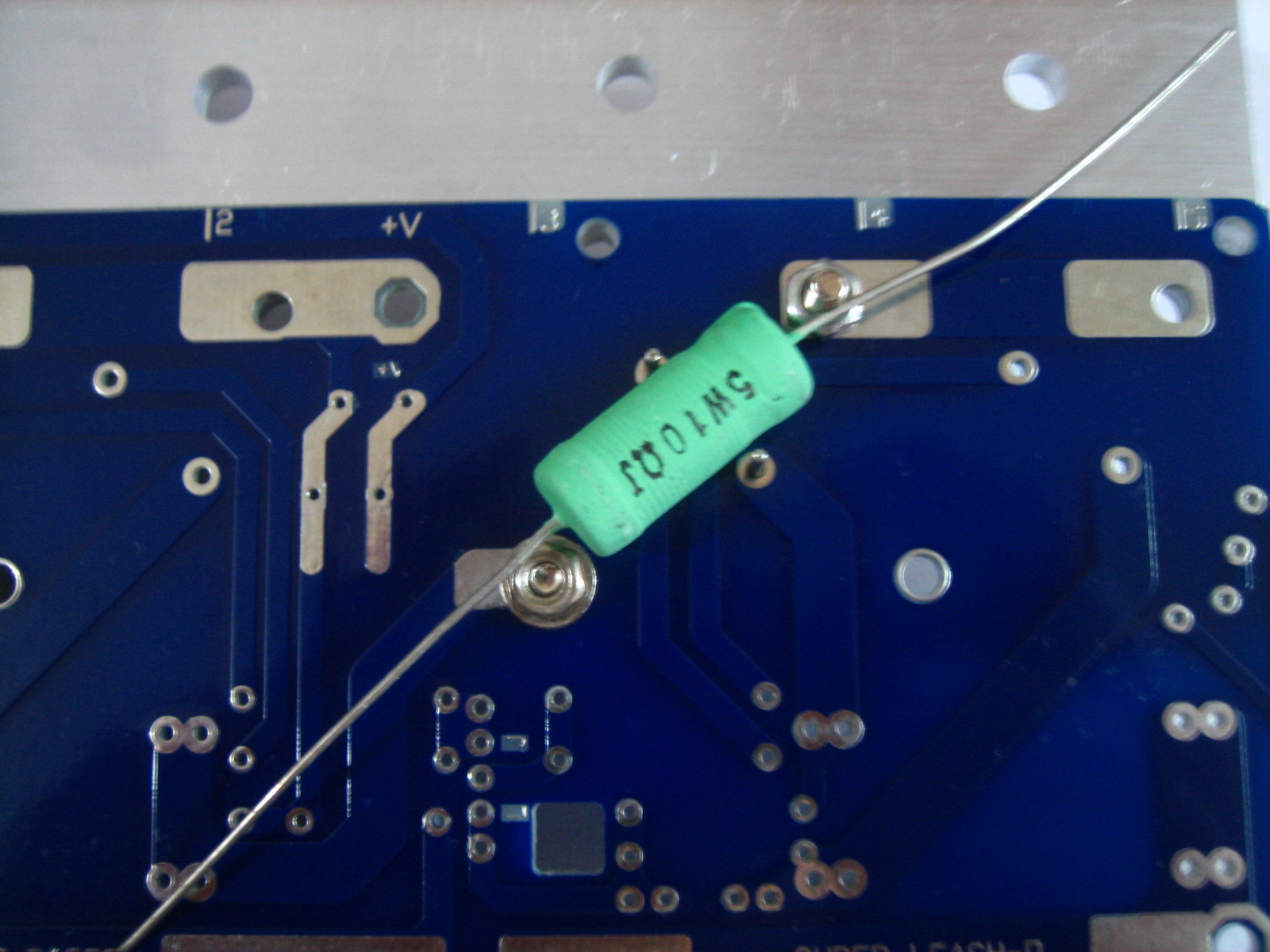

Hi Luke
As in Post#1041, the source resistors can still be implemented w/o changing the pcb. Hope the 2 photos attached can clear my mumble jumble in Post#1041. The resistor can be even implemented on the component side which might be a bit crowded.

Besides you can just just jumper out where the Emitter Resistors would be if you do not want to use them, RIGHT...
Not now. The new PCB won't have source resistors.
