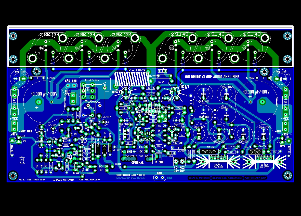

Hi Alex,

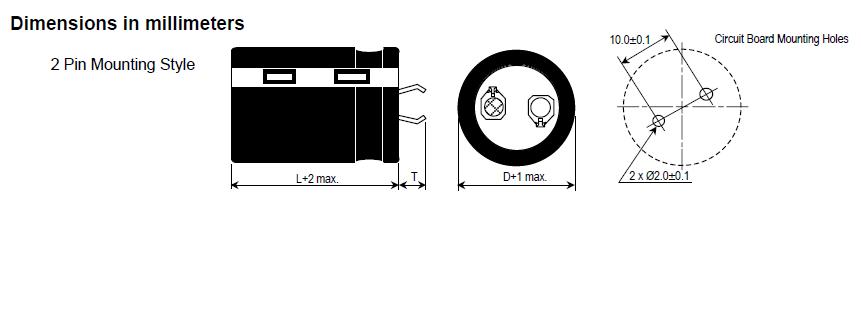

Very nice board. The holes for the big snap-in filter cap is a bit too small - it look like 1.5 - 1.6mm dia. It should be 2mm according to Panasonic datasheet.
BTW, can you change the layout a little bit so that the 6x gate 100R resistors can be mounted under the PCB, just like the 10nF capacitors from D to ground.
The gate resistor should be very close to the gate pin to avoid oscillation.
When the gate resistors are out of the way, you can also move the two 1uF/160V film caps away from the output FETs, then the potential builders can have more clearance for their heatsink bracket.
Cheers, Stanley

I see that the source resistor (0.22ohm) is missing from alex's TO-3 version board. Can 'anyone' (or should I use 'everyone' here, but I think this is going to be a grammatical mistake) please kindly shed some light on this?

Bigpanda - They are completely unnecessary. None of the Goldmund Mimesis amplifiers had them, nor do any schematics, including the one I posted on page one. The resistors would be large in size and clutter up the board.

If they are vital to the circuit, no matter how big they are, they have to be there. Just want to make everything sure and make this project right, that's my only aim.
BTW, I am planing to add an extra pad to some transistors so as to make them easier for use with alternatives. Instead of a tripod (as in original), make the legs in-line and with the flat side facing the other way (for the alternatives). It seems that of all the alternatives that you mentioned, they are having a reverse EBC arrangement than the original. I will try documenting them when I get all things ready. It might look a bit crowded with pads but it may be easier for some guys. As long as they know which holes they should be in, that should be OK.
If the 2oz thick copper for the power and output traces is good enough for that width, I will keep them that way. If not, I might attempt to broaden them. Please comment.
Bigpanda - They are not vital and again none of the Goldmund Mimesis amplifiers use them. The only reason they were added by Alex before, was because of someone's suggestion. These resistors are not part of the schematic and shouldn't be used if you're building a faithful Goldmund clone.
In my opinion, the extra pads are not necessary. Also, weather the holes are in a tripod configuration, or in a straight line doesn't make much of a difference either. If anything, I personally prefer the tripod layout, the transistors sit firmer. While in a straight line, you could bend them around easier.
The width of the tracks is perfect. They will never ever reach their 15+ amp rating.
I think that the TO-3 version of the board should be made. If people decide to use the TO-3P transistors, they will still fit. The 2 outer pins of the plastic version transistor just need to be bent 90 degrees to go through the PCB holes.
The source (case) will be connected with a single screw to the PCB.

They are vital for good current sharing. Other way precise selecting of Mosfets (Vgs treshold and Vgs vs Id) is a must.They are not vital
Then you must buy 100+ , sort them into groups. Even WITH .22R emitter resistors and BJT's, crude matching is recommended. Had an amp with all devices dropping 13mV Re , one dropped 17mV ... guess which one blew ?? 🙂

PCB Rev 3.7

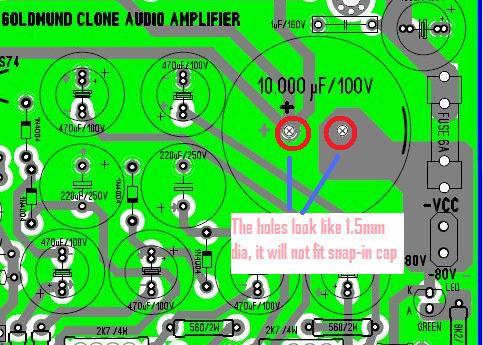

Hi Alex,
Thanks for the quick changes.
Can you please double-check the hole size for the 10000uF capacitor? If the picture represent the actual hole size, then they look like 1.5 to 1.6mm diameter and that will not fit the snap-in capacitors (which require 2mm mounting holes). The potential builder cannot drill that out either as the speaker ground is connected to one of the 10000uF cap.
Cheers, Stanley

They are not supposed to be 10000uf anyway they should be 4700uf. Is that right Nagys or have i mixed it up with something else?
Hi Alex,
I think that will be better if you rotate at 180 degree 100uF capacitor near 10000uF and heatsink. In that case ground pin between 100uF and 10000uF will be closer.
Best regards
Best regards

Max diameter for C31/C34
Hi Eivind,
I have checked, 35mm diameters capacitors can be installed on the last two PCB version by alexmm.
I think that is up to builder to choose the capacitance - the board can fit anything from 4700uF to 10000uF.
Cheers, Stanley
