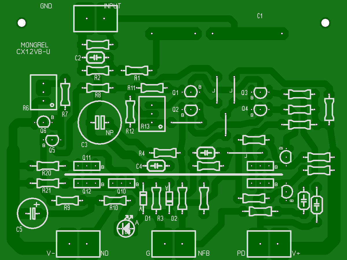

I was trying to check the protection schematic and the pcb I found something suspicious :
1. The 330pf at D3, D5 was ID C5 but there is a C5 (4.7u) with R13. So I rename the 330pf to C9.
2. The polarized caps have a different convention or Alex has done it the other way round. The hollow rectangle is always the +ve while the solid line (could it be just a thin line or as thick as the rectangle) is the -ve. The main pcb doesn't seems to have problem but the protection circuit is just confusing (seems the caps are all the other way round notationed). Please confirm.

Sorry Alex,
You have changed the solid line and the rectangle for every ele. cap but C3. So if you don't mind, can you please put a "+" so I do not get confused.

Bigpanda - In the layout, 99% of electrolytic capacitors (in the power supply too) either have the +/- reversed, or the picture/symbol reversed. I already brought that up a few times before. Everything else in the PCB layout is connected correctly, I checked a million times. Those who build this amp should always follow the original schematics, please see them attached. They are correct. For electrolytic capacitors, the empty square is the - and the solid square is the +.
We need to either reverse all the electrolytic capacitors (pictures/symbols and +/-), or not print the silk screen. Otherwise there will always be someone who installs them the wrong way and they'll explode.

Hi Nagys,
I am not going to agrue with the convention because it is too old a story and it had been done too many times in this forum. As long as we use the same convention all along the same schematic or the same set of schematics of a project, I don't think we should have a problem. When I do my schematics and pcb, I will always put a '+' sign to make things clear (just like we got a '-' sign on every polarized cap we bought). That would eliminate any mis-convention.
In the main board schematic, I can use the one at the Vcc's to follow the designer's convention but as for the protection schematic, I am getting confused (sorry about my limited knowledge on this).
I had been reading all post for this thread and I don't know if I might have been taking a nap and miss some part you said you have state about the 'wrong convention'.
If your hand drawn schematics (main and prot that you have posted in very early posts) are correct, I will follow that onto the pcb (at least for the polarities of the ele caps).

Bigpanda - Sorry for the confusion. In Alex's PCB, all the electrolytic capacitors are shown CORRECTLY, +/-, including in the protection circuit. Please do not change anything 🙂 I forgot this is a European schematic, as well as my hand drawn one. In Europe, the - is either a line, or a solid square and the + is the empty square. I've been working on a few schematics here and got it mixed up with the American ones. Again, all the +/- are correct in Alex's layout 🙂 Sorry for the confusion Alex! I also checked once again all the traces and connections, everything looks good.

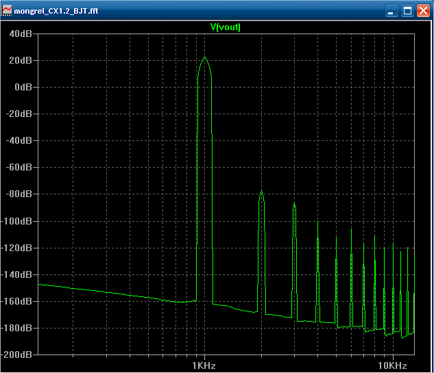

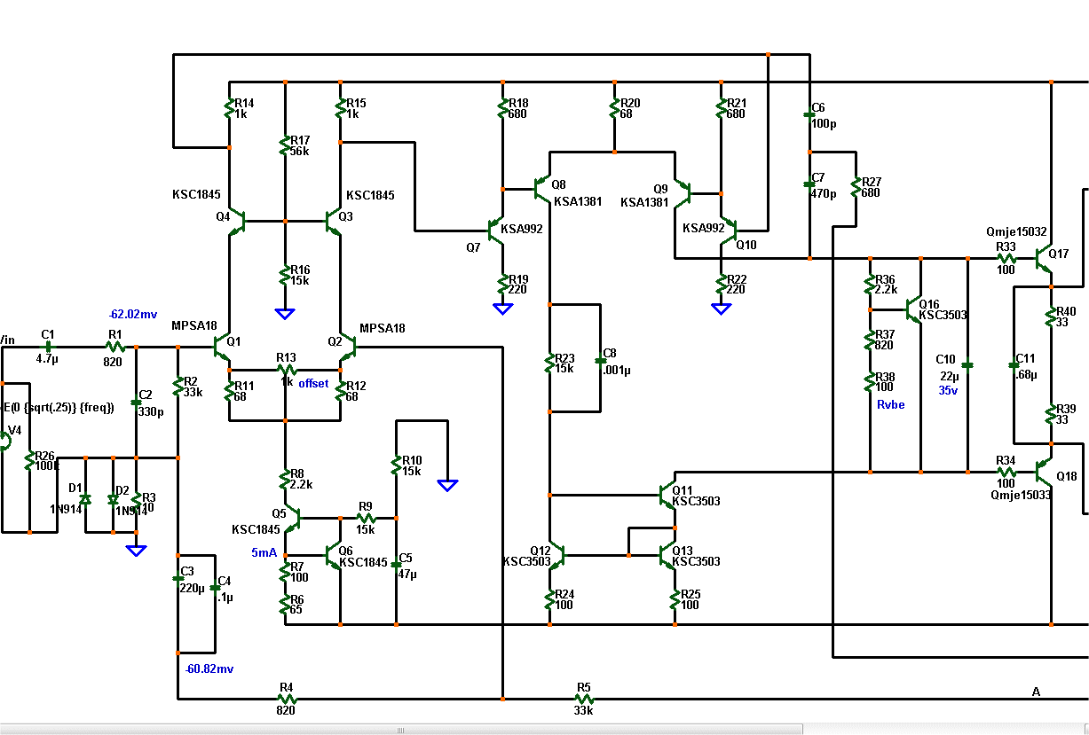

Almost ready , even prototyped. when I get my sk134/j49's (hitachi's), I will even give them a "run". This topology , (with drivers) actually is at home with either BJT's or mosfets. With laterals , one could even leave out the drivers and "crank up" the VAS current , driving the laterals "direct".
With transitional miller compensation (TMC) .. BJT's can even beat laterals. (below- 1). Just for comparison , the circuit can use LSK170/389 for LTP or MPSA18's. I aim to BEAT the goldmund .. period. (pix2/3). Keentoken has the same goal. Compared to the original w/MPSA's, the distortion components are the same , just 10 - 15 db lower. No one would make any money on this one either , 20 year+ service life is expected.
