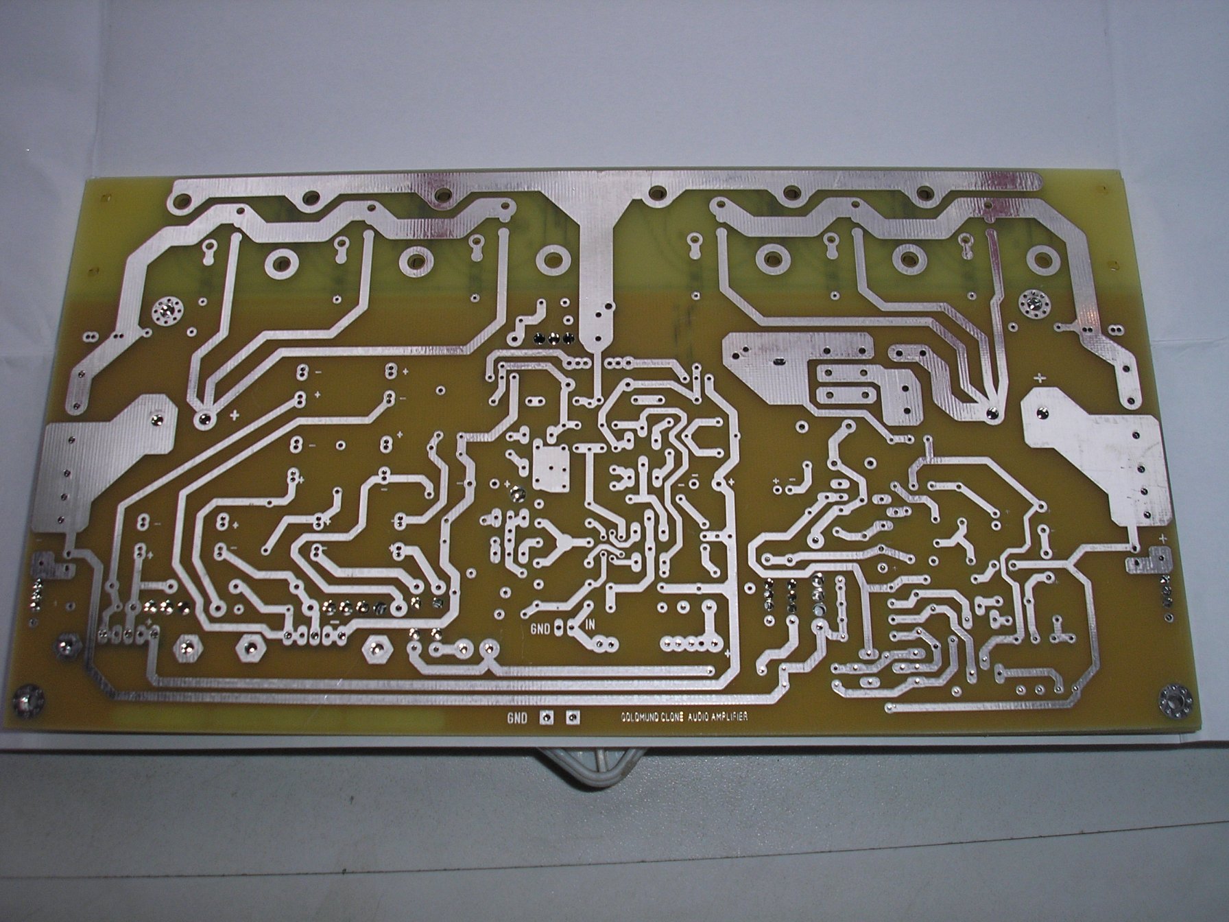

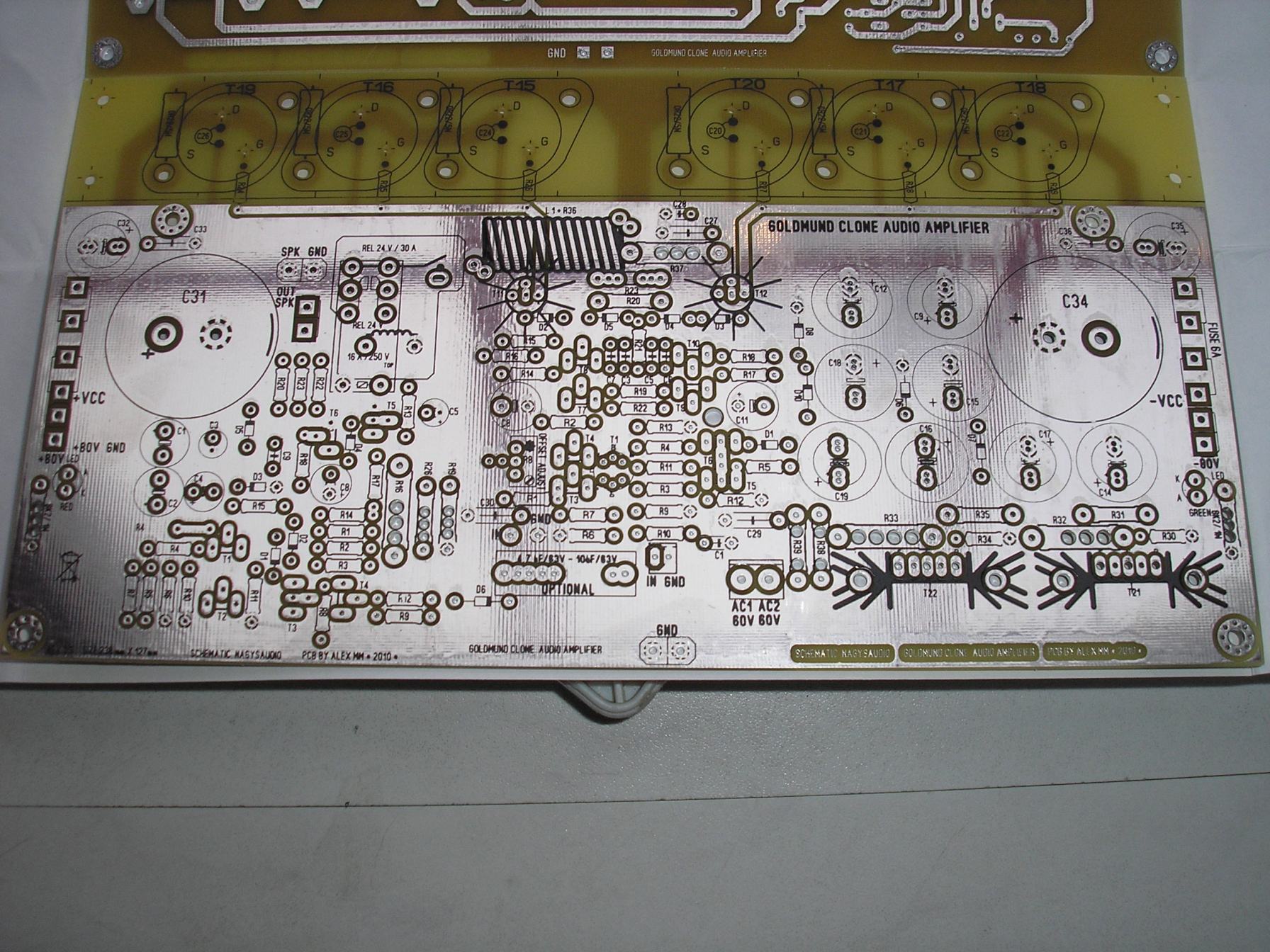

Hallo all,
The boards arrived here in The Netherlands, Bigpanda thanks.
It’s difficult to make a good picture, I make the pictures close by the window on the floor 😉
Rudy
Rudy,
in case you run into stability issues, ground the heatsink and solder the C's at the drains to the heatsink. (in the Hitachi appl. note, btw)
