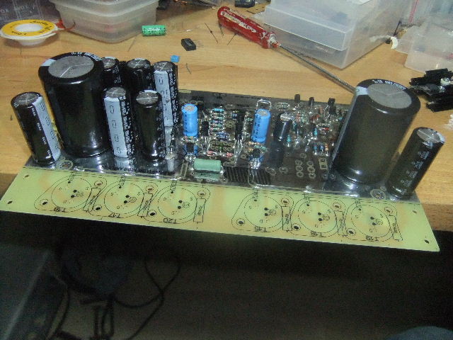

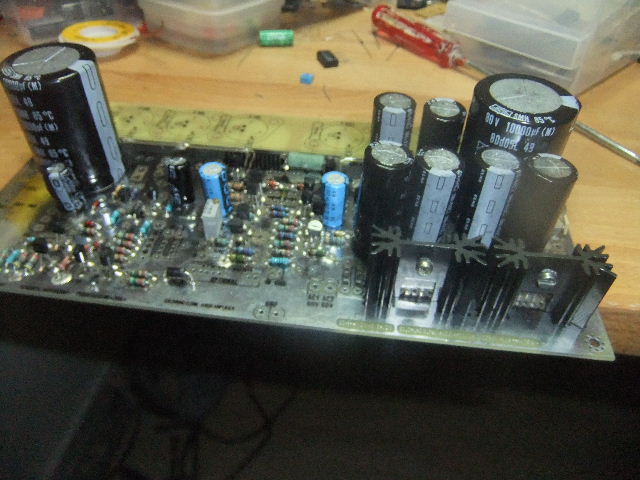

Most of the components in place. 2N5564 is expected in the postbox one of the first few days. Now I just have to find a supplier of BUZ 900/905 that can deliver at a reasonable price. Anybody have good tips?
As far as possible, I want now in the first instance, to take advantage of the components I have lying already.
This means, among other things: T21/22: MJE 15029/15030.
D6/7/8/10 and D4/6 (Protection): 1N5393.
These changes I mean will be safe and without any impact on sound quality.
When it comes to T5/6, I have done changes which I'm more uncertain about.
I do have BC182L . They have placed the emitter and collector reversed compared to BC 182B. This is easily resolved by turning BC182L. But "my" BC 182L measures a HFE as high 1200, so I went skeptical to use them.
My data book says that the BC 546 B is equivalent to BC 182 B. But I mean to remember that in a previous post it has been mentioned anything that the T5/6 must be BC182B
Do not remember any more the reason for this conclusion, but believe that this emerged as a result of someones simutation work. I am grateful for any comments on this change in particular.
C1/2 in the protection circuit is two 220uF mounted back to back. My two 220 uF are 100V types.
Are these "safe" enough with respect to voltage (my transformer will provide 55V AC)?
I notice, for example, C4 is a 160V type (I have no wish that a condenser explode because the voltage tolerance of them is too low).

Not ready for test , yet. I am waiting for my ordered output devices.
Look at pictures #1184.
