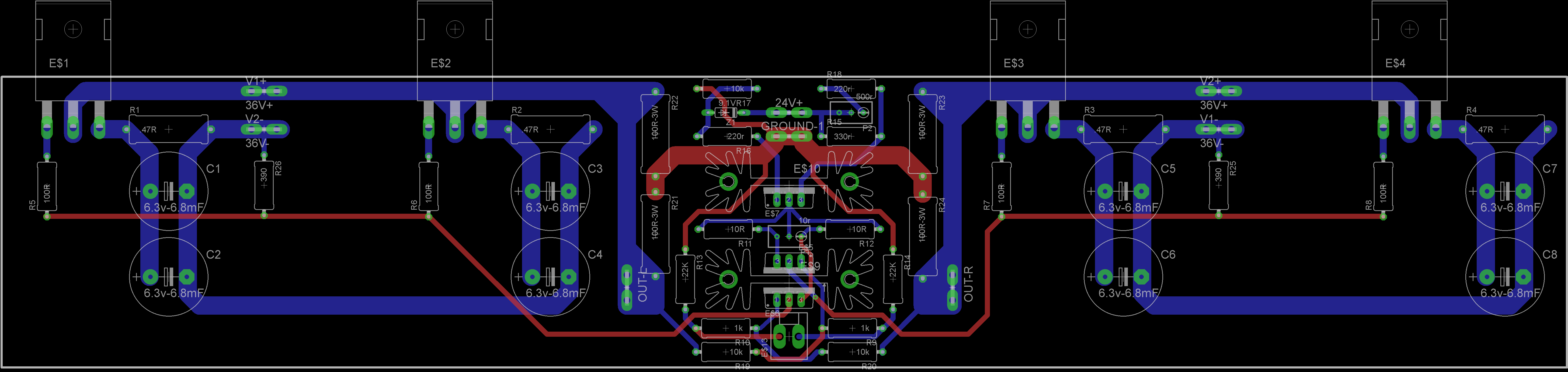

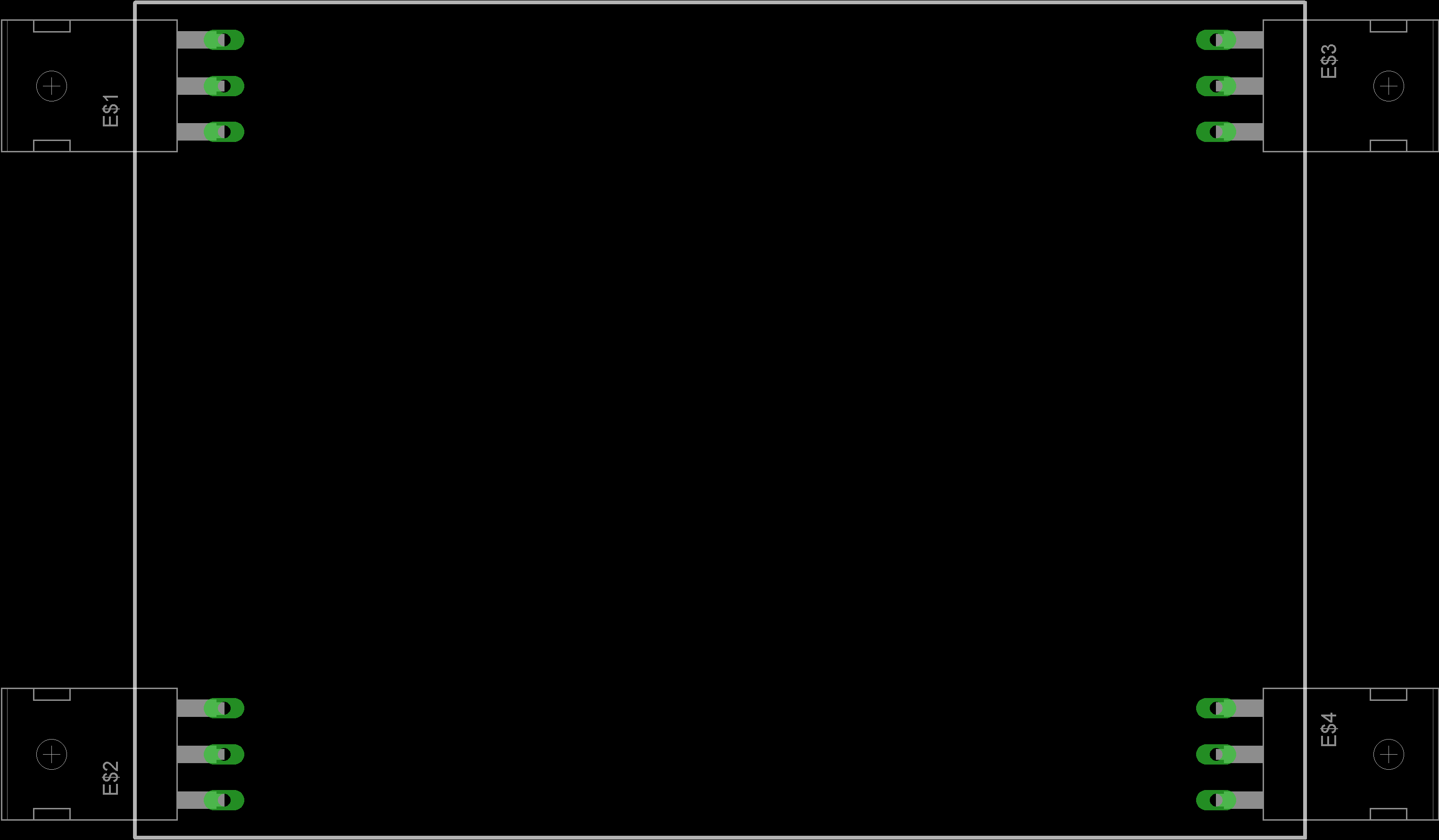

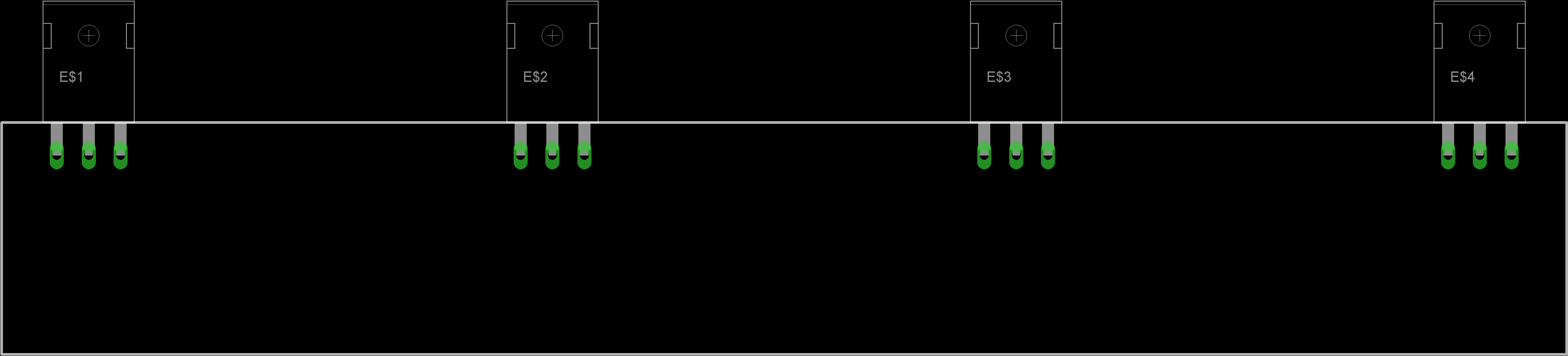

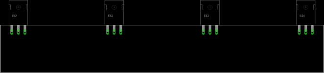

Buzz the second one works better for my chassis.
But if want to use the square one that's cool too - I can make it work.
Thanks for the help !

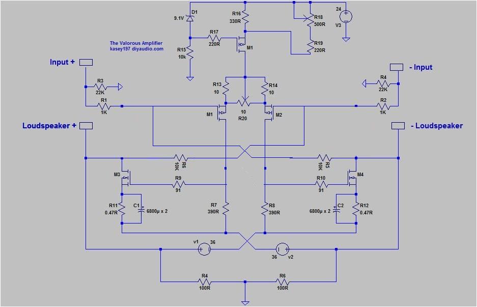

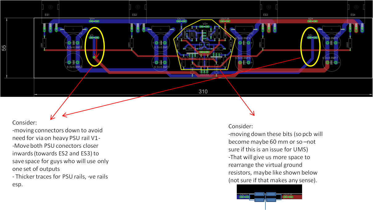

Looks like this will do the job very nicely but two things need attention:
The 100r virtual grd resistors need more space - they are large 3-5 watt parts and so may be useful to make space for a parallel set. We an use that later for tweaking too if we want but at the min need more space for a bigger part. The common point for these two 100r needs to be separate from the other earth connections - carries quite a bit of juice etc - you know the drill.
The input diff pair if you can line em up btb or same alignment would be bonus so we can tie em together to min drift. Not a big issue at all and it complicates layout a heckuva lot so I m not losing sleep over this.
If you replace the diff pair CCS with a resistor, the common mode voltage of the drain resistors will swing with signal.
The cascode FETs are there for good reasons, as the drain voltage sees the complete output swing, and more.
Patrick
Patrick thanks - I will try removing the CCS at some point later just to see if things break. I suspect there should not be too many problems since the common mode voltages will get nailed by the differential nature of the outputs.
Anyway no harm playing with this 😀 so lets see.
I will report later what I find either way once I get round to it. It will be nice to understand the merits/otherwise of deleting yet another part.
On cascoding - points noted but not sure how much of a practical improvement we will see, given the already good linearity of the basic setup. Gilding the lilly maybe but certainly worth a go if we're going down the road of adding parts - hopefully for another amp down the road.
Thanks again for the inputs. Cheers, Kasey

gremlins crept in - I noticed an error in the schematic in post 28 http://www.diyaudio.com/forums/pass...regation-pass-inspired-ideas.html#post3589261
while debugging the pcb layout with buzz.
Pls see update drawn below - this will be cleaned up and more details added later after PCB tests.

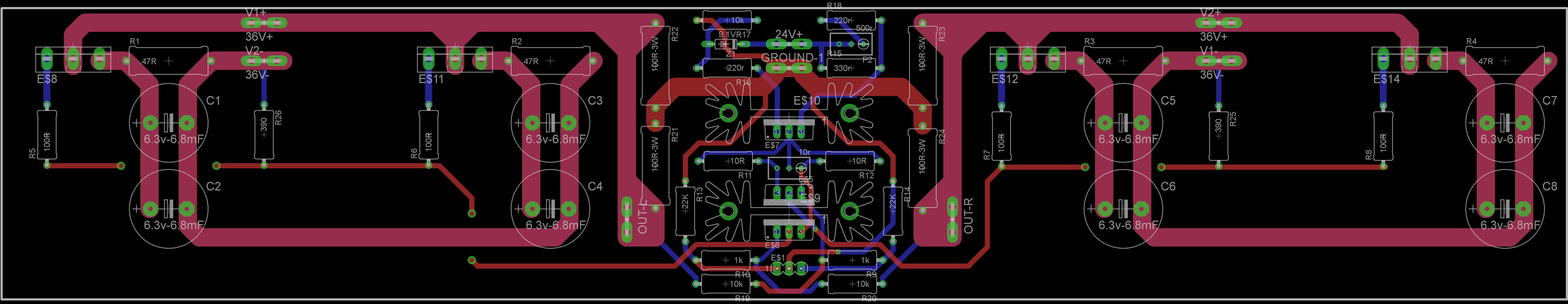

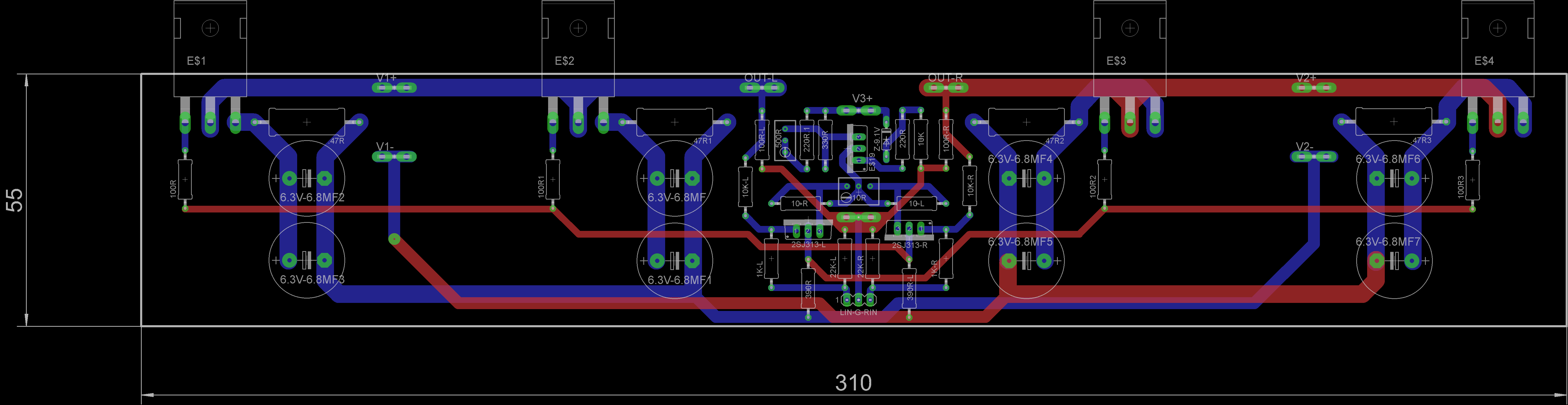

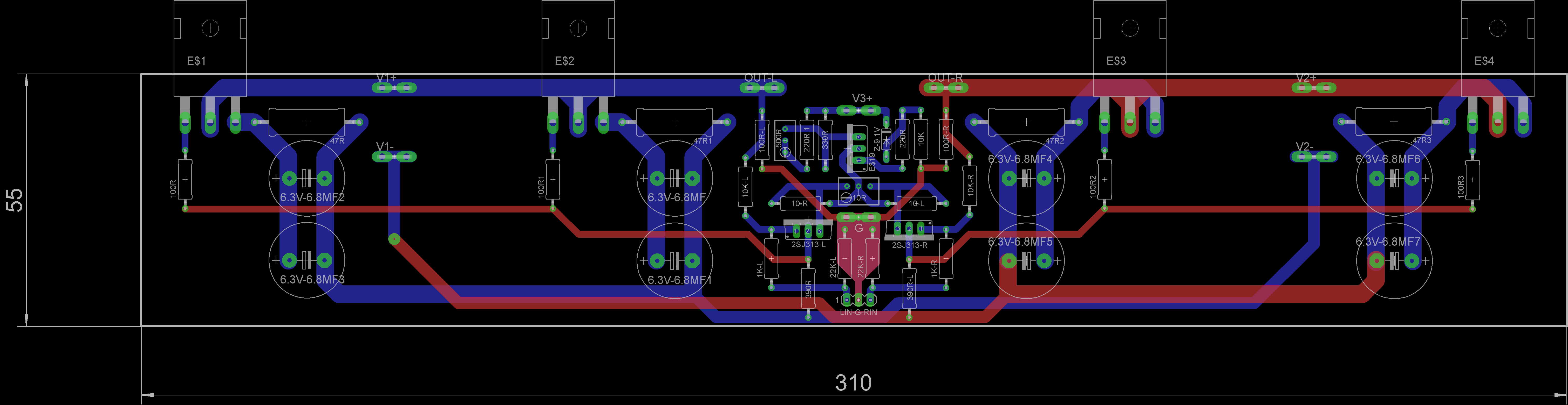

Another try. I can move the neg rail mounts to middle of lower large bus if you like it better. I can add the ground pin back in for the input, but Rane suggest attaching directly to case. Its up to you.

Looks a beaut.
Psu connector layout is better your way than mine.
Ground pin and earth connections let me get back to you.
That's the bizness Buzz- Looks great !

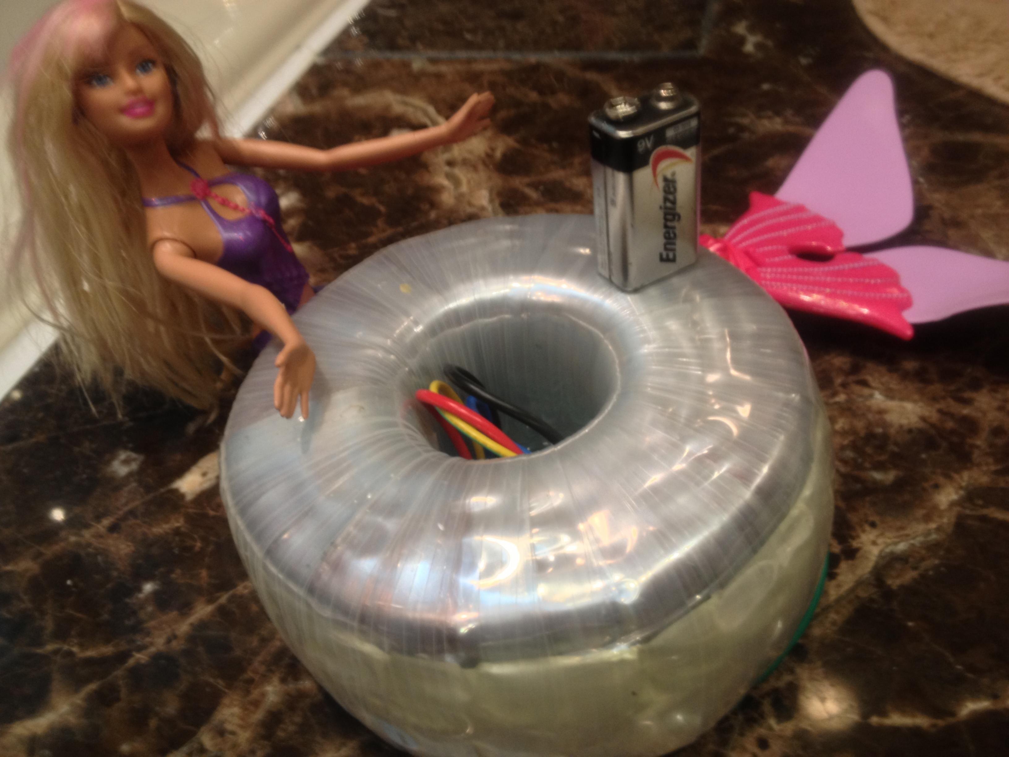

Big heavy beaut - 8 x 18V 4A plus two low power 20v 0.1a rails for the ccs.
I plan to set it up so we can do two modes:
i) high current mode for ger and esl/ribbon guys so 24V 8a rails
ii) normal mode for 4 ohm and up speaks so that will get 48V rails.
Lets see if it blows up or not 😉
